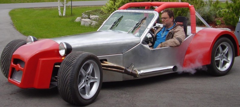

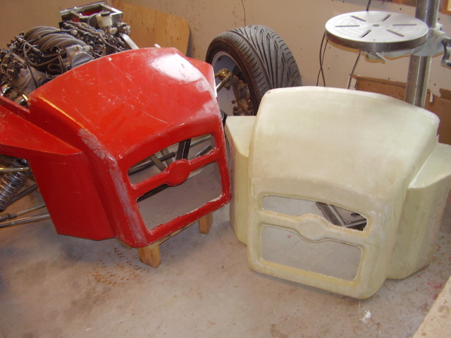

I'm considering some carbon fiber use in my next build. I built a Lotus 7 type car about 10 years ago , and when I did my reaearch , the consensus was that non autoclaved carbon fiber was more of a cosmetic thing over fine woven aircraft quality fiberglass when used with a high quality epoxy resin . Yes there is a strength gain by using the stronger fiber but the resin matrix will ultimately be what fails unless it cures more fully under heat and pressure like any reaction in plastics . Also in order to get the ultimate in stiffness to weight ratio the resin matrix(epoxy) needs to be used extremely sparingly. Thats what prepreg is all about. There is so little resin that its virtually undetectable on the partially cured pre impregnated cloth.
