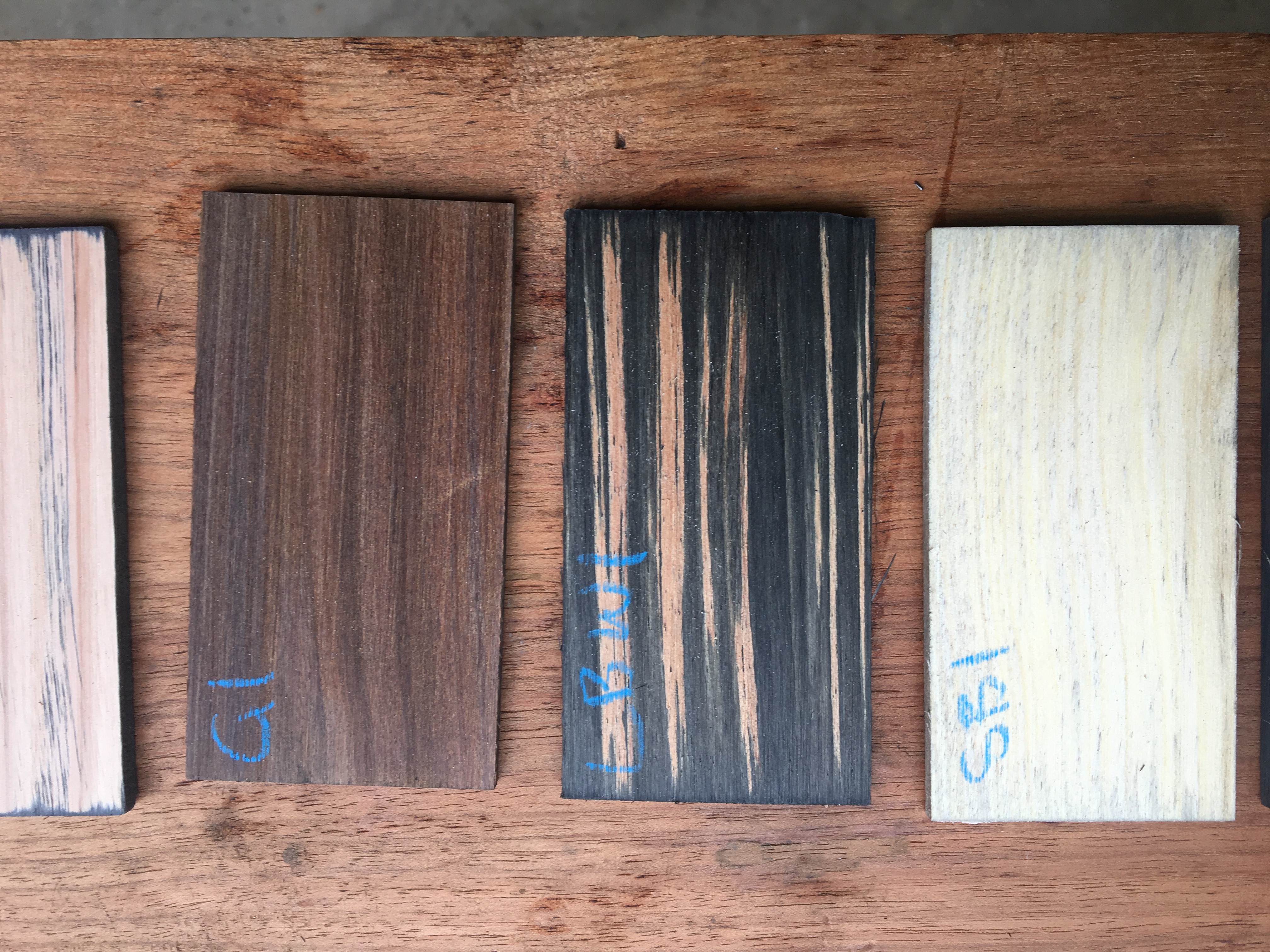

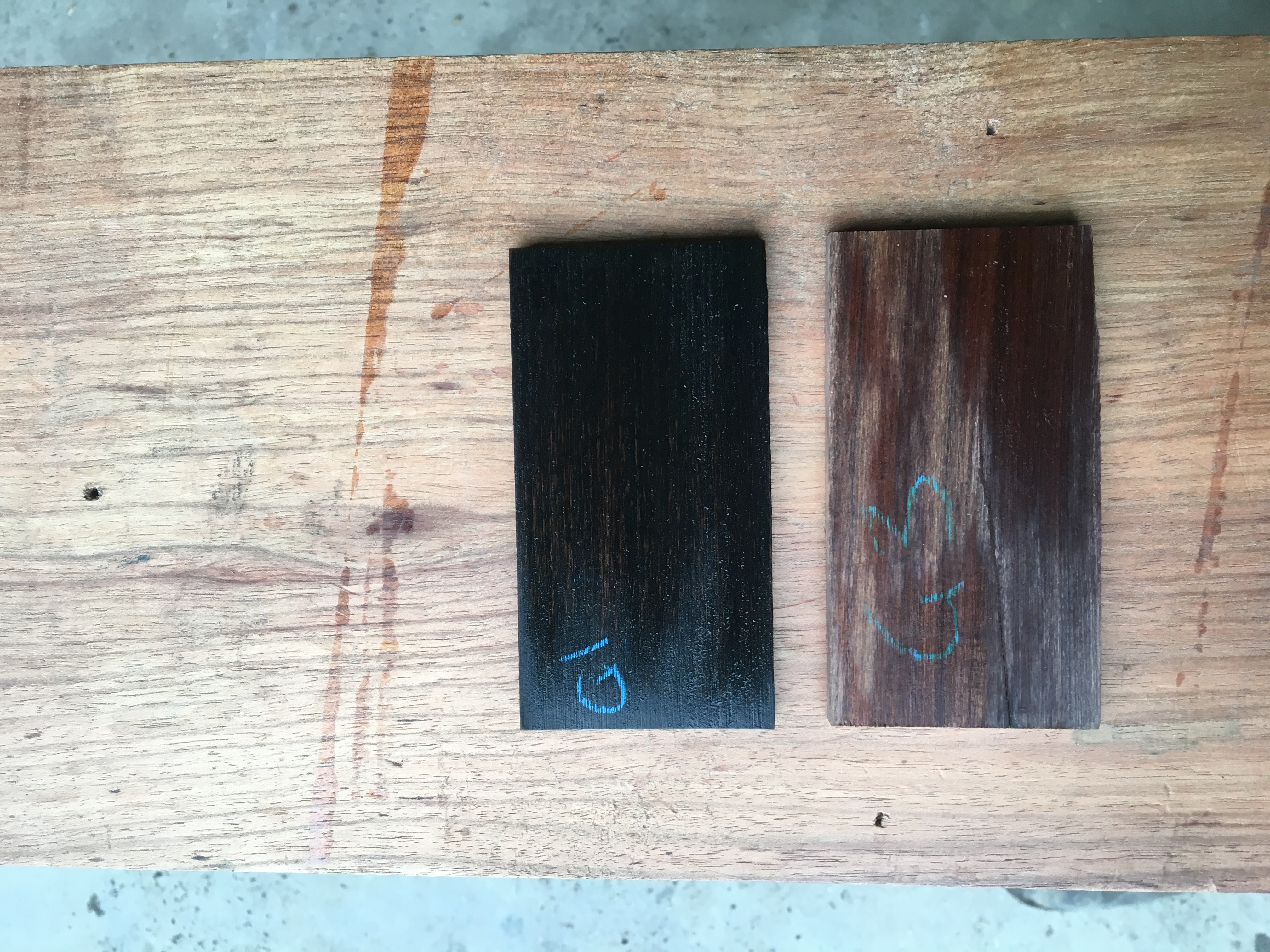

Over the last couple of days I've run a trial utilising a strong solution of steel wool in vinegar on various timber species to test their reaction to the mix , along with depth of penetration .
Gidgee , Blackwood in both high and low density samples , vic ash , messmate , red gum and satin box were trialled .
The samples were submerged in the liquor under vacuum for 2 hrs , left to soak for 2 hrs then popped into the kiln to dry out
All went black to varying degrees barring the satin box which turned the colour of the liquor but not reacting to it . The best colour was messmate , with a deep midnight black .
Unfortunately the depth of penetration was not as convincing . The samples were then sent through the sander till half their thickness was removed from one side . The gidgee lost its colour first pass , red gum and messmate soon after , ash next . The hard Blackwood retained some colour to the core and light Blackwood had only streaks of its regular colour so is most promising for an ebony colour replacement though at sub 500 kg/ cu that's hardly going to work . If I can improve Blackwood to 100% penetration I'll then trial resin impregnation to bring its density up .
I have a second batch of identical timbers which have been put through the same process excepting for 12 hrs in the vacuum and a 24 hr soak . Those will go into the drybox tomorrow morning . If I get any improved penetration I'll report it through .
So as to the gidgee , yes it goes black , though it's less that 0.3 mm penetration

Very interesting Pete. Thanks for sharing the results. It looks like your vacuum treatment didn't get it much deeper than you would see just soaking it at atmospheric pressure? It certainly does achieve a nice uniform black colour in some timbers - just not to a great depth.
