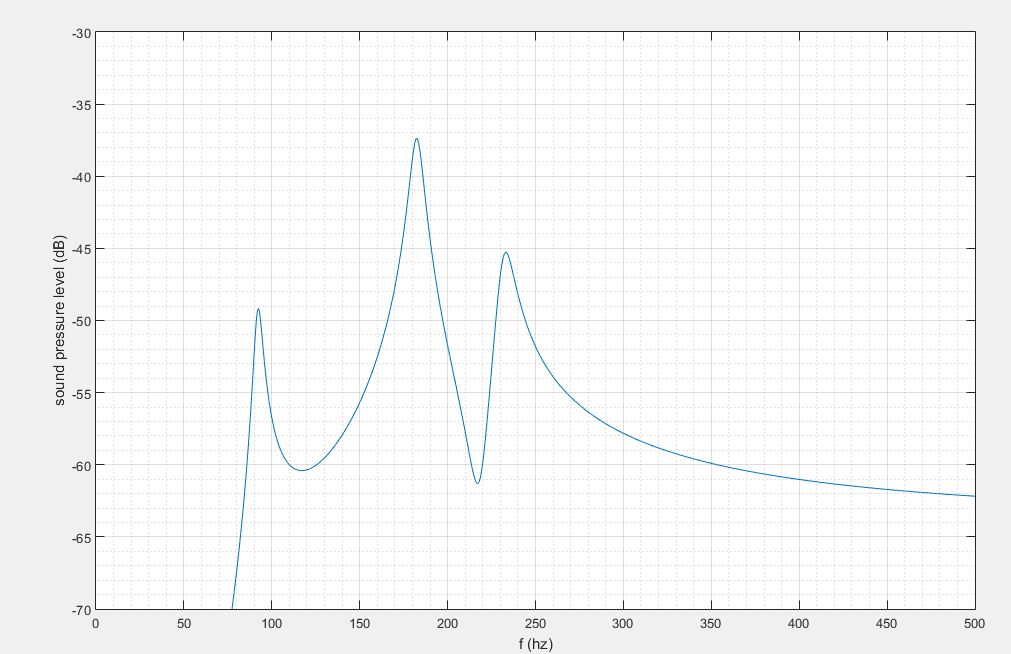

It is all strung up. I ran a first plot with strings and the T(1,1) 1 = 91 Hz, 2 = 183.5 Hz and 3 = 234 Hz. With this I think I can pretty much nail 95, 180, 226 Hz as everything is in the correct direction for tuning. My plan is to enlarge the sound hole (I left it a bit small) which can move T(1,1)1 to or toward 95. Then I would tune the backs lower transverse towards to lower T(1,1),3 to 226 Hz from experience I believe that will move T(1,1)2 to very close to 180 Hz from coupling. I adjusted the matlab 4dof model I got from this site to match what I was seeing with my tap test. I modified the sound hole are to move T(1,1)1 to 95 and then lower the backs stiffness until T(1,1)3 was 226 Hz. The results were very close to my desired results. I am pretty excited as I will be able to hear a properly tuned 180 Hz classical guitar.
retop first plot with strings.JPG (65.99 KiB) Viewed 30408 times

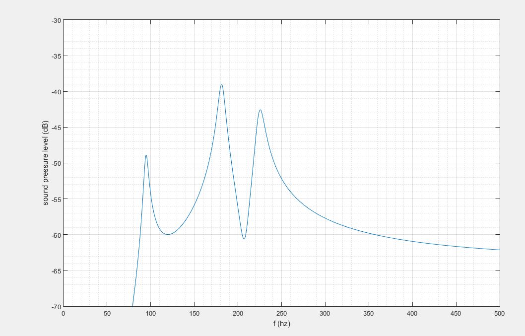

Here is a plot with the model tuned to match my guitar
Here is the plot after modifying the sound hole area and the back stiffness as described above,

On second thought I decided to first lower the back resonance to close to the target of 226 Hz. That went well and it lowered the top's resonance to 180.1 Hz. I am waiting on changing the sound hole. Lowering the back dropped the Air resonance to 89 Hz. In between notes which is good, but almost an octave lower than the tops resonance. I fear that 195 Hz is too far away and I do not want to end up right on F# 92.5. I might add a black purfling strip to the inside of the sound hole to drop the air resonance a Hz or 2.
The guitar really sounds good especially given that I just strung it up today. I will wait a few days before I do more.
