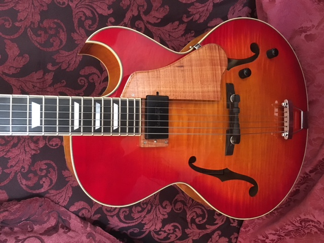

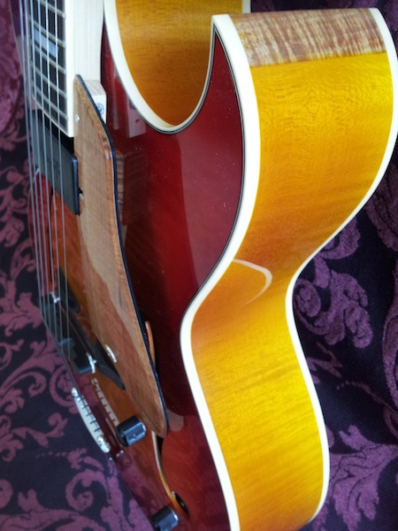

So i've got the sides finished and just starting on the neck, this one is a copy [ with some small aesthetic variations of the cherry burst build from last year.
so when i've got something to show you i'll post pics on here!!

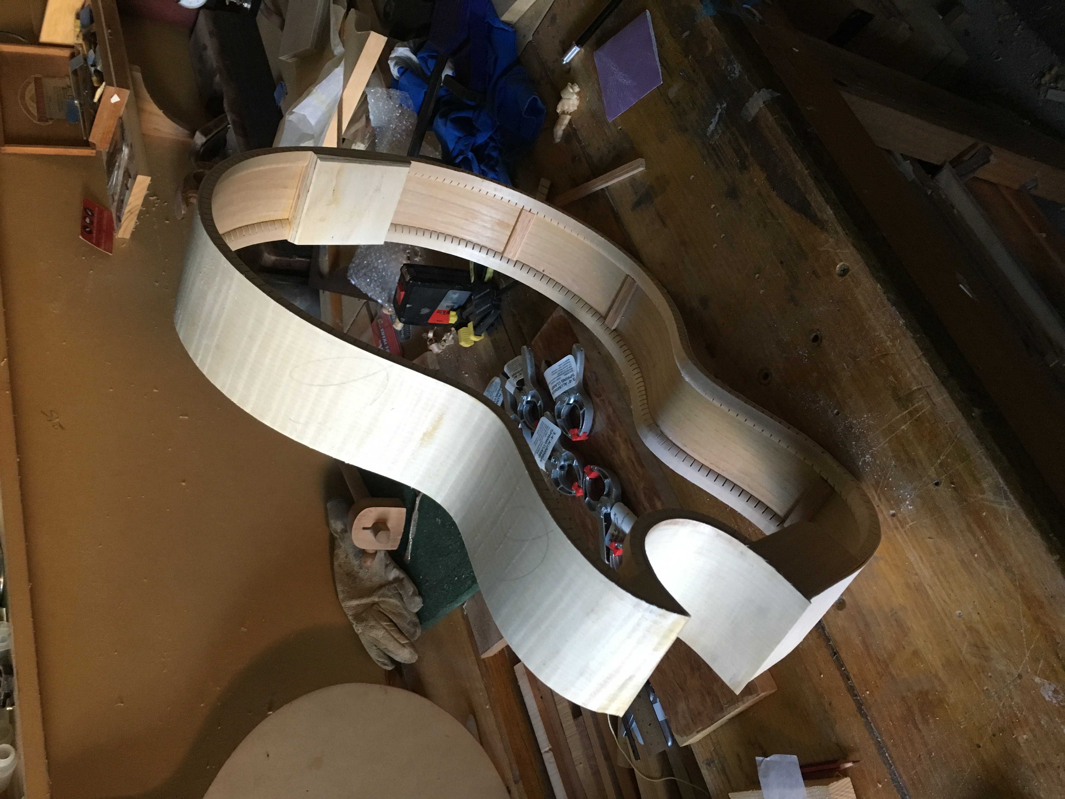

Laminated sidesand plywood tail lock

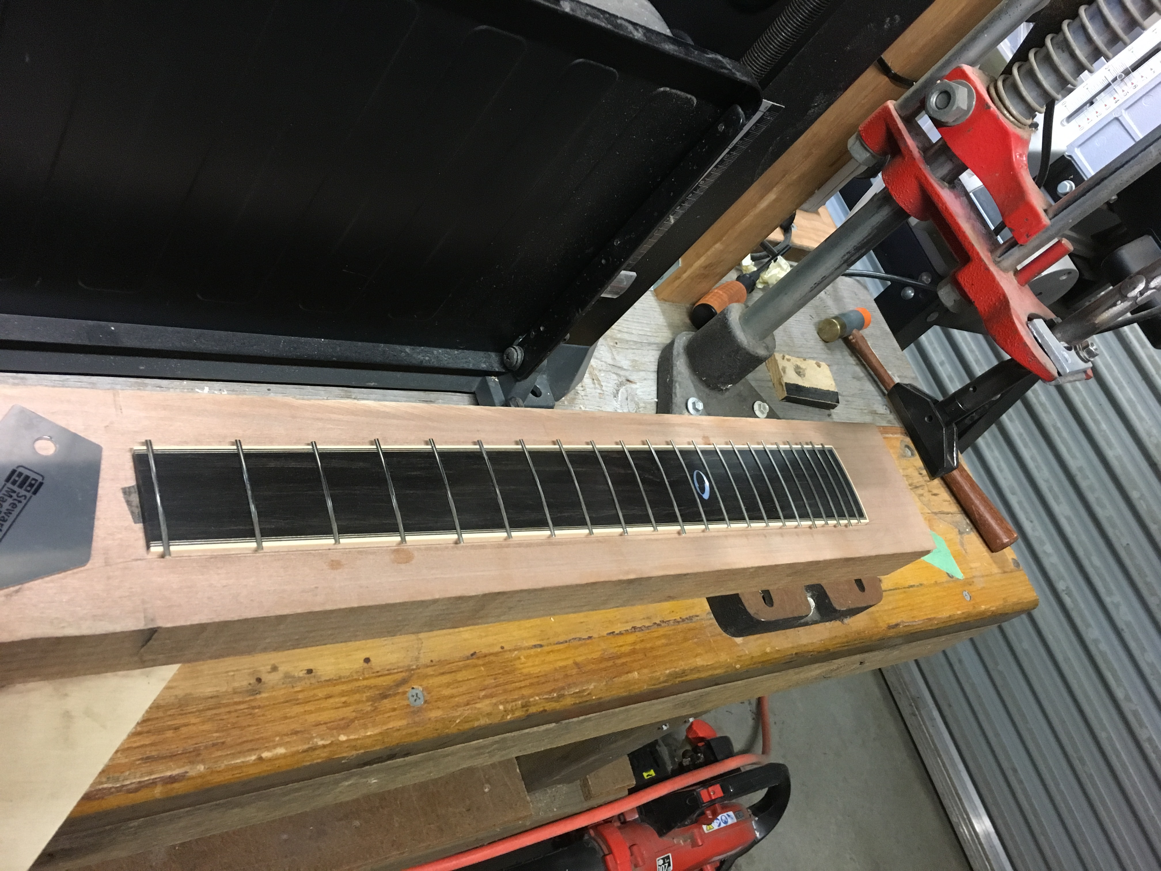

Post by rocket » Sat Aug 26, 2017 12:58 pm
Bound ebony fretboard

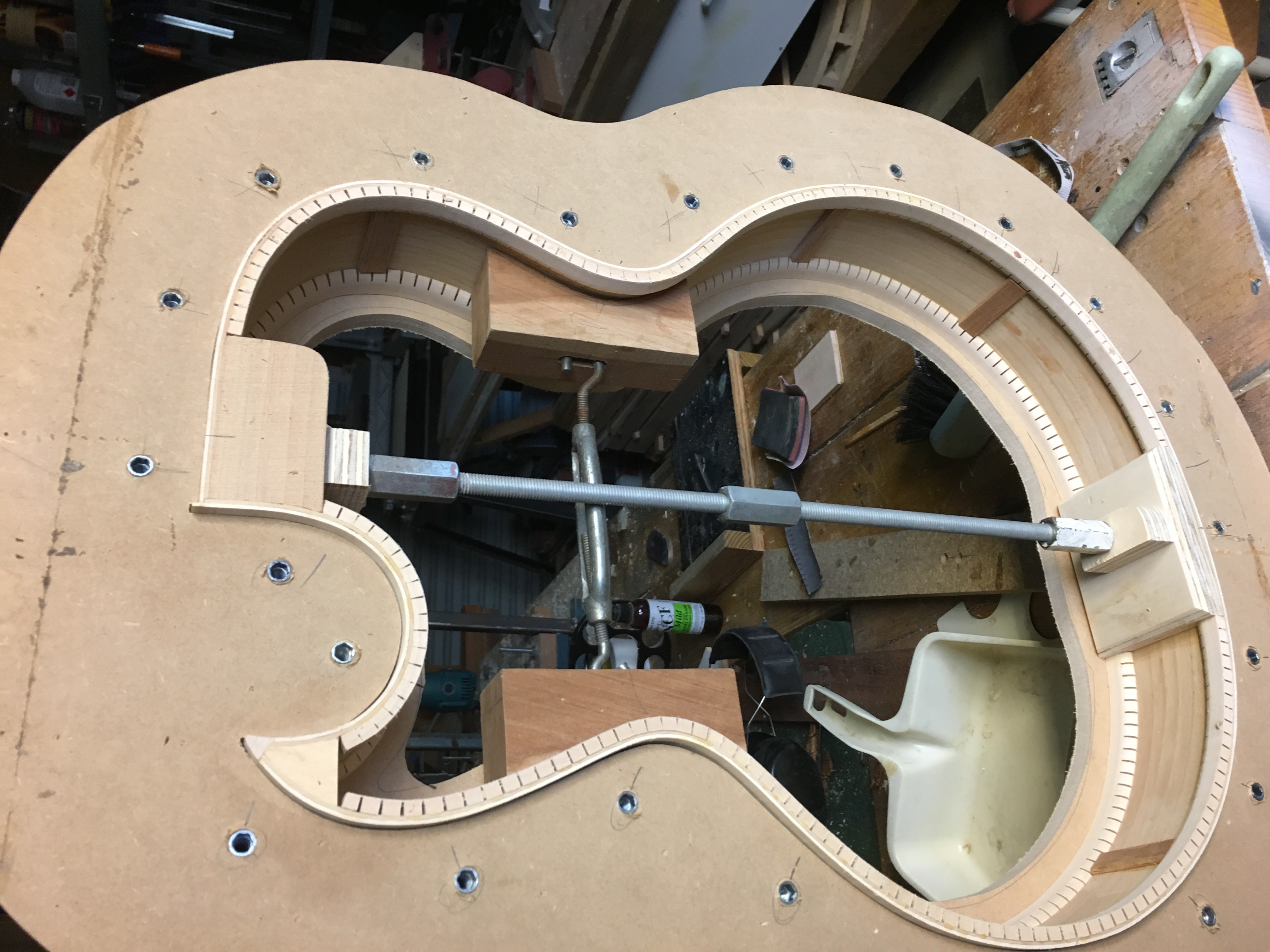

Very nice, can we see a photo of the body mold you are using
Re: New build
Post by rocket » Fri Sep 01, 2017 4:03 pm
Body mould Steve.
Rod
Re: New build
Post by simso » Fri Sep 01, 2017 7:14 pm
That looks really good, did you hand make that one.
The laminated sides, are you buying them laminated and bending or laminating them into the mold

Steve ,, no cmc's in my shop, i do everything with the old elbow grease, make a template, transfer to mdf cut it out on the bandsaw, refine the bumps with files etc.
I bend my sides and laminate them inside the mould, all my instruments are done that way.

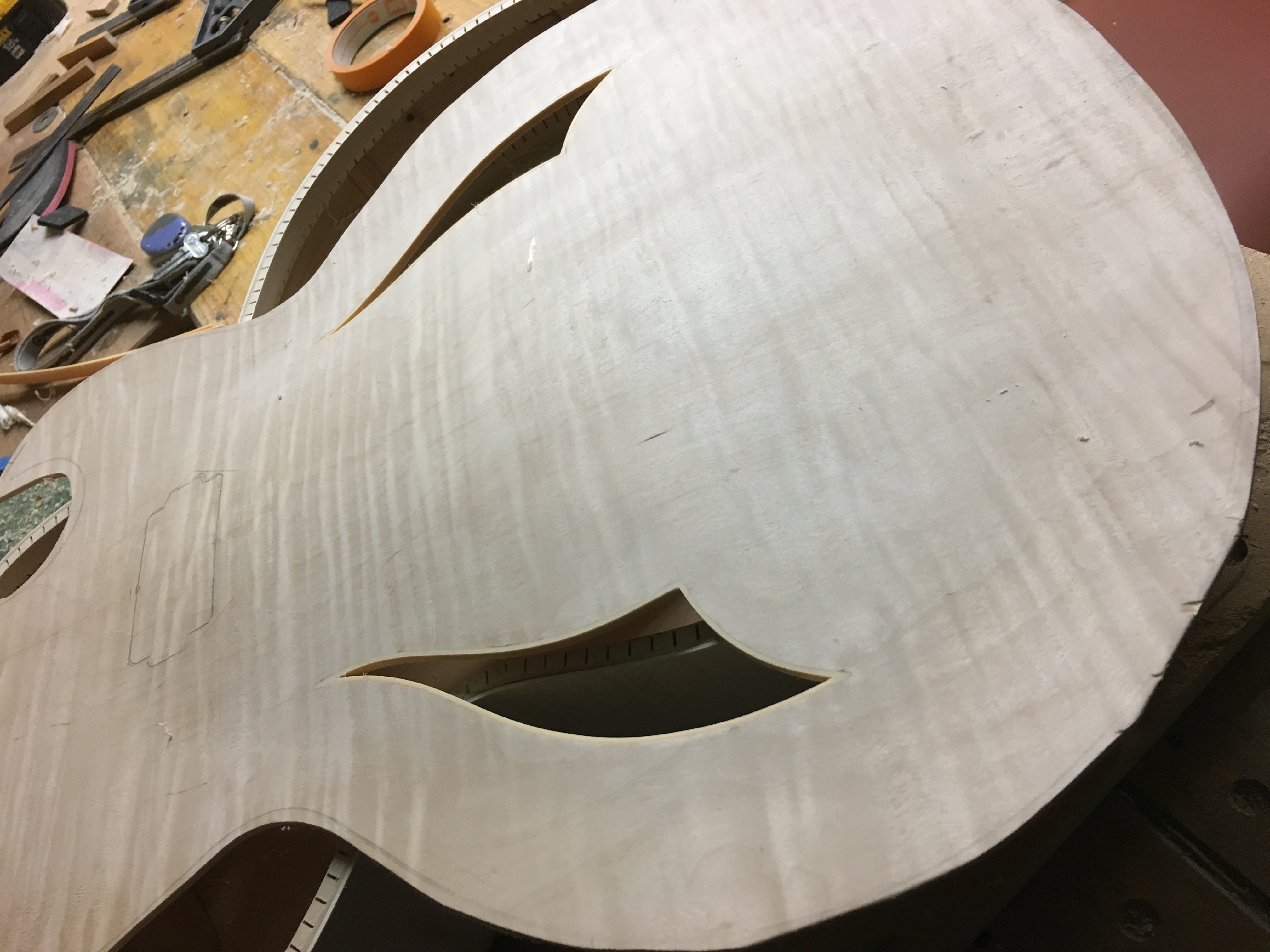

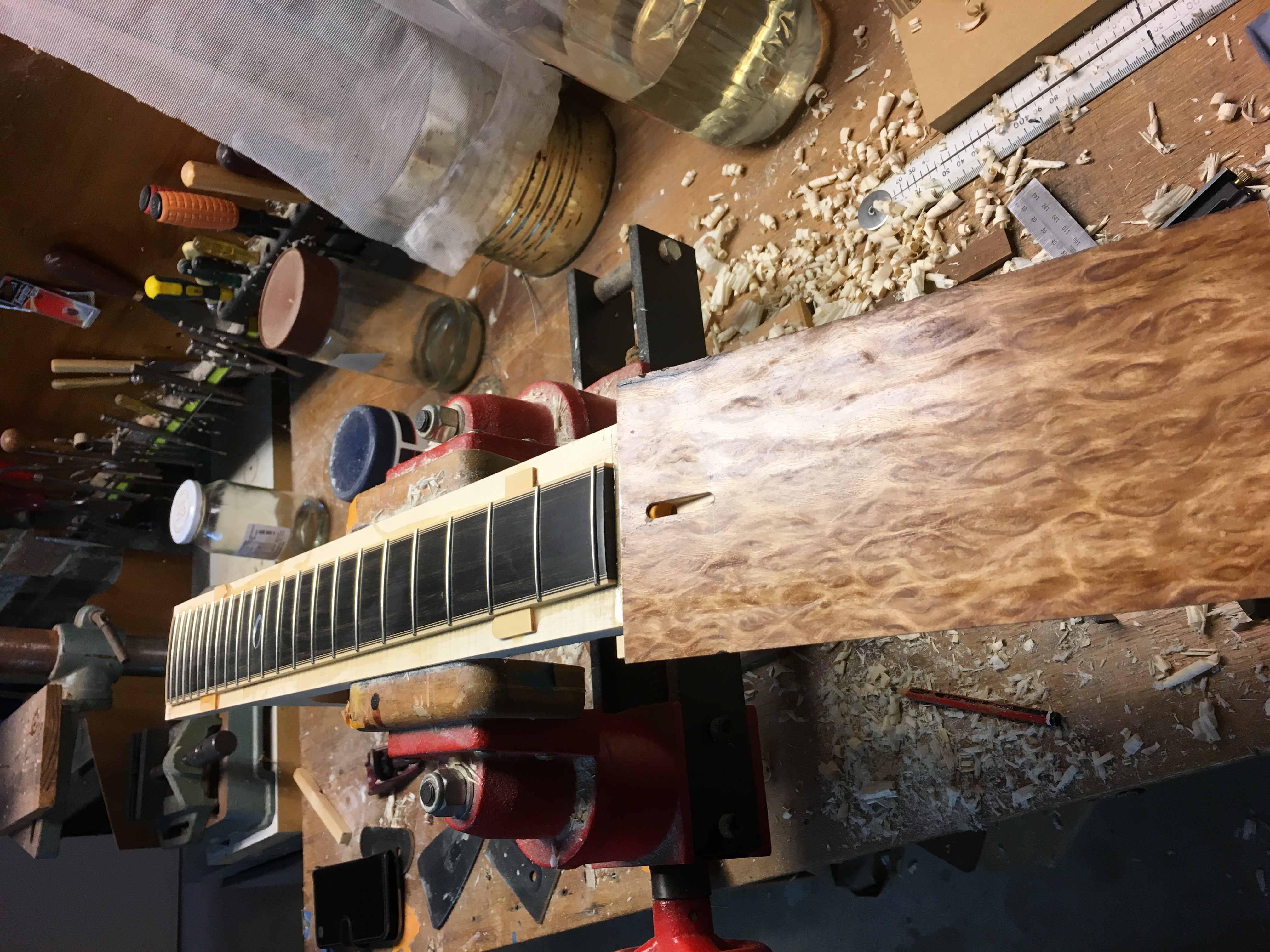

Post by rocket » Fri Sep 01, 2017 10:08 pm
Re: New build

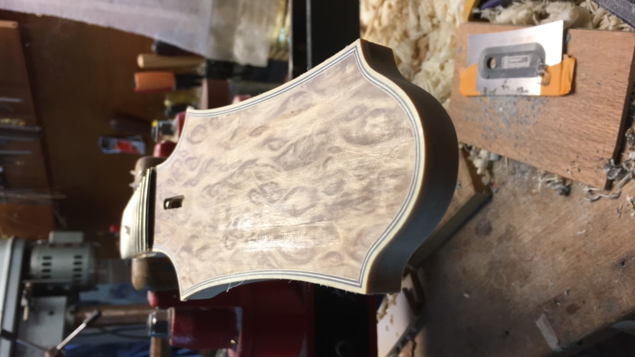

Post by rocket » Wed Sep 13, 2017 9:44 am
A bit of progress.
Rod
