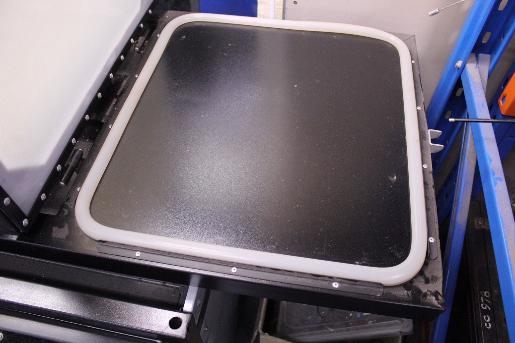

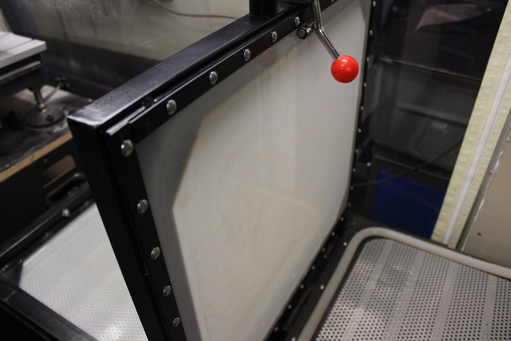

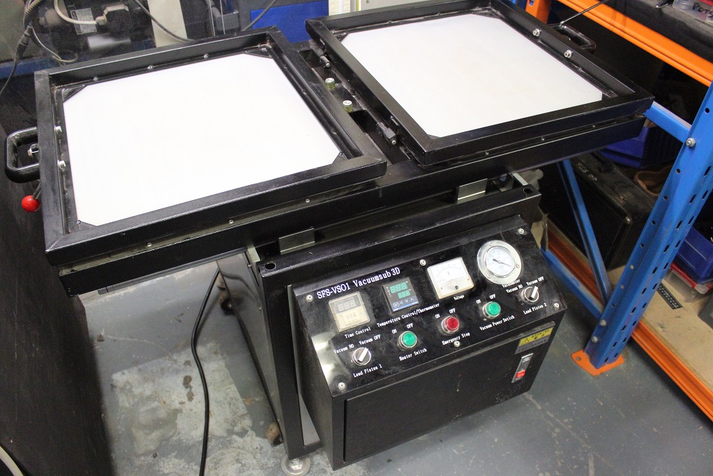

Here is my vacuum clamping machine, I have two of these units, one is permanently setup to sublimate, this one was purely for guitar and brace work.
It has two work plates, each with their own vacuum source and clamping, there is also provision for adding a heat source, not that I have needed one yet.

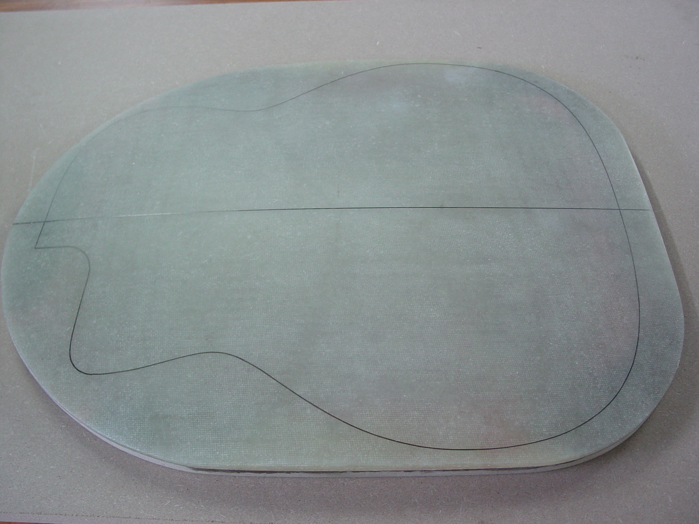

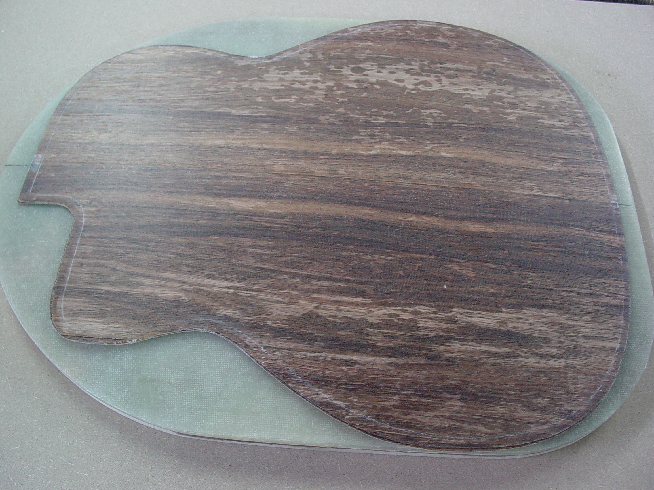

The photos show how I laminated a Selmer/ Maccaferri back. I made an internal fibreglass mould on an MDF backing. Three plies of .8mm veneer (Blackwood/Poplar/Mahogany) were glued together using West Systems Epoxy in a vacuum press. Worked well, but may be a bit more work with a typical archtop's more complex geometry.

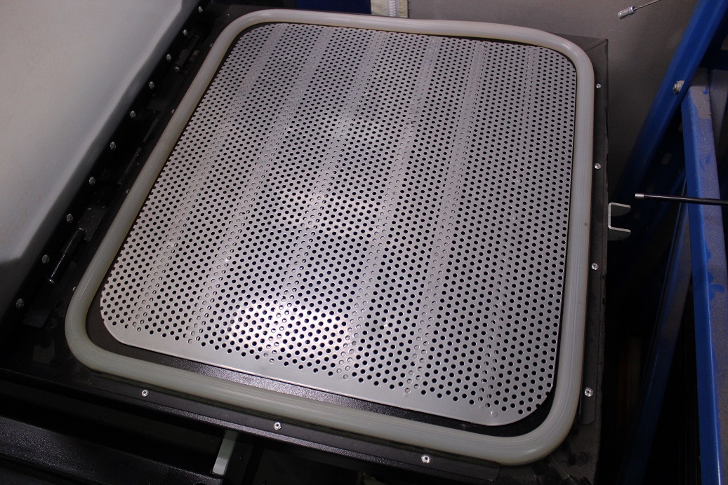

This commercial sublimation unit is pretty good, the vacuum when set will hold upwards of an hr before the pump re-cycles, heavy duty rubber sheets have been used, the border of the bottom plate is a type of plastic with ribs in it, I'm assuming the rubber conforming over this is what gives the good seal.
The base of the unit has stainless steel sheet with lots of holes to allow air draw. When I purchased the one for sublimating, I thought even back then what a great machine to convert into a vacuum jig.
We will see how it goes for forming.
I might next week, machine myself up a top plate to muck around with, I will gel seal and cure it so water and so forth won't affect it, then start experimenting, it's like everything, have to start somewhere.

I had no problems laminating backs (and sides) using .8mm veneer, dry, without any preforming. The recurve on an archtop may present problems, however. If I were to try it, I would start with an inside mould which also modelled the recurve. In order to get the vacuum to press the veneer stack into the recurve, it may be worth trying a hard(ish) shallow rubber strip of the right profile along the recurve. The aim would be to have the bag under vacuum in contact with the wood and the rubber strip, with no gaps leaving an unsupported bag.
Yes, a pump with a tank would be much better . But the little Gast pump is what I had access to at the time, and it worked well. I did speed up the epoxy drying process by putting the bag under an electric blanket (cheap single bed one from K Mart). The right elevated drying temperature also has a positive effect on the epoxy's mechanical properties.

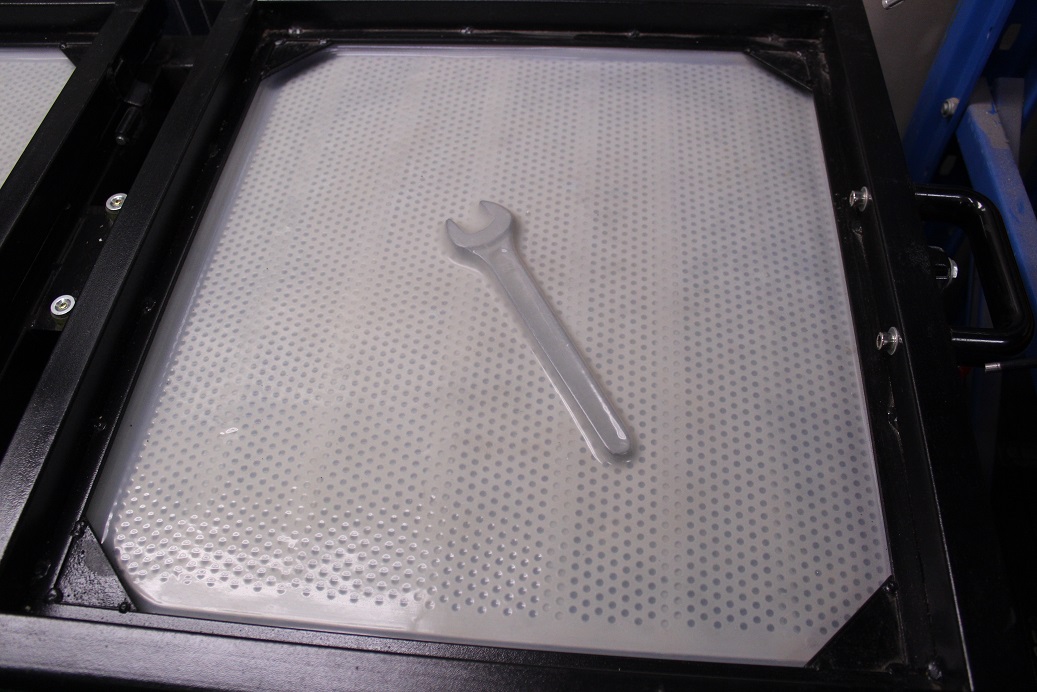

Would you post some more detail photo's of this Steve. I'm planning on building a press, and looking for ideas on getting a good seal. The home made one I built 10 years ago is only mediocre at best.simso wrote: ↑Sat Sep 02, 2017 7:38 pmThis commercial sublimation unit is pretty good, the vacuum when set will hold upwards of an hr before the pump re-cycles, heavy duty rubber sheets have been used, the border of the bottom plate is a type of plastic with ribs in it, I'm assuming the rubber conforming over this is what gives the good seal.

Will take some photos tomorrow for youWould you post some more detail photo's of this Steve. I'm planning on building a press, and looking for ideas on getting a good seal. The home made one I built 10 years ago is only mediocre at best.

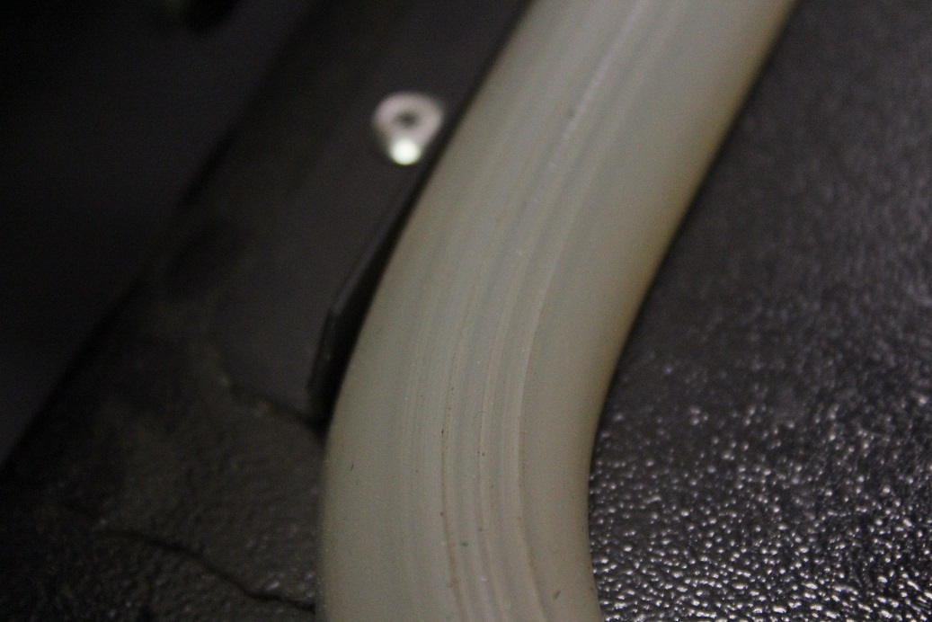

Up close
Re: Vacuum molding
So is it the silicon rubber membrane that is making contact and the seal on that big sausage, or is it the metal frame?
Re: Vacuum molding
Yep, the rubber sucking down over the sausage shaped ribbed plastic is the seal, the steel is just a sheet they have mounted / glued the hard plastic onto, it can be lifted out, the vacuum hose is connected to the underside
You can also see that the base steel is painted with a rough surface, allows the vacuum to pull down nicely as per the first photo.
I also stand corrected re it runs for an hr without rebooting, I used it this morning, it powered on, and created the initial tank vacuum, 2 minutes, then I used it to suck down onto the spanner and it sat there for 9 minutes before the pump cycled on again, the cycle was literally 15 seconds.

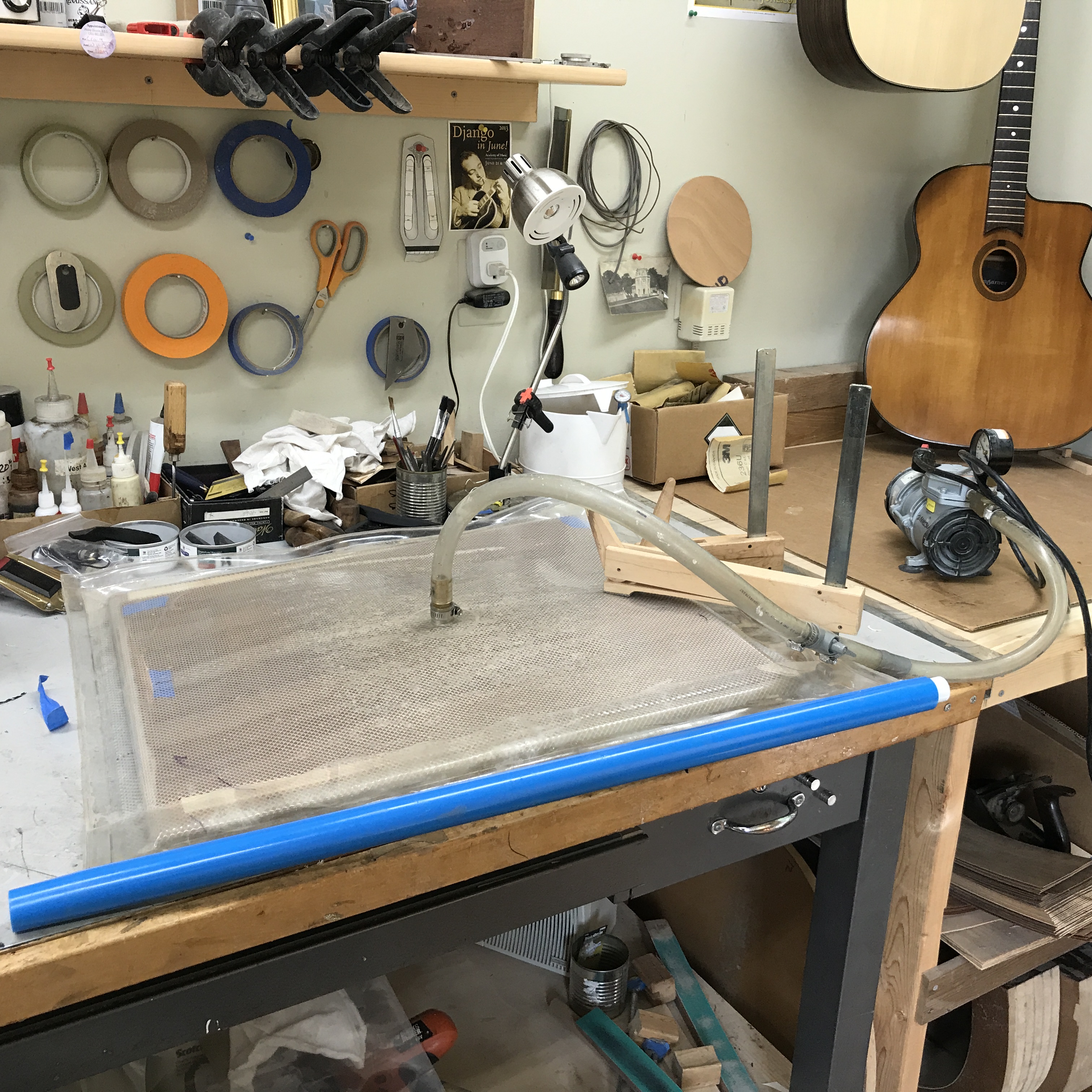

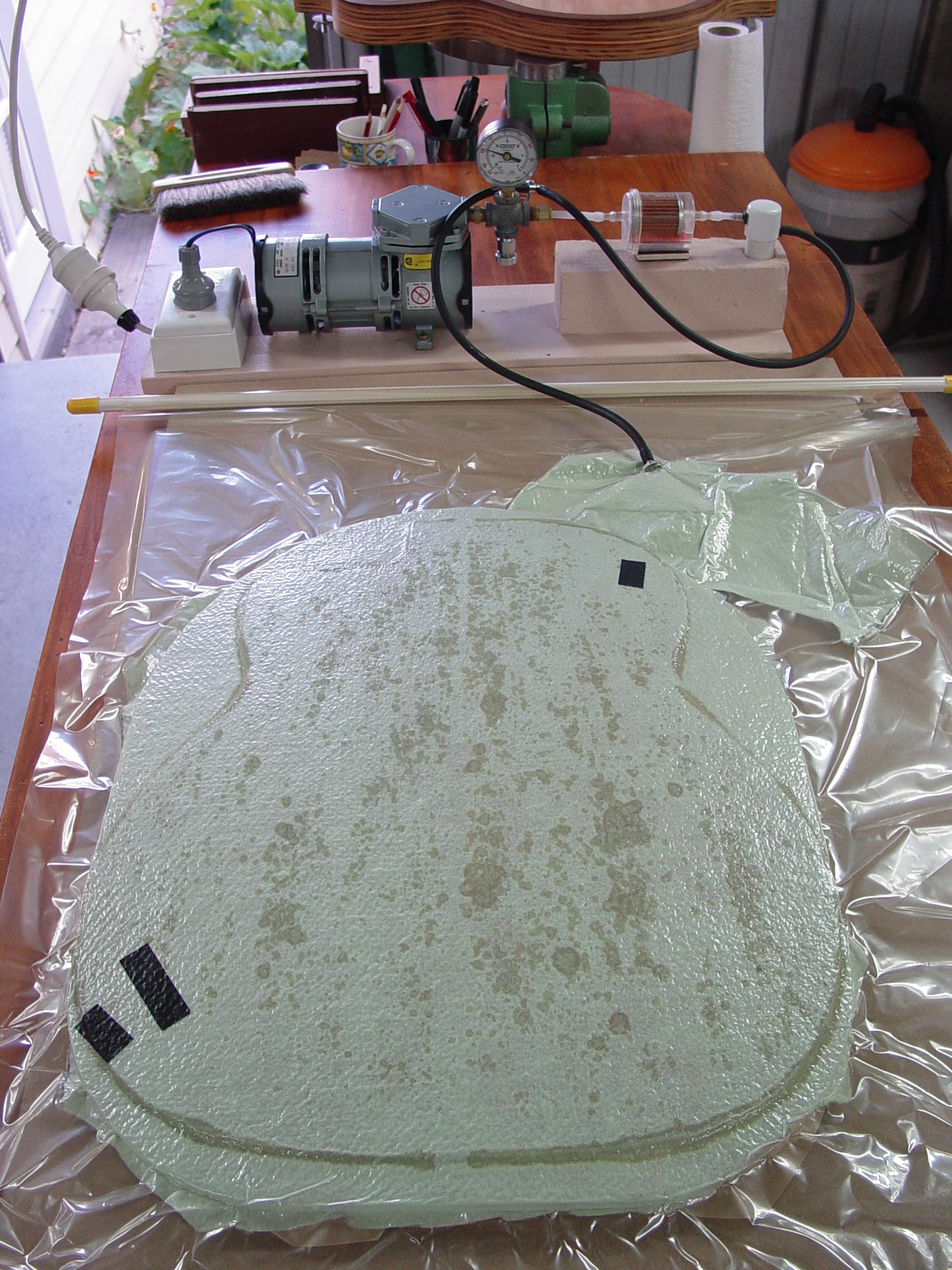

As Ross says, I've been vacuum molding backs for my gypsy guitars, both spherical and violin back shaped (I have a hard time saying arch-top back
Made the violin back shaped molds by gluing medium density PVC foam sheet to a 3/4" MDF board and carved out the shape in the foam, tapered into the MDF on the edges to insure it is even and in plane all around.
The tricky part is the compound curves near the edges. If the recurve is dramatic, there is a tendency for the the veneers to bunch up along the edges and in extreme cases may stand the veneer up on edge and crack. I have two molds, one with more recurve than the other. With the one with more recurve, I mold all but the outer layer first. I mold it dry to see what might happen and cut darts in the edges and remove a little wood in the trouble areas. Even so, I might get some bumps in it, but no worries, these can be smoothed out and then the final layer molded on. Single layers are less trouble than multiple layers. As the vacuum is first being drawn, you can sometimes smooth out bumps along the edges if they start to form. On my mold with less recurve, I usually have little trouble and mold all the layers at once. Sometimes a small bump can be clamped down like in the picture below.
I use a vinyl, reusable vacuum bag, plastic bleeder sheet, a small vacuum pump with no reserve tank (see pic) and epoxy glue (WEST brand, standard). Much prefer epoxy in that it has a longer working time and cures well in a vacuum. All the water based glues I tried hydrated the wood too much and cause warping and then shrinkage after finishing.
Epoxy will bleed through the wood, but that is okay because I use epoxy to grain fill and it blends in nicely. I use 30 grams of mixed epoxy per interface, so a three layer lam would use about 60 grams glue. I use 1mm poplar for the internal layer(s) and .5mm for the inner and out. Usually mahogany for the inner and whatever is cosmetically pleasing for the outer. In spite of worries about how thin the outer layer is, i have never gone through it in 40 guitars.
If your mold is heated, I'd be tempted to try hide glue. The French builders in the mid 20th century all laminated backs and sides, some with recurve. I'm told they did this using hide glue and a large pile of hot sand as a press. When the sand cooled off, the glue would set up.

BTW, I typically get 23 inches of vacuum with my set up, far from perfect, but more than adequate. I get excellent glue penetration, not voids and good reproduction of the mold shape even in the recurves.
