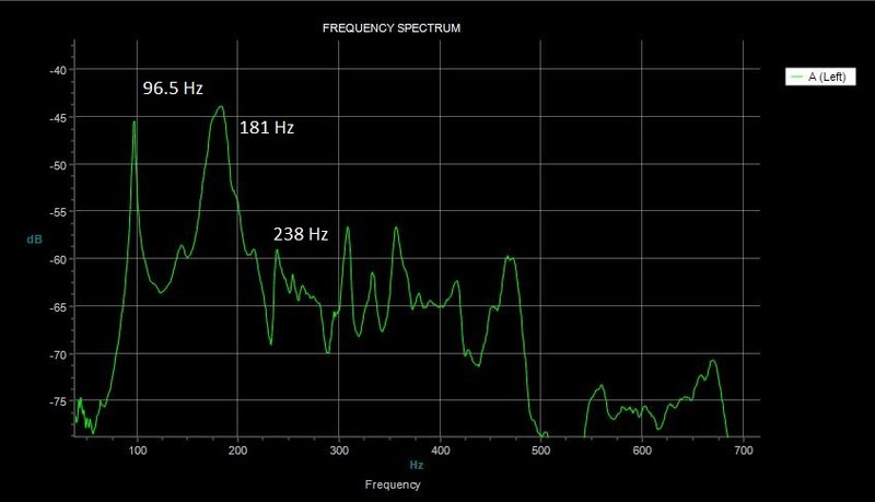

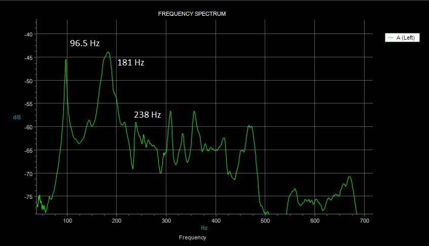

I have finished the top bracing and closed the box. So far things look and sound good. I think I may hit 180 Hz on this guitar. I will have a better idea after I bind the guitar but right now the top resonance is 193 Hz.
From the last post I epoxied the smaller braces on and then laid CF tow on all of the braces.

Whoops forgot to post the final spectrum graph. Everything is not exactly where I had hoped but the guitar sounds great, my target T(1,1)2 was 180 Hz and I am at 181-182 Hz with no mass. Also nothing is right on a note (but the air is close). The back is not super responsive but it does couple. I got a much better response from Koa on one of my previous guitars.
I had about 15 minutes of everything I know is wrong when after a bit of sanding the back brace just a bit, I picked up and tested the wrong guitar and wondered why I was getting 94, 170, 214 Hz. It took me more times testing then I want to admit before I noticed I had my guitar built to Gore medium steel string plans.
