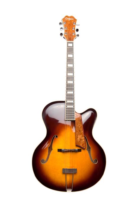

I use Stumc Colortone tints which i find very good and Microtone 3220, usually get a pretty good outcome.
Octigan Guitars Warm Brown Front (Custom) copy.jpg (26.21 KiB) Viewed 23682 times

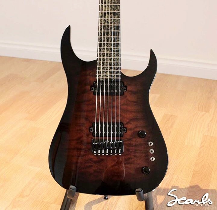

Same method, same product, just less concentrate in the mix:

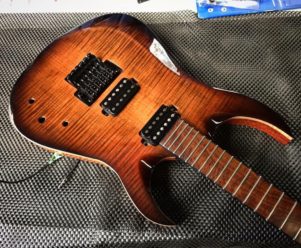

ImageIt depends on what market your work is intended for. Some markets prefer the sprayed look, others the hand rubbed look. If' you're making guitars for the "hair rock" brigade, it should be sprayed. If it's for the "pencil 'tash and braces" crowd, it's hand rubbed.
"Vintage Gibson" look covers both, as early Gibsons have hand rubbed bursts, 60's ones have sprayed bursts. What are you making exactly?
Here is a hand rubbed burst. I much prefer the look of these on an acoustic.
