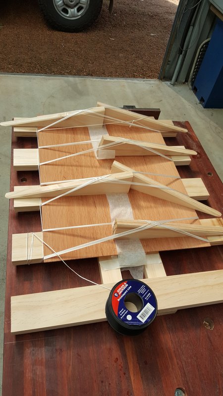

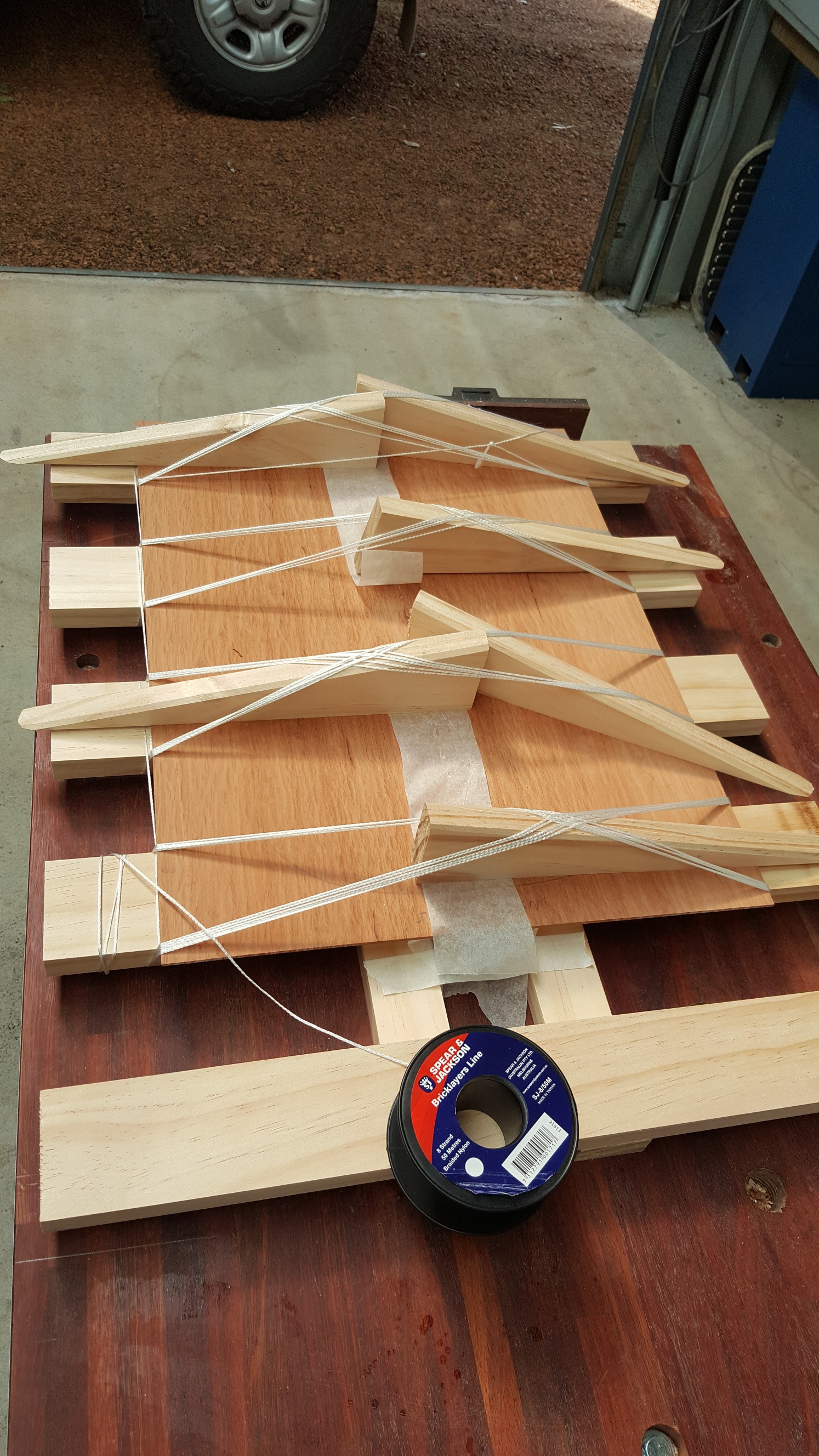

Sincere thanks to everyone for the suggestions you've posted so far, plenty to think about...
I started on it recently, see pic attached.

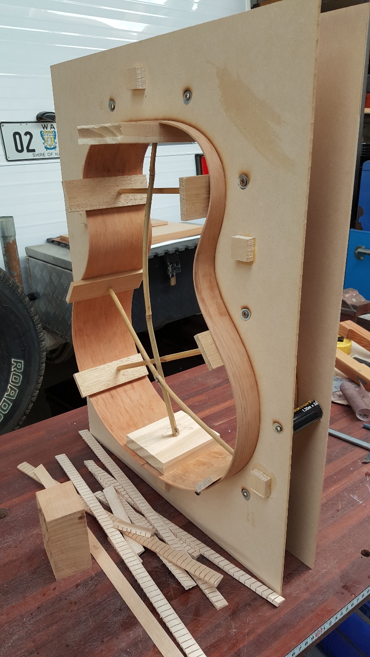

More progress...

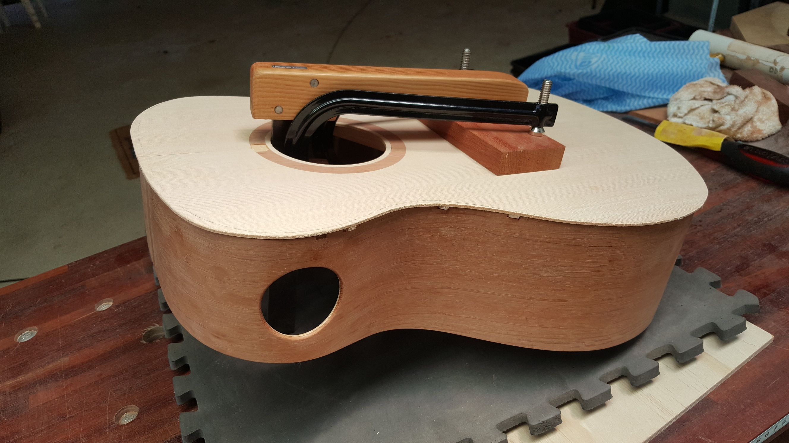

And today I am assembling the body

Getting there. More sanding / finishing to go.

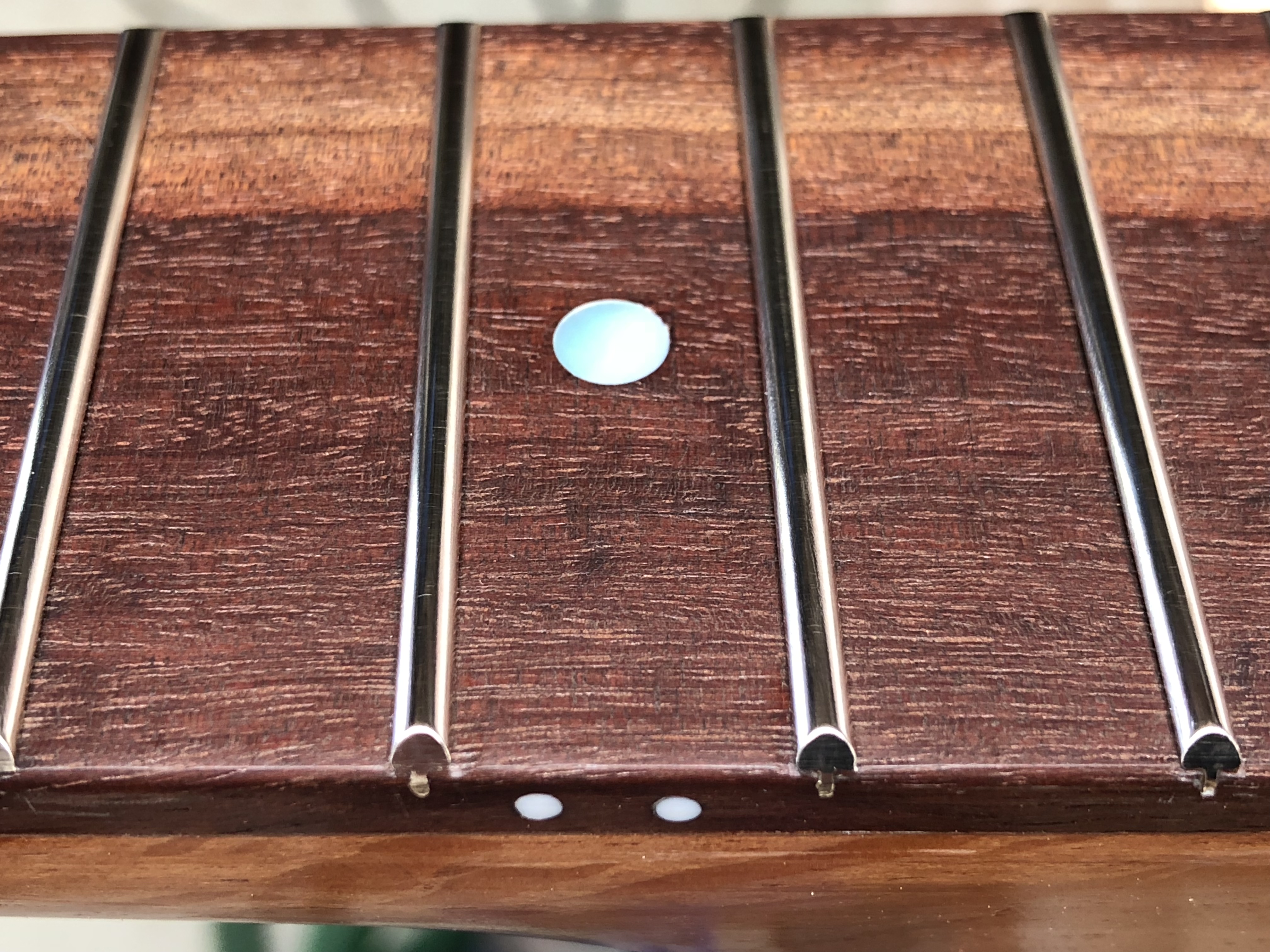

Finally worked out a method to make fret ends presentable and consistent.
Have a lot more shellacing / polishing to do, then make bridge and glue the neck.
Have lasered some Braille into the rosette and set dimples into the back of the neck for fret markers.
