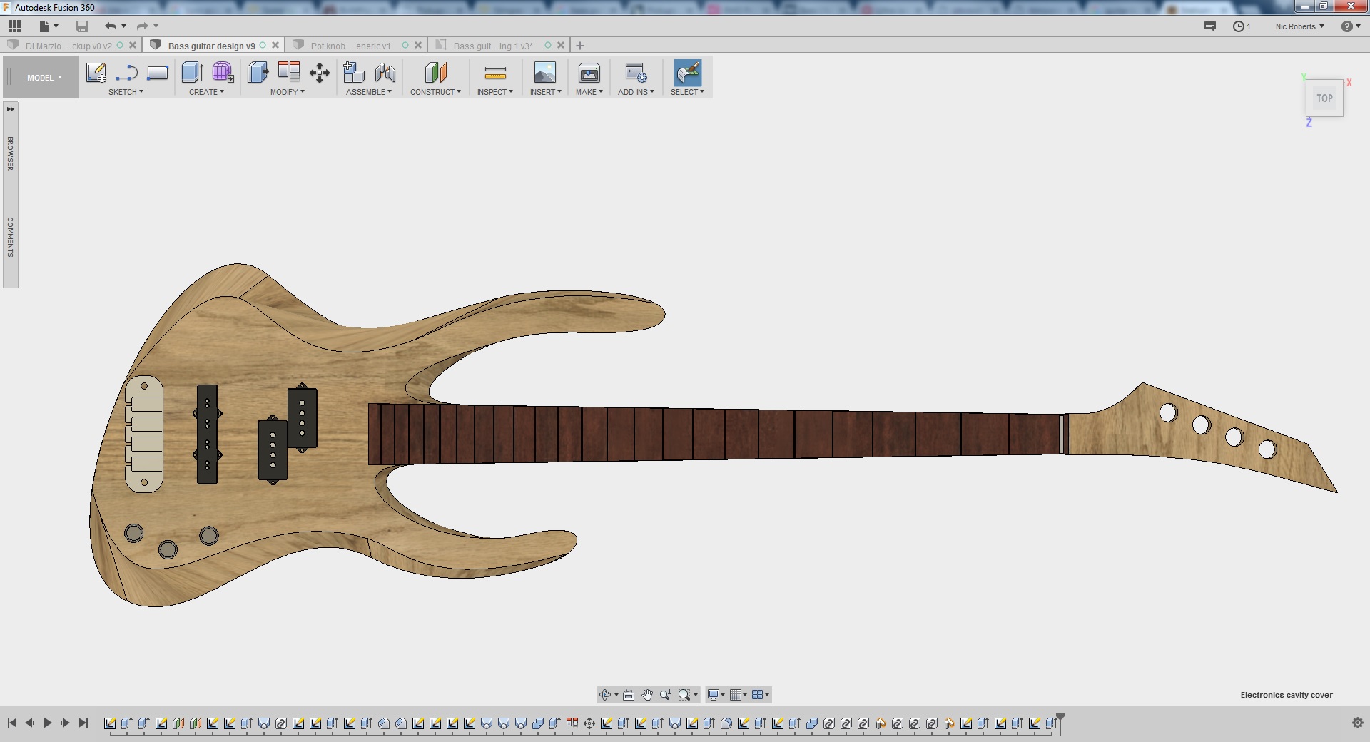

Also, I've been busy building up a CAD model to help speccing out the job (timber sizes and what not). One thing I haven't been able to find much science on is pickup placement. I've kind of eyeballed it based on other bass guitars. Does anyone have any good links to docos for pickup placement?
Thanks for that. I'll flick you a PM.

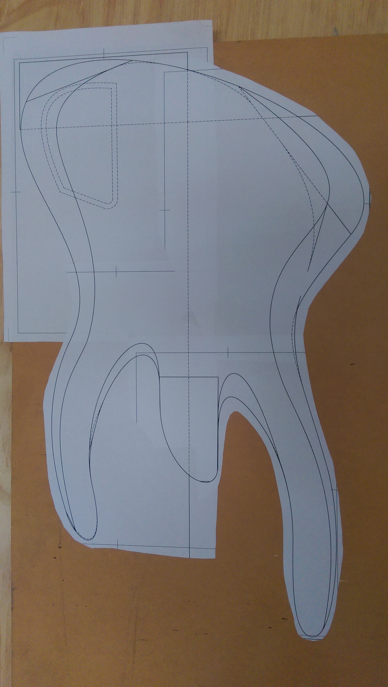

Was a bit under the weather today, so spent the day at home. In between bouts of not much I managed to order all the components for the bass and finish the CAD model.
Printed it out at full scale and stuck it on some mdf to use as a routing template for the body.
On the weekend I'll try and get the template cut out and ready to roll.
Centre line is obviously the centre line, the line full width side to side is the intonation line for the bridge, end of the scale length (proper term for this point?) The rest of the weird lines are artifacts from the chamferring on the body or from printing on A4 sheets. Ha ha.
Re: Timber supply - WA
Funky design,
Pickup placement is what you want, then you choose a pickup with the magnet strength to suit its location.
If you get stuck, send me a pm.
Run a scale through to the bridge pick the harmonic points ,that's what fender and others used.
- Posts: 146
- Location: Perth, WA
I built a PJ bass a few years ago and I went in to Kosmic sounds in Osborne Park and measured the pickup placements on both Fender Precision and Jazz basses. I'll check what the positions were when I get a chance later and let you know. Or if you have a shop nearby you could do likewise? I used a soft plastic ruler to avoid any risk of scratches or offending the staff.
Here we go:
145 mm from centre of bridge (middle saddles) to centre of Precision p'up.
71mm from bridge to centre of Jazz p'up.
I hope that helps you.

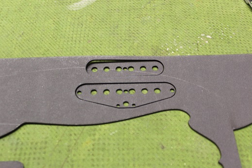

So much involved in pickups,
Here's me making a pickup, hope its informative.
http://www.mirwa.com.au/HTS_Manufacture_Pickup.html
- PUPW3.2.JPG (85.73 KiB) Viewed 34982 times
I like that Steve. And as I'm needing a pickup it is food for thought. As I don't have a magnetic source at home, would making the poles by inserting a neodymium magnet into a mild or stainless steel shank work?
If the stainless is magnetic stainless to start with, then yes.

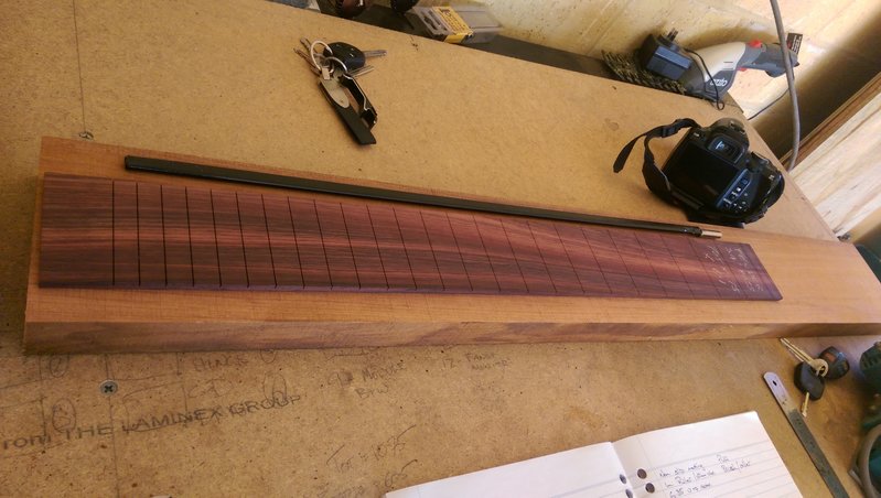

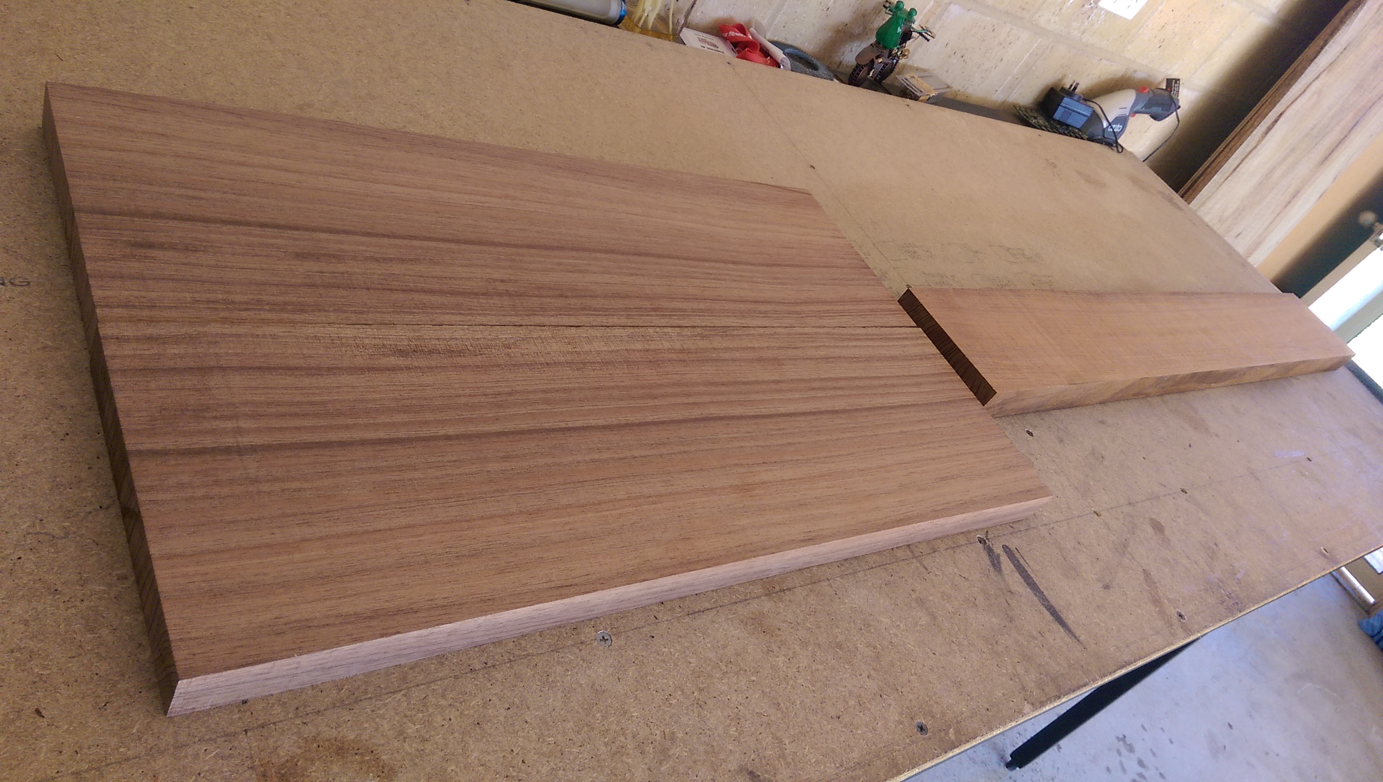

Whoo hoo! New bass guitar;
* some assembly required
Thanks for the help with everything so far.
I'll keep this thread as a bit of a build thread because I'm sure I'll have more questions along the way.
What are the woods you went with. The body blank looks a tad thin?
