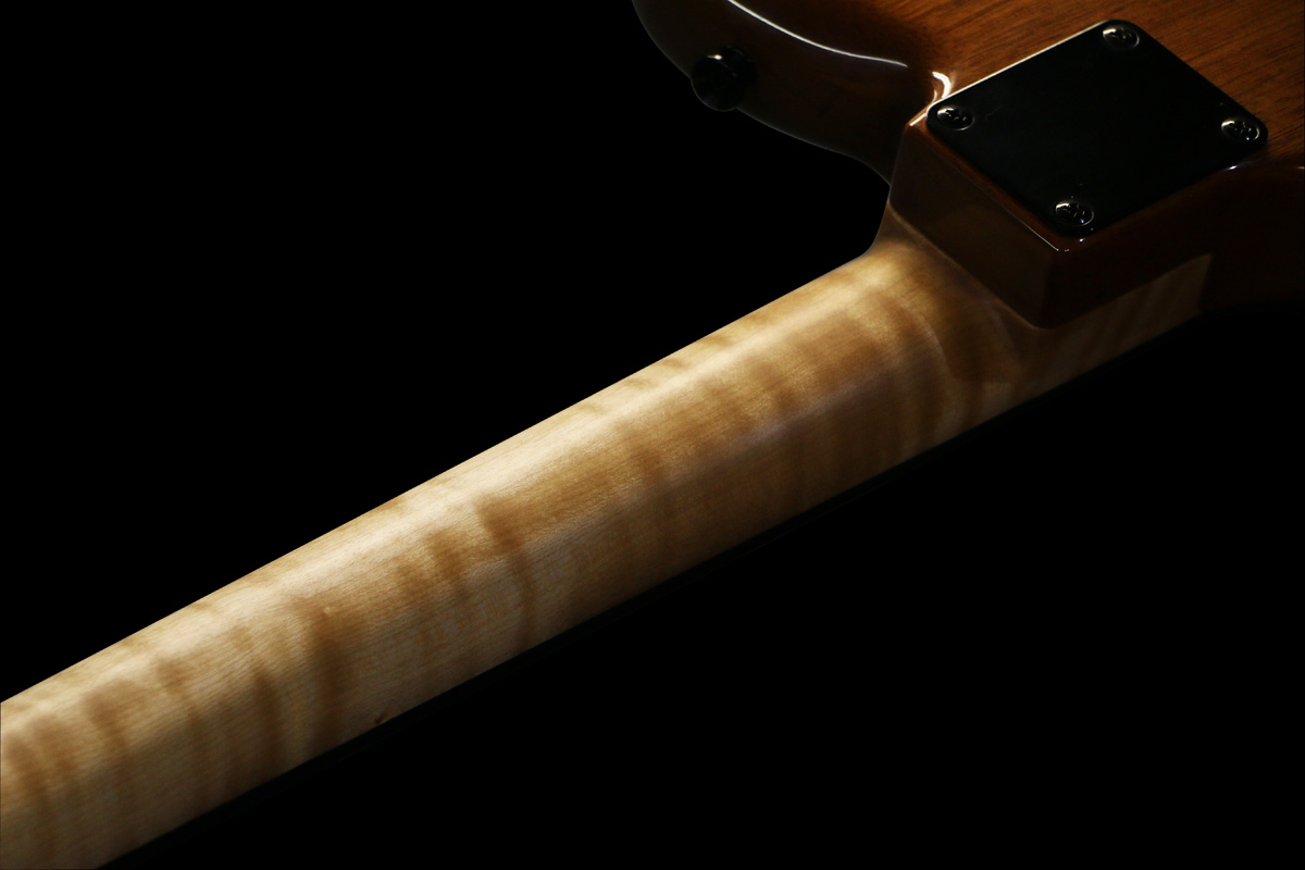

Yes Trevor, I have several times and I'm not the only luthier I know of that has.Trevor Gore wrote: ↑Sun Dec 03, 2017 11:37 amHas anyone tried Organoil Hard Burnishing Oil on a guitar? I've used it on furniture (seems OK, dries hard fairly quickly) but not on a guitar. A light first coat will likely prevent too much penetration.
I've used it for necks, where the customer has requested an oil finish for the feel. It provides good protection and makes for a lovely satin touch, while being easy to touch up over time. It does not however, build to a higher gloss like the Tru-Oil, being more matt or satin.
To the best of my knowledge (don't count on it), it is predominantly a mix of tung, citrus and eucalyptus, with some wood turps and perhaps other minor ingredients. It does penetrate, being quite thin and sets hard - I've not had an application go sticky again in high temps or humidity like some oils do. You can "burnish" it to a higher gloss level if desired, however, I've done some sample testing on that and never liked the look. It was kind of strange when you turned it in the light it would go from looking glossy to matt...
I also use it as my first coat on fretboards too. A light coat to penetrate and protect the board longer term. When dry, I then use a citrus oil as a final coat to the fretboard and buff it out. That's it.
I quite like it, but that's just my personal experience and may change if I find another I like better! In the mean time, it ticks the boxes when I need an oil to use.
Here's an example:
