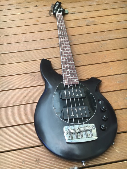

This one was finished yesterday, first time I have ever painted this stuff, huge learning curve, it’s actually a pigment you add to the clear coats, problem is it sprays like an underbody car spray, so really gritty, if you sand the pigments in the clear smooth, it stays permanently Grey, so you have to apply copious amounts of clear and try to level the surface flat using just the clear coats, huge learning curve....
First photo, cold under 30 degrees body

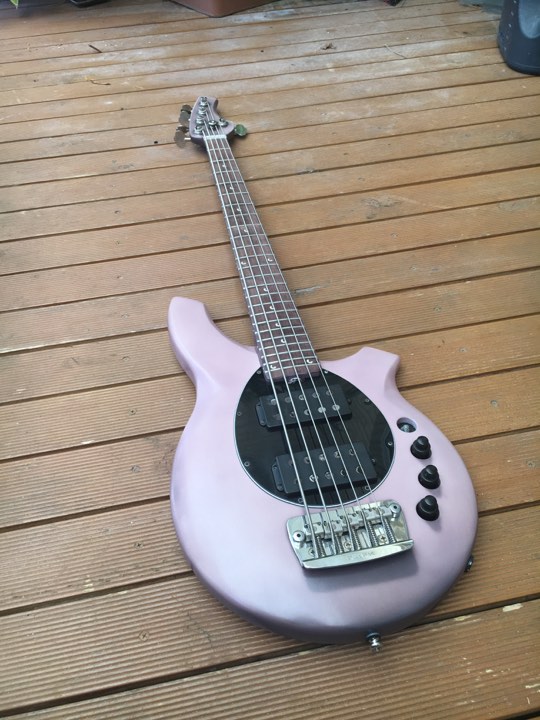

Second photo, add some warmth to it like out in the sun or your hands and it goes white
