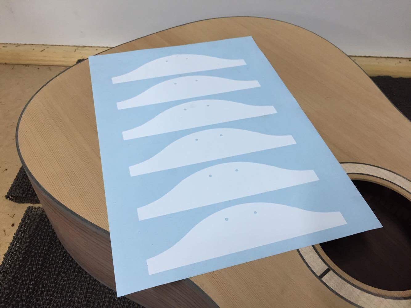

What Steve said, however to take it a step further, rather than just mask, I have stickers I make up with two holes which help me with alignment.
I position the bridge pre paint which has the two holes in it and then I drill the holes into the top ready for post paint mounting.
After paint I razor blade the sticker silhouette which is 2mm smaller than the bridge silhouette, peel it off, then the holes allow me to mount the bridge post paint without needing to align everything up again.
