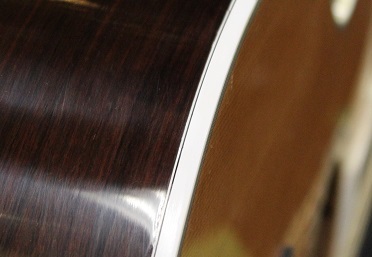

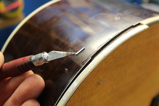

Finished writing this one up, basically a walk through on how I replace a piece of missing black and white binding on a Martin
The whole lot can also be done by hand, no machines, just more scraping as shown at the end when tweaking the thickness
http://www.mirwa.com.au/HTS_Binding_Repair.html
The paintwork finish was limited to 1cm either side of the repair, could have gone to town on the finish it was in such a tragic condition.
