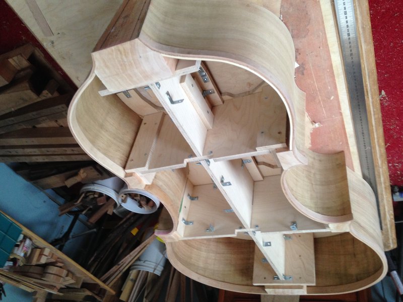

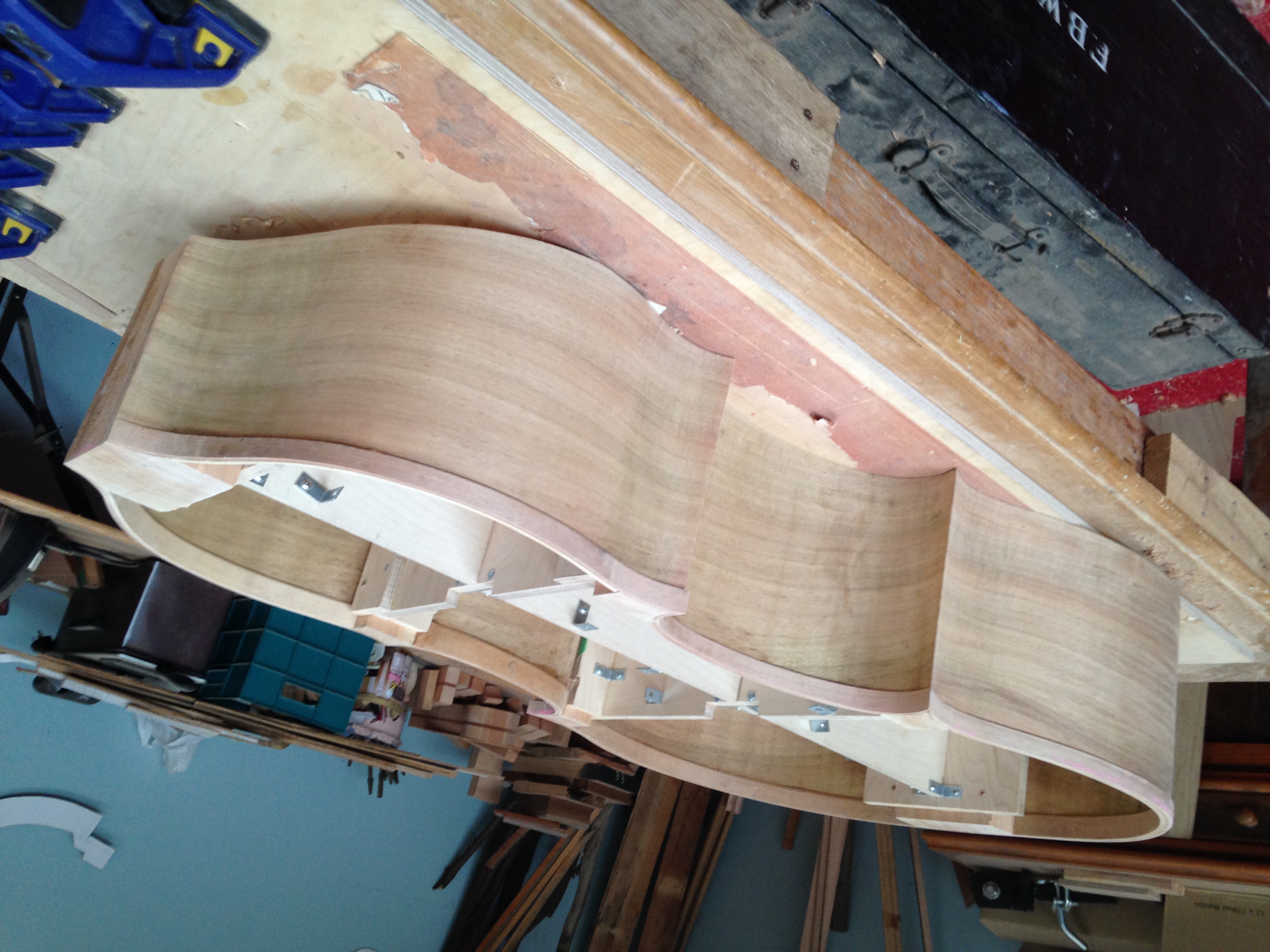

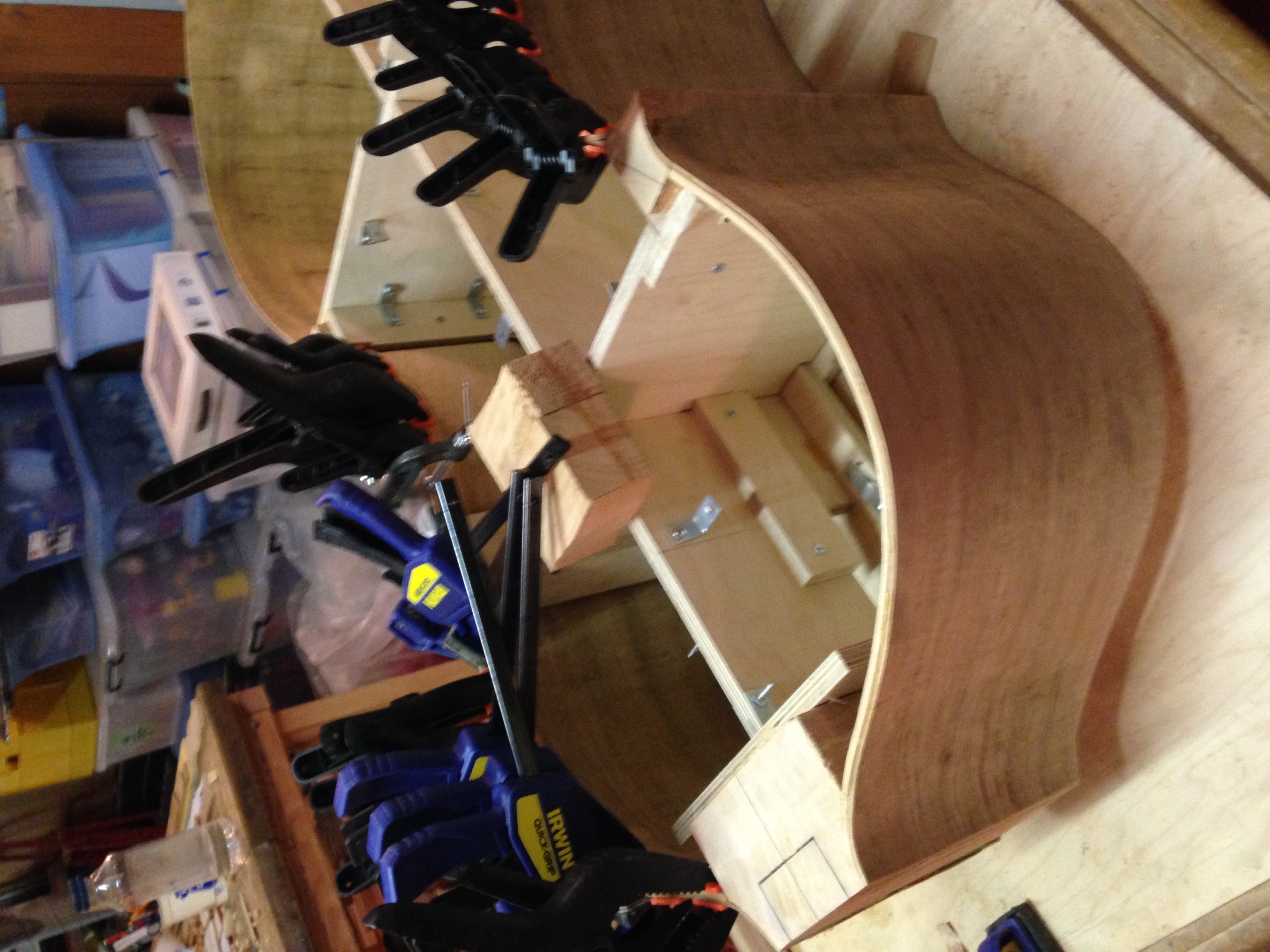

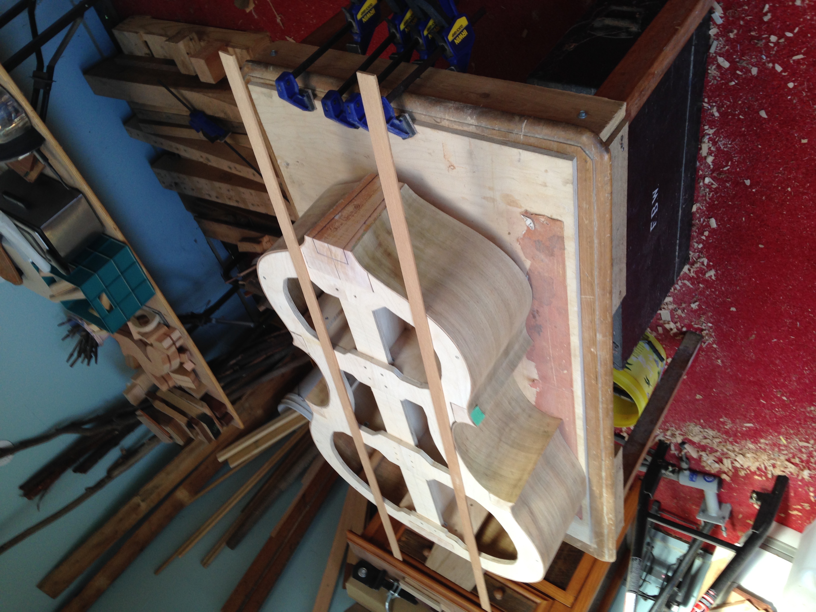

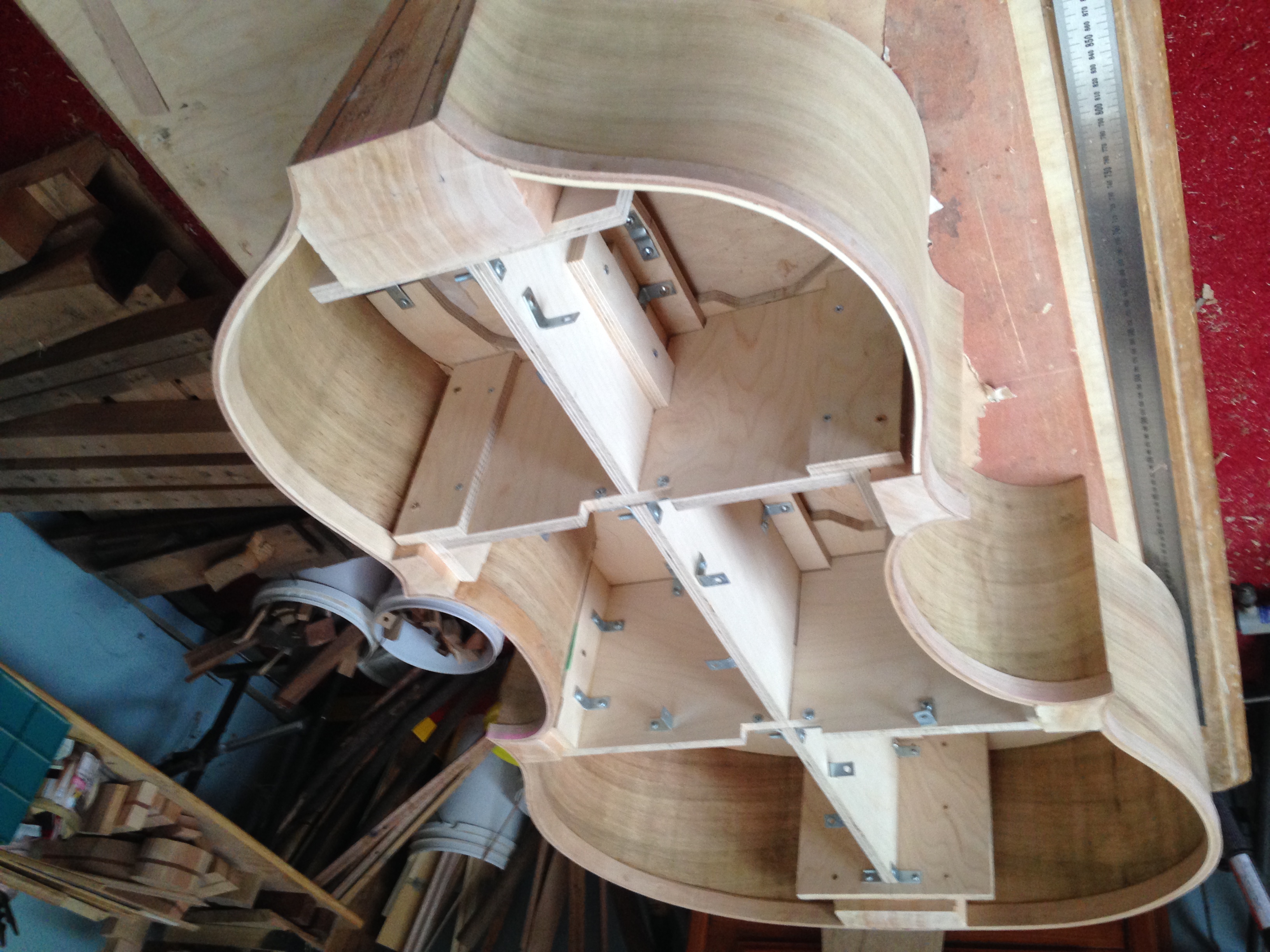

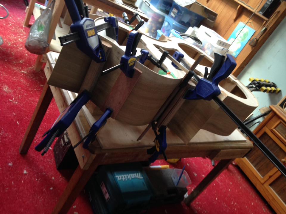

Progress Photos. I got the last rib glued in and clamped it today. Bastard of a job to self teach, but I know how to do it now. Also got the boards for the belly planed and joined. Now just waiting for glue to dry.

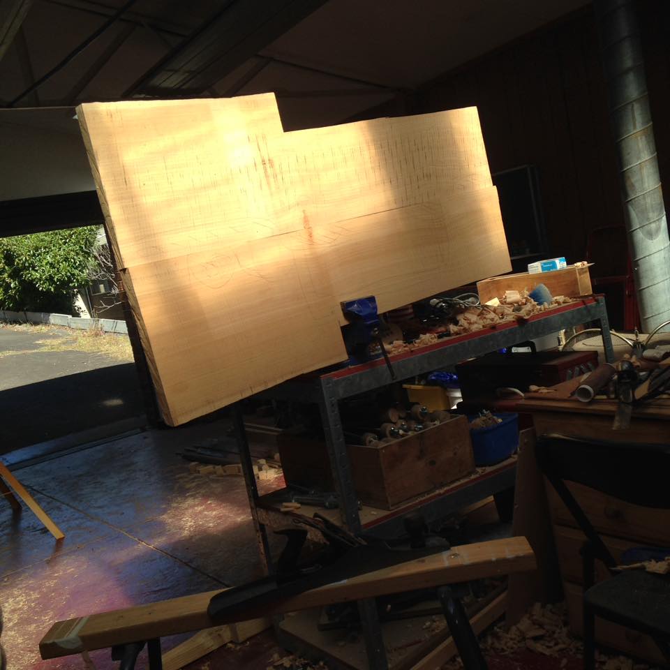

Re: Double Bass Build

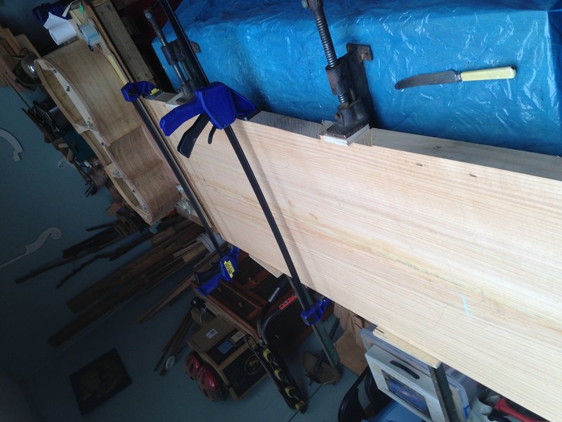

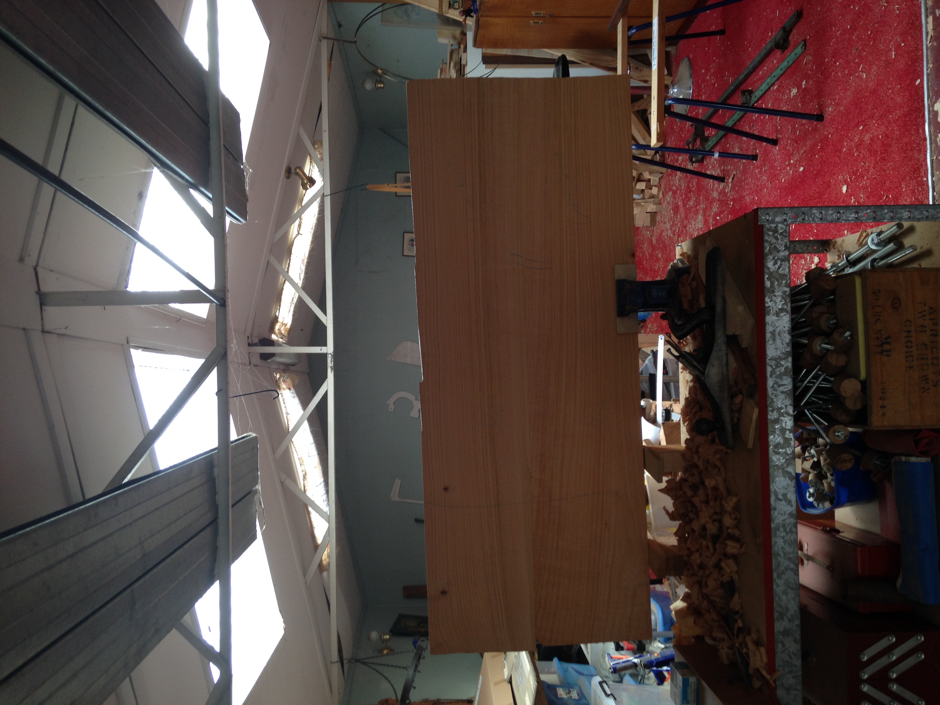

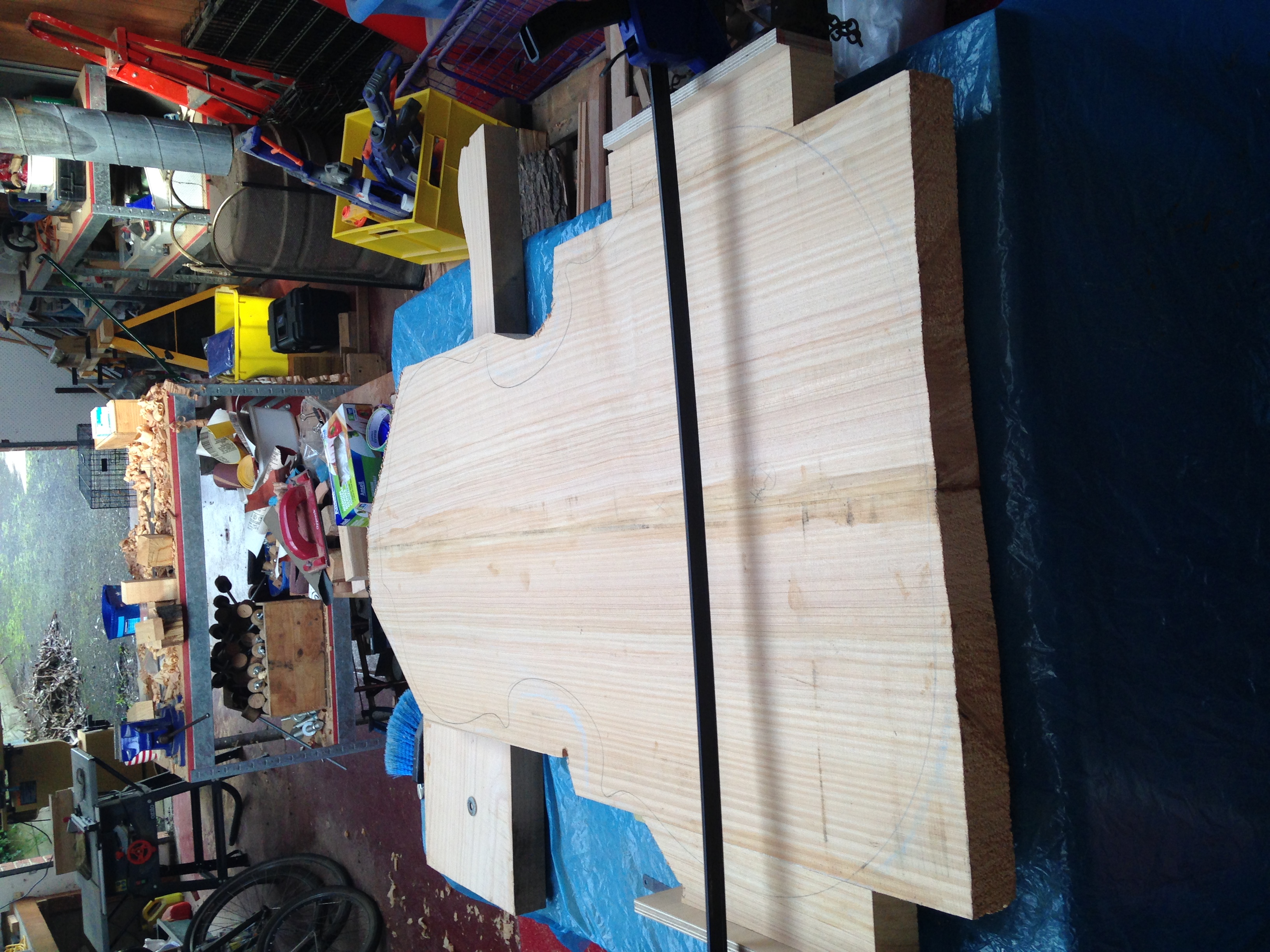

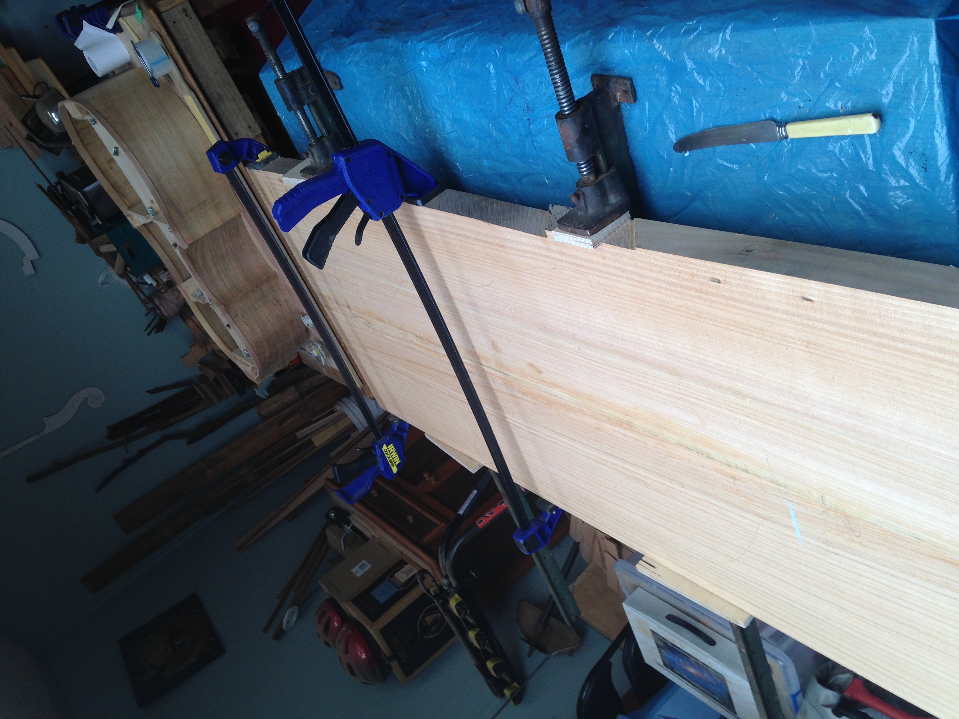

Been a while since I posted. The Macrocarpa boards for the soundboard didn't work out because they had two
large unstable knots in critical places. Chalking that up to experience.
So I'm looking for new double bass sized boards to use for the soundboard. No luck so far, but I'm wondering about using old growth close grained douglas fir if I can find clear cut boards with no knots or splits, etc, that are big enough for a double bass soundboard.
Otherwise maybe Hoop Pine if I can find some that's big enough. I've wondered about California Redwood too,
but maybe it is too soft for a double bass? Also Western Red Cedar, which is also soft, but which I know has been used successfully by other double bass builders.

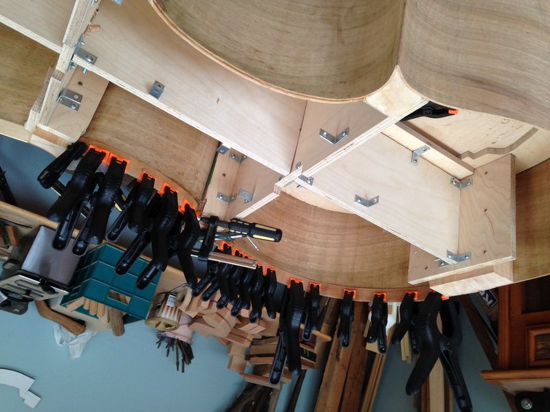

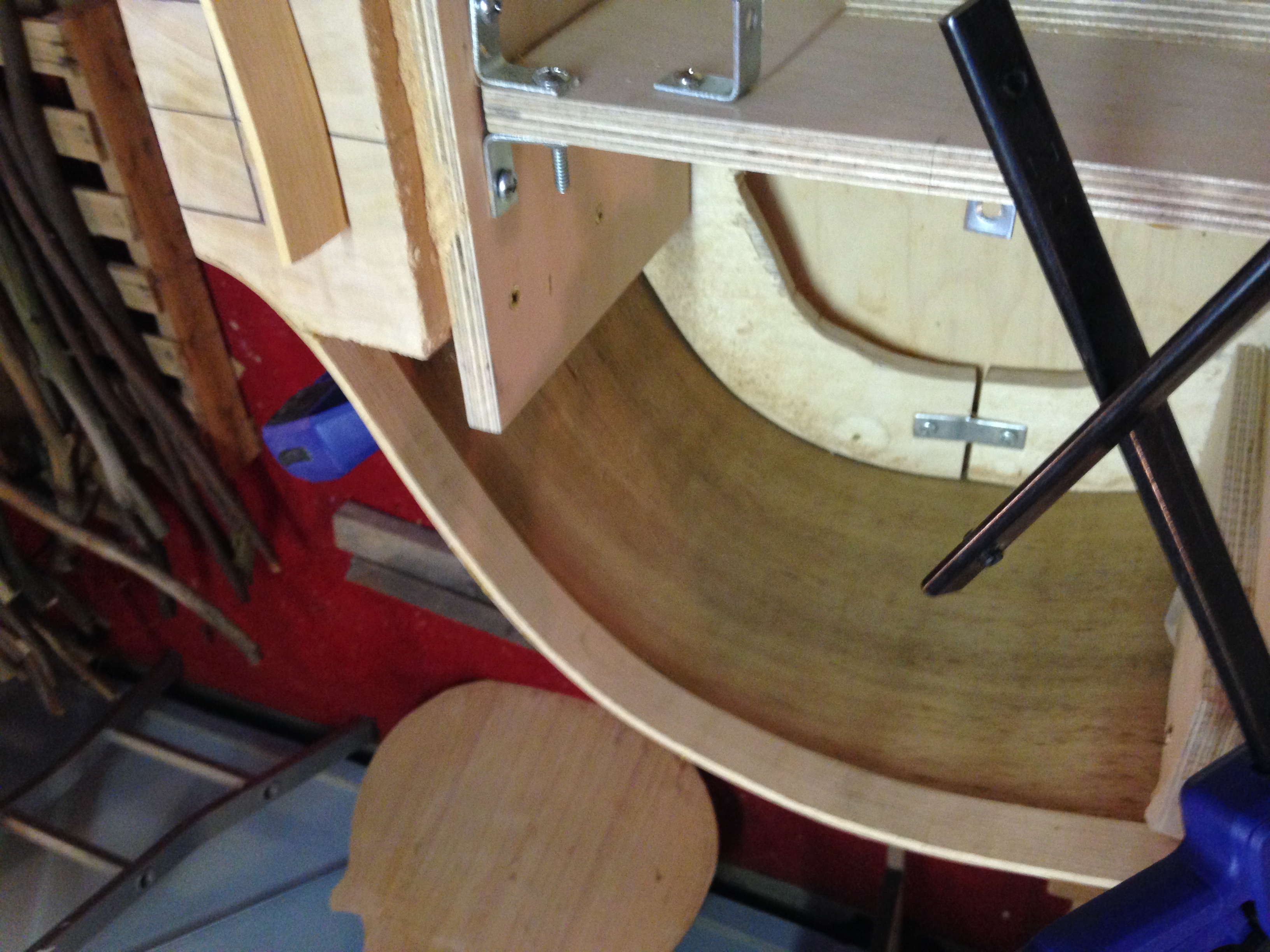

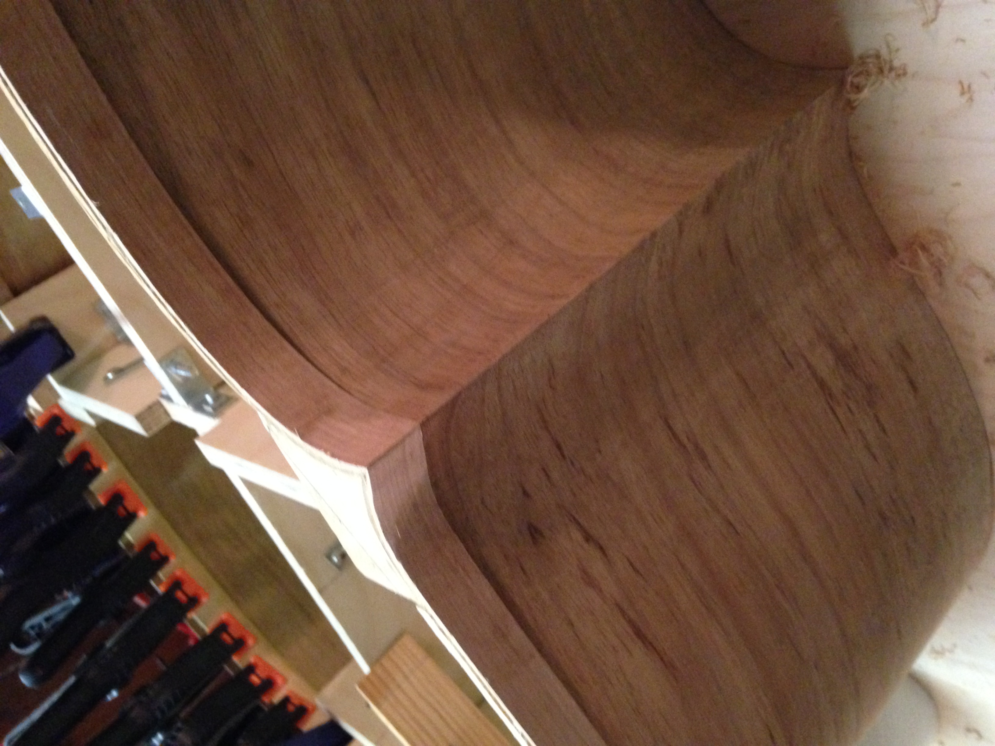

In the meantime, I've bent and glued in the first set of internal and external linings. The internal linings are cut from old quartersawn Kauri floorboards.
The external linings are cut from old quartersawn Tas Oak floorboards from the stage area of a local community hall that were offered up as 'firewood' when the hall was renovated.

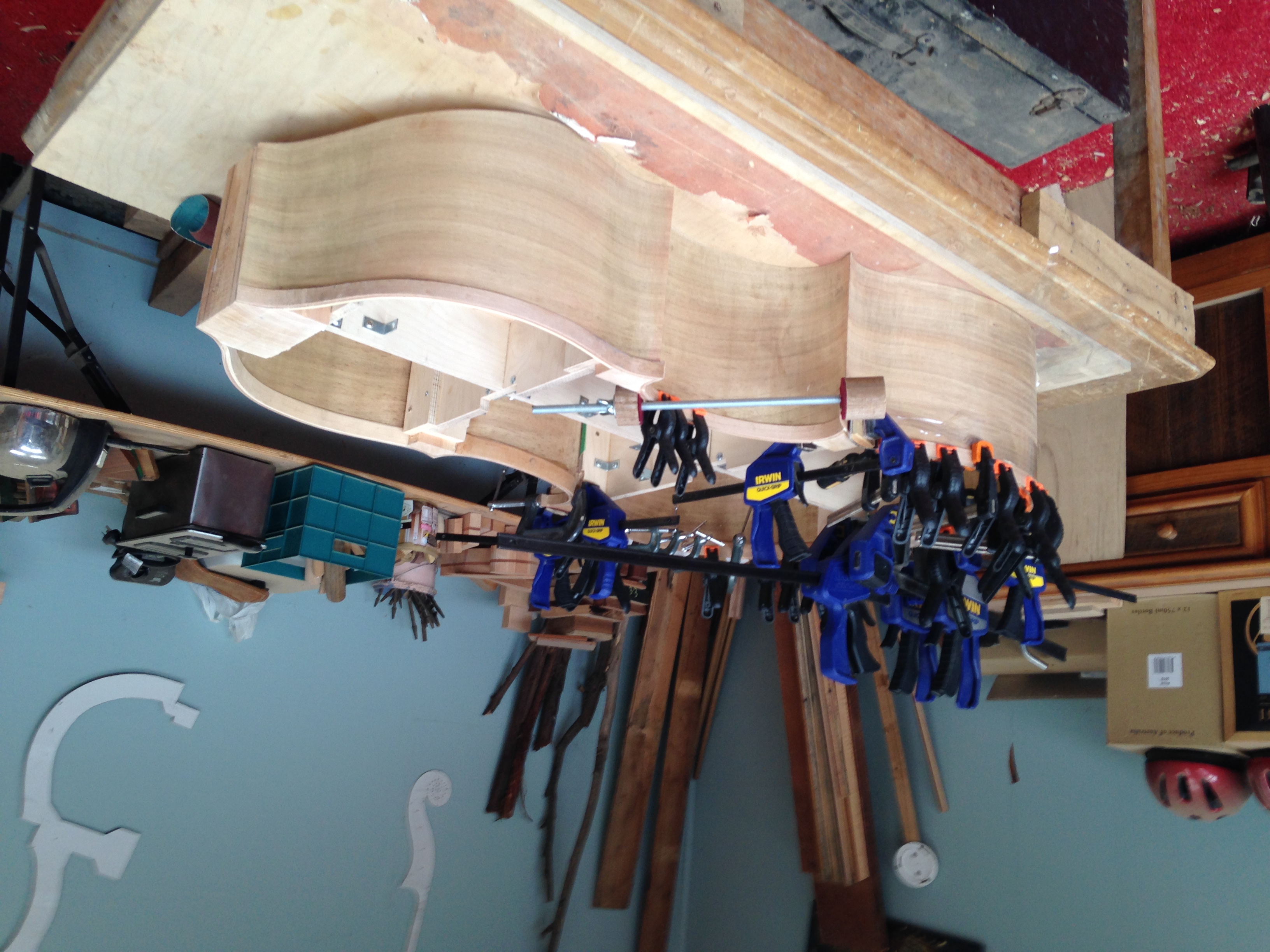

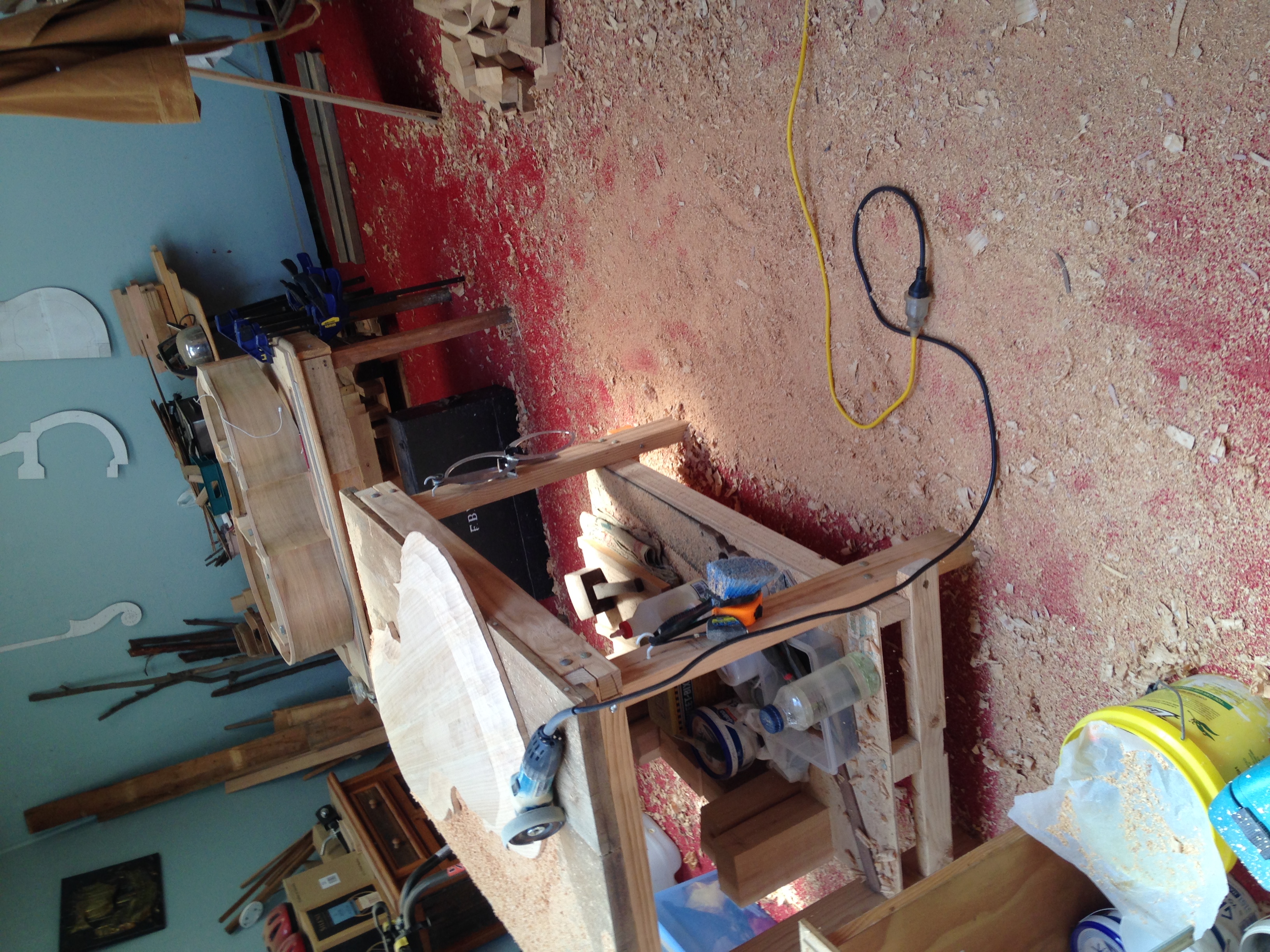

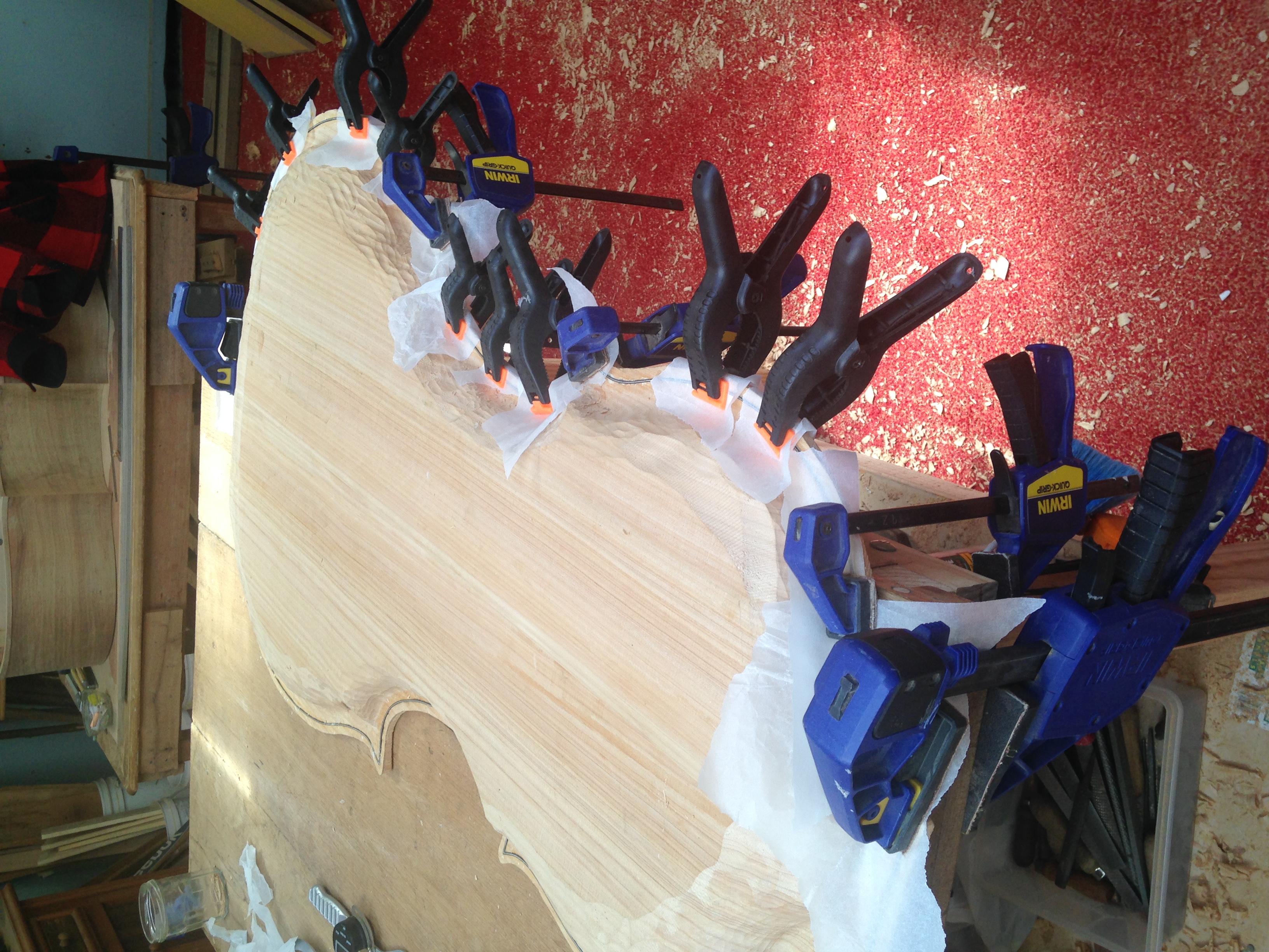

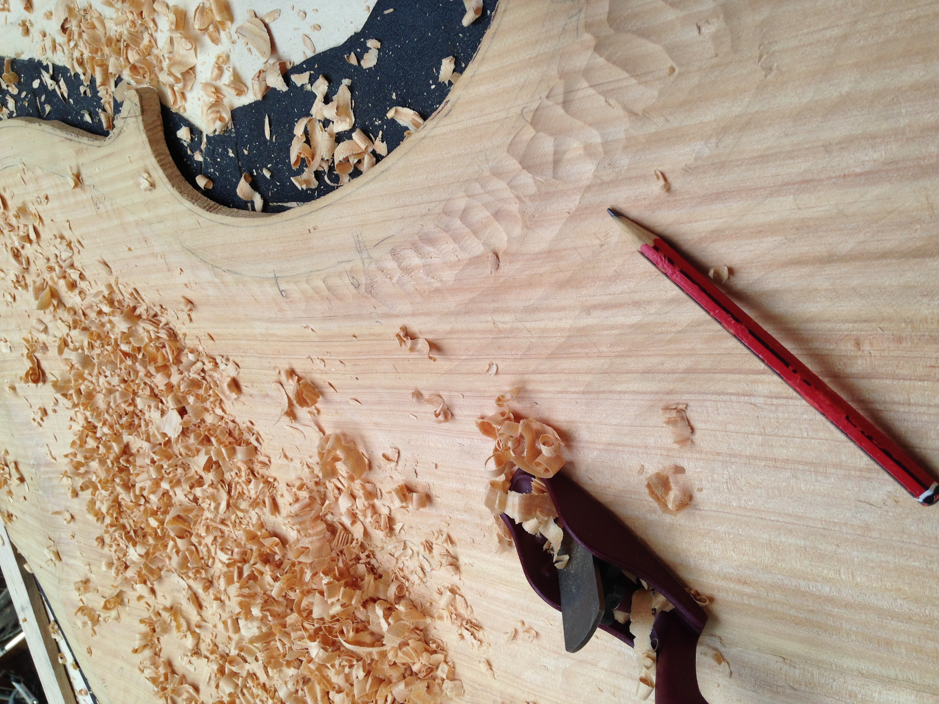

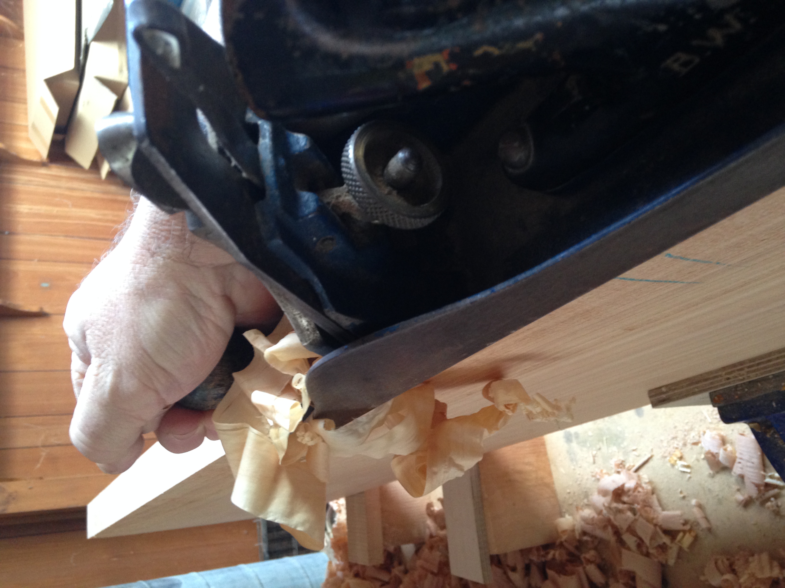

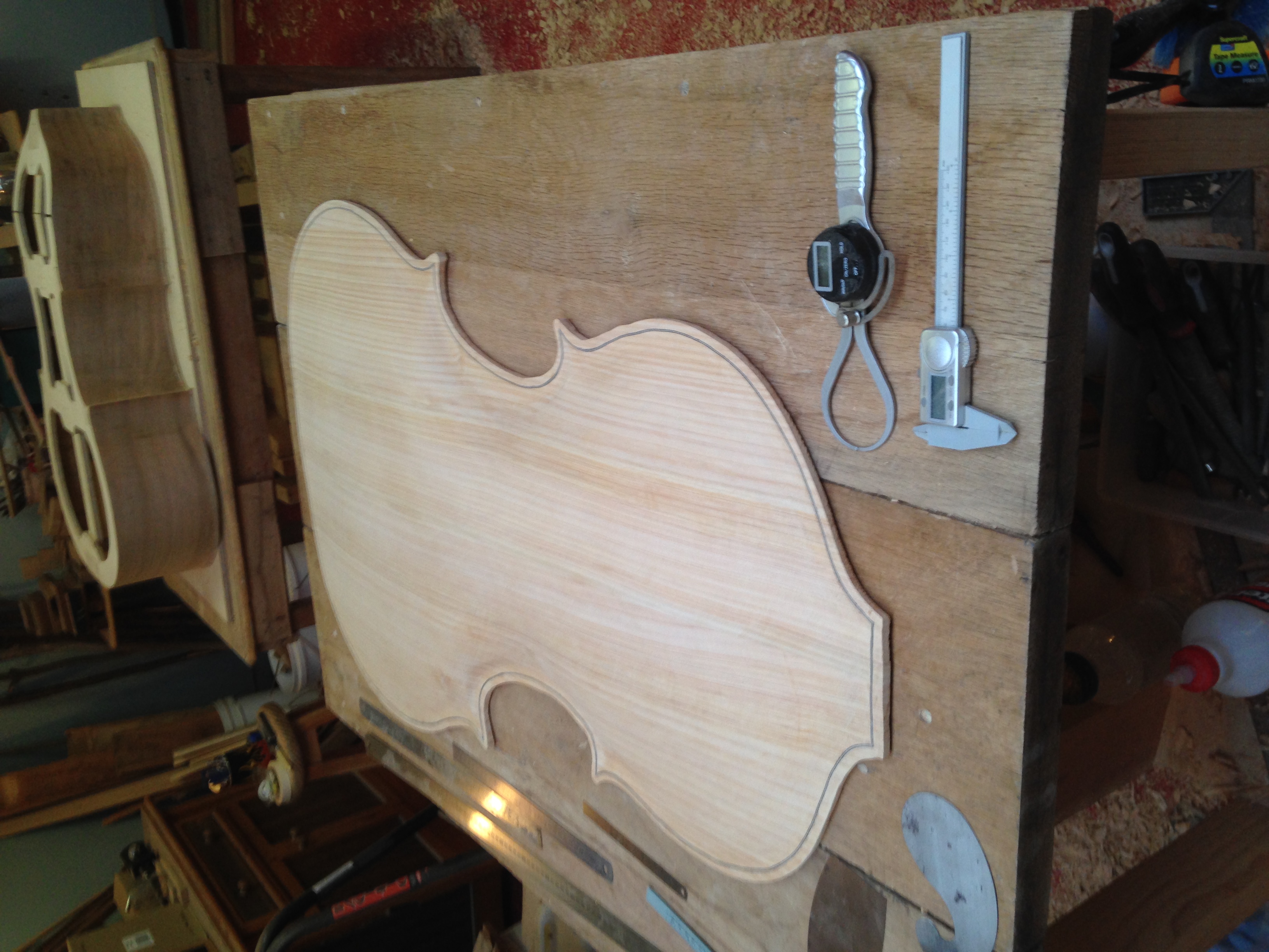

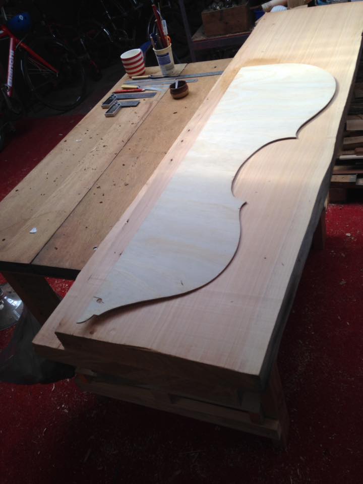

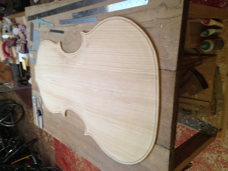

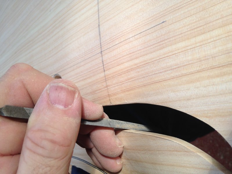

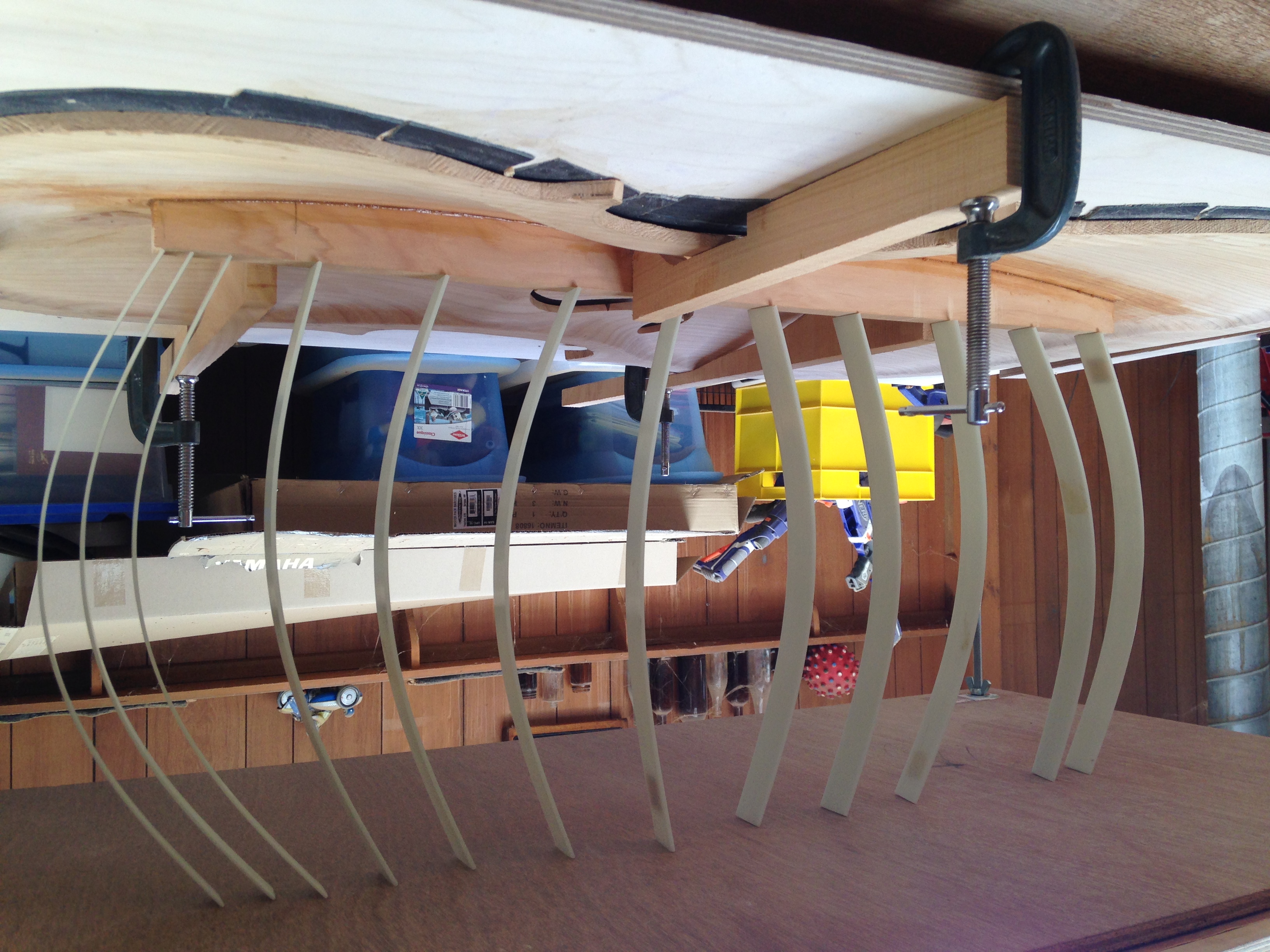

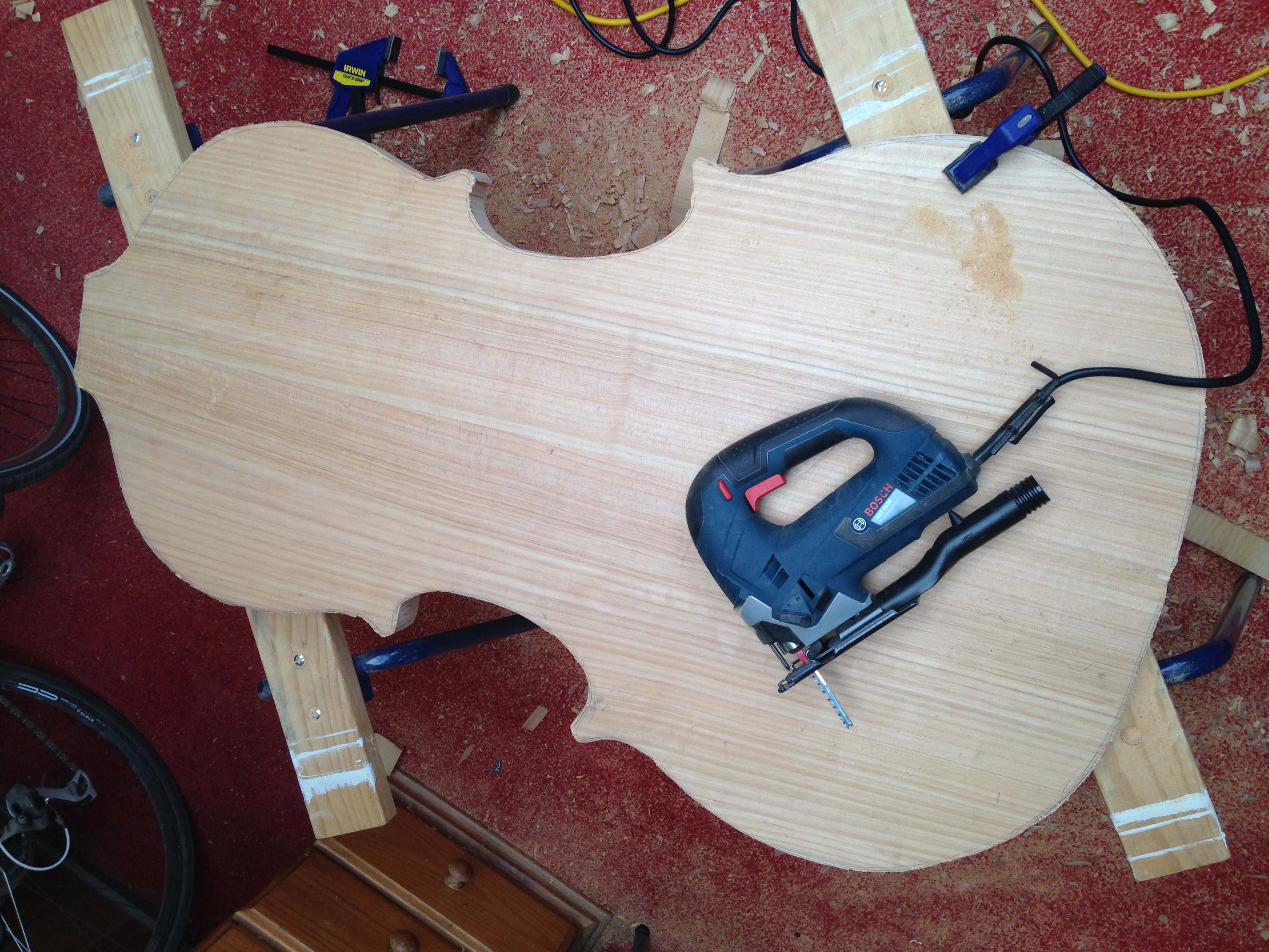

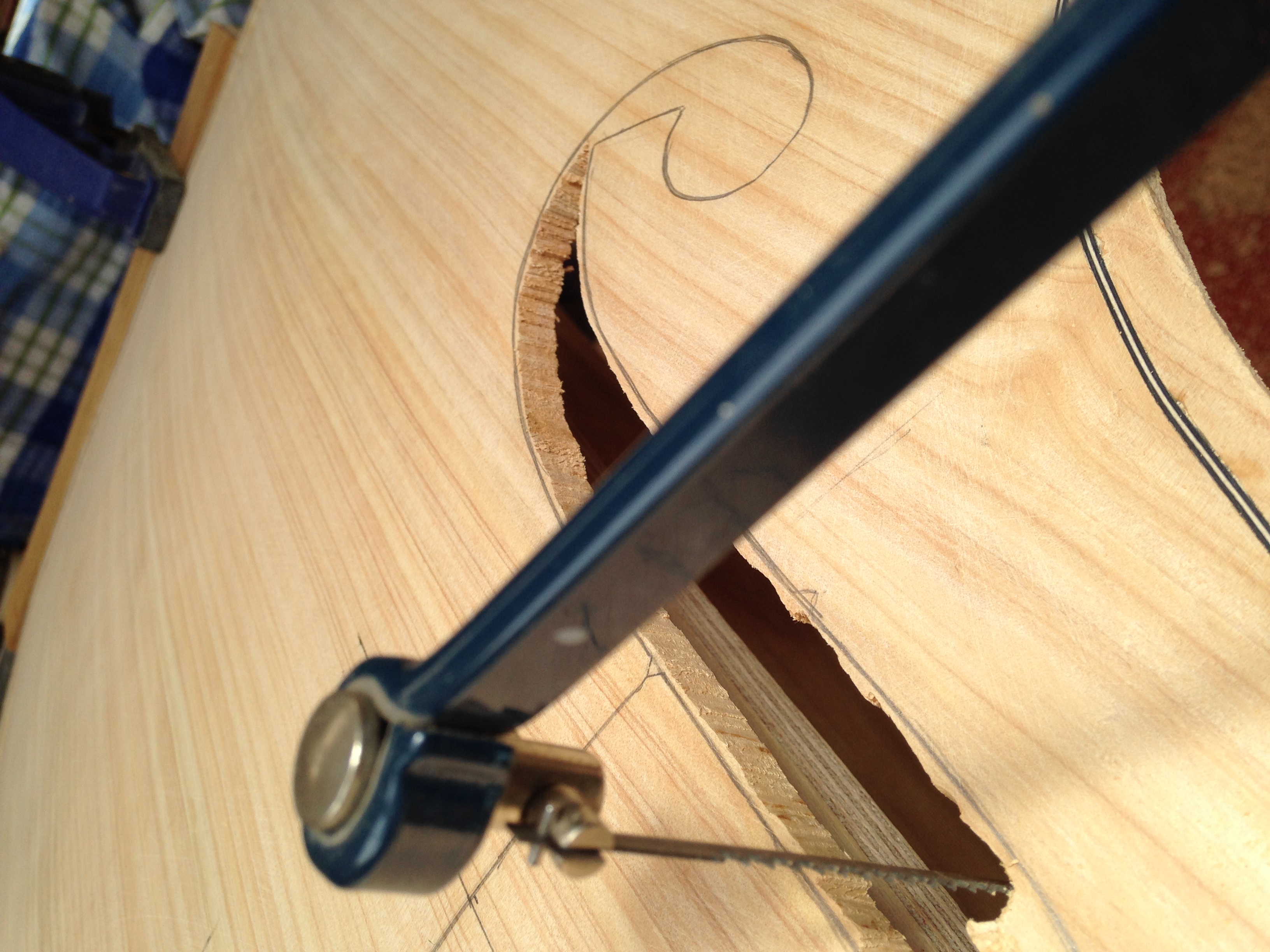

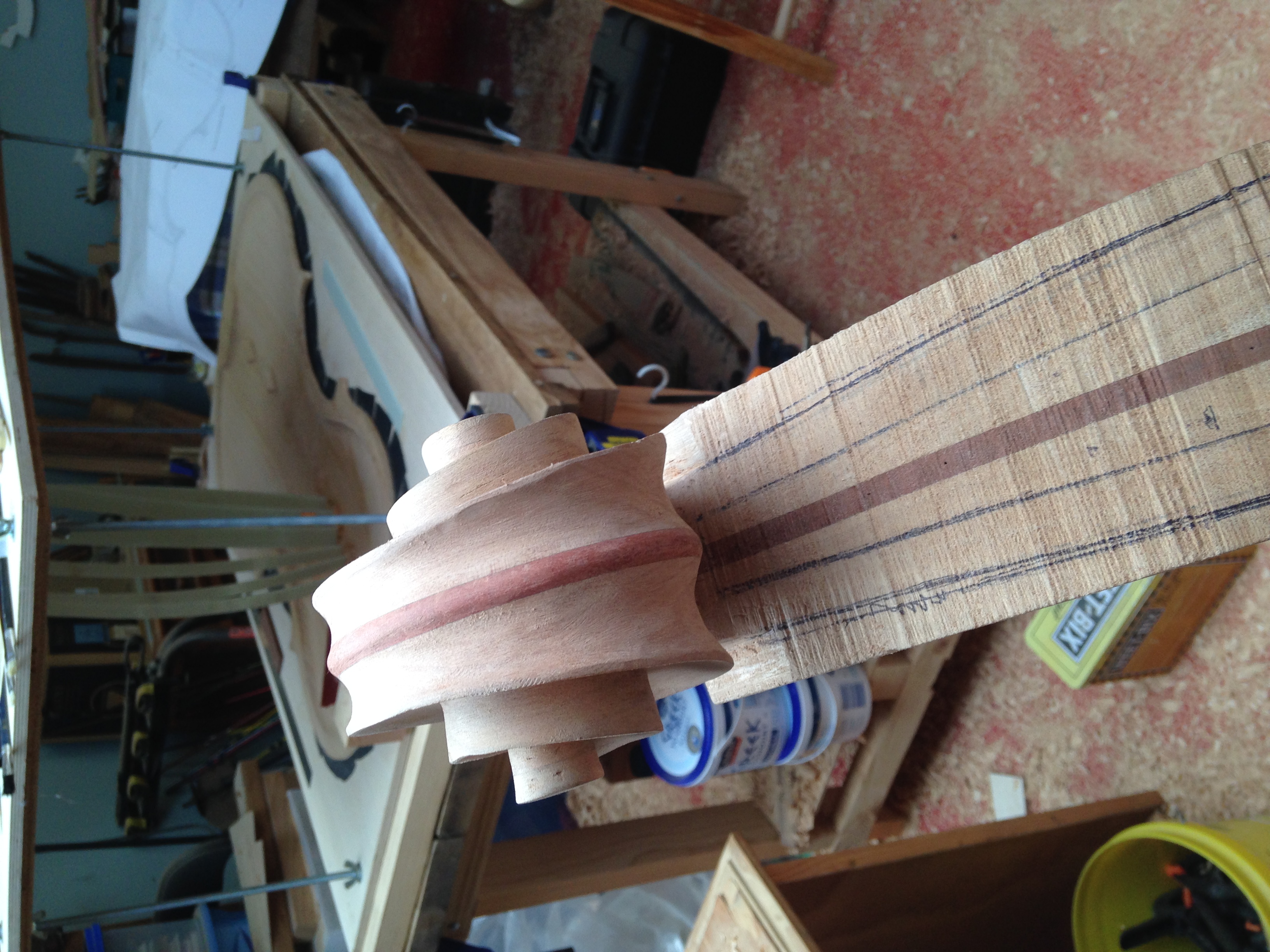

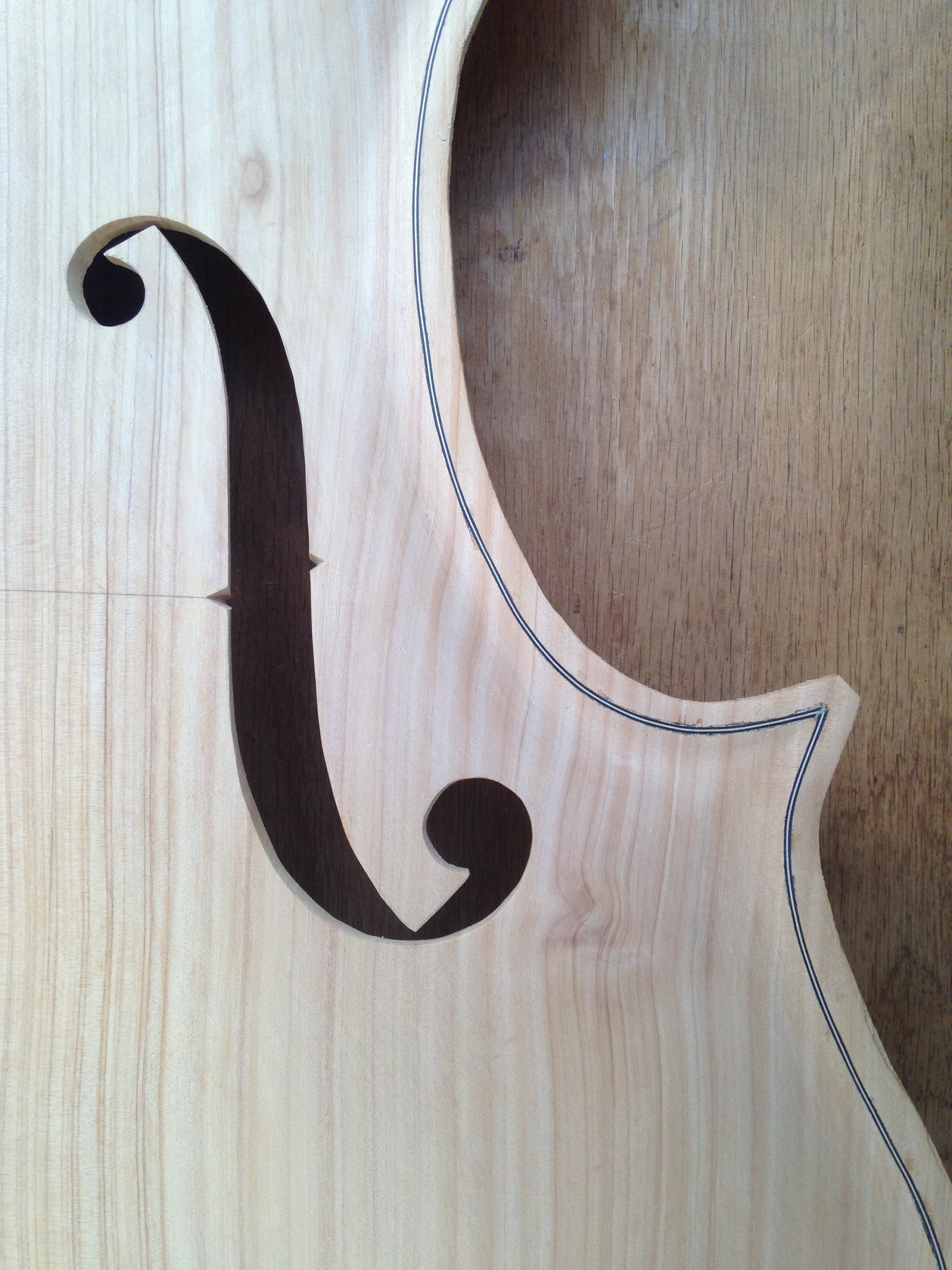

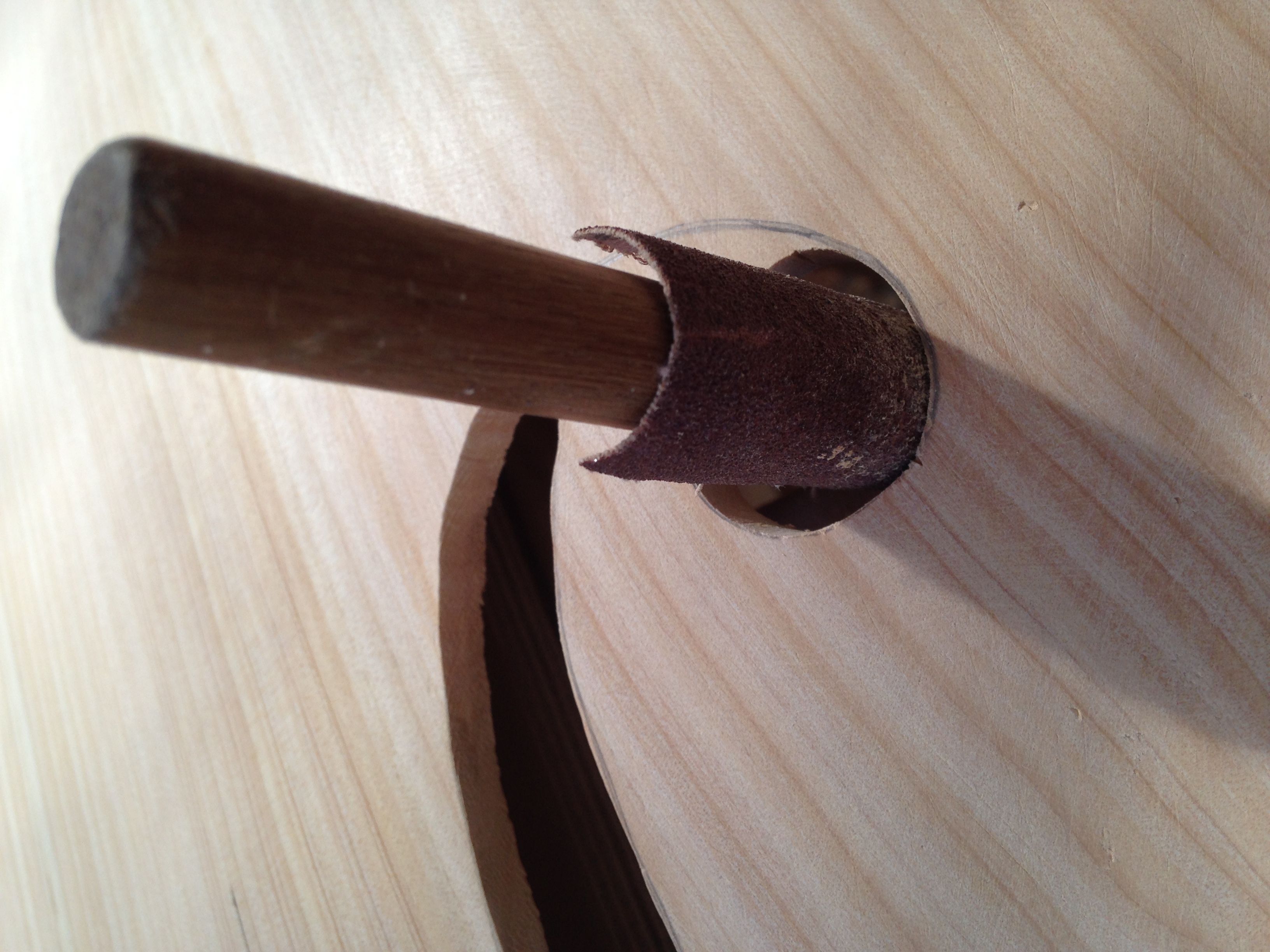

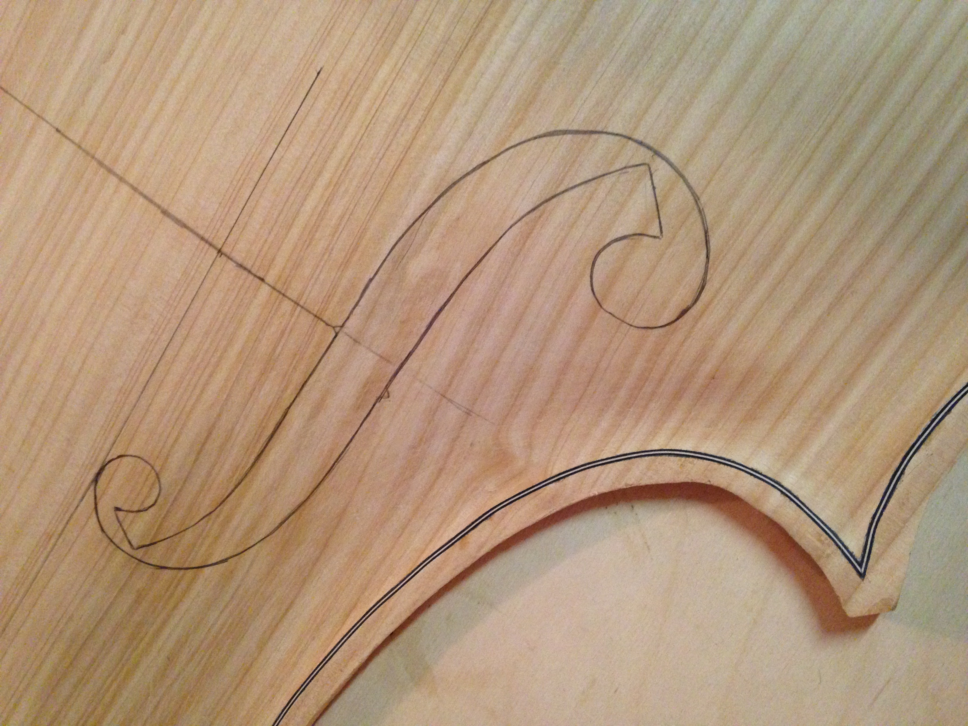

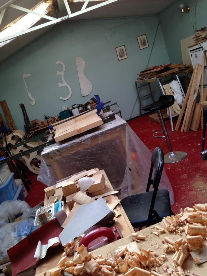

I haven't posted in a while, but the build is slowly progressing. Here's a few progress photos.
I do like how you have approached the build, with inner cross supports for the build and so forth, extremely neat.
Will be impressive when finished.
- lamanoditrento
- Posts: 617
The proportions boggle my mind. Also really interesting that you add the purfling lines before you carve the rest.
- Posts: 775
Sounds like you got the bug, brother! Or will soon have it! So buy good tools, one step at a time as you build. One can always sell good tools and pick good ones up second hand, if they have not been worn out by tradies! Go for home handymen who have moved on for 2nd hand is my opinion. I have never gone wrong with Makita, they now have a soft start trimmer, but you need the grunt, so look around for a quality soft start powerful trimmer. The next expense will be router bits then re sharpening costs so buy good quality bits as well. A word of warning, practice runs first, and make sure the collet chuck has no debris in it each time you load a new bit! All the how to stuff is on you tube if you look these days...Do you use Japanese back saws? Well worth the investment as well, they cut on the pull stroke and cut fine and straight as well as having replaceable blades. Might solve the problem without a router investment. Jigs for them are easy to knock up if you read about how to use them and practice first.
Cheers, Ross
Cheers, Ross

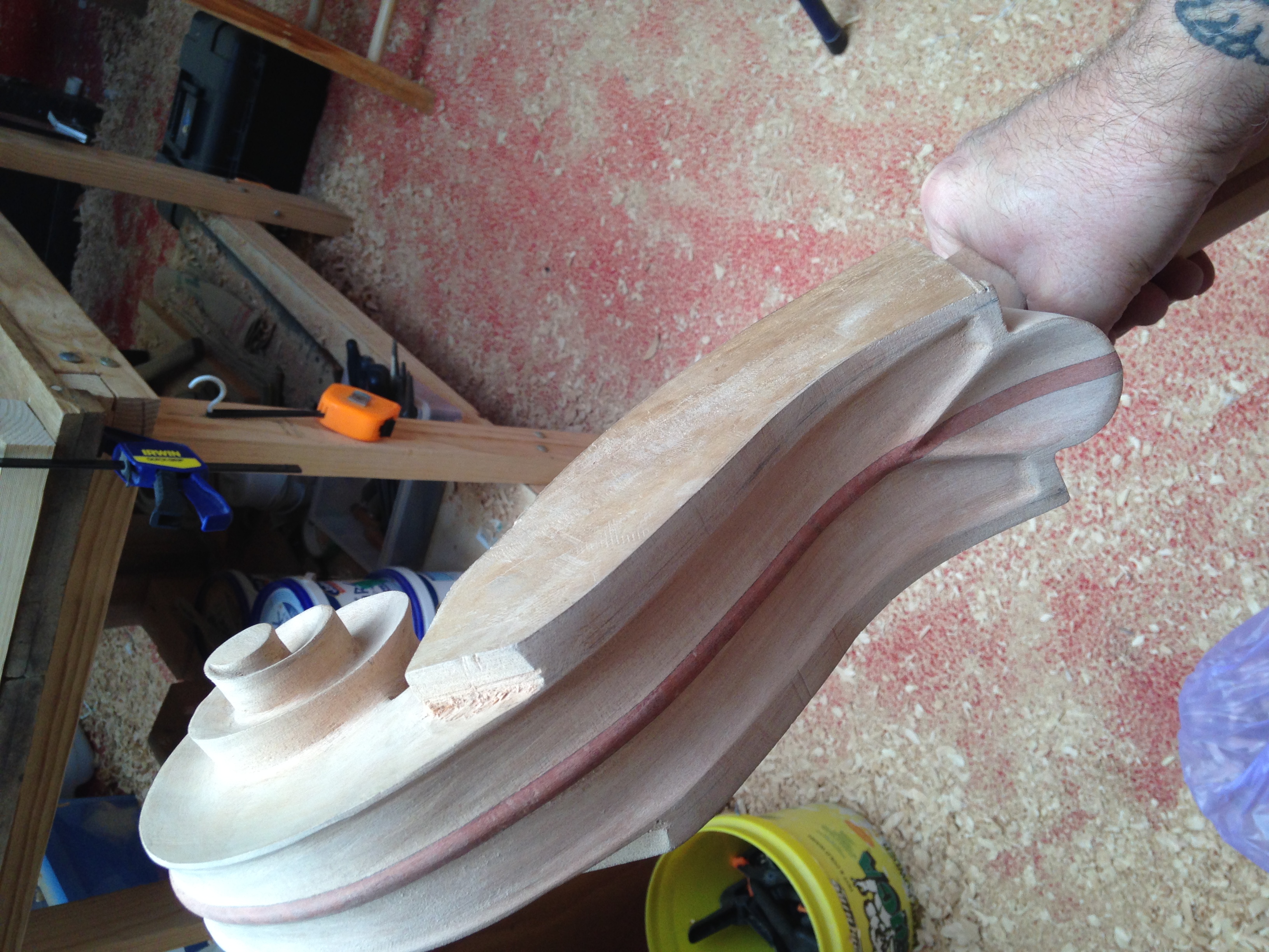

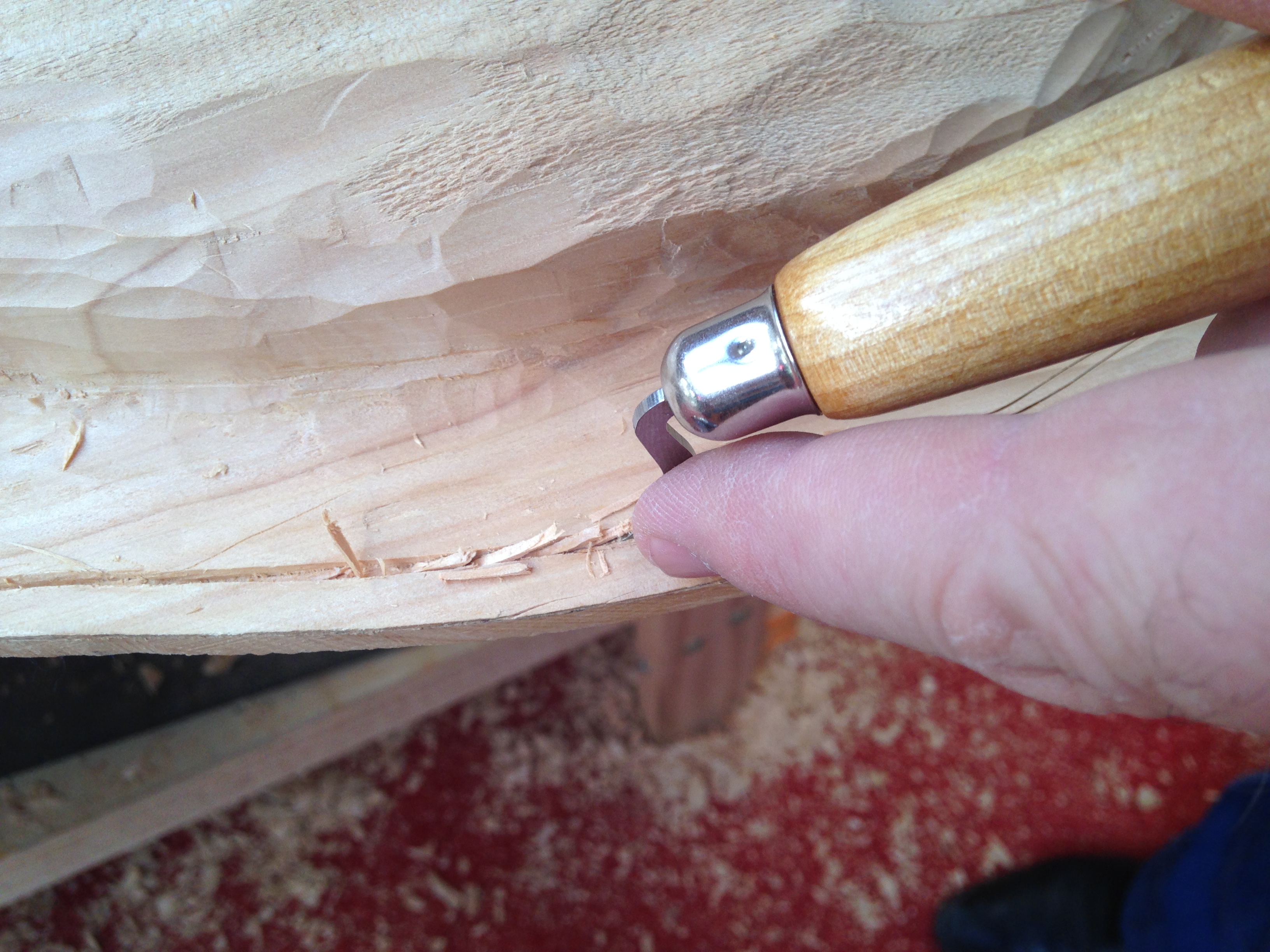

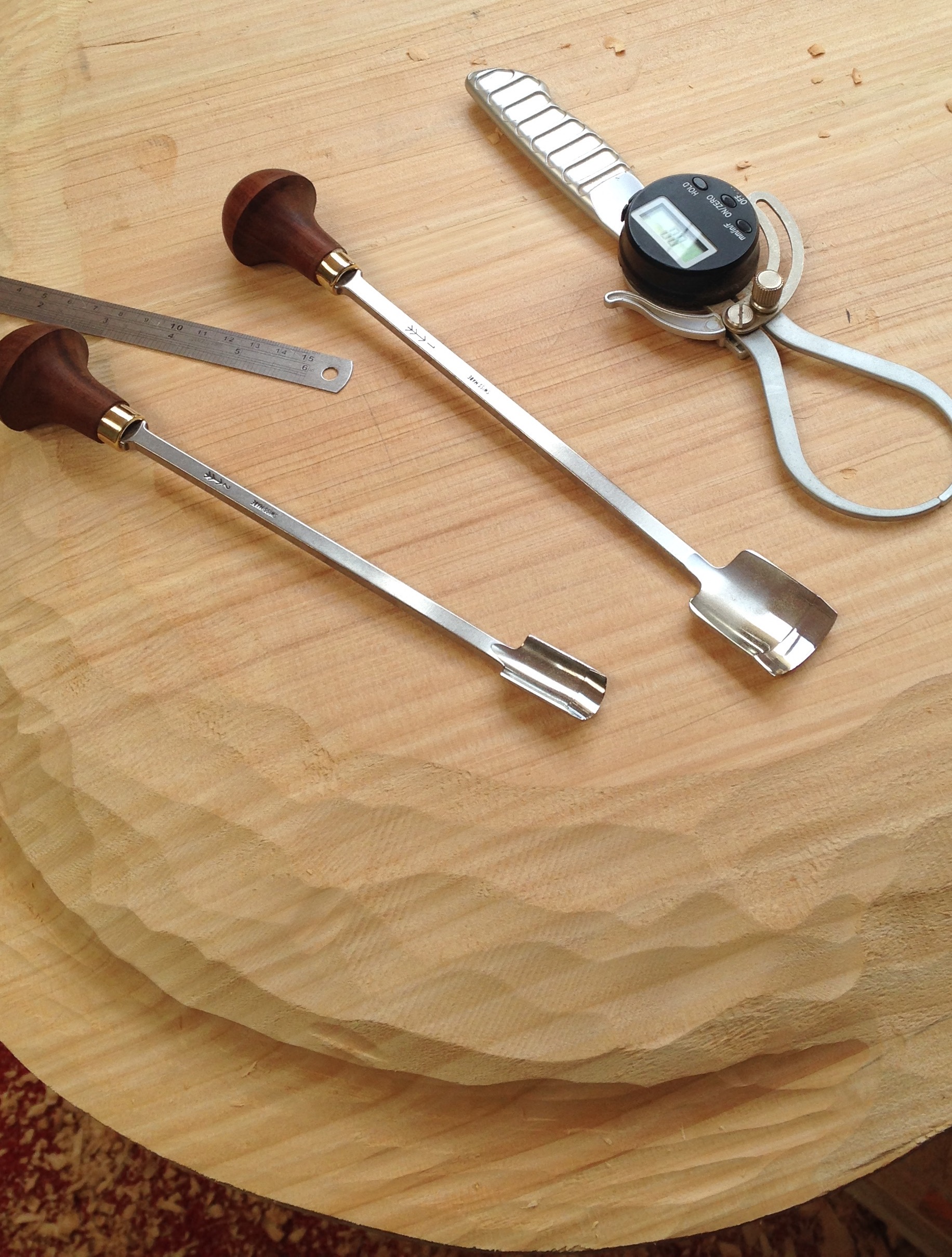

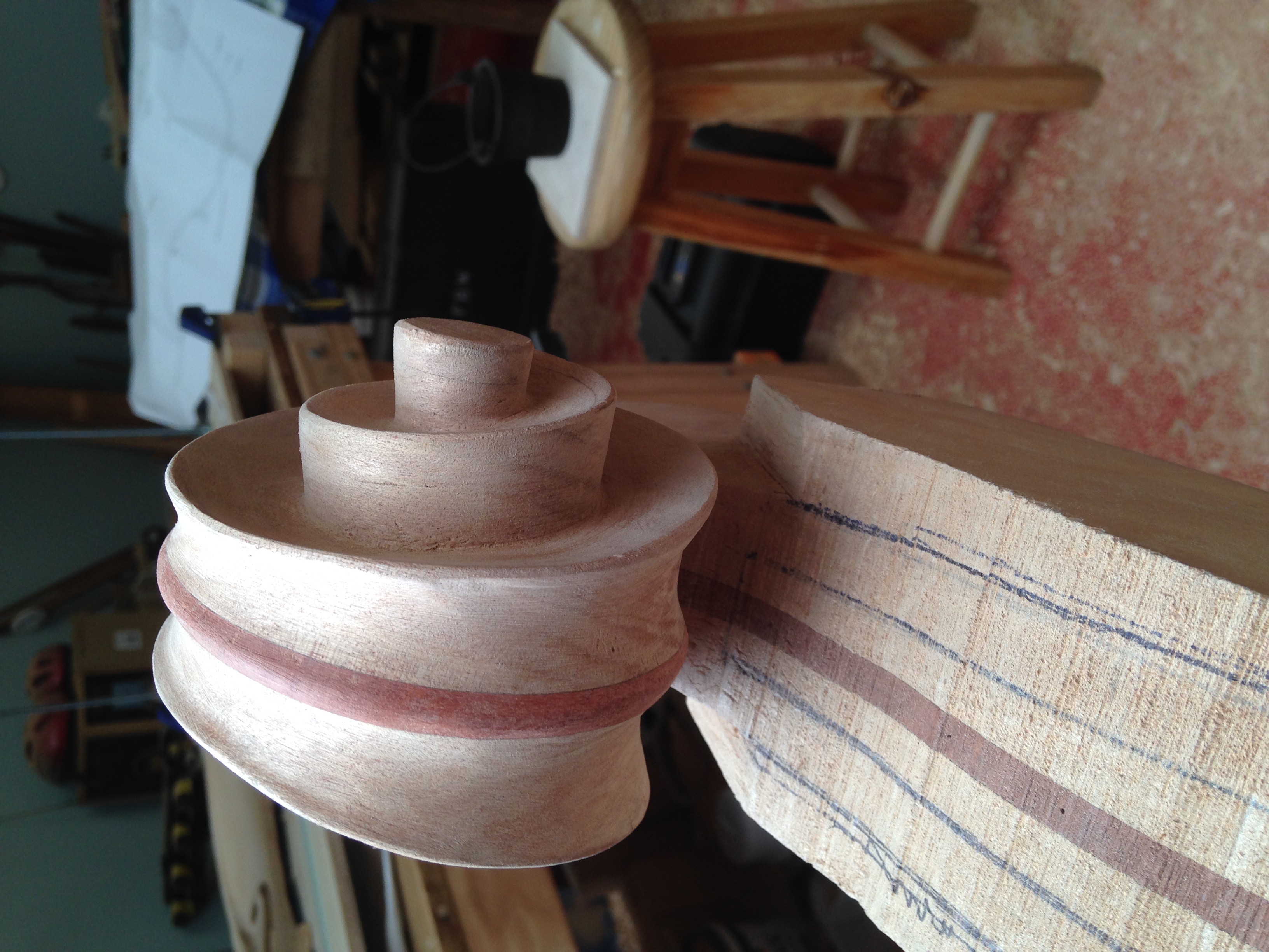

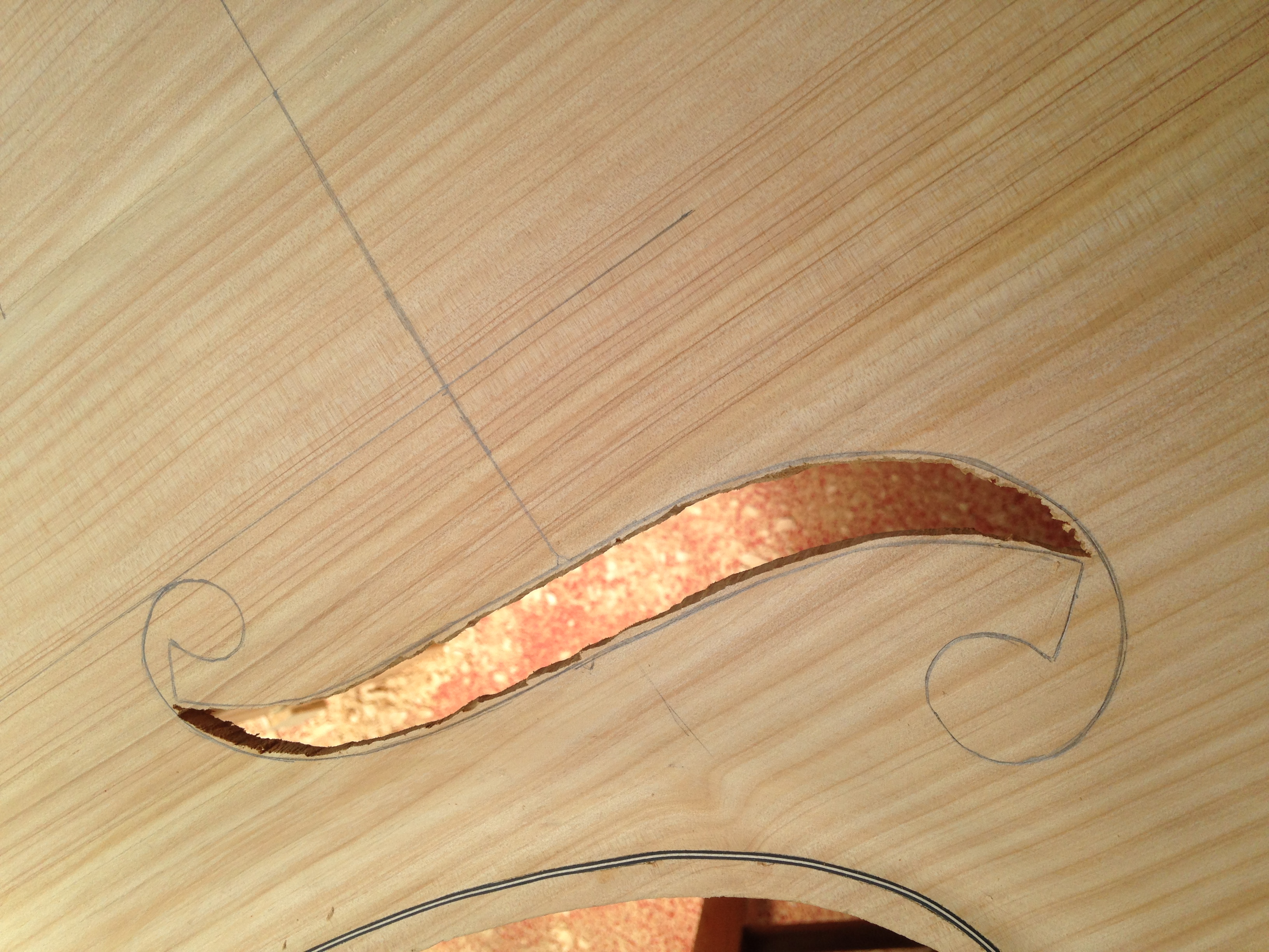

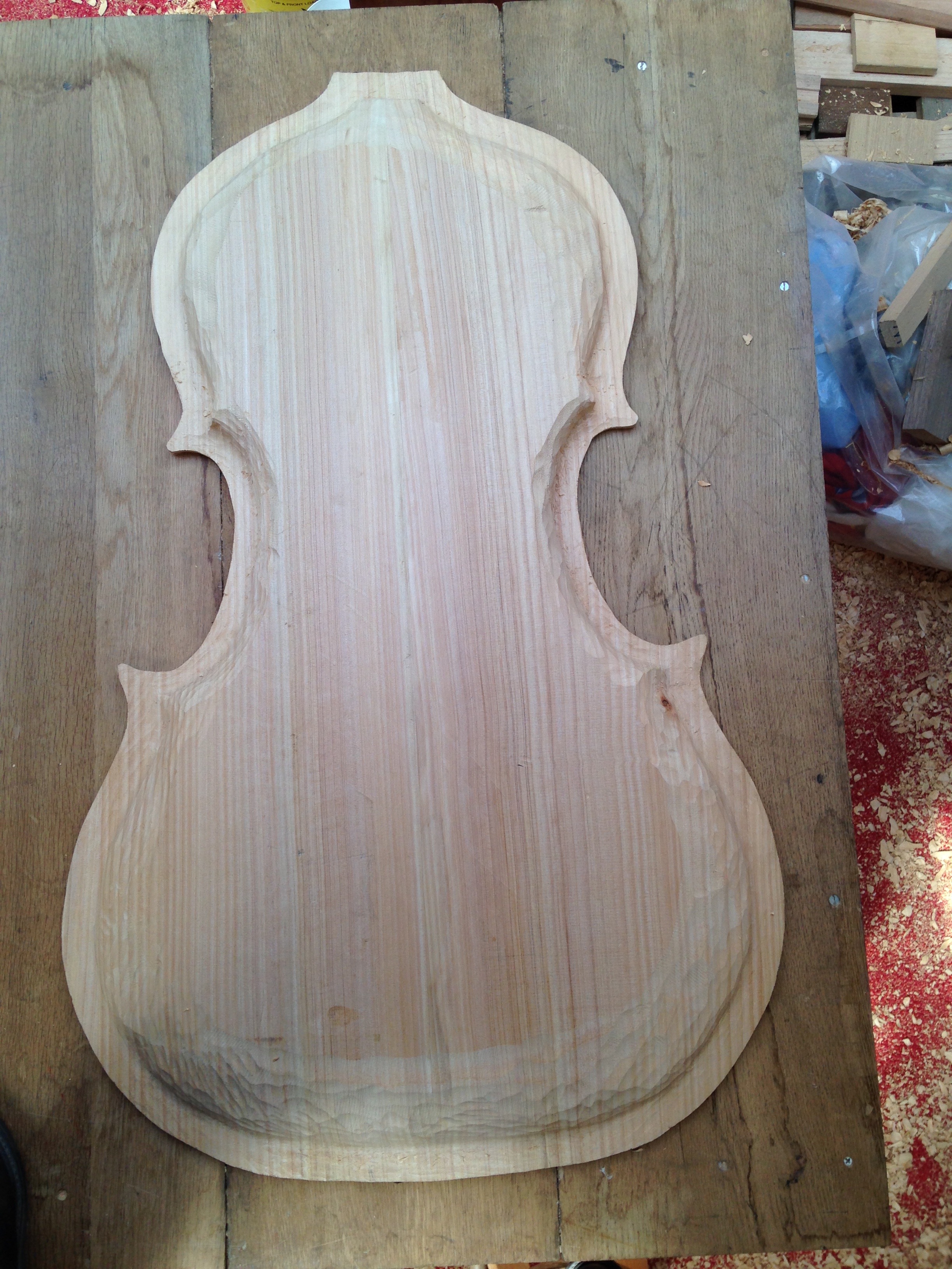

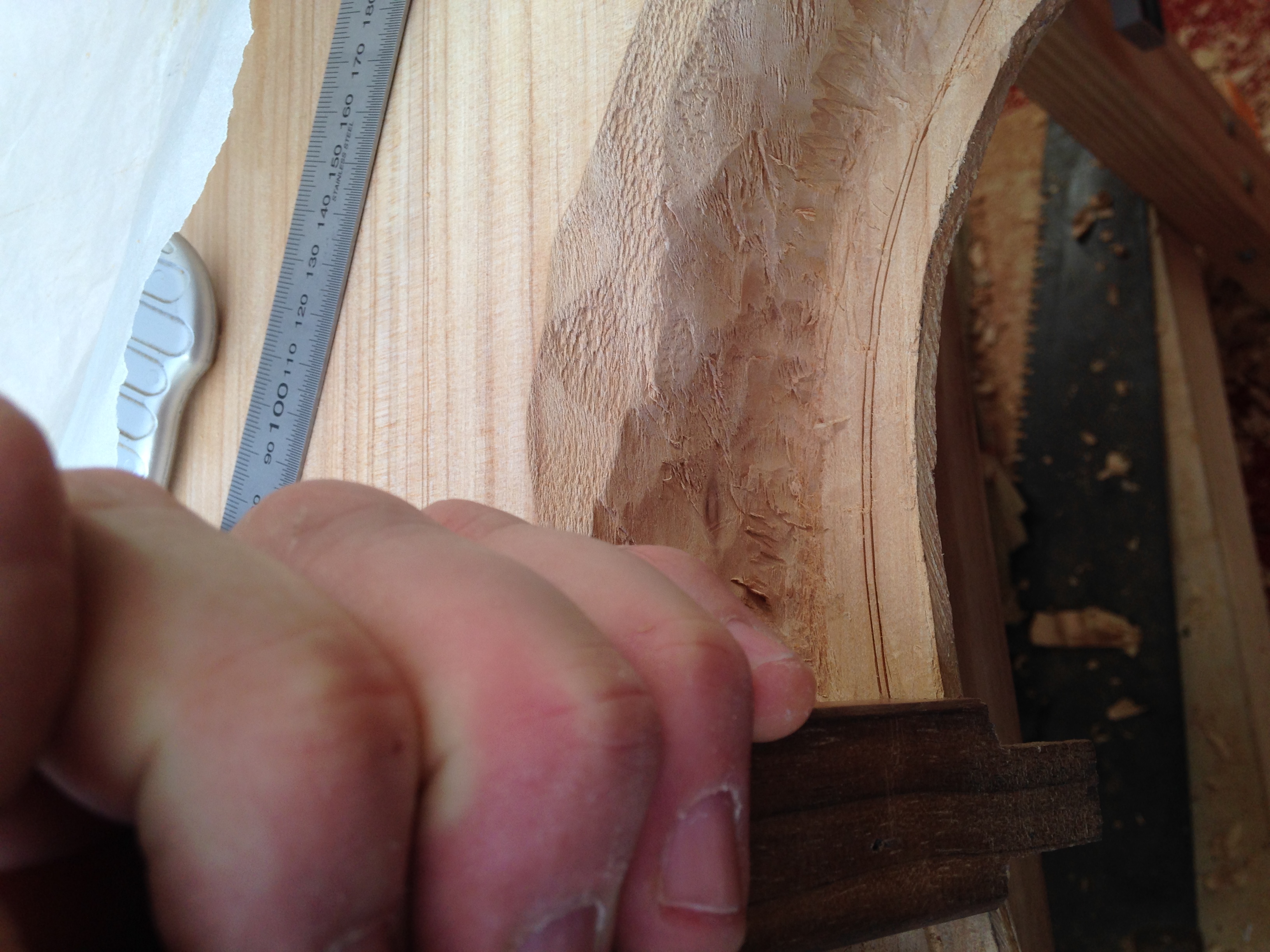

Thanks for all the great encouragent and advice fellas. I appreciate it. I'm still very much a novice and I've made heaps of mistakes (and running repairs, etc) but it's all part of the learning curve. And the proportions do boggle me at times. Sometimes it feels like I'm building a boat!
I think I do have the bug and I'm patiently buying up good tools as I can afford them. The Arbortech and Makita angle grinder were the last ones I bought with money I earned from a wedding gig earlier this year.
The purfling is a little rough but I can live
with it. I'll do better on the next build. Meanwhile I've just started on the next big task - carving the outer arches on rhe soundboard.

you are probably well advanced by now but i’ll offer a few tips for next time
We commonly use a slot cutter router bit to establish an even edge thickness by registering the router base at the back of the plate.
purfling usually goes in after the arching is carved and the outline finalized on the rib garland. often, purfling is done when the top/back is glued in place!
establish your long arch shape first, then carve upwards from the edge of the plate to meet the centerline. this gives nice even curves.
i cut the neck mortise with a japanese saw before gluing the top or back. a router is hard to manage up north there and you can screw up very quickly. and you still have to cut out the mortise by hand near the button. tricky!
if you are doing a flat back you might consider using my responsive bracing system which I think is a big improvement in the traditional ladder bracing. there are details on my website.
