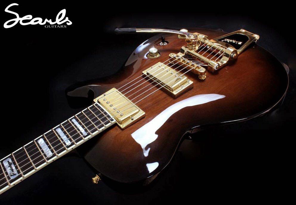

Contrary to Steve’s advice, airbrush is my weapon of choice for bursts. I use an Iwata Eclipse. Any burst you see on any of my guitars has been airbrushed.

Before Searls Guitars existed, when I used to do guitar refurbs/resprays etc I used touch up (detail guns) for bursts. Then I learned how to use an airbrush.
