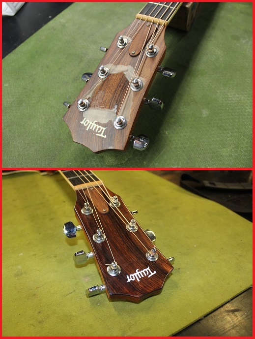

I can genuinely say as a person that loves nitro and for example, I love nitro so much that I even use it to do repairs on Taylor’s as well, uv finished surfaces are very thin as each layer requires mechanical keying as you may have noticed in my walk through.

For repairs, you really can’t go wrong, remember the taylor super glue drip fill repair I did, here’s a reminder link, it comes up pretty good.

http://www.mirwa.com.au/HTS_Superglue_Drip_Fill.html
