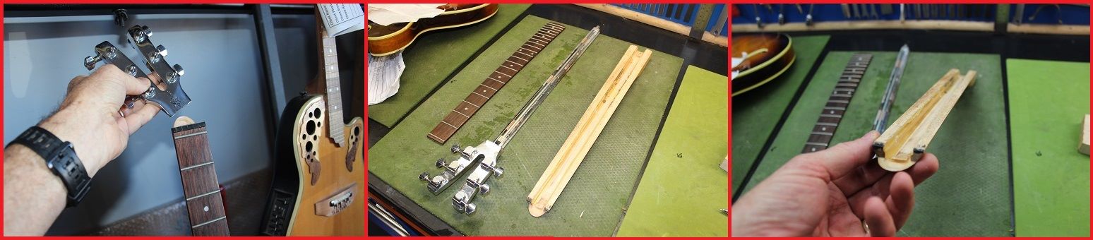

I will take a photo tomoz of my original one, not flash looking at all.

Noticed in my photo, the guitar it’s sitting in front off.
How’s this for a funky neck, I pulled this off as it was broken and just fitted a plain neck to get him going, got to work out the feasibility of getting cast ally tig welded.
I have a tig welder but don’t trust my skill set enough to do the job
