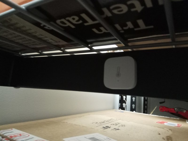

I do not control humidity in the working area but I have a humidity controlled wood storage room (about 2x 3.5m).
My shop (a garage actually) is nearby the ocean , generally quite humid but variable (from 45 to 85%) according to the wind direction, a couple of times I have seen the hygrometer up to 90%.
The humidity control system is based on a cheap 12lt dehumidifier, a temperature/humidity probe, a zib-bee smartpulg with relevant smarthub connected via wi-fi to the home internet router.

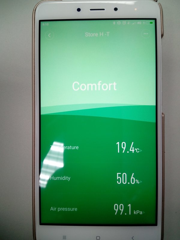

The system works really well and I am able to keep the humidity just around 50% with the water reservoir that needs to be emptied one or twice a week when the outside environment is very humid.

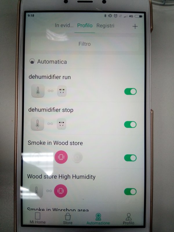

I have a remote interface app on my phone (MiHome) that allows receiving high humidity alarms (usually when water reservoir is full  and need to be emptied) and verify the room conditions as well as totalizing the energy consumption with the capability to start/stop manually the dehumidifier from remote.
The overall cost for this system is around 300NZD including the cost of the de-humidifier. Some info here below:
1) Celsius 12ltr DeHumidifier (was 220NZD at The Warehouse)
2) Zigbee T/H Probe( about 18NZD)
https://www.aliexpress.com/item/Xiaomi- ... 4c4dj64oQD
3) Zigbee Smart Plug (about 19NZD)
https://www.aliexpress.com/item/Origina ... 4c4dRu1R5i
4) Smart Gateway (about 37NZD) :
https://www.aliexpress.com/item/Update- ... autifyAB=0
5) I have actually also installed a smart wireless smoke detector (@ 38NZD) which provides remote alarming via the same smart gateway, which can alos manage a wifi camera with remote access:
https://www.aliexpress.com/item/2017-Or ... 4c4dj64oQD
I am including some pictures to show some of the components and remote screen and example of the automation page.
The system function really well, not too expensive and easy to install and program.
Happy to help with any additional info.
