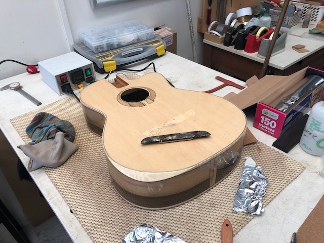

Boy, my current build is giving me no end of grief. I am making a new bridge after the first one split under string tension along the lamination while stringing up. I noticed however that one of the 18 holes on the new bridge hadn't gone all the way through the tie block. Using a eggbeater style had drill I have broken the 1.5mm drill bit in the hole and in the attempt to remove it with plyers, the end has broken off flush with the back edge of the bridge.
Any ideas about how to remove the bit now without making a mess of the bridge would be welcome:
Apologies for the bad photo - but you can just make out the drill bit
Broken drill bit in tie block

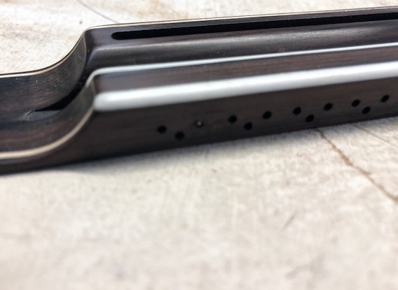

See below what i mean with the bevel. I do this on all mine now anyway, looks good, with the added bonus of weight removal. Sorry i dont have a better photo showing it at the moment. I do this with a ball ended dremel bit upside down in a make shift table and a fence.

You could route a bevel across the back of the tie block, careful not to hit your drill bit with the router/dremel but go very close to it. This should allow you to get needle nose pliers in to remove the drill bit - ensure to pull straight and twist obviously. After removal tidy up with the router/dremel.

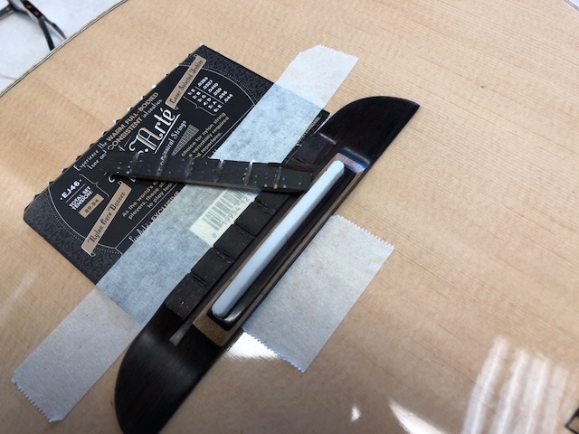

Here ya go - the original was only a 6-hole and made pretty much per Trevor's method. Lamination was rosewood/cf/tassy oak/cf/rosewood with epoxy
