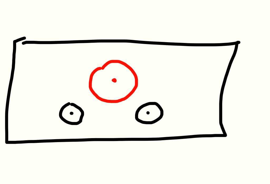

Real easy,
Two skate board roller bearings from local bearing plac, maybe two bucks a piece or online eBay 6 for 3 dollars or similiar. Piece of dowel wood, cut it to same thickness as skate bearings, spin it up in a lathe or drill a hole and fit a bolt in it and spin it up with a battery drill, whilst it’s spinning lay a file against the centre and that will put a groove in, the groove is for your fret tang relief area.
Bolt the two skate bearings (black pic) to a piece of wood in a straight line about 5cm apart then bolt your grooved one (red pic) between them in the shape of a low slung triangle, the height of the grooved one in relation to the fixed straight ones, push or pull the fret wire through and it will set your radius, want to be fancy, make either the grooved one or one of the fixed ones moveable and or attach a wheel to crank the grooved roller, then you can accomodate different radius’s and roll the wire with a handle
Finger sketch up
