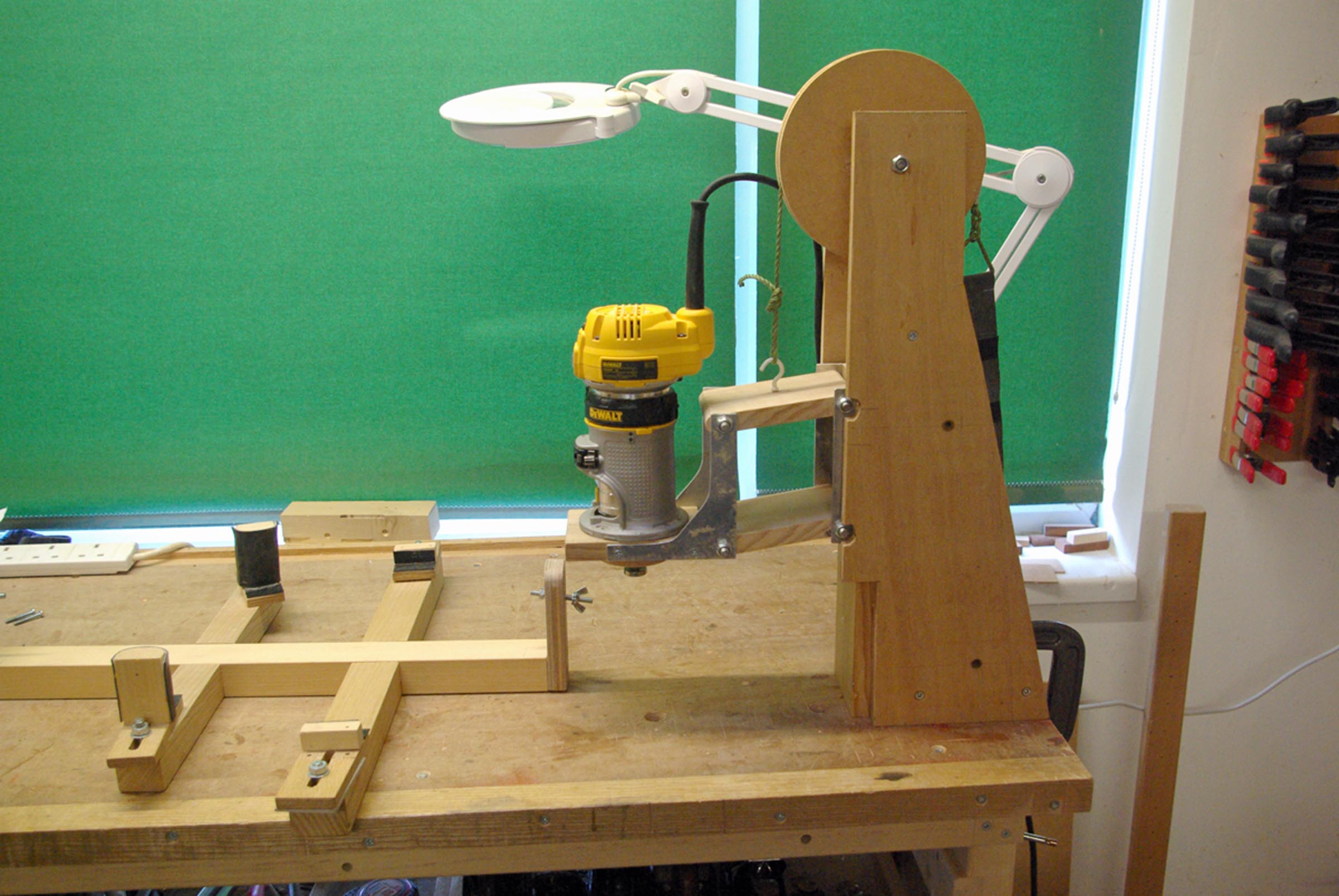

This is what I use Richard, nothing fancy, it's home made but does the job, the cradle has castors on it and it has adjustable clamps for different sizes. I use the Stewmac router bit and bearings. Wayne
Re: Routing bindings/purflings
I do as Wayne. It took a couple of iterations to get the router holding tower right. I use a counterweight to reduce the load the router puts on the guitar top.
I have also modified the cradle so it will take all the shapes I use - have just bound one based on Trevor's medium SS and had to increase the outward movement of the supports.
I have also acquired the small DeWalt router which is far better than what I was using previously, with good depth control, smooth running, low runout.
This system does provide a fairly low stress method.
I'll dig out some photos later.
Martin is dead right though sharpness is all.

Thanks again for the feedback. The overhead router approach looks similar to the Gilet Gore approach. If you use that with a bearing, doesn't that mean you have to do one pass to the bearing/cutter depth? So does that increae the chance of splitting bits out...how do you approach the process to minimise the risk or am I being overly apprehensive? Just hate the idea of bits of sounboard scattered over the shed after all that work!
Well it is not a panacea.
Routers whiring away are, at least for me, always a bit of a worry. However with this setup, using only spruce and maple back and sides I haven’t had any chip out.
What I do get, doing the top corner is fuzz. Ie fibres of the spruce that have not been cleanly cut. I always have to clean up with files, maybe a chisel used as a scraper, sandpaper on a block, whatever.
But this is not to do with the jigging arrangement but the quality of the router cutting.
This arrangement does however give a properly shaped rebate.’
What you will find (as G and G) say is that the Bending/shaping of the binding is important. If you get it right it goes easily, ubut if not it can turn into a bit of a nightmare. And that tends to become clear once you’ve taken the tape off!

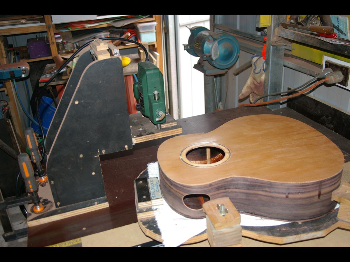

We use Chris Ensors jig https://elevatelutherie.com/product/ult ... nding-jig/ and get good result on student builds (if they have done a decent job leveling their sides first).
That is a nice built rig
Thanks Steve. It is entirely based on G&G's design with a bit of development looking at what others have done. (Oh and any reference to coal mining pit gear will earn a slap!)
It's rather typical of a number of jigs one makes for the build process. You spend quite a lot of time and effort building the jig, then some time on setup but the actual process takes a matter of minutes out of the many hours of build time.
Drilling jigs for headstock tuners, and for bridge string holes. These take a long time to build but you get so much back in swiftness of process and accuracy. Over only a handful of builds they repay you well.

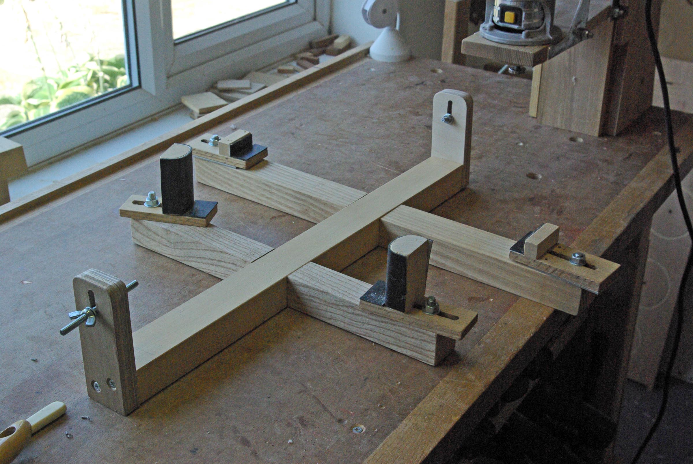

Probably too late now but I built mine with a couple of draw runners to allow the router to raise/lower during the cut:
I have a Makita router (0700 C?) and I use the speed control to avoide big kicks on start-up - I also make sure the cutter is not in contact with the work piece and ease the work into the cut once the cutter is up to speed
Nice set up. I've had a go at knocking one together this weekend. I've tried to paste a url below. https://www.flickr.com/photos/143232438 ... ed-public/ https://www.flickr.com/photos/143232438 ... ed-public/
Does this look like it should work? The track slides up and down quite freely (although not as good as a ball bearing), and it has very little slop, which is why i though it might be a good option.
I'm going to have to figure out how to paste images here, but the link seems to work...
Nothing wrong with that
