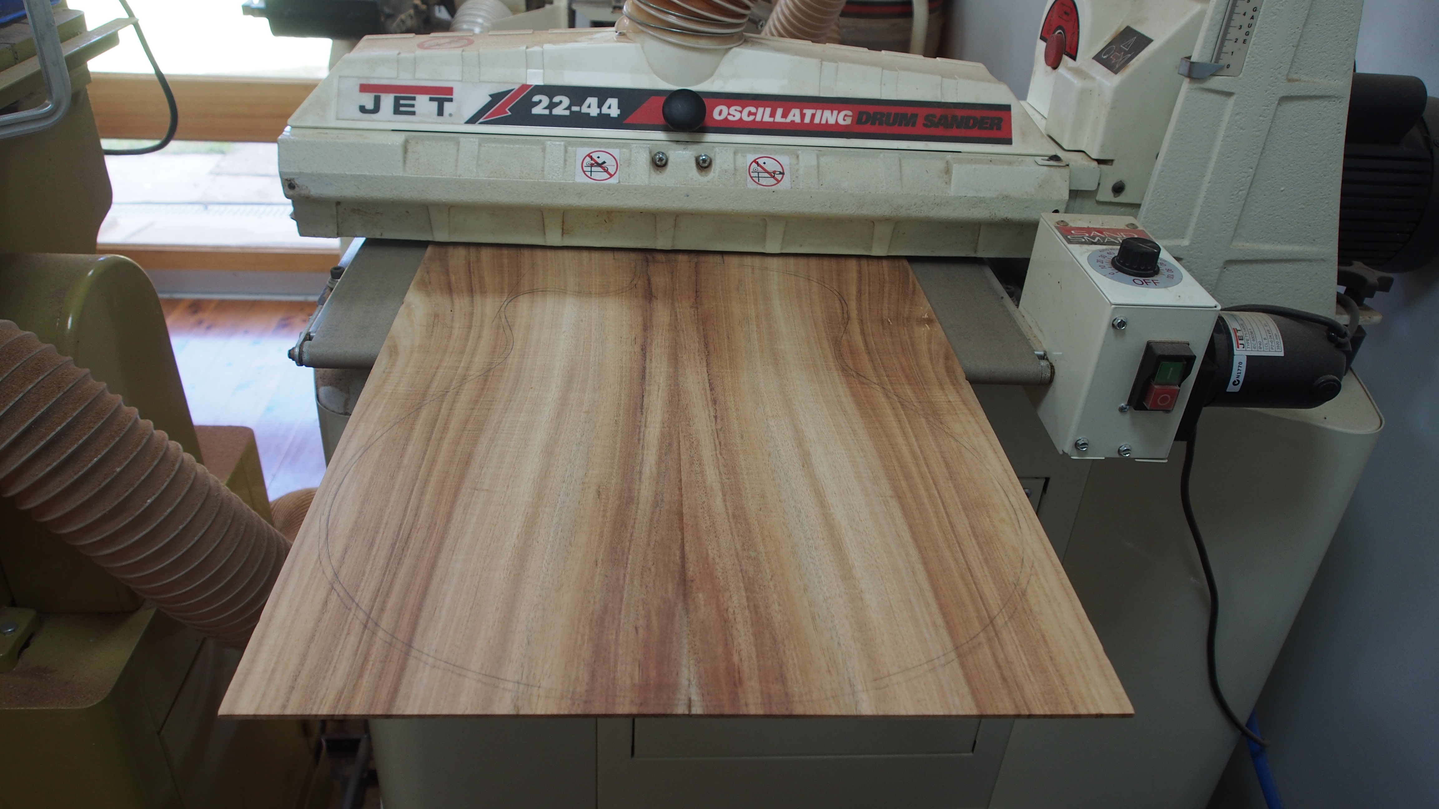

I have a Jet 22-44 Oscillating Drum Sander with a Jet DC-1200VX with canister kit dust extractor. This has proven to be a very useful tool for thickness sanding the top and bottom plates, making veneers for my arm rest bevels, thickness sanding the bindings that were cut on my band saw etc.
I have replaced the belt and found it better to purchase parts from overseas. I think Carbatec is not continuing to sell Jet products now.
I still find it necessary to rotate the timber to balance out the slight errors of the Drum Sander. Using a cleaning stick regularly on Drum Sander paper is important and helps to extend the life of the sand paper on the drum.
Overall it has been ok machine for hobby guitar building. I was advised that you need a large diameter size drum to minimise paper clogging that industrial models have. These type of Drum Sanders are way beyond my budget and not justified unless its a business that builds and sells lots of guitars.
