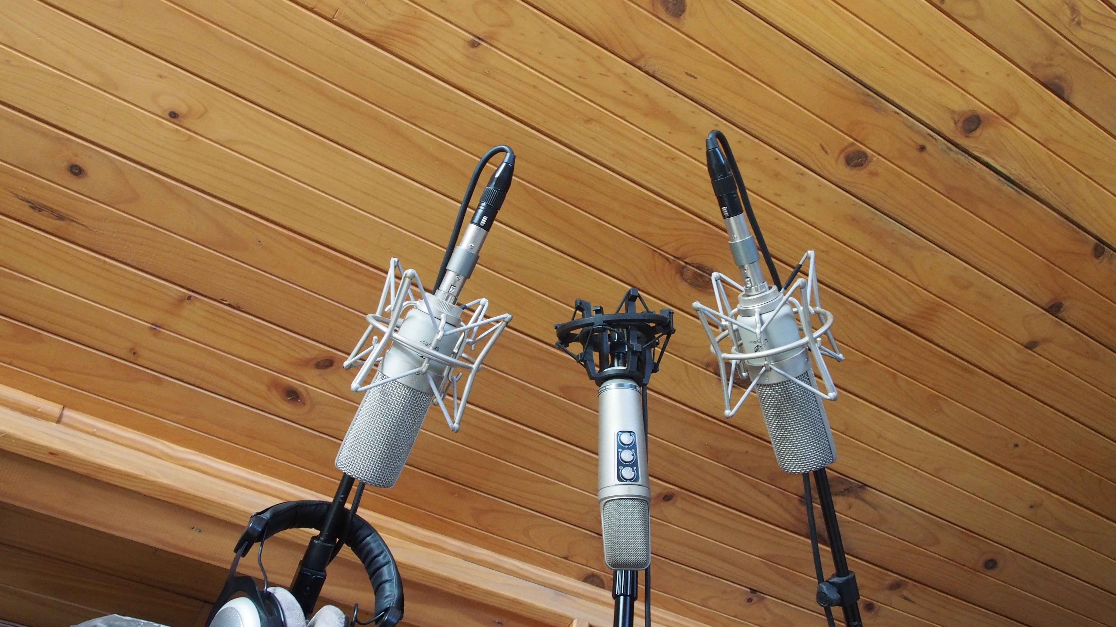

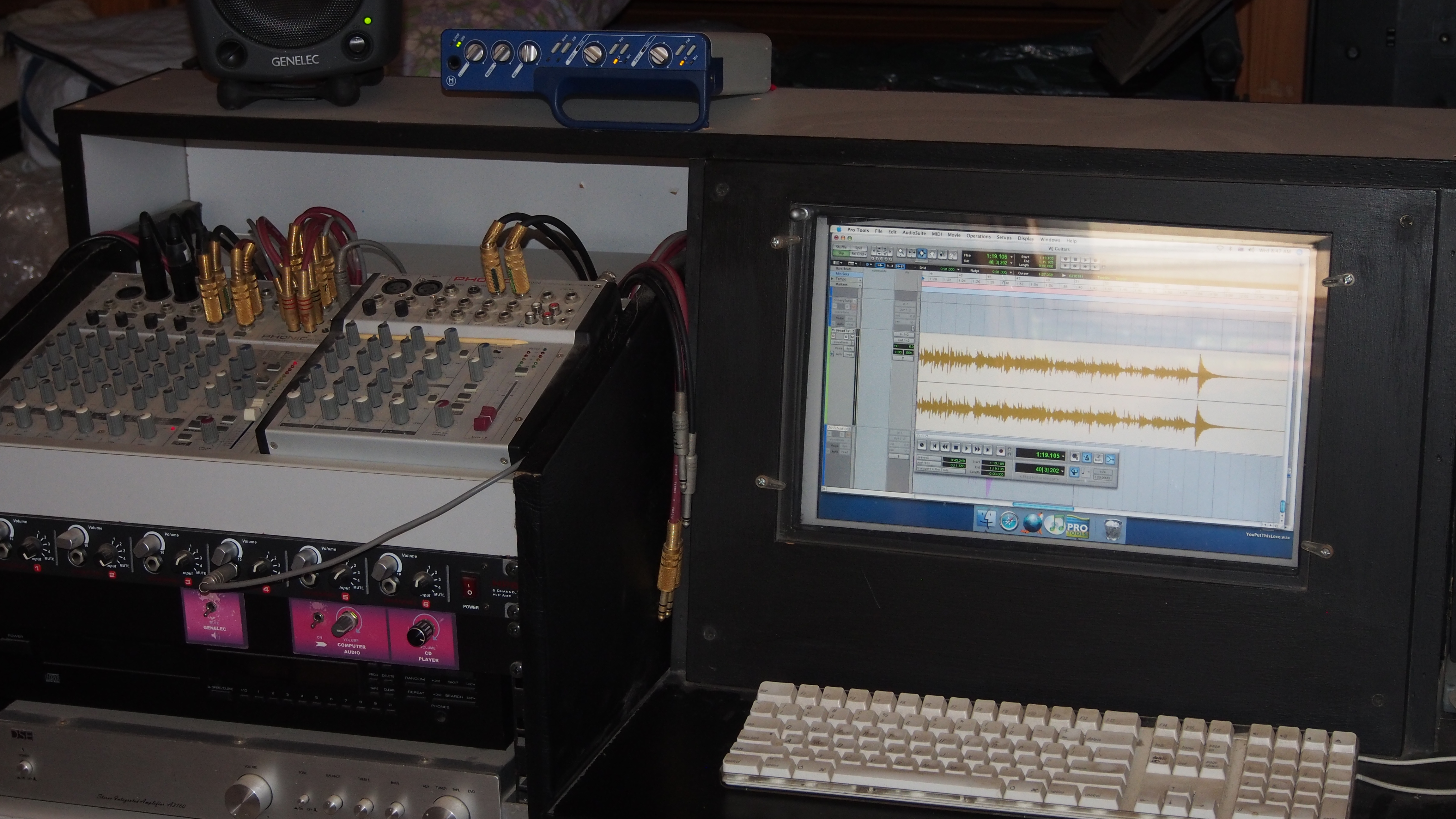

Hi Trent
I have an older version of Pro tools, some 'waves' software and record in my upstairs loft studio room. I record in an acoustic controlled environment in stereo, dry no eq or effects. Less is more. On some recordings I use X - Y microphone format with a matched pair of condenser microphones and more recently use 3 pointed microphone setup (Left Centre Right). Spending time positioning the microphones is important to minimise phase cancellation issues. I like using a matched pair of ribbon microphones (Left Right) and condenser microphone blend for the centre. The ribbon microphones give a more natural warm sounds and the condenser gives the high end sparkle.
