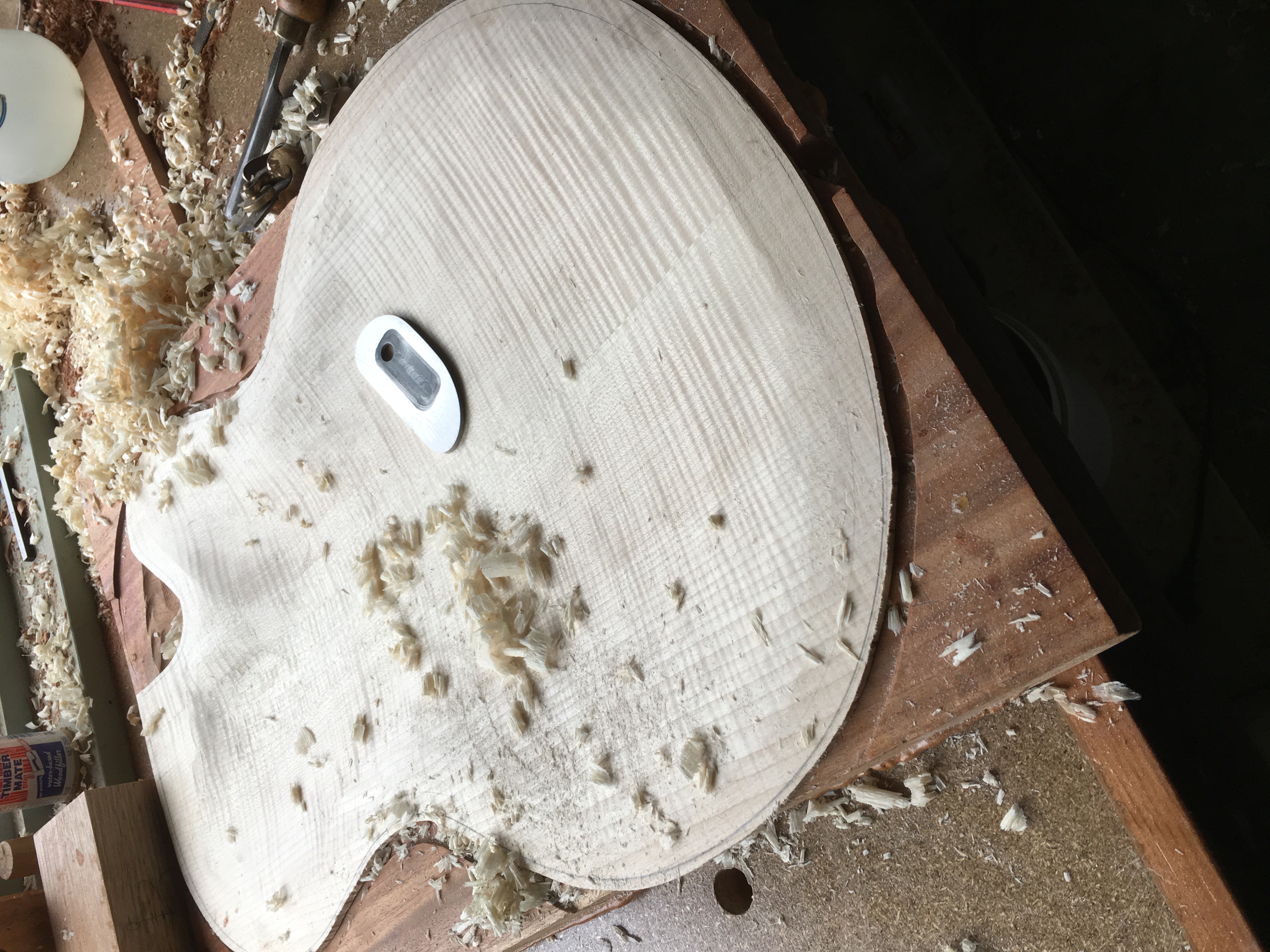

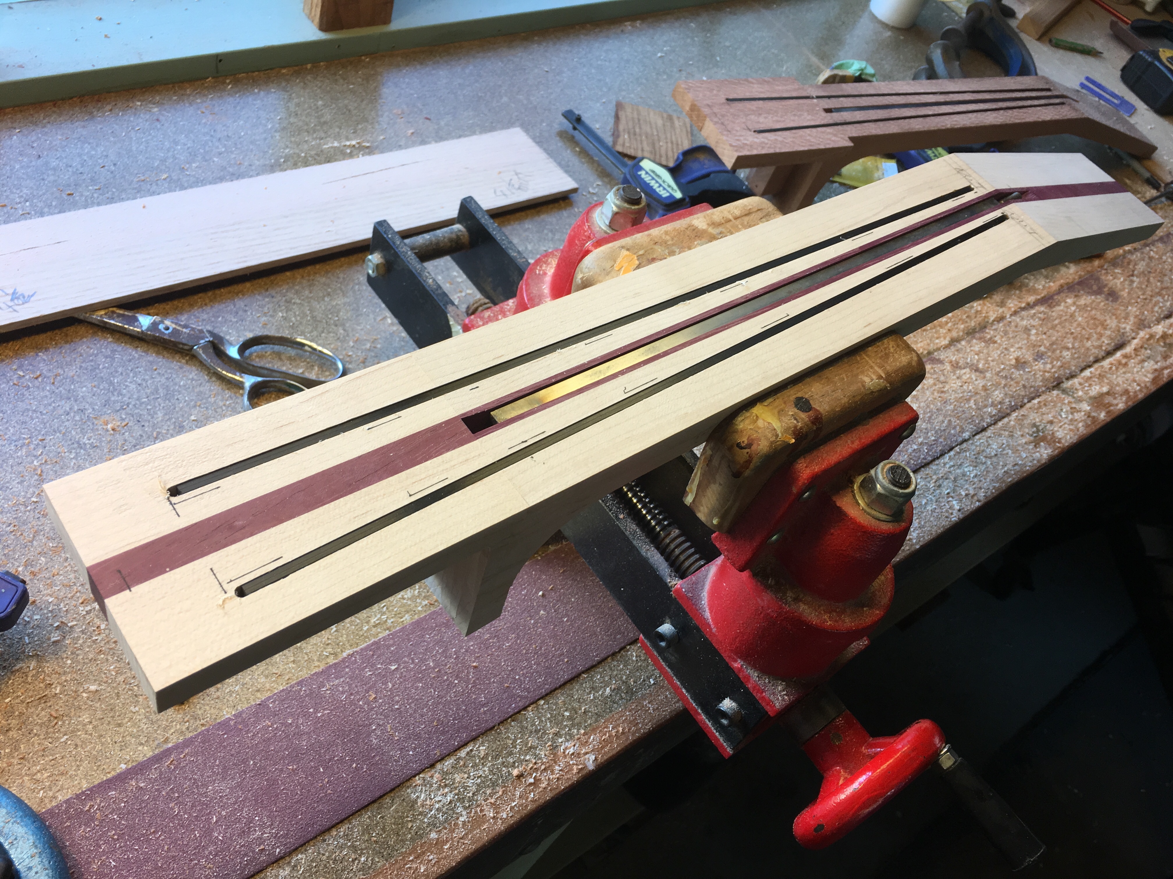

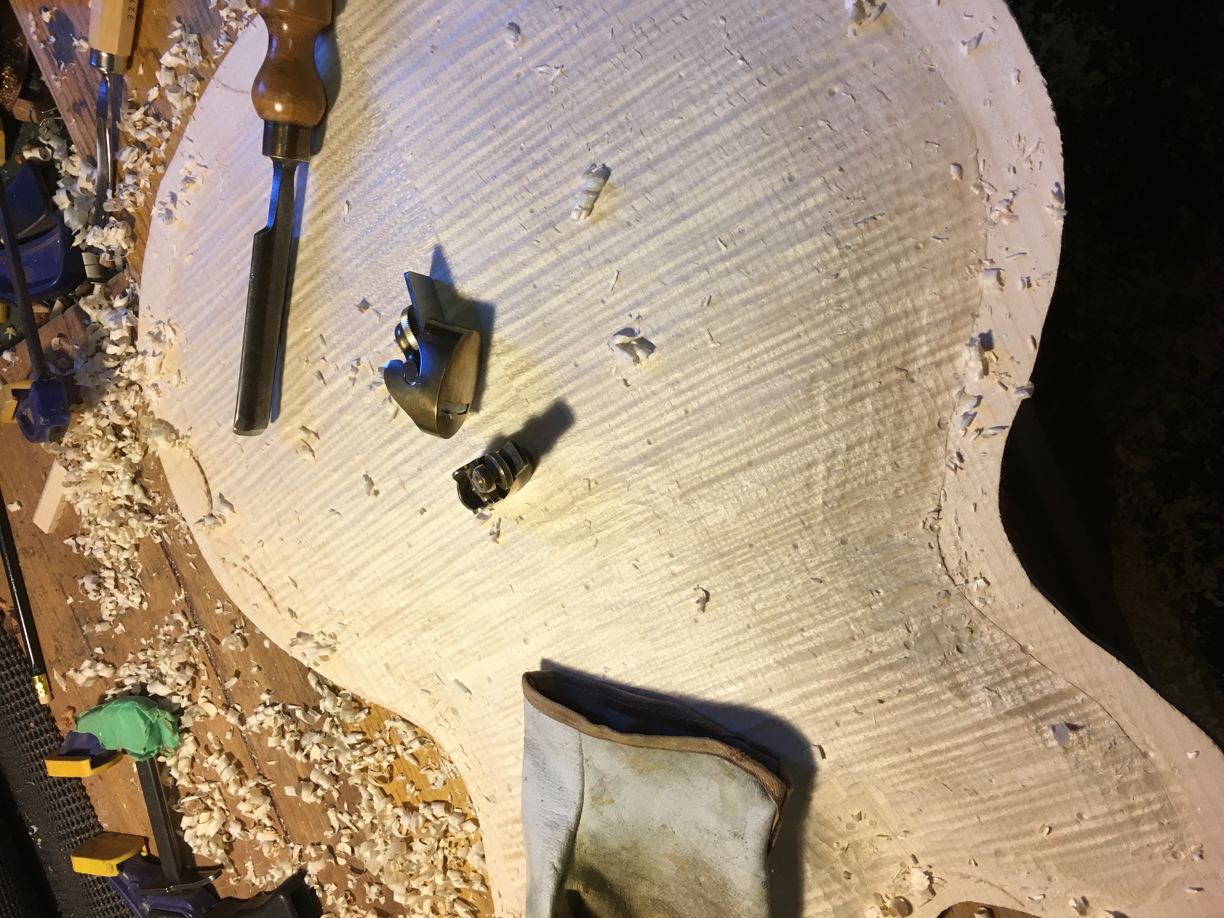

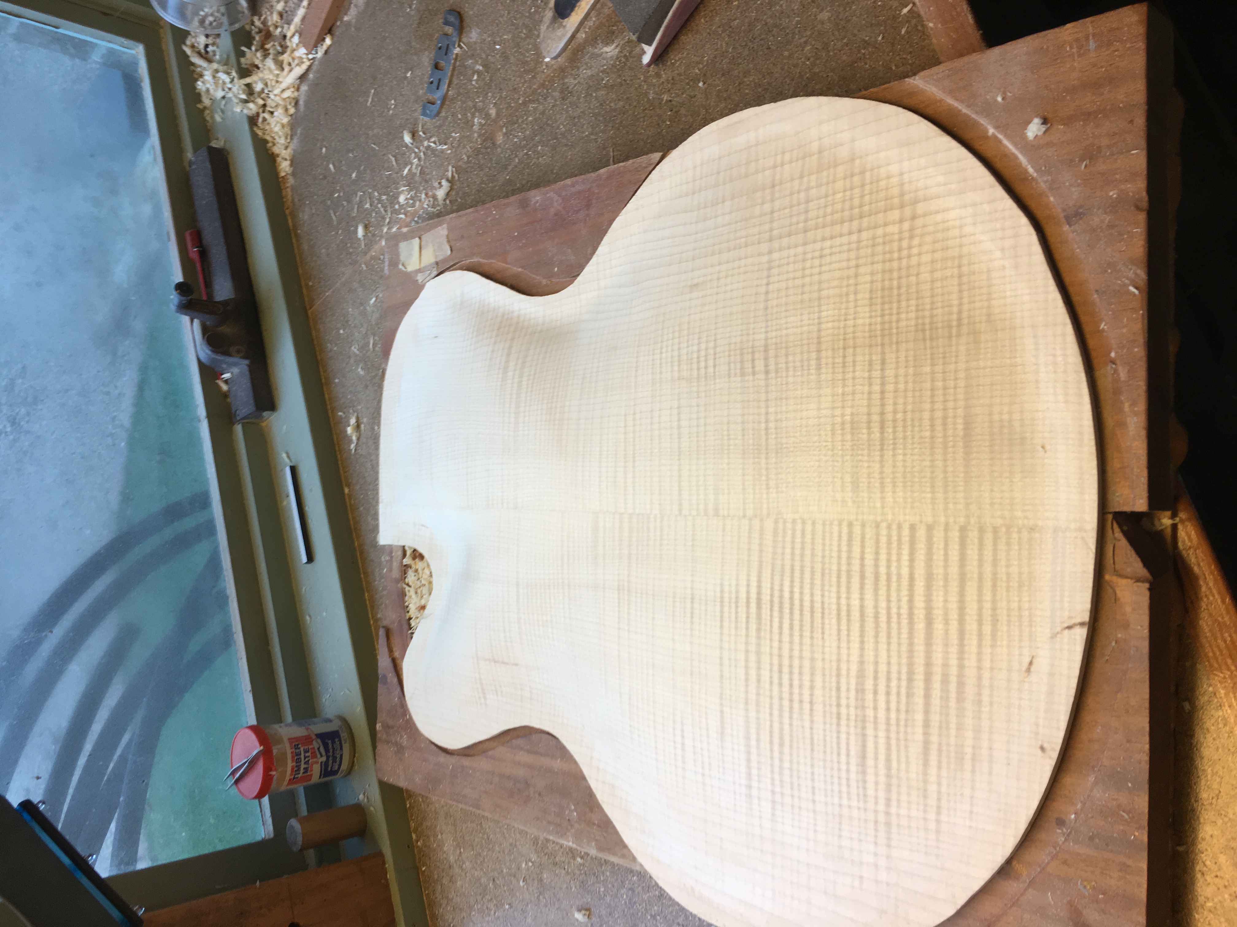

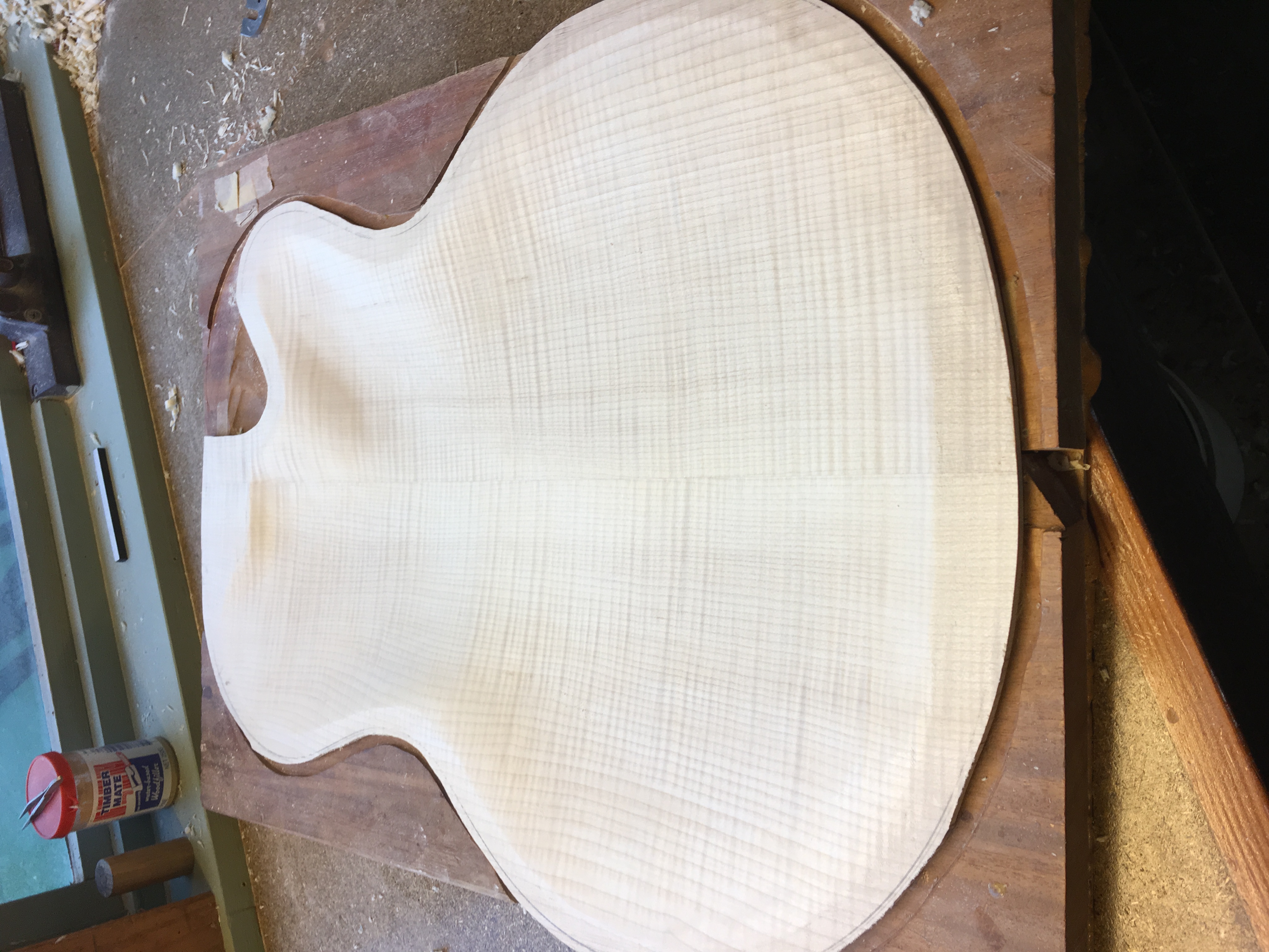

Hi there all, I started this archtop a couple of months ago and thought some progress pics in here might be appropriate.
17 inch by 3 inch body 25 scale, maple back and sides , Sitka top that I’m still carving atm.
Rod

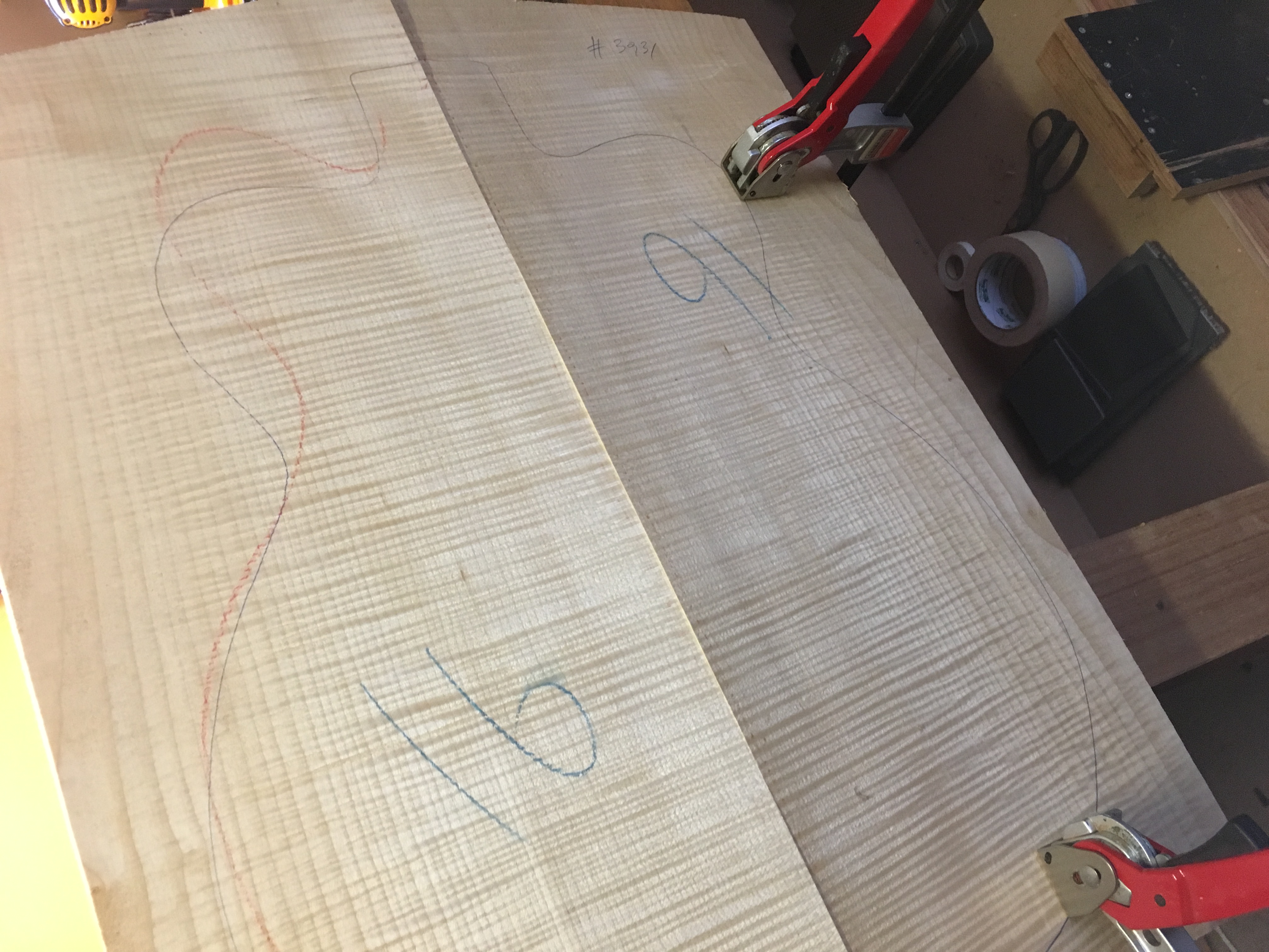

Bookmatched back set and rough carve

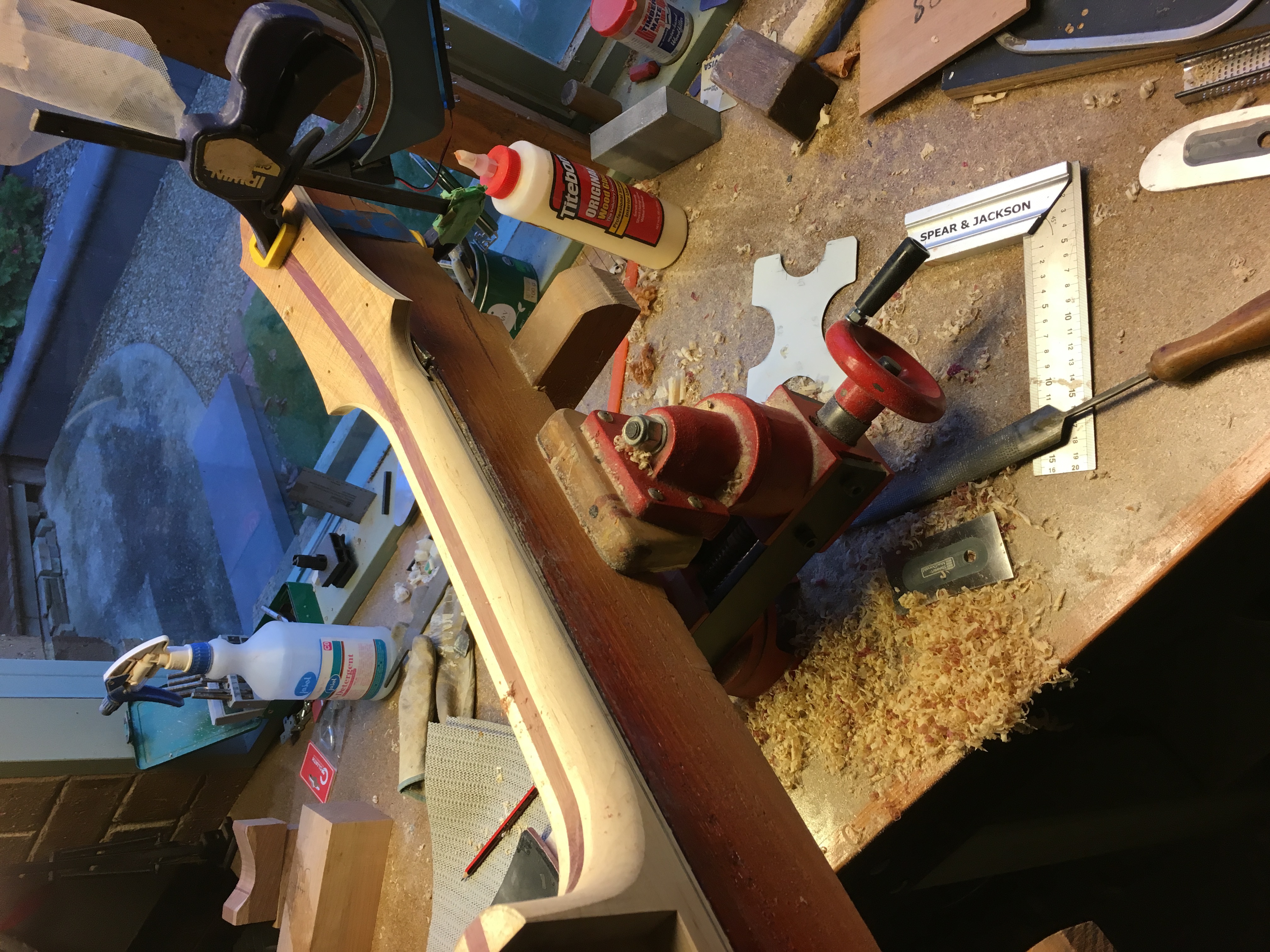

Maple and Purple Heart neck w cf

Hand carving, I feel for you, that is just too much hard work.
Re: Current archtop build
Post by rocket » Mon Oct 22, 2018 4:19 pm
Hi Steve, yeah it’s a lot of work but as I only build archtops and ten years along I’m sort of used to it now, I only build one maybe two a year so I can’t see any need to try the copy carver or cnc method, with individual carved I can tweak them along the way if I need to!!

Post by rocket » Tue Oct 23, 2018 6:44 am

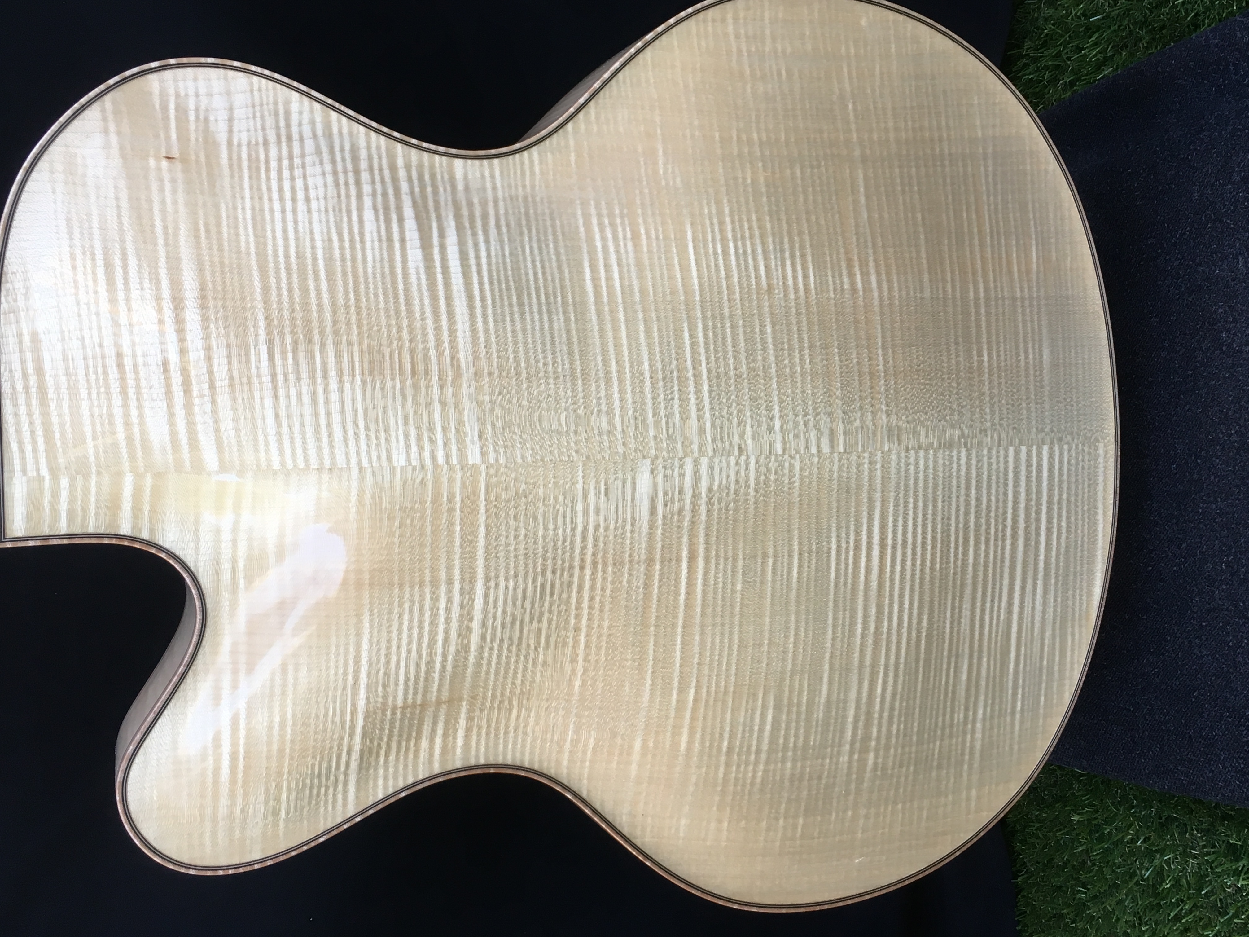

Here’s a few more pics of the finished back, it’s thicknesses down to 4.5mm

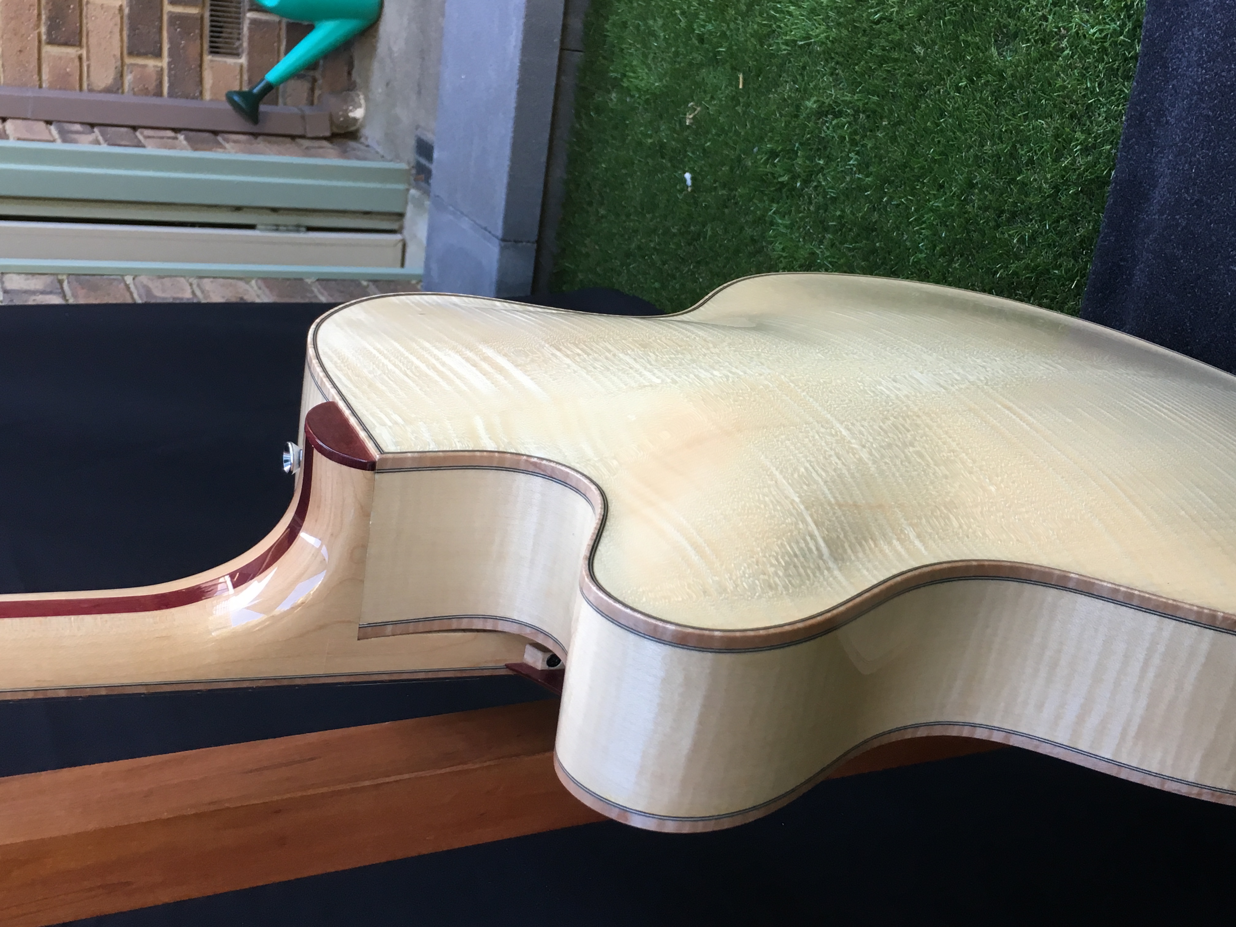

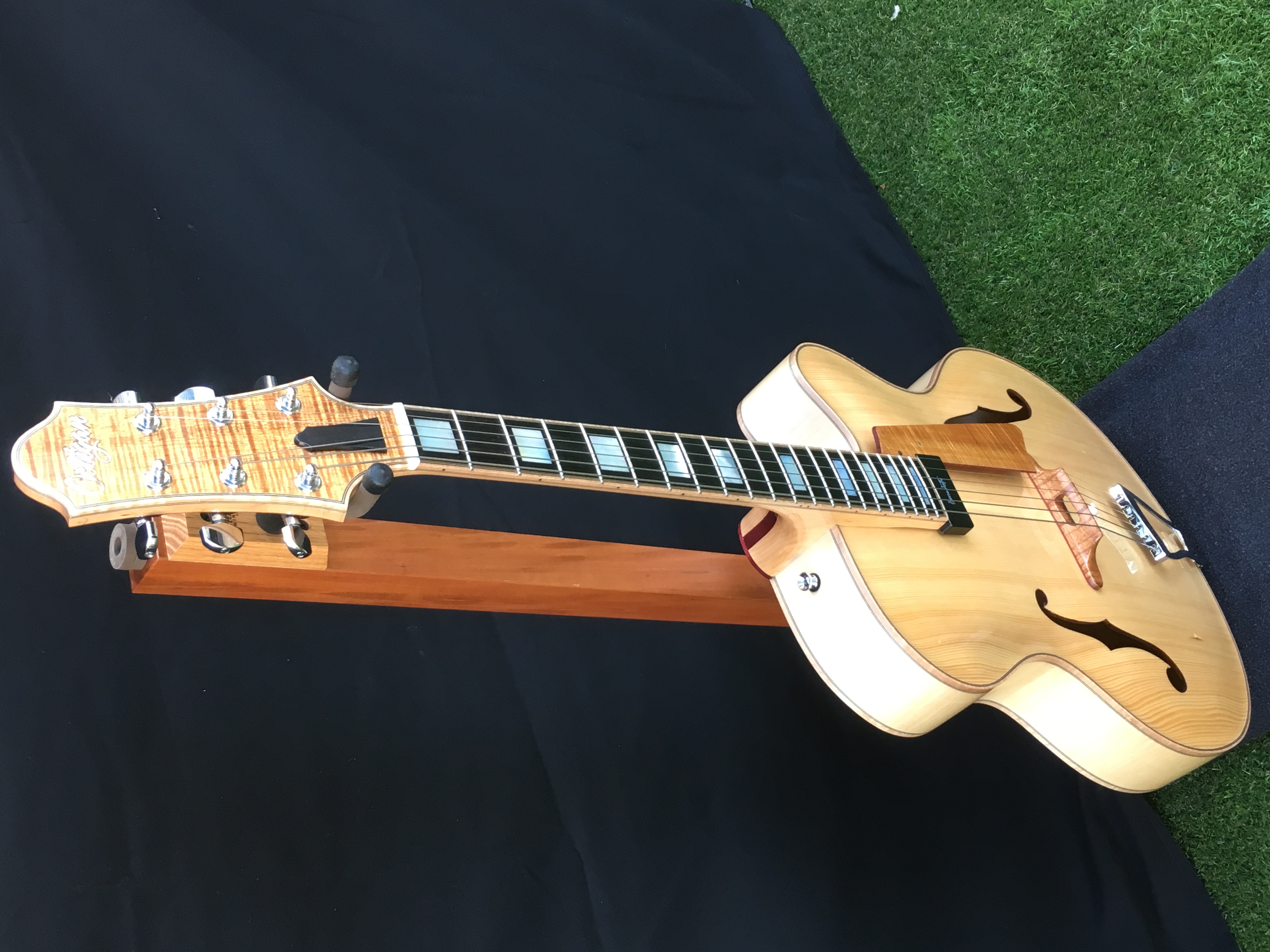

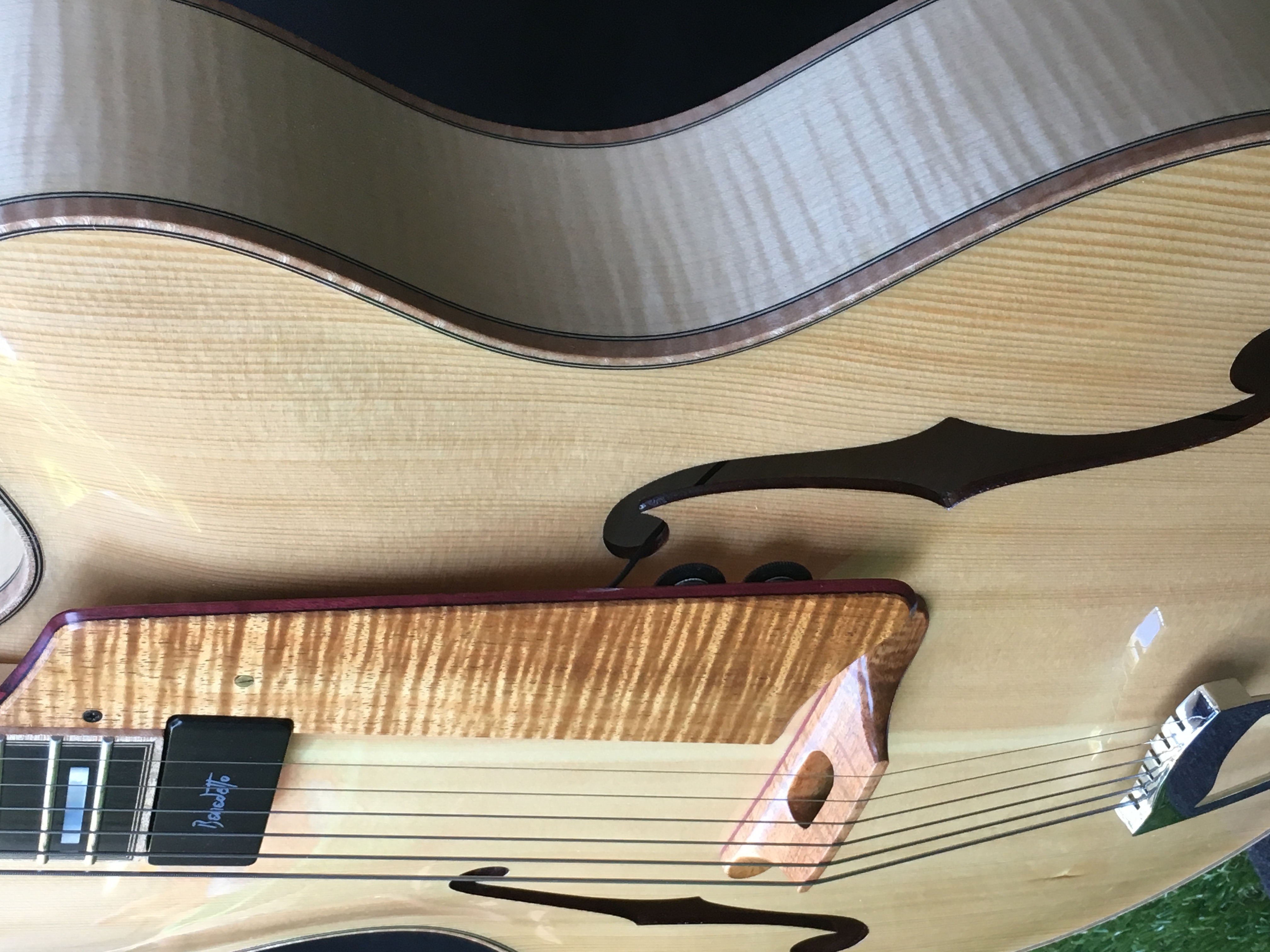

Post by rocket » Wed Feb 27, 2019 9:26 am

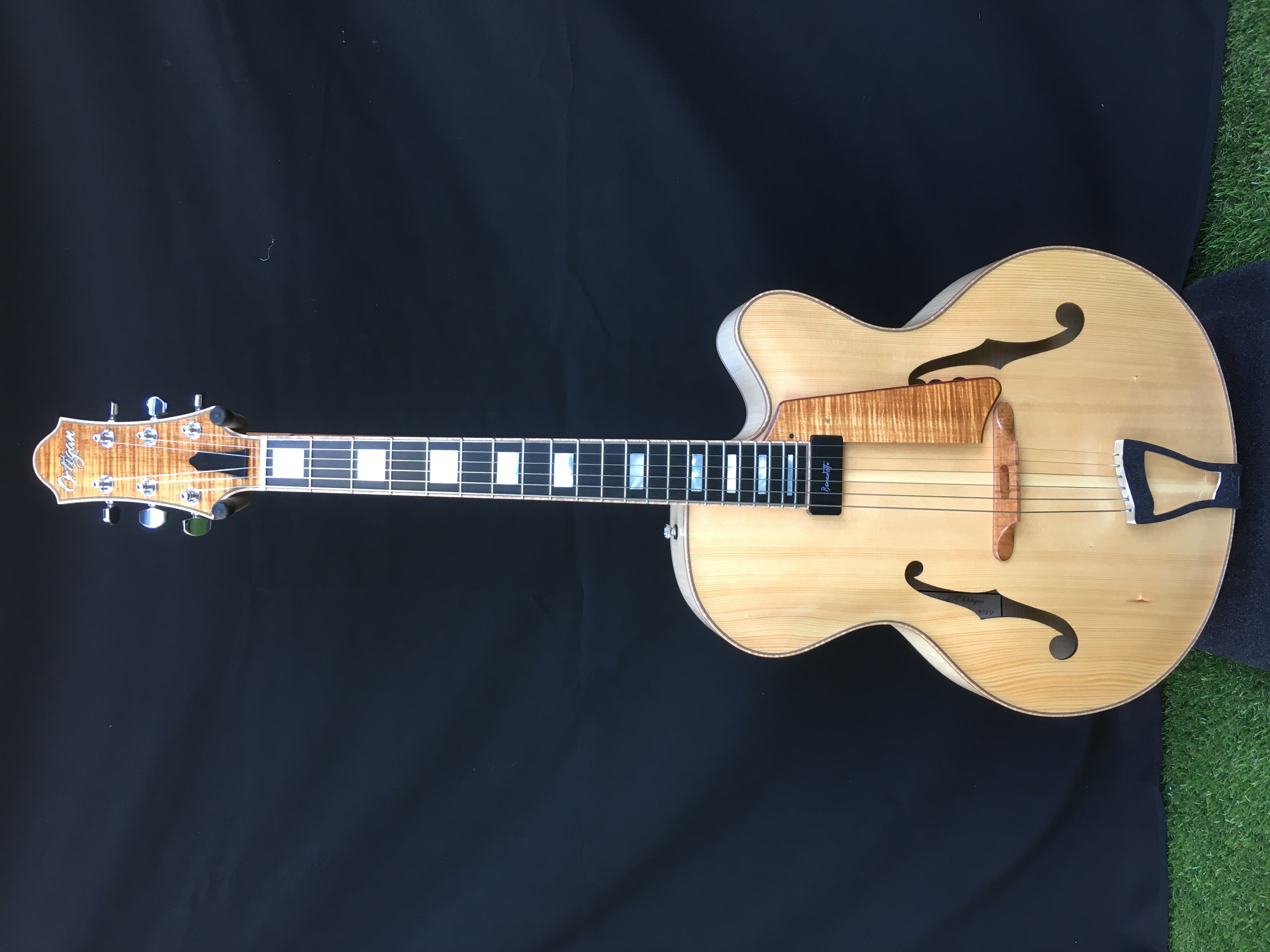

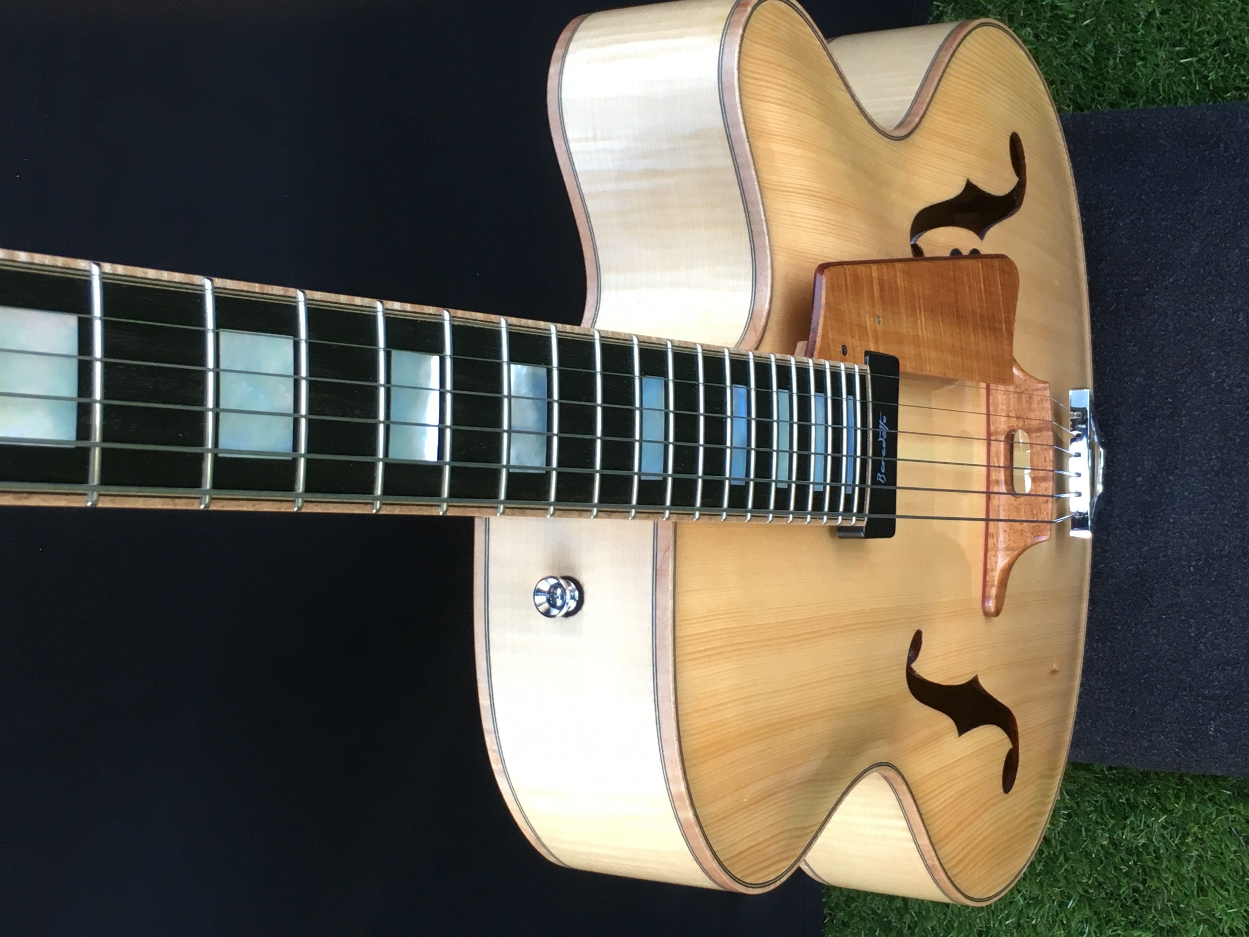

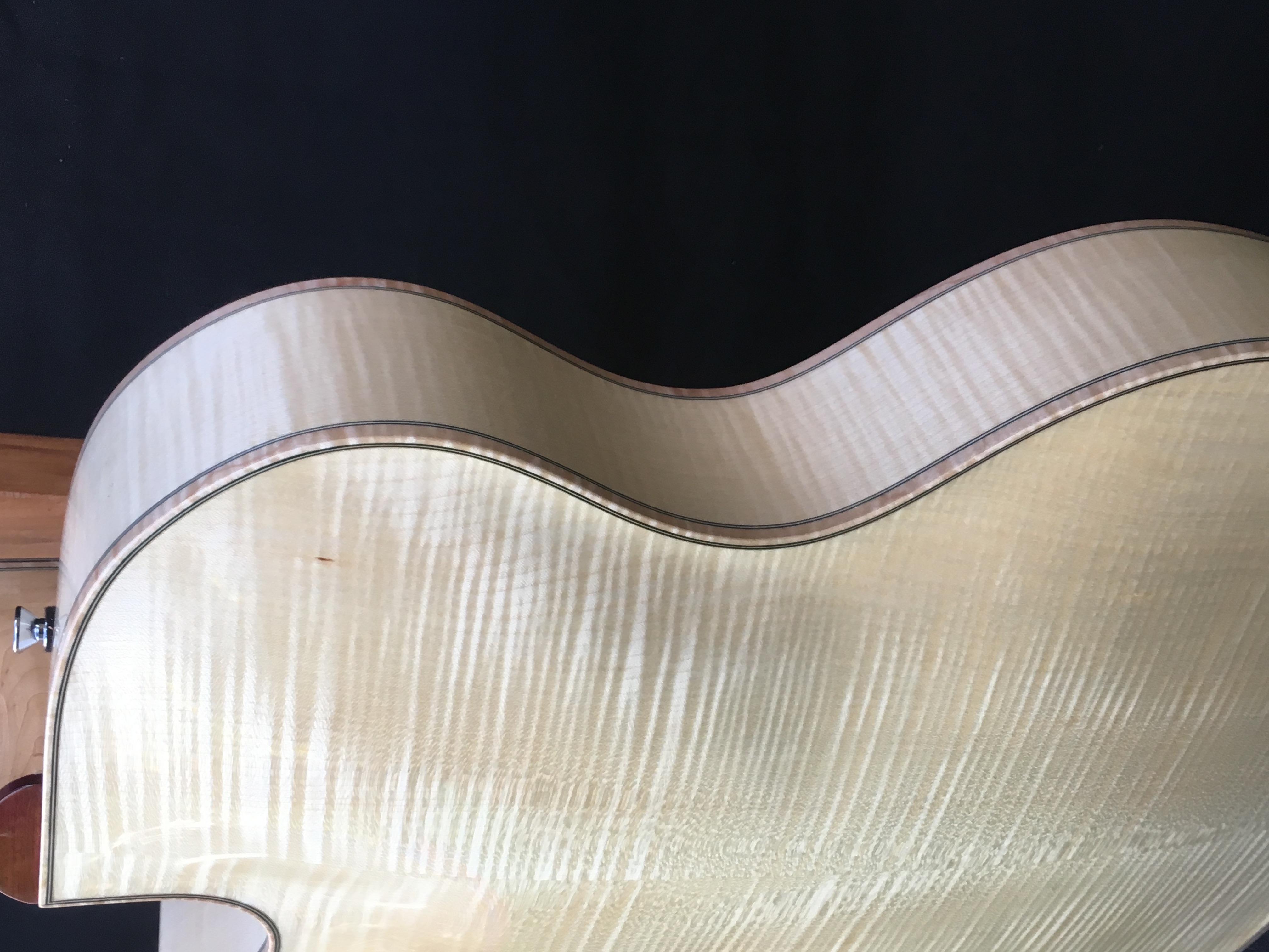

Fast forward five months and this build is complete.
17 inch 25 scale archtop jazz guitar in maple and Sitka with Otways Blackwood veneers and one piece bridge, ebony fb, parallel bracing, S6 pickup, natural finish in Mirrotone 3230
Thanks for looking

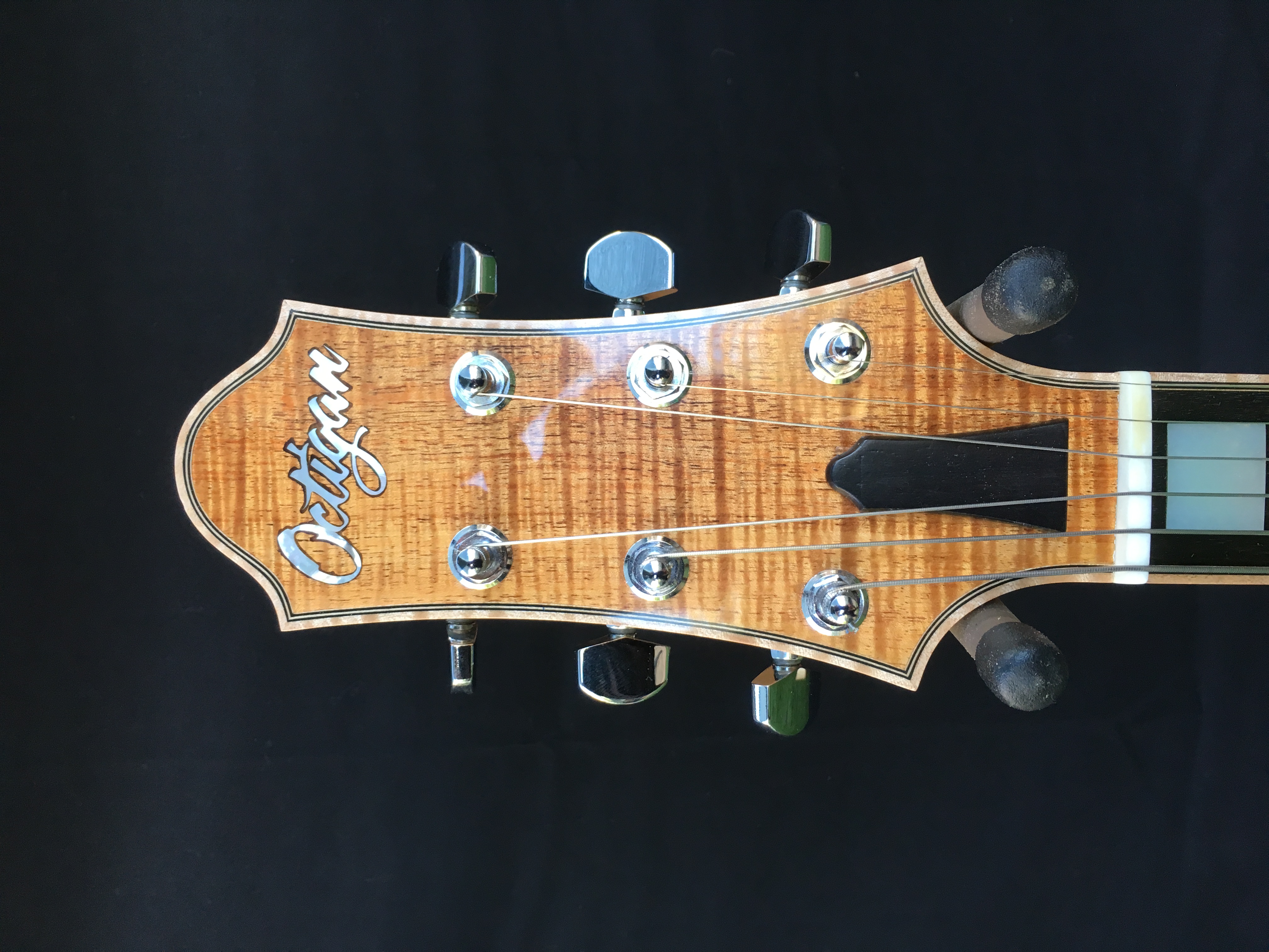

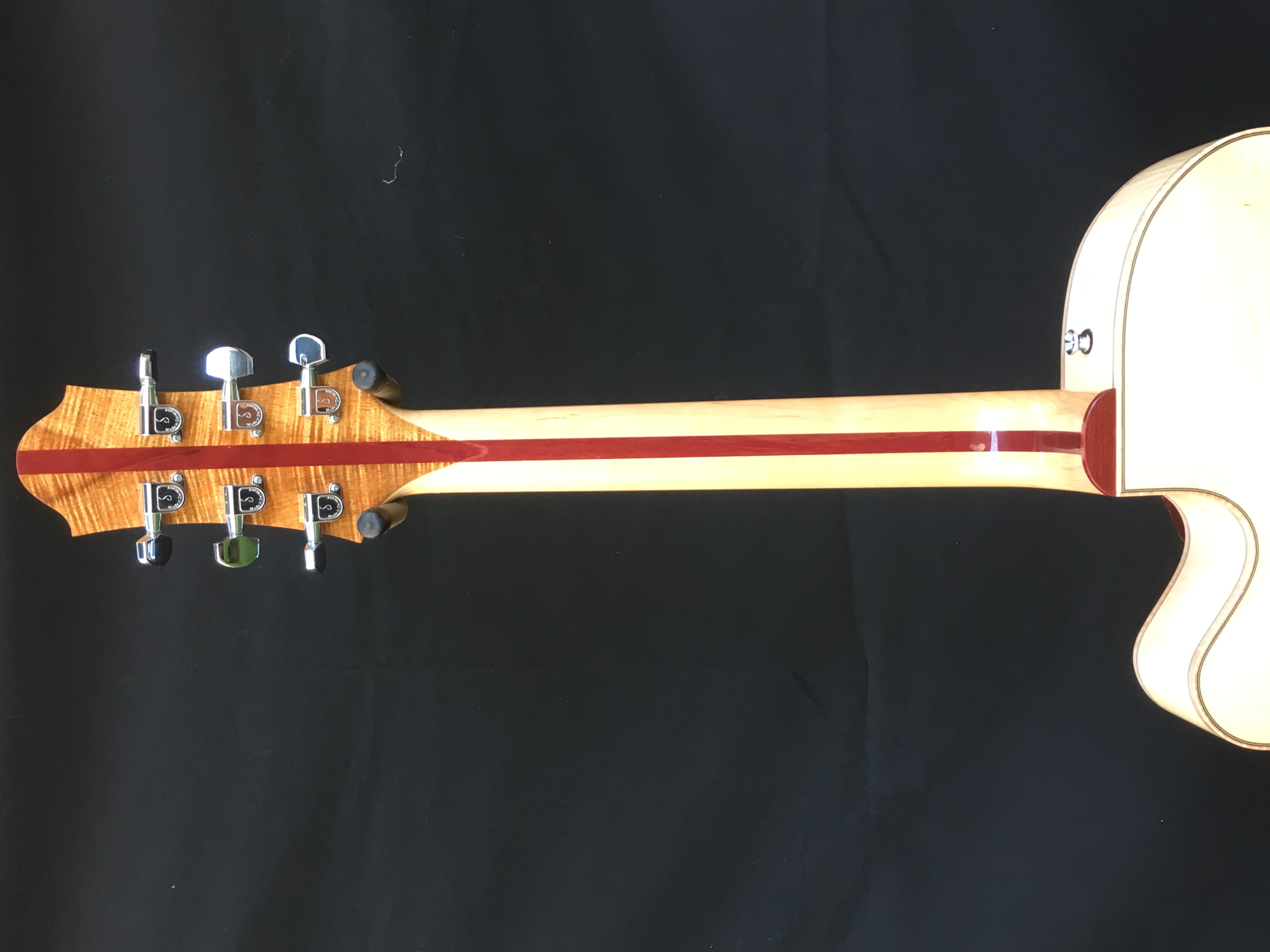

What is the neck timber? Laminations of bloodwood(?) (same as heel cap) and (?). And how did you do the blending of the bloodwood(?) lamination and the veneer at the back of the headstock?

Hi Greg nah that's Purple heart as is under the finger rest and bridge, and i made up the the back headstock veneer with the purple heart lamination in it and the applied it to the neck, just had to line it up perfectly, something i very rarely achieve (doing something perfectly)

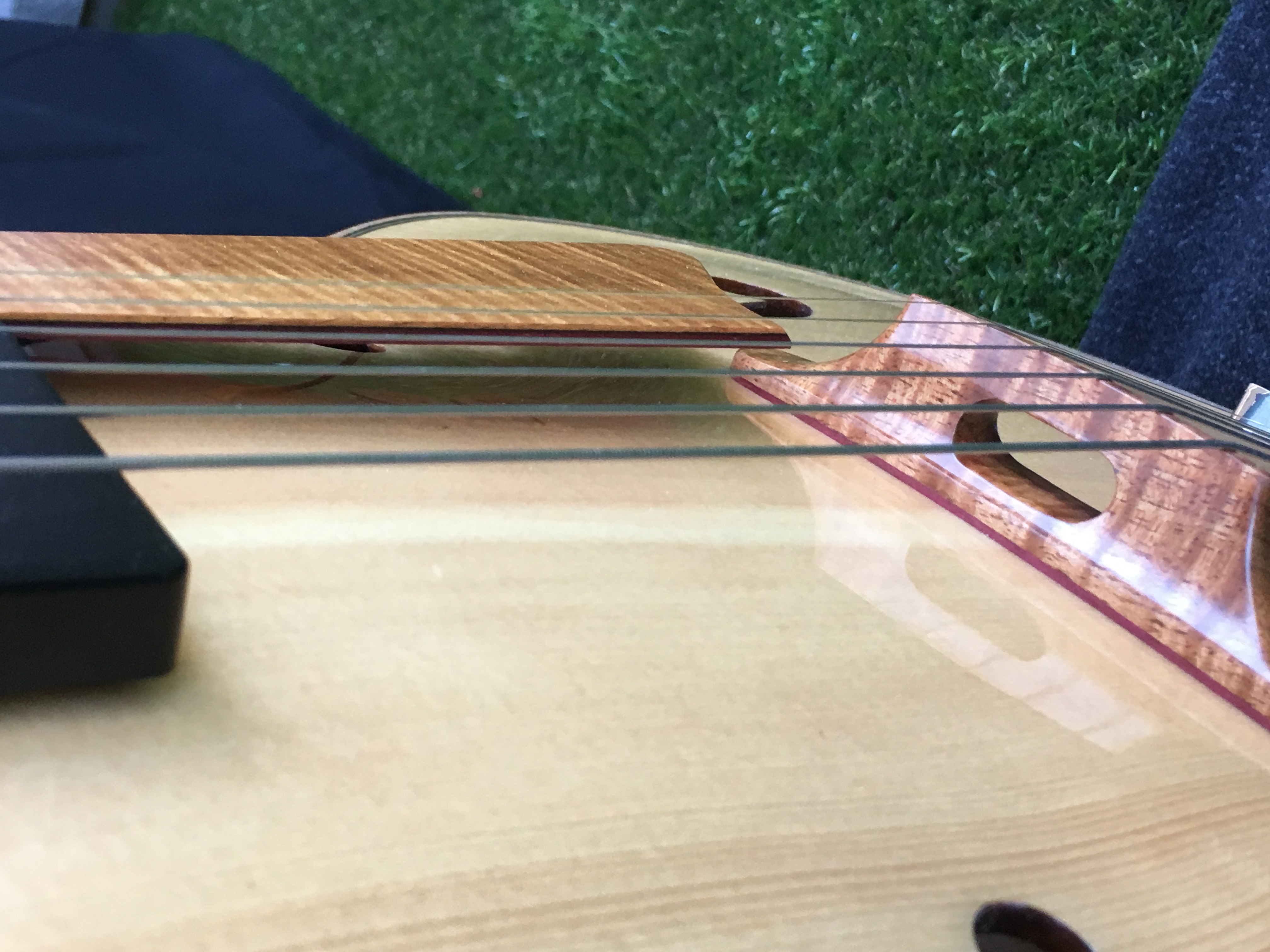

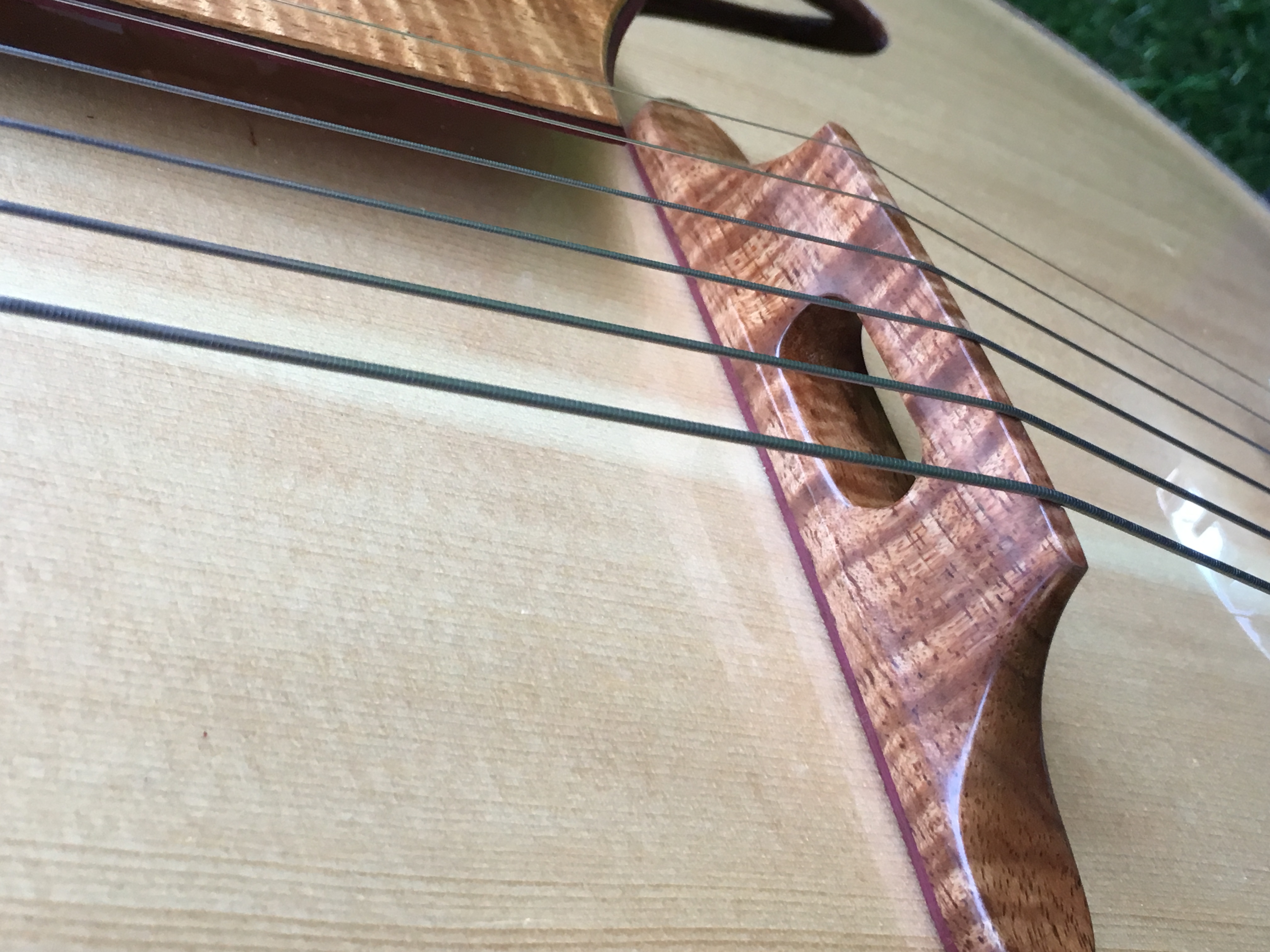

Looks great Rod. Is the lamination under the bridge for looks or did you need to make it a little taller?

Thanks Wayne, no the Purple Heart is there for the aesthetics, there’s actually still a bit of meat on the bridge so I’ll give it one final tweak just prior to delivery. I’ve used Purple Heart extensively in the build so it blends in well.

Beautiful work as usual Rod. However, my understanding having admittedly never got to the position and tooling of building an archtop myself but hope to begin soon, is that the bridge needs to be lightweight, and the soundboard and bracing needs to be such that a lightweight soundboard gives volume and projection...a snappy jazz sound. What is your opinion based on your build experience of bridge weight in the case of archtop guitars. I really like the tonality of the Benedetto pups, I use one on my John Liddy archtop, but sadly John passed away and I had not upgraded to one of his later builds which to both my ear and his were better and more lively as he evolved. He also learnt a lot from his efforts building F style Gibson mandolins.

Hi Ross, correct me if I’m wrong but I think you’re saying that this bridge looks as if it’s too heavy for this guitar! I think I could have made it a bit lighter but it isn’t too heavy at all, in fact it is lighter than your common two piece Tunomatic bridge.
As a rule I do try to build light especially this type of instrument and to that end I’ve incorporated cf in my bracing to add strength while reducing bulk.
In a non electric world all this is paramount but so much preference these days for amplification has seen the top mounted pup become so popular in jazz builds (Benedetto B6) a few more grams of weight in the bridge becomes insignificant when you’ve got pickups and pots hanging off the belly!
But back to this build,beside the aesthetics of this particular bridge I wanted to see if a one piece was possibly a better method of transmission of energy than the three piece including the thumb wheels and considering the amount of volume this instrument is pushing out,the combination I’ve put together here is on the right track.
I hope you are able to have the archtop experience sooner rather than later!!!
