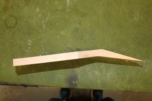

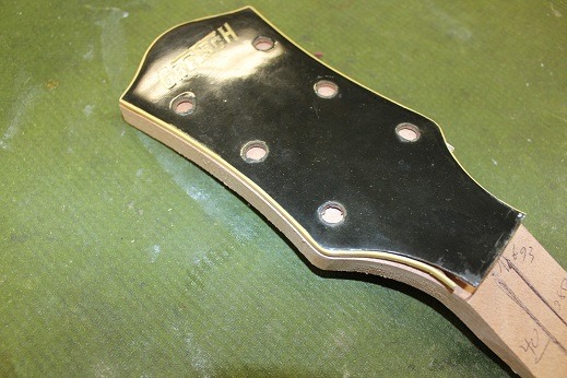

I had to replace an old gretsch headstock on a late 60’s guitar that had been well not repaired well, the new headstock I have made weighs less than half of what the original weighs (well what’s there of the original anyway)
Tempted to source some more dense mahogany and make another one
Replacement

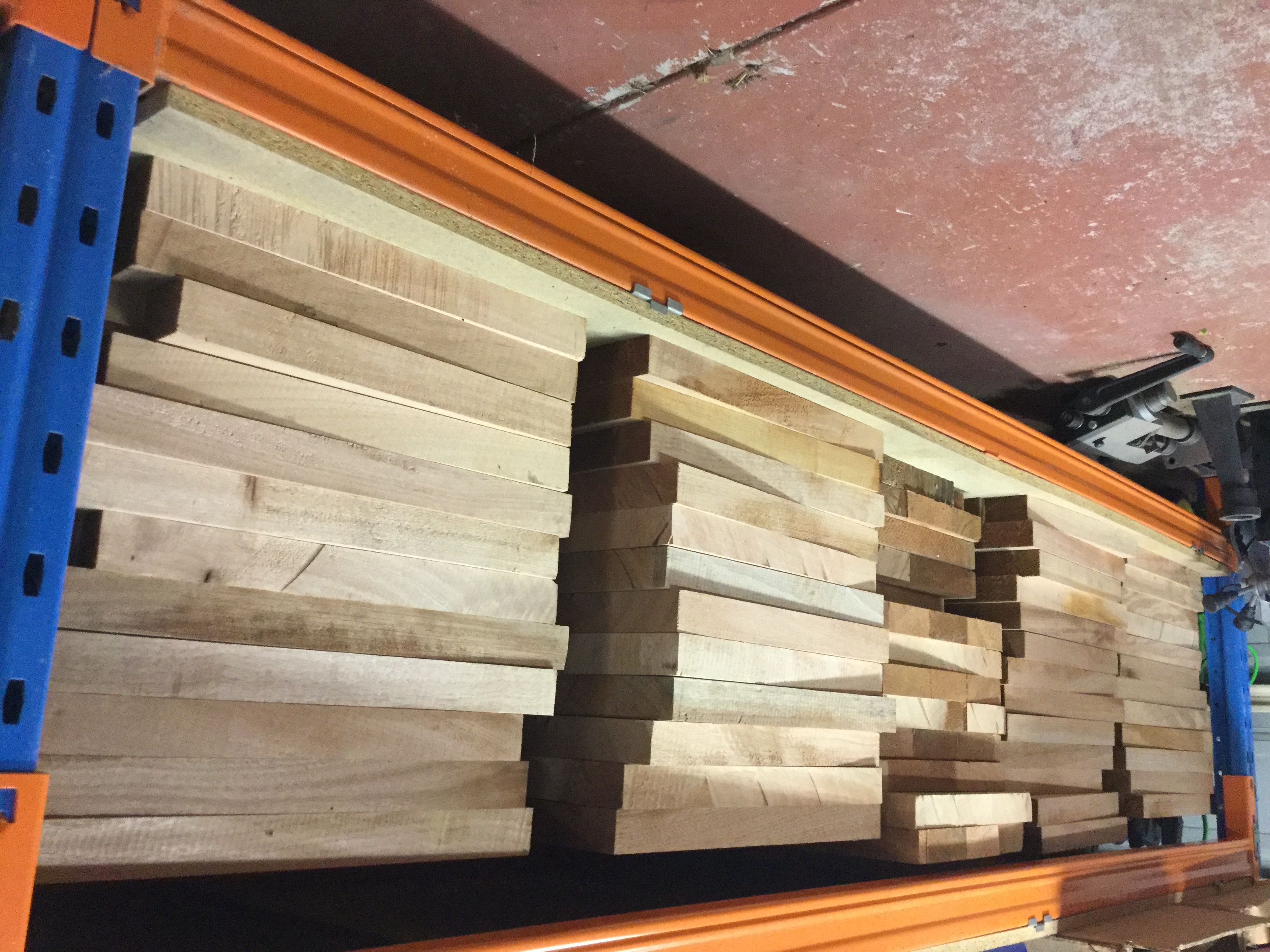

Starting to go through some of my old stock, trying to work out what’s what
Mostly Chinese mahogany, so I am guessing “Toona genus”

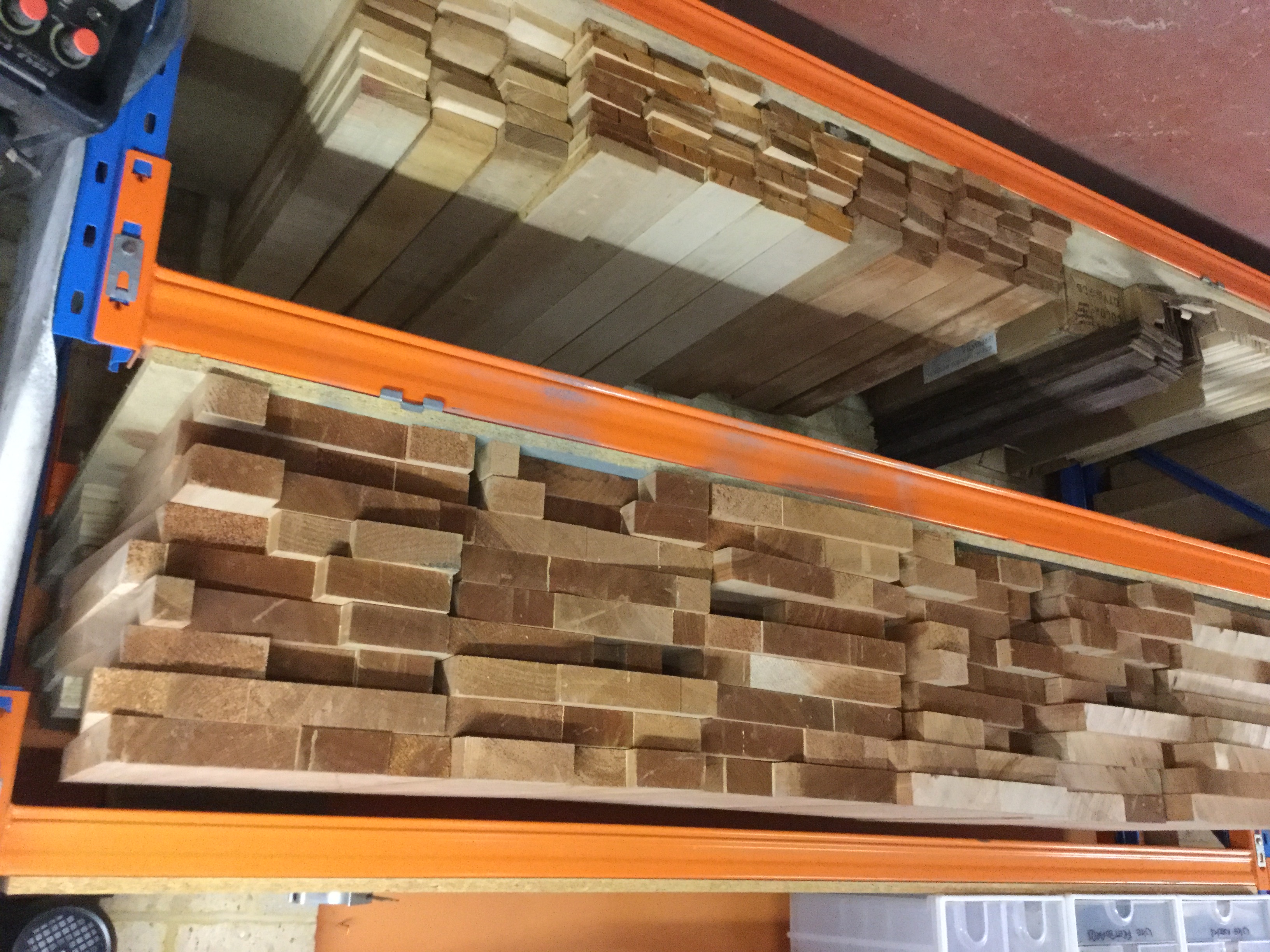

Another 120 blocks on this shelf, and more and more shelves

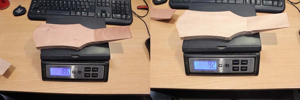

Allan shipped me a piece of his African Mahogany which he has for sale in the sale section.
Its good stuff and double the weight of anything I have here.
Mahogany density and strength is very related
On the left one of these blocks of wood weighs in at 186grams for a machined headstock,
On the right same machining program Mahogany Toona - Chinese mahogany, comes in at 92 grams

That’s interesting to see and I hope it helped you out.
I’ve never physically weighed it, I just know from working with it, feeling it and the finished products that this is my preferred Mahogany.
