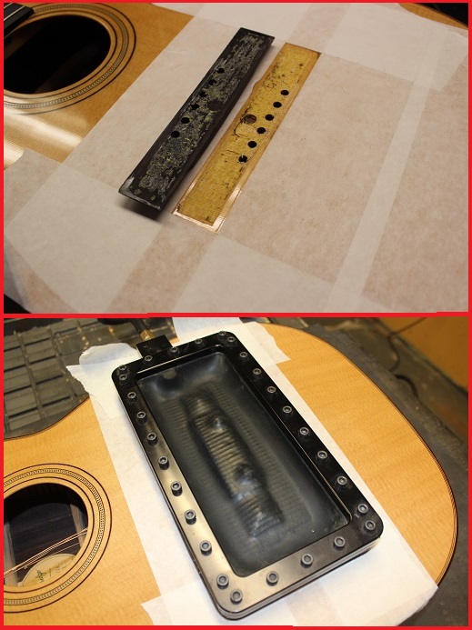

How to Vacuum Clamp Bridges
http://www.mirwa.com.au/HTS_Vacuum_Clamp_Bridge.html

Post by Mark McLean » Tue Oct 30, 2018 6:12 am
Thanks Steve. Nice demos, as usual.
No glue squeeze-out with your vacuum clamping pictorial?

Post by simso » Tue Oct 30, 2018 10:05 am
Missed that photo didn’t I, being hide glue just warm water was required at a couple of spots

Post by Mark McLean » Tue Oct 30, 2018 10:50 pm
OK. I am glad that I am not the only one who needs to clean up glue squeeze-out!
I did a vacuum clamping of a bridge tonight, with HHG. After 12 minutes of clamping I took the vacuum off and cleaned up the glue with hot water, soft cloth and a pointy stick. It took about a minute as the squeeze-out was still "booger consistency", but the bridge was holding tight by then. This was following the method Robbie O'Brien showed us. After a quick clean-up, - clamp it again. Looks good. I hope it holds!

Post by simso » Tue Oct 30, 2018 11:18 pm
What mix ratio is your hide glue to water.

Post by Gazm » Tue Oct 30, 2018 11:29 pm
Thanks for your informative tutes Steve.
What gram strength & clarity of HHG do you use for successful bridge glue ups?

Post by simso » Wed Oct 31, 2018 12:31 am
I just use Behlens low strength 160gram I think it is, mixed 50/50 with water, this allows for me faster drying times and more glue in the joint. With hide glue as always, fit and finish of the joint is paramount to success.
