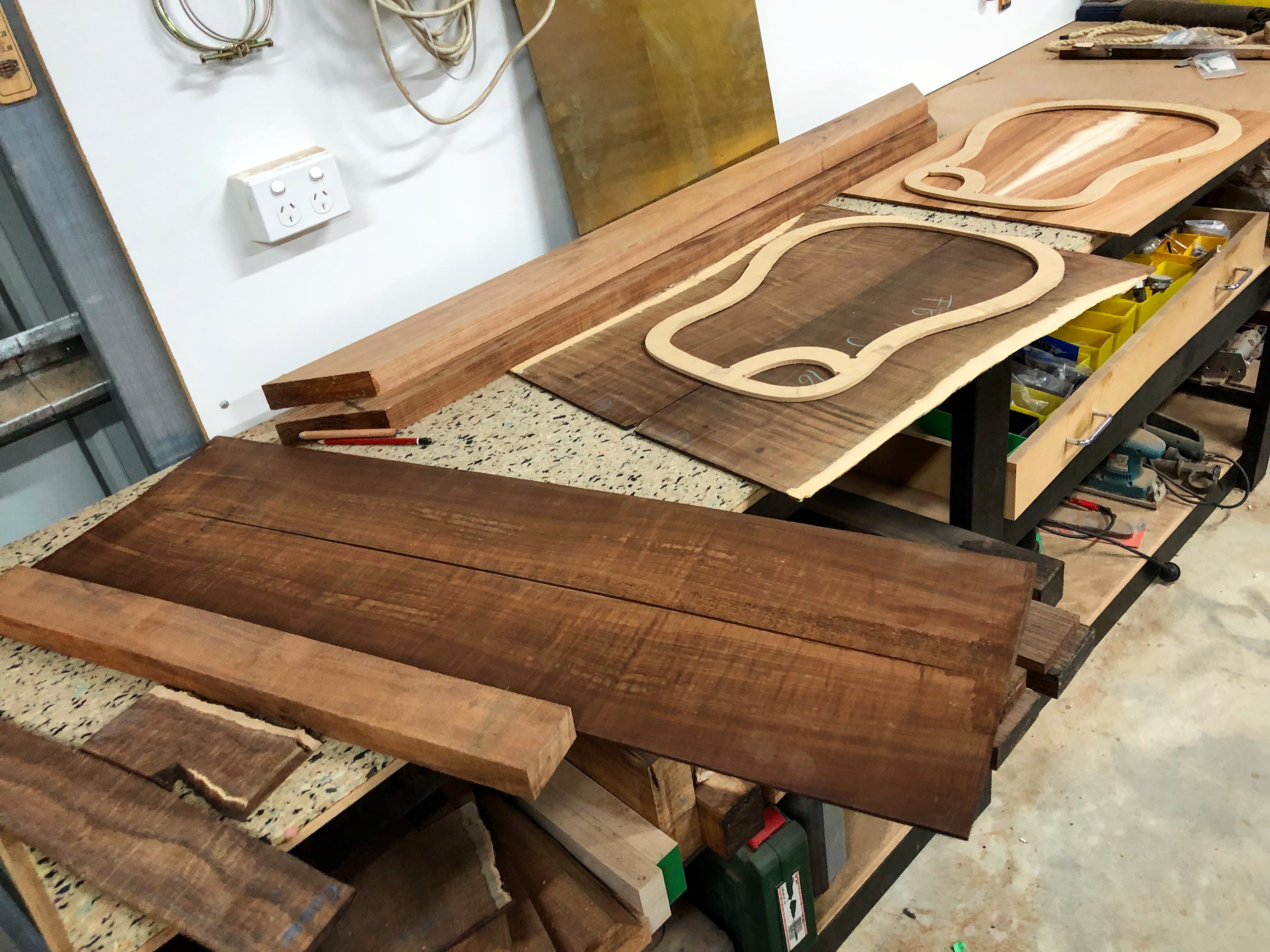

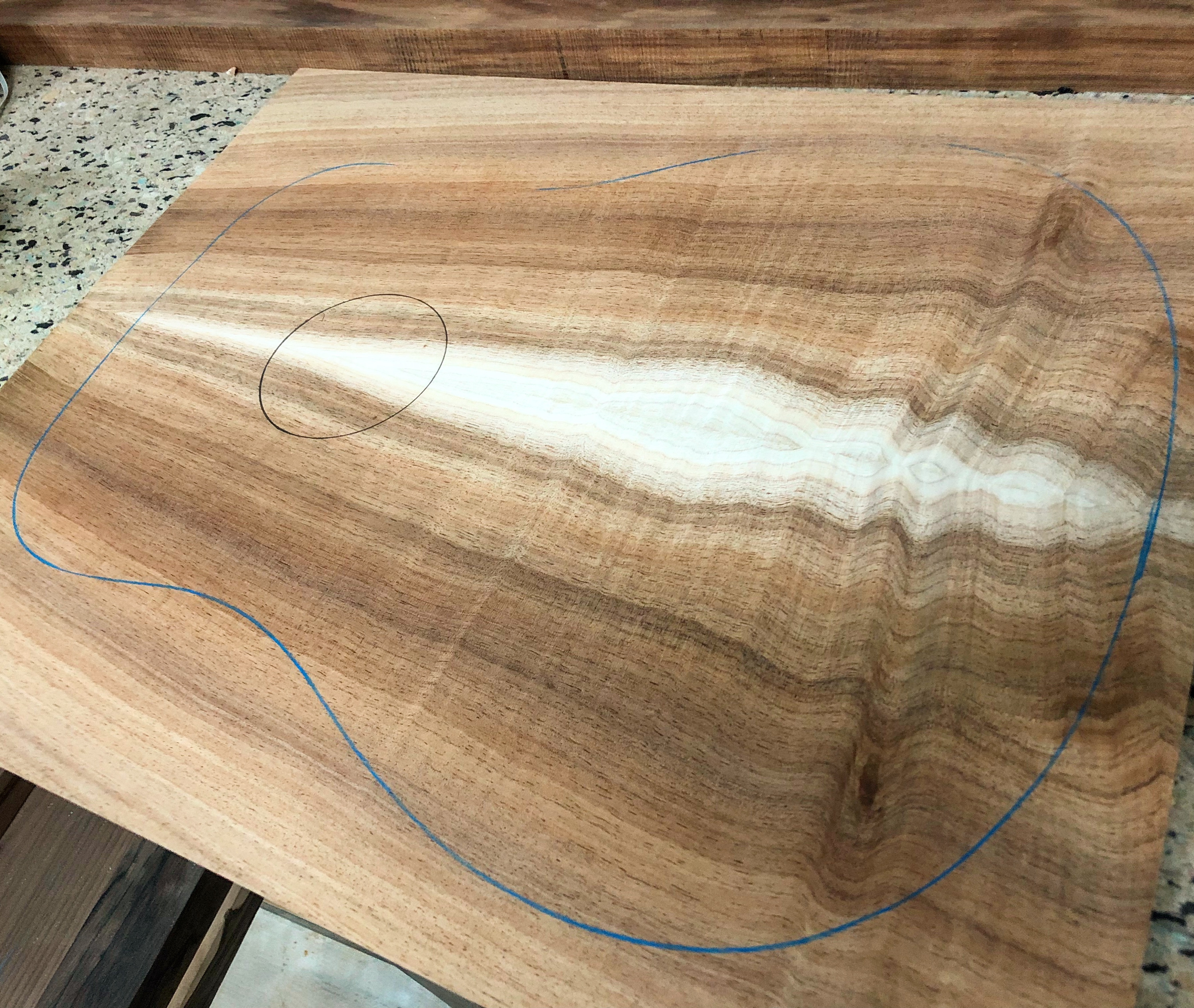

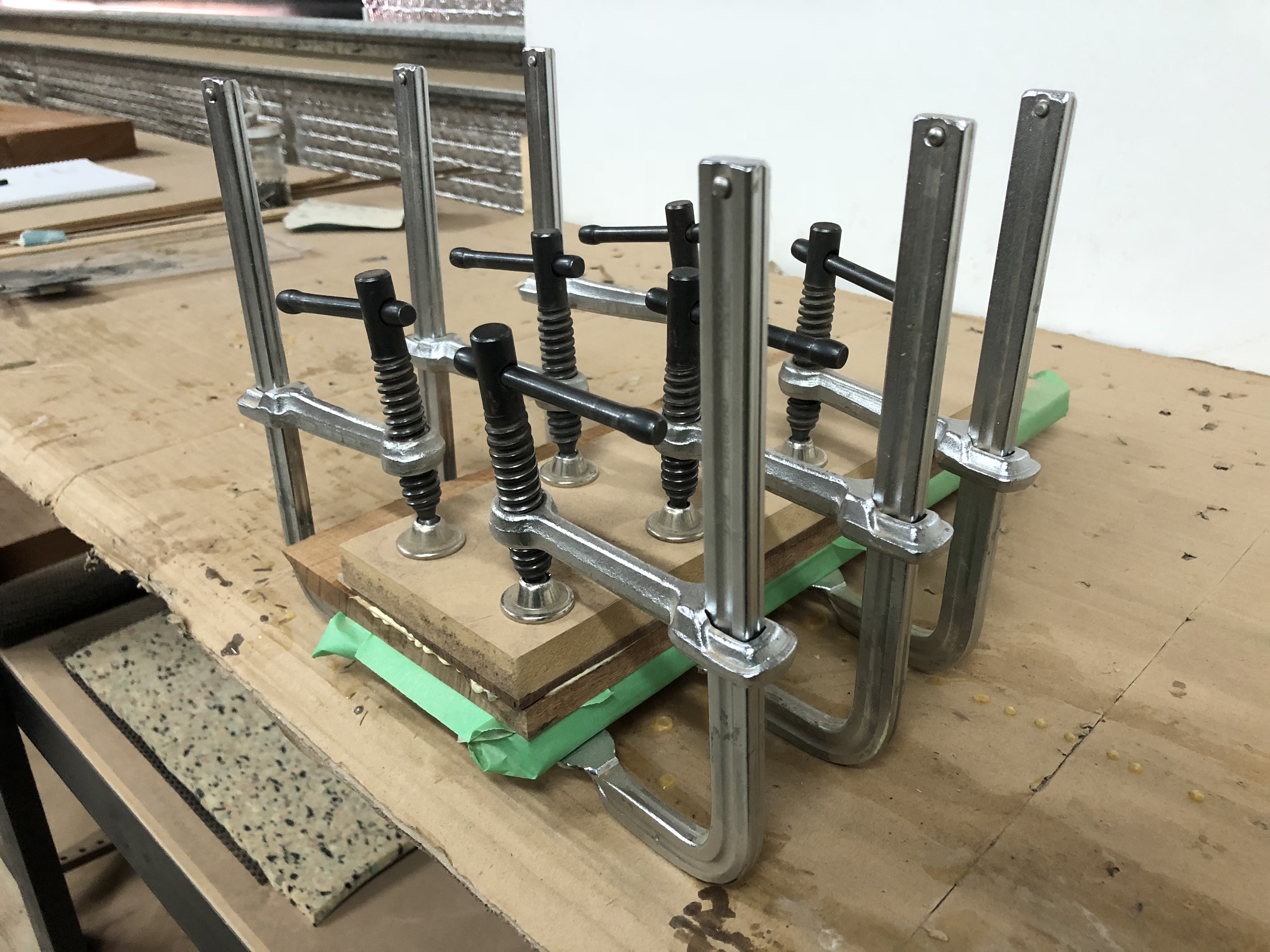

Hi guys, it’s been quite a while since I’ve done a build thread here and I have a pile of timber I’ve put together for a (mostly) Acacia dread I plan to start next week.
I say “mostly” Acacia as at this stage I think I’ll use cedar for the bracing and I’ll probably use Mahogany for the purf, other than that every timber will be Acacia, unless I decide to go with Ebony bindings, I’ll work that out on the day, see what sort of mood I’m in.
With that said, I’ll be doing the same with the cutaway, at this point I’m leaning towards no cutaway, I’ll work that out next week on the day I start bending the sides!
Blackwood top (ADD 430!!)
Ringed Gidgee back and sides
Ringed Gidgee fingerboard and bridge
Ringed Gidgee headstock cap (May go with ebony for colour contrast, still undecided)
Fiddleback Blackwood neck
I welcome any feedback/suggestions!

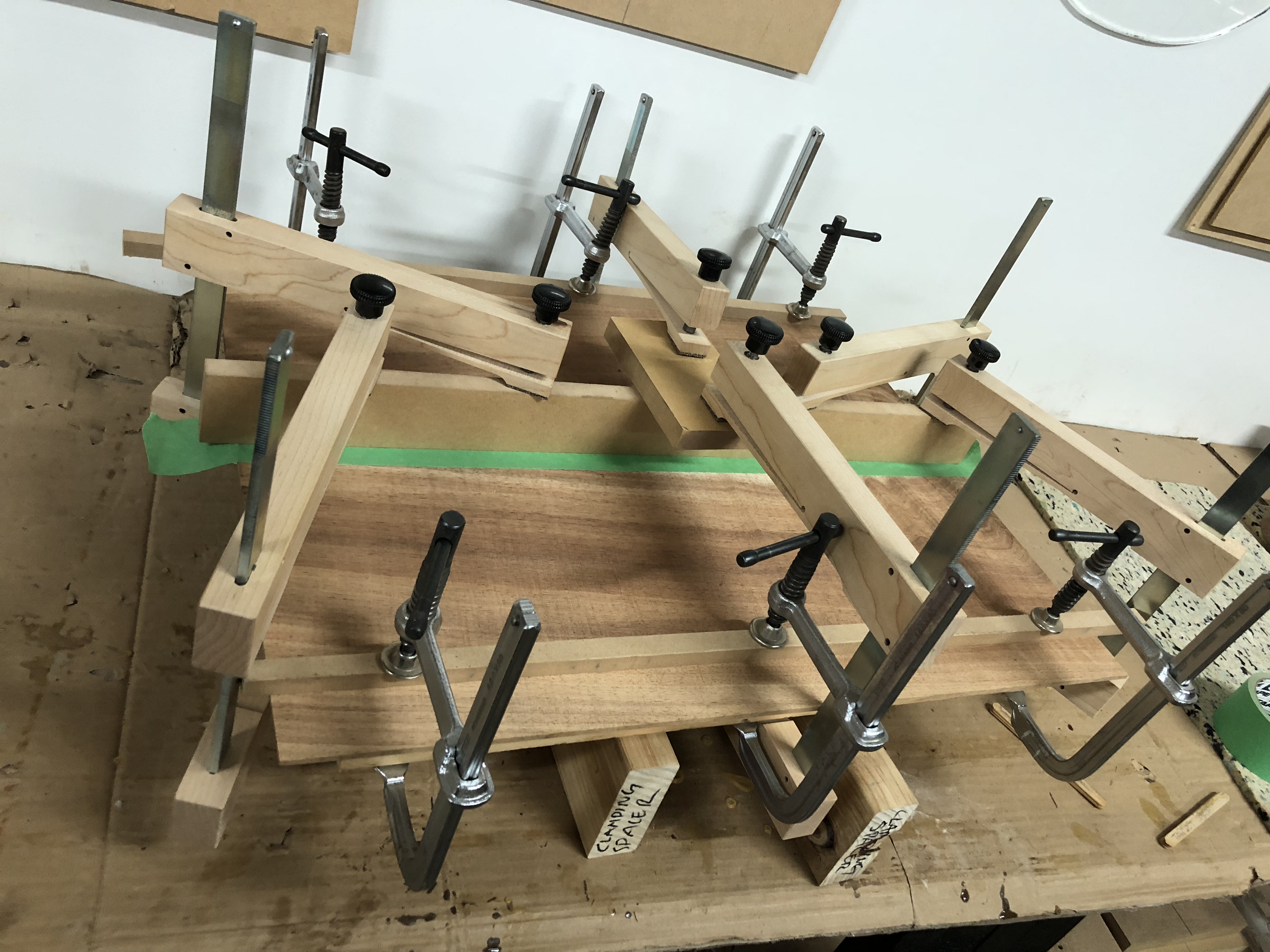

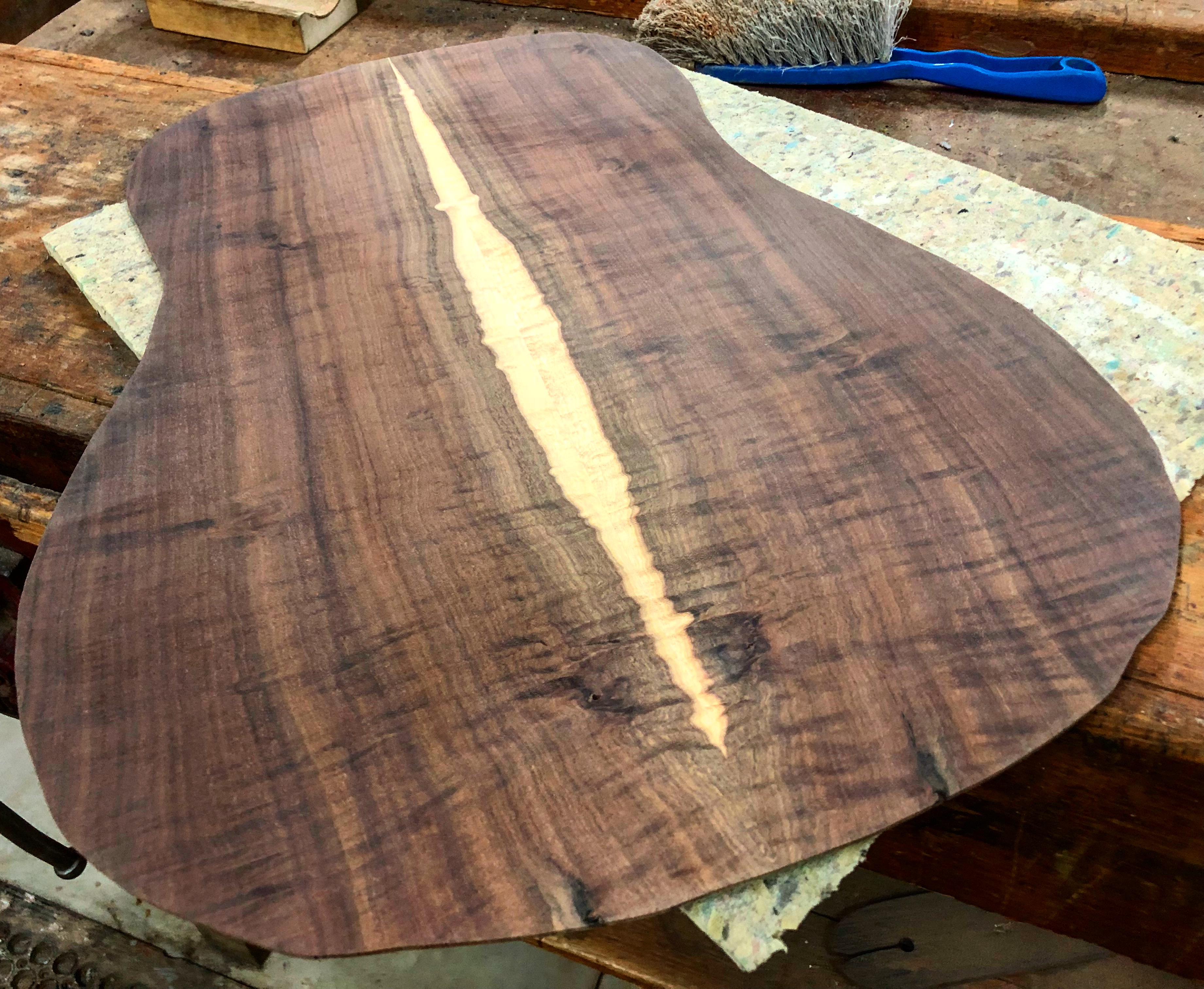

Everyone has their preferred way to join plates, various jigs and clamps whatever. I’ve tried many and this is the way I keep going back to.
A thick back board so there’s no flex, clamp the first plate down with a spacer in the center (at each end), push the second plate into it and clamp, then remove spacers so the plates push together and then clamp the seam down.
This is the method I’ve had the cleanest joins with and it seems to never fail me.

This morning I cleaned up the top and back, also glued down the back strip. I was going to use Blackwood for the back strip however I noticed some Mahogany strips I had cut and drum sanded last year, so I just used those out of convenience.

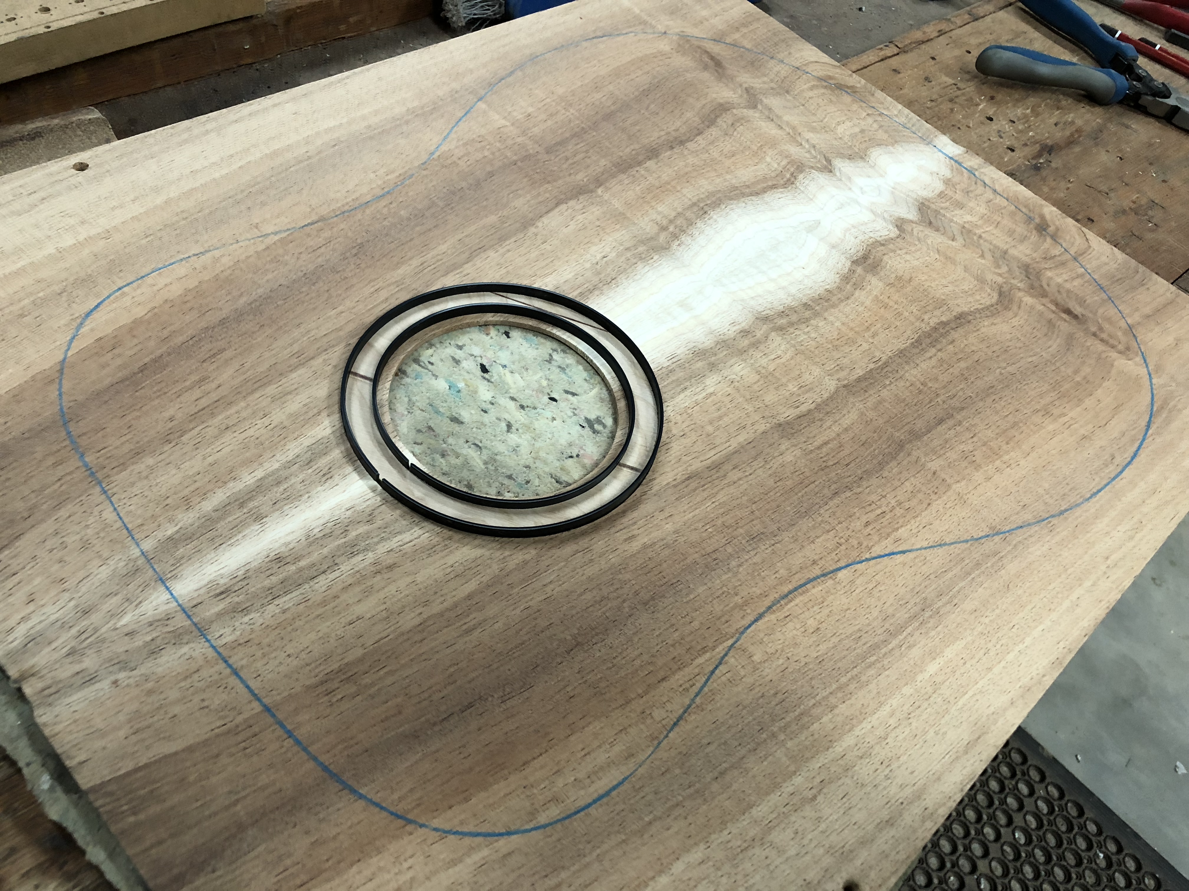

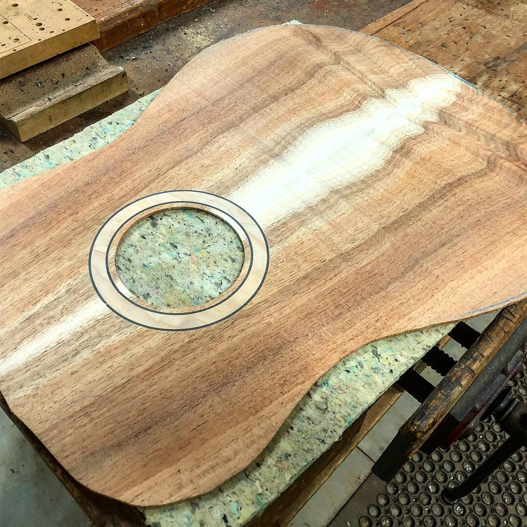

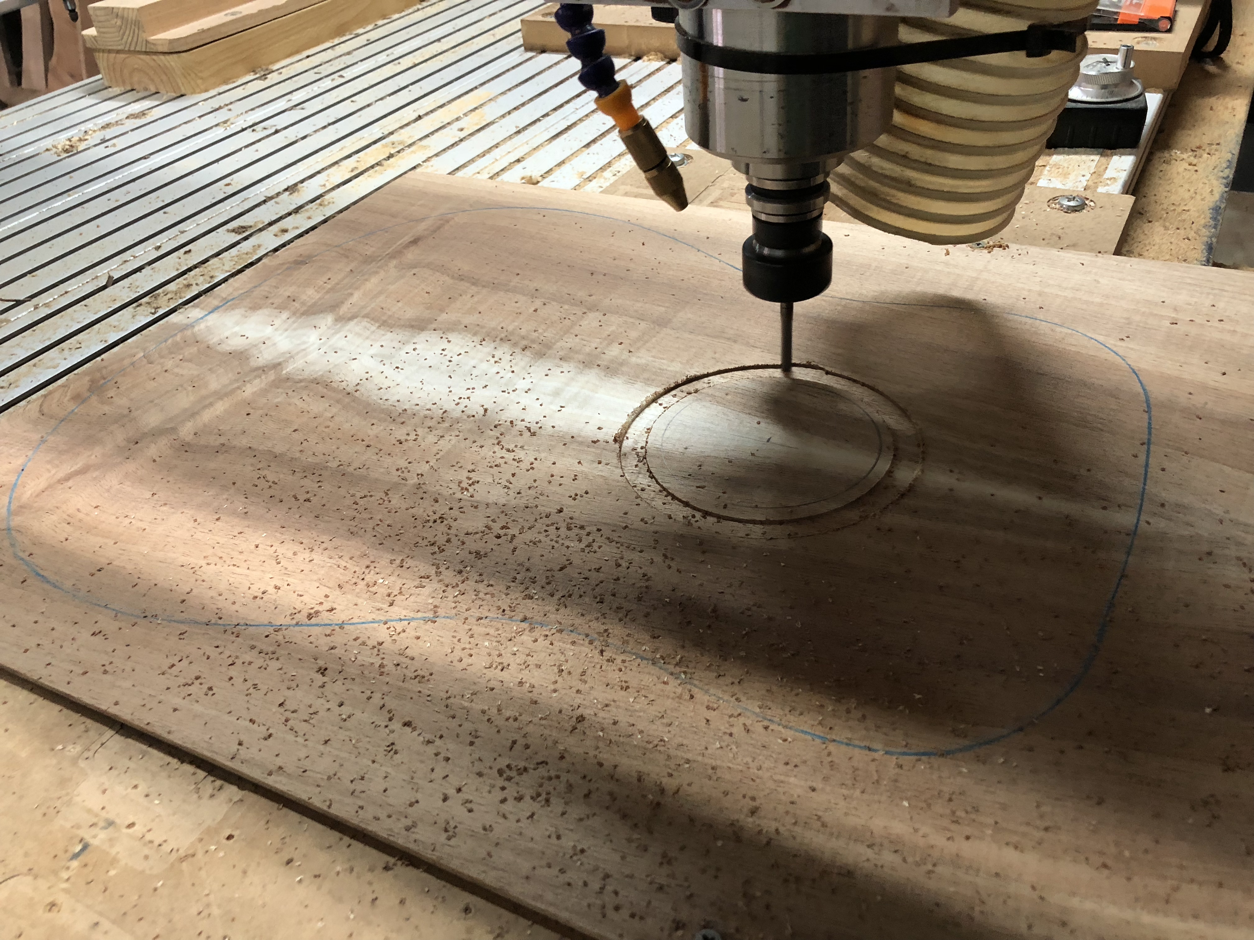

In between other jobs I did a little bit more on this one in the arvo, started the Rosette, a single piece of quilted maple. Rosette and recess cut using a spinny fast tool thingy.
I also started the headstock joinery, which is the cap and a 1mm veneer in between

The top will be 3.5mm at finished thickness.

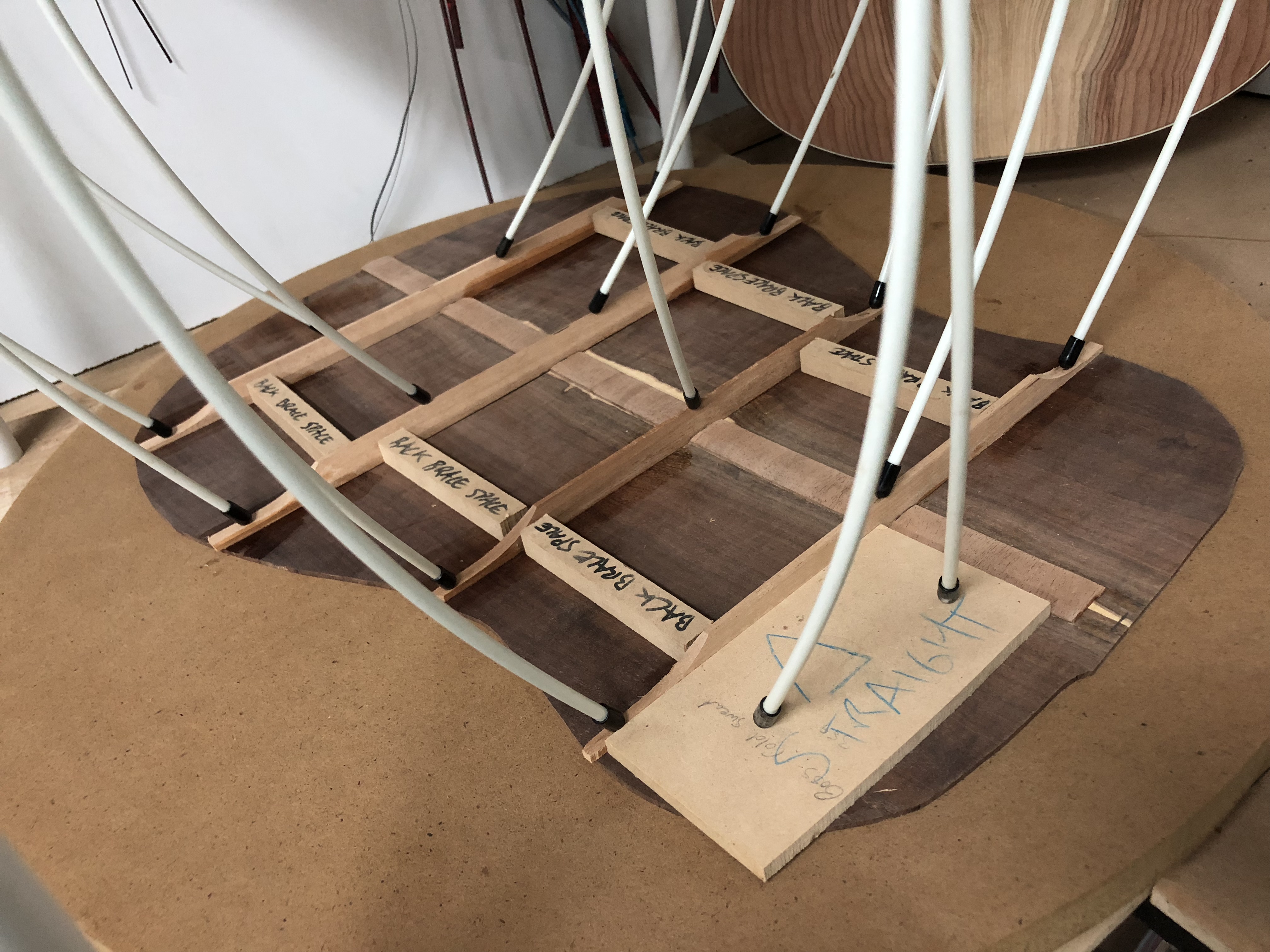

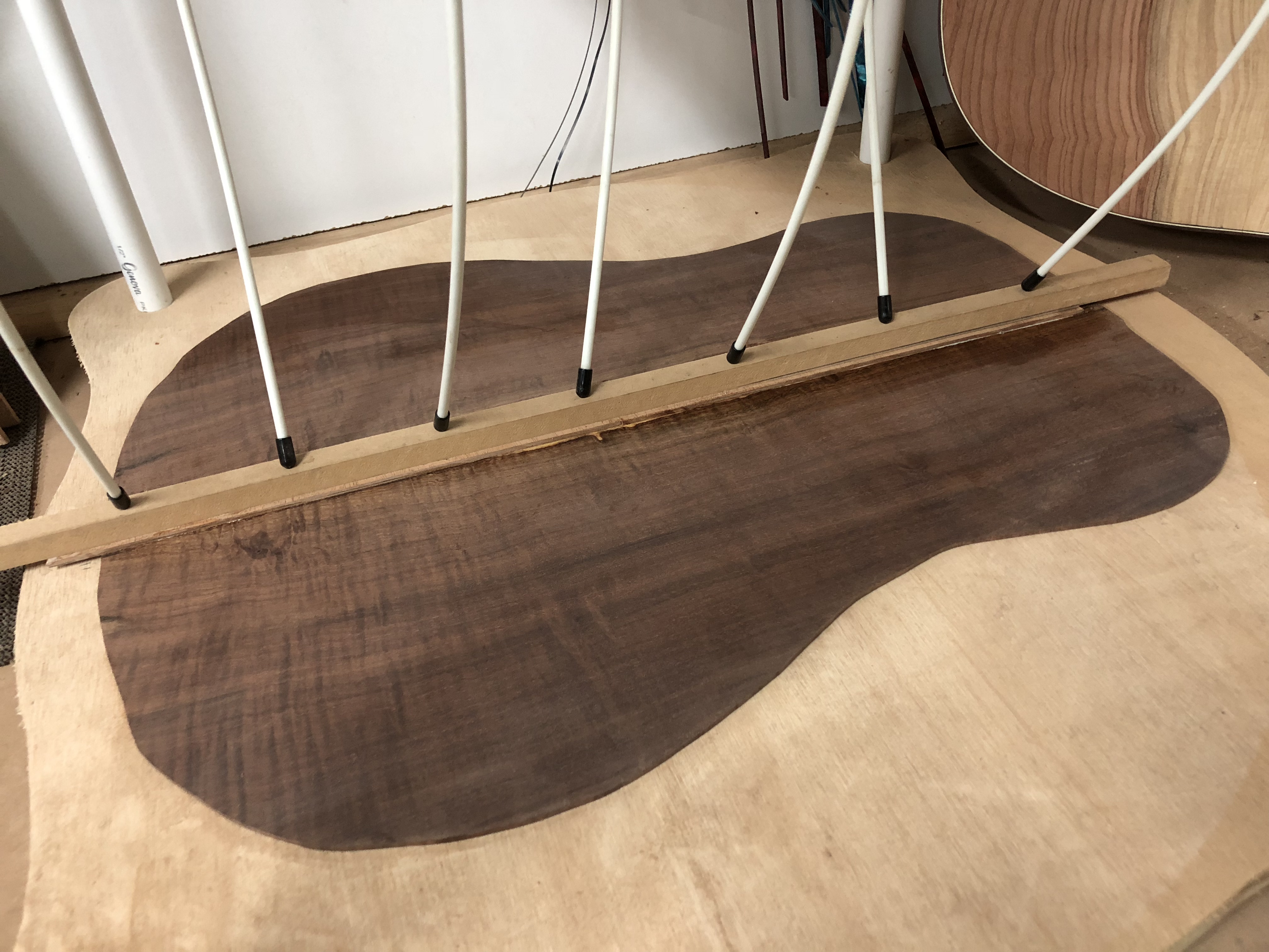

Won’t get much time to spend on this one today, but I wanted to at least get the back bracing clamped down.
I do something I’ve never seen anyone else do and use spacers. On one build I did I had a brace move on me after I’d walked away from it and I cane up with this idea so it never happened again. The first part of MDF starts them off square and then the spacers do the rest

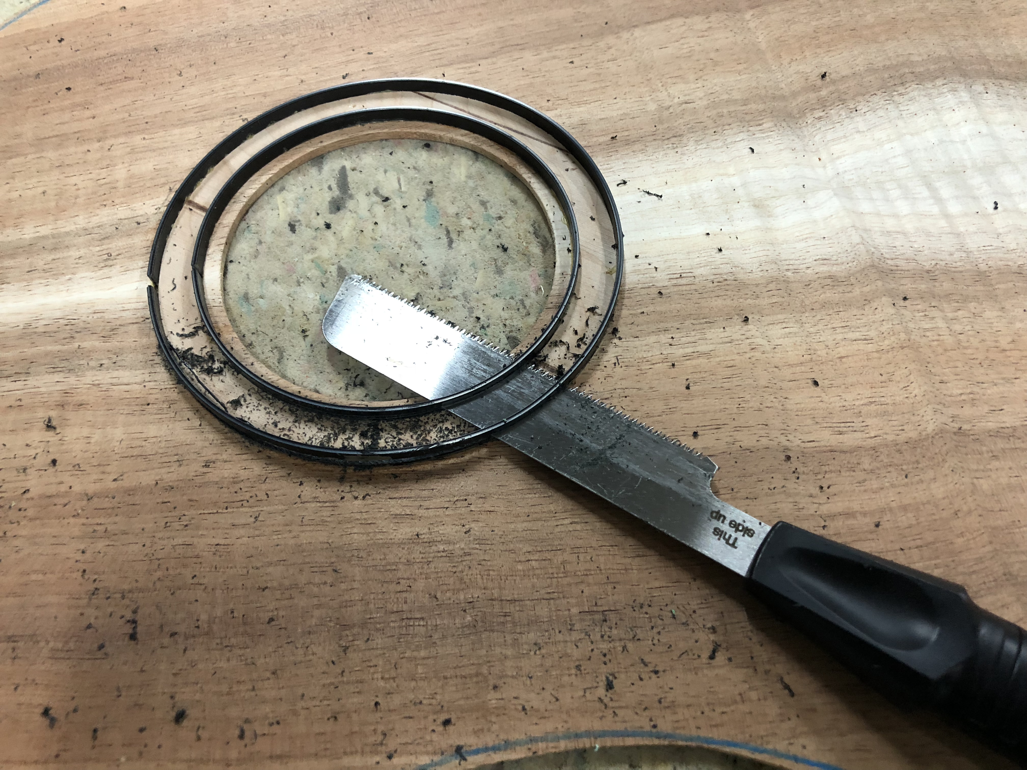

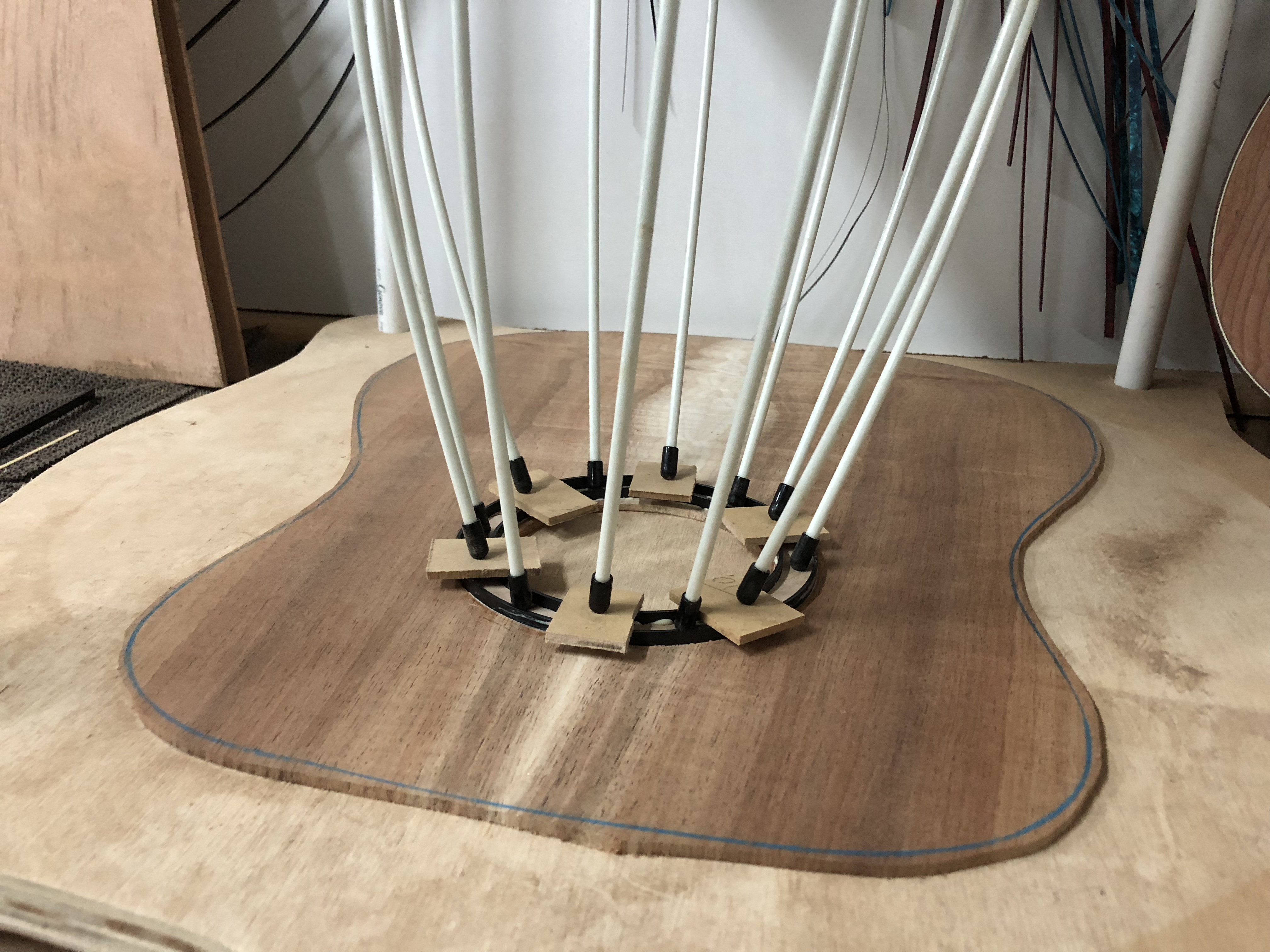

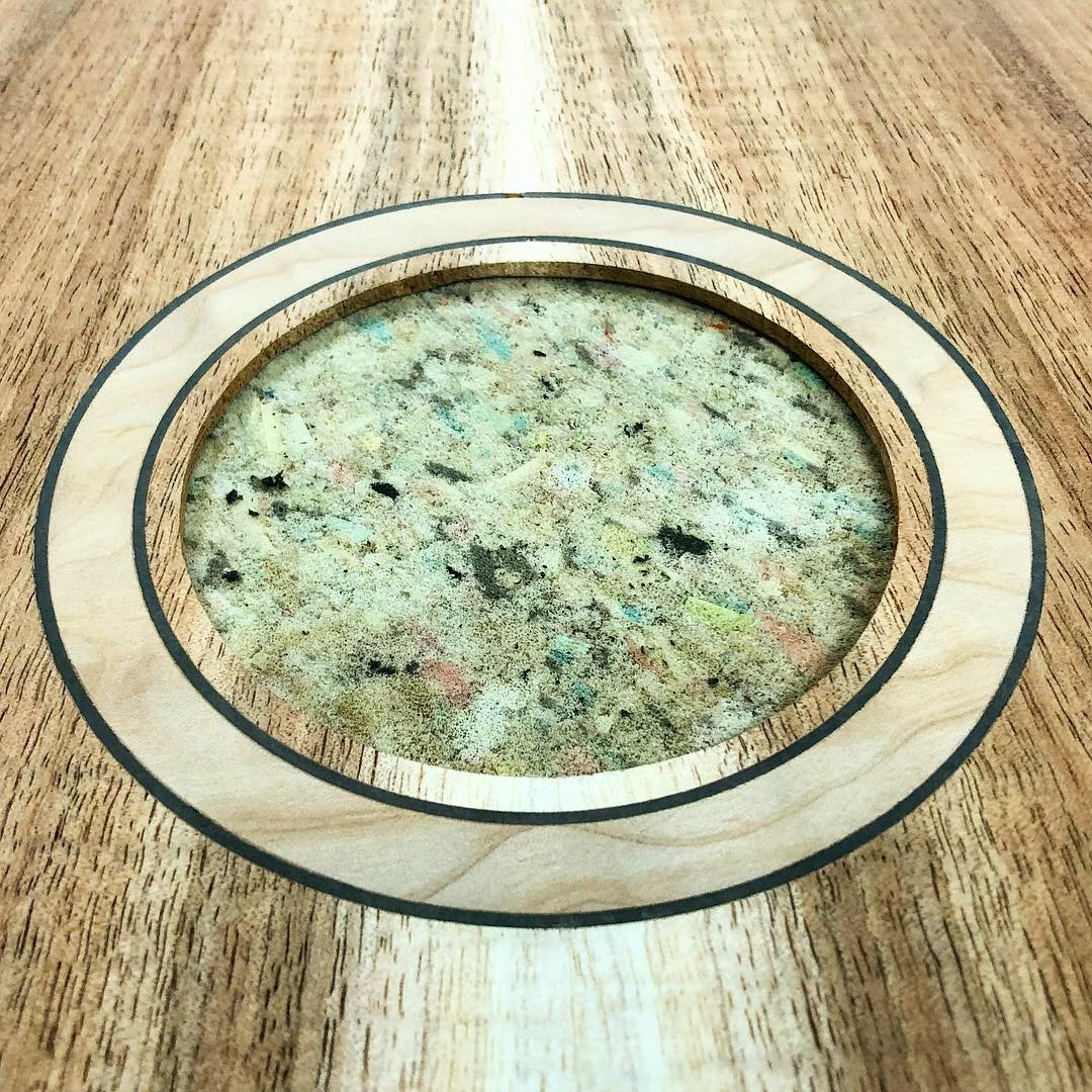

Rosette progress
Flush cut saw doesn’t get used very often, however it is handy at times:
After a bit of scraping and sanding:
