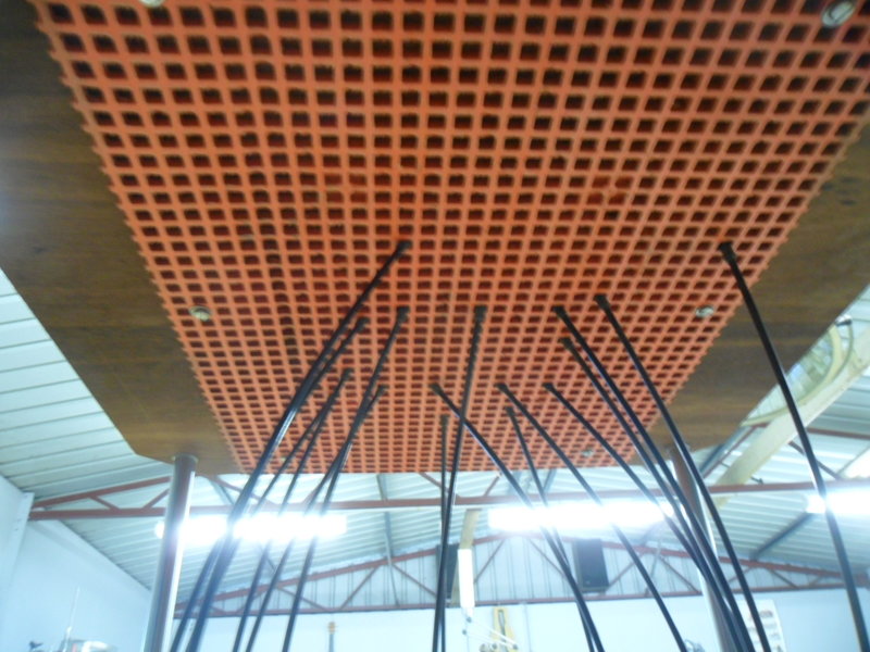

I use bamboo. I bought some bamboo screening at Bunnings, which is multiple lengths of bamboo laced together with light wire. Cut the wire and I ended up with dozens of usable go bar rods for about $9. I bought little rubber caps to put on each end (also Bunnings). There are white caps and black. The black ones leave black smudges in your work.

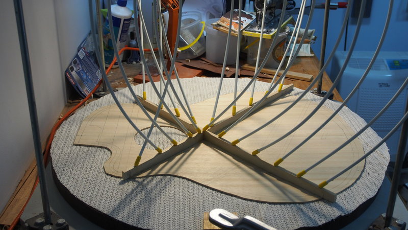

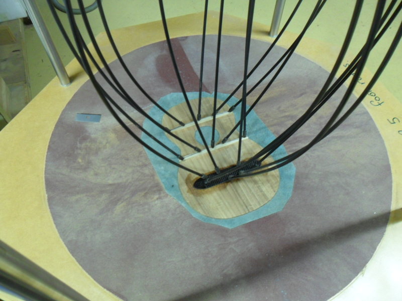

Hi Nigel.
About 10 years ago, I decided to make a kick-arse go-bar deck, and naturally the issue about what might be the most appropriate rods needed to be addressed.
I began with the following criteria in mind (and I've had pause to reconsider these over the years) but overall, I've been very happy with how things turned out:
* "Floor-to-ceiling" distance, i.e height that the rods would need to span - 800 mm. I based this roughly on the go-bar decks being offered commercially by places like StewMac and LMI. I made my deck height adjustable, but I've never bothered to change it; it works just fine. I sometimes dismantle it, because my workshop is very small.
* Based on the way I thought things would work, I decided that the rods I'd need would be 900 mm long. I.e. they'd always be somewhat bent when they went into the 800 mm deck.
* I approached an organisation in Sydney selling fiber / resin (not actually fiberglass) rods used as battens in sail-boats, and quickly discovered that there is an organisation - Permex Products Australia - extruding such rods here in Australia, and distributing them throughout the country. You will thus be able to order them (or maybe they'll even be in stock) at any places that sell sails for dinghies and the like. You can easily find them on the internet. In fact, I bought the rods directly from Permex, and they cut them to length and posted them to me once we'd worked out what I wanted. One can also choose from a range of "tips" that go on the end of the rods (presumably to stop them from eventually poking themselves through the fabric of the sails), but I never bought any; I've just rounded and smoothed the sharp ends off the rods with sandpaper.
* I gave them the criterion that I wanted each rod to exert a force of around 7 kg, when a 900 mm rod was forced into a space of 800 mm. They (understandably) didn't know which rod might be most suitable so they sent me a bunch of samples of varying diameters, and I came to the conclusion that an 7.2 mm diameter rod was what I wanted. I ordered 15 of these. At the time, these cost around $3.00 a meter.
* Once I started using them it became very clear - much to my delight! - that within very wide limits, it made no difference how drastically I bent them, the force they would exert was an extremely reproducible 7.0 kg. By that I mean, whether I was bending a 900 mm long rod into an 800 mm space or a 400 mm space, the force (and I measured this all using a bathroom scale) was always around 7.0 kg. I've been using them for the last 10 years, and they still each exert exactly this same force, and spring back perfectly strait when I take them out of the deck. None have ever snapped.
* In retrospect, I think that I should have bought 20 rods, and over the years I've worried that 7 kg force per rod might be way too much, and that the joints might become starved of glue because too much might squeeze out - but so far, I've not had a problem. If I was to do this again, I'd probably buy the 5 mm or 4 mm rod that they offer. That way the force will probably be more like 3 or 2 kg respectively. (And I see that you, Paul, are using a 4 mm diameter rod, and getting 2.6 kg from them. Permex also make a 4.5 mm diameter rod. Maybe that's optimal - but I'm still happy enough with what I'm getting.)
*One thing to consider is that if you happen to use (be afraid; be very afraid!) 20 go-bars at one time, their combined force on the deck is going to be (in my case of 7 kg per bar), a total of 140 kg! Even though I used pretty thick MDF when making the deck, I can see that it has become very slightly dished over the years. This isn't a problem for the "ceiling" but although I insert a predetermined radiused dish when gluing braces, I no longer have a perfectly flat "floor"surface, should I need one. (And I too really love your solution to preventing rods from slipping on the "ceiling", Paul!)

All that remains now is where to get the plastic lattice.
Cheers Ross
Yes, springs are linear, including soundboards and braces, within reason...also a very good point re the additive load on a gobar deck. I use a few different pieces of MDF to adjust the height of the deck and then put my radius dish on top of that. I have also glued and repaired braces using a piece of 15mm Kmart neoprene which was sold as a 'yoga mat' as a radius 'dish'. This conforms to compound radius braces, eg Selmeroid builds (Selmer Maccaferri) and archtopbrace repair.within very wide limits, it made no difference how drastically I bent them, the force they would exert was an extremely reproducible 7.0 kg. By that I mean, whether I was bending a 900 mm long rod into an 800 mm space or a 400 mm space, the force (and I measured this all using a bathroom scale) was always around 7.0 kg.
I'm wondering where the 7 kg figure originated here? With additive force on the braces, given that for each brace there are multiple rods, is 7 kg overkill?I gave them the criterion that I wanted each rod to exert a force of around 7 kg, when a 900 mm rod was forced into a space of 800 mm I gave them the criterion that I wanted each rod to exert a force of around 7 kg, when a 900 mm rod was forced into a space of 800 mm
Cheers Ross

"I'm wondering where the 7 kg figure originated here? With additive force on the braces, given that for each brace there are multiple rods, is 7 kg overkill?"
The 7 kg figure was just sucked out of my head! I'd never used a go-bar deck before attempting to build one. At the time, it just seemed like a good number. In retrospect, I think 7 kg is too great a force, and between 3 kg and 5 kg is a better number. Those with "true" knowledge of the matter (like, someone who has bought a commercially available deck and go-bars might wish to chime in here .......
Frank
Frank
Re: Go-bar rods
My hoop pine go bars generally exert pressure around the 7Kg mark. Not huge when you consider how much pressure you can exert with a cam clamp.
mooshalah wrote: ↑Wed Dec 19, 2018 2:46 pm"I'm wondering where the 7 kg figure originated here? With additive force on the braces, given that for each brace there are multiple rods, is 7 kg overkill?"
Frank
