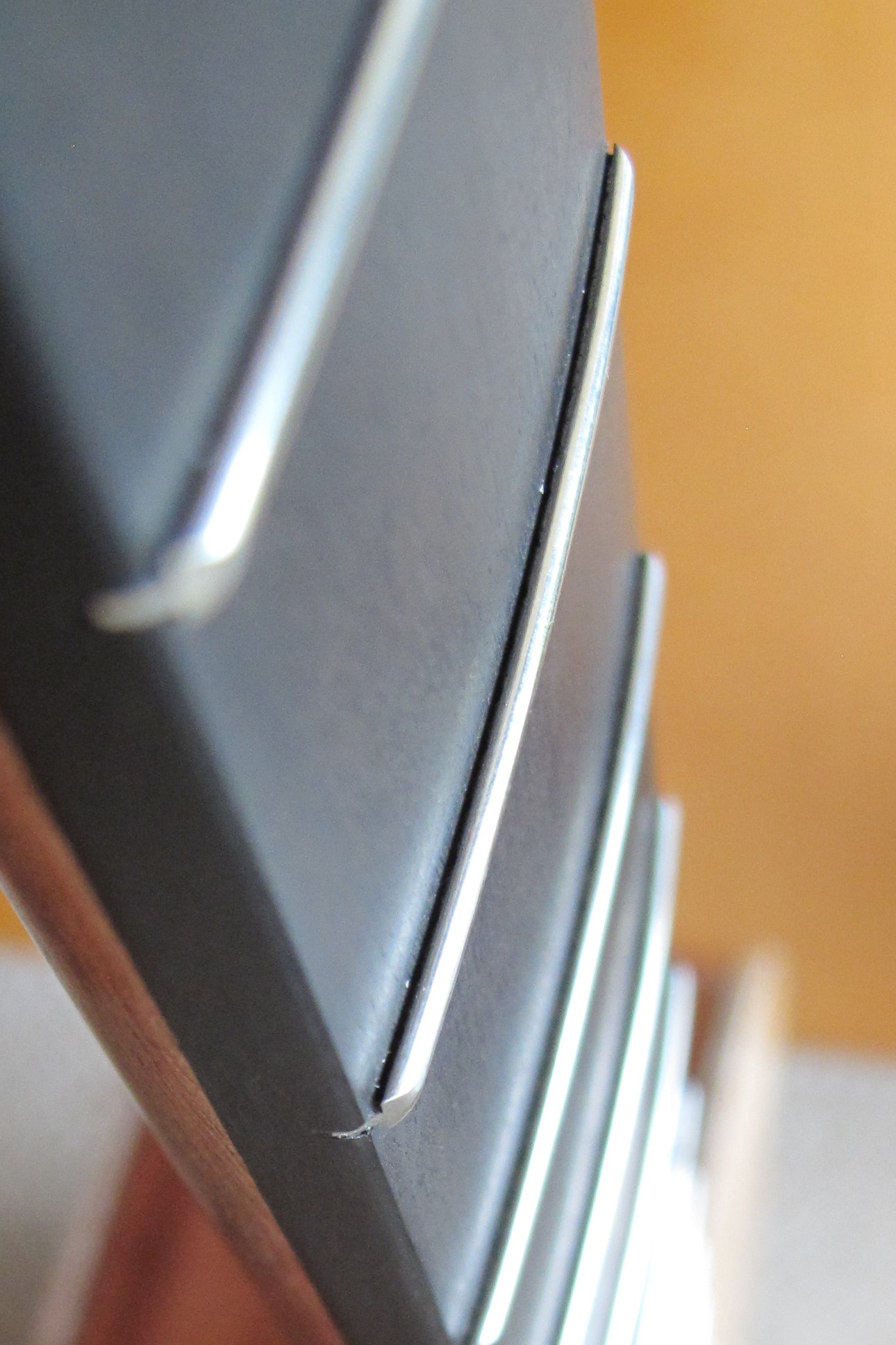

Hi all
I have had a bit of a disaster on the fretting front on my second build :cry: . I didn't notice till it was too late so just kept going which was, in hindsight, a mistake. Obviously, from the pic, they are not seating properly. Most are fairly similar, some slightly better than others. I'm not sure if the slots were too narrow (they were pretty tight) or not deep enough - it was a pre-slotted board so I guess I assumed it would work. Apart from heating the frets with a soldering iron to melt the titebond and yanking them out - risking ruining the fret board, are there any other remedies for a newby? I read that a bead of superglue could be run under the fret http://fingerlakesguitarrepair.com/repa ... -fretwork/ to improve things without pulling them out or should i just leave them for now and see how it plays? They are fairly well lined up and I can file and crown them so, apart from high spots and potential for buzz, what are the other main problems with this poor seating?

Looking at the bottom photo and in particular the side of the fretboard there appears to be a gap between the bottom of the fret tang and the bottom of the slot. is this actually the case? If so then slot width could be the problem. Regardless recutting the slot is IMO the best option. Jamming frets into undersized slots can potentially have the effect of inducing back bow in the neck.

I don't think there is much of a gap under the frets, if any, but the slots may be too narrow as well as you point out. Only having fretted one instrument means I haven't got much of a reference point to know if it is too tight or not, but that one went perfectly and I have had no trouble at all with that instrument. This lot took a bit of hammering and as a consequence, I'm a bit nervous about trying to get them out! It has introduced a very slight back bow as you say, maybe 1 mm. I thought that might be compensated for by the string tension (and could be fixed with the truss rod).

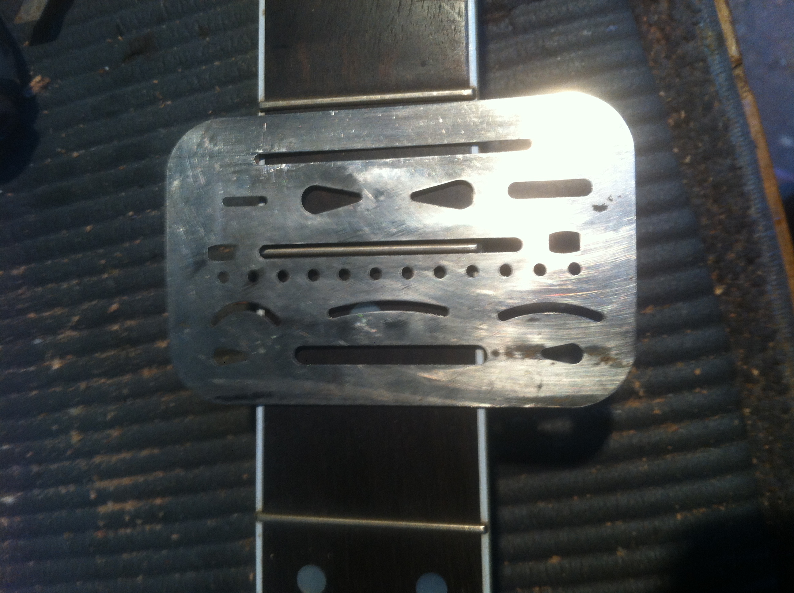

These drawing guards are good for protecting the fingerboard against chipping when pulling frets-commonly available from a graphics supply or art store.
If the frets don't seat properly, the string can loose energy when fretted which affects the sound. Gluing the frets in increases stability of the frets and seals the fingerboard from moisture uptake via the fret slots. Glue also helps with bound fingerboards where the tang is removed at each end of the fret. Cheers! Ross
