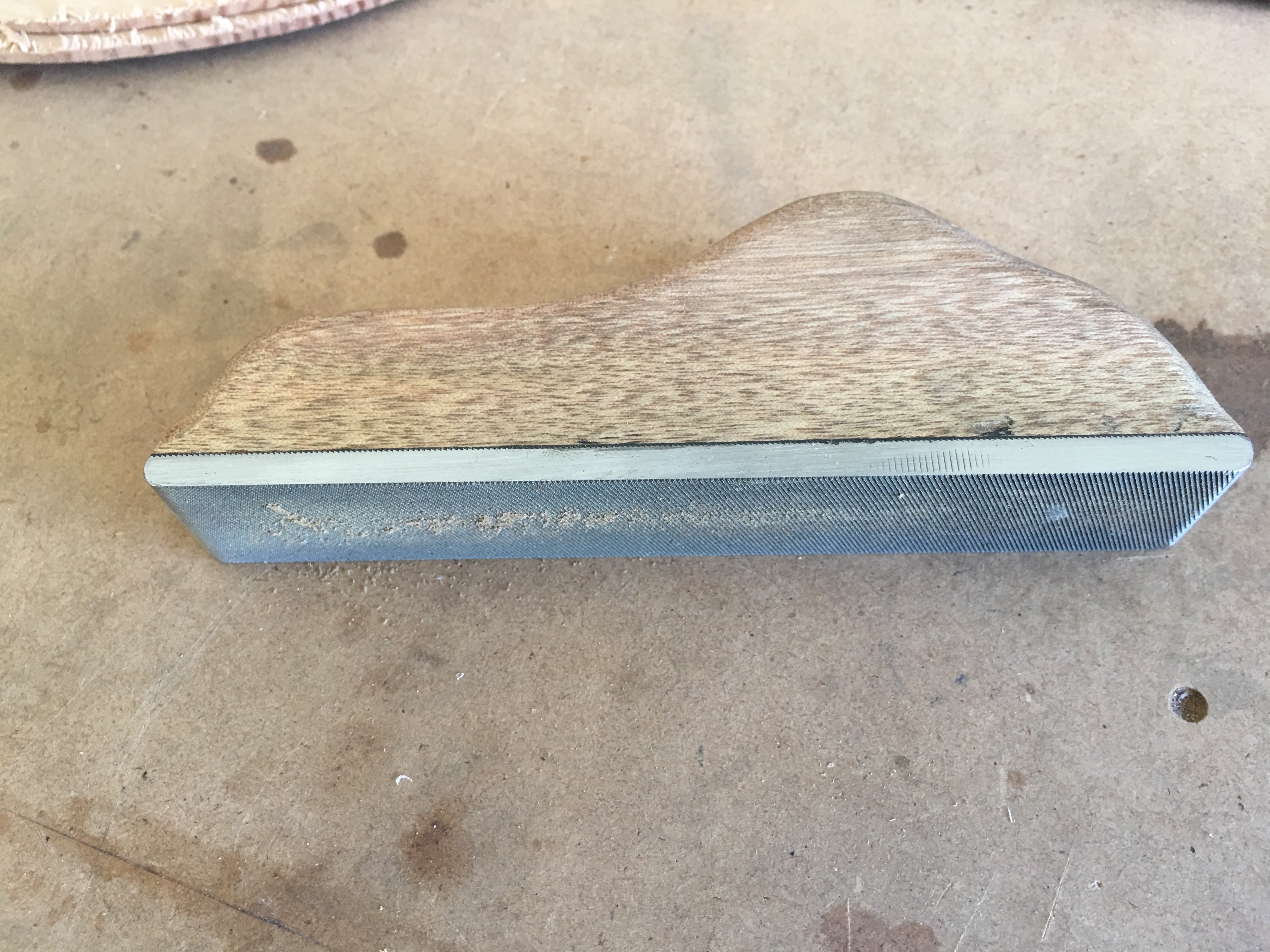

Made one from an old smoothing file and a QLD maple offcut. Very happy with its performance. Inspired by Stewmac

Re: Homemade fret/fingerboard leveller
Post by vandenboom » Tue Feb 12, 2019 1:12 pm
Thnx Geoff. What is its length?
I looked at getting a longer (12") fine mill file once for fret levelling but struggled to get one that was truly flat. I went to a reputable engineering tool supplier in melb , checked 8 of his stock sgainst my precision straight edge but couldn't find a good one.
Post by jeffhigh » Wed Feb 13, 2019 8:09 am
IMHO length is vital,
A 16" beam with 320 grit is far superior to a shorter file, even if you get a good one.
