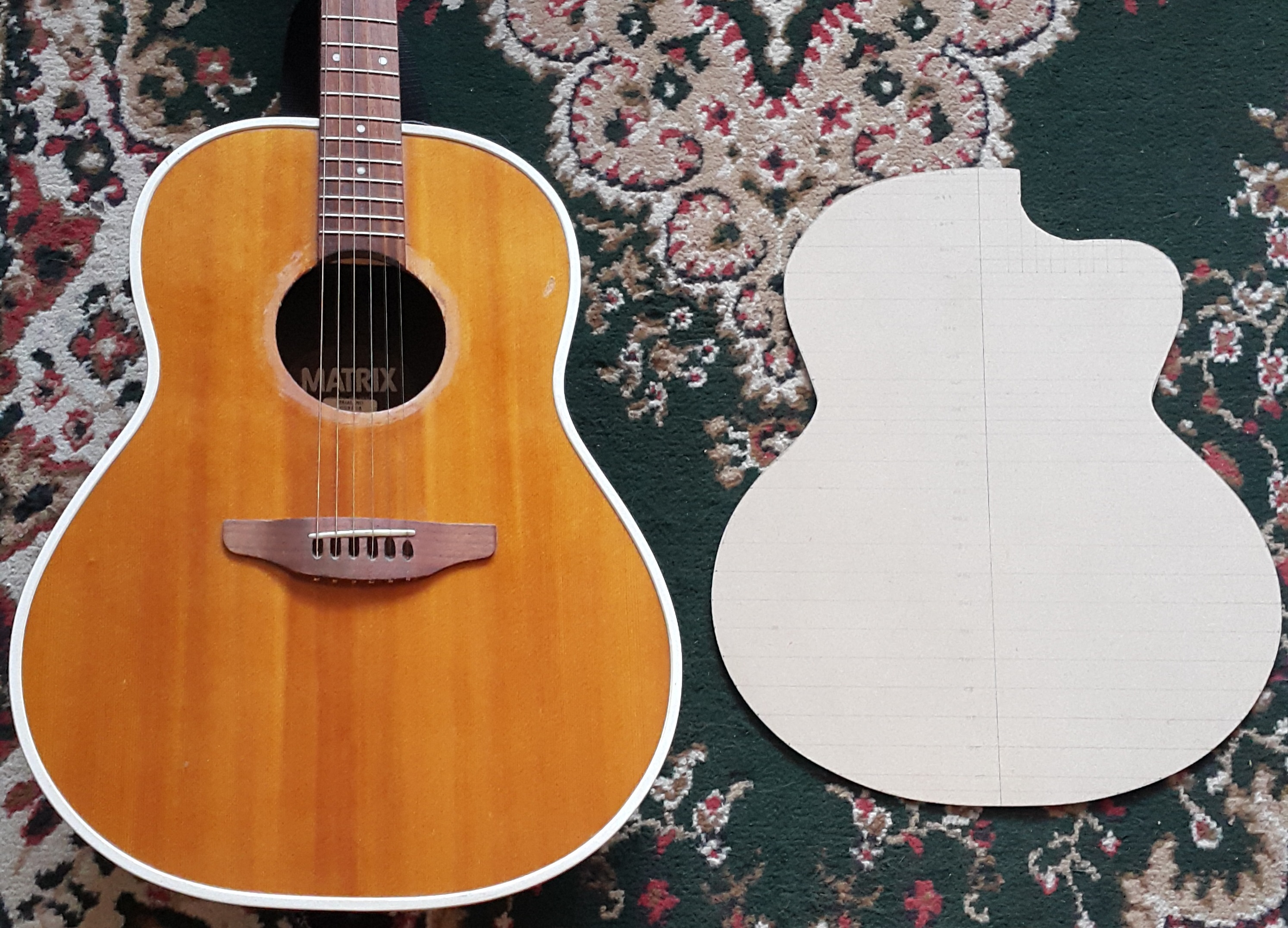

Picture shows the outline next to the old beat up Matrix (ovation) bowl back I'm playing.

Do the specs place the bridge somewhere closer to the middle of the lower bout than the example you have on the left?
I like the shape though the waist is very tight and you might have issues with getting timber to bend like that.

Hi Martin,
I would think 110mm depth is quite deep. You may like to have something more like ~85mm at the neck and ~95mm at the tail. As Allen said the waist is tight, so will be a challenge. Also speaking of challenge, a cutaway introduces a lot of thought and work on a first build. If you don't play much above the 12th fret, I would seriously consider not doing a cutaway.
Otherwise, bravo for taking on your first build from design up.

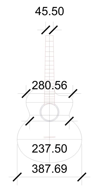

More pi's with autocad.
I don't really play much beyond any fret at the moment, but love the idea that one day I will.

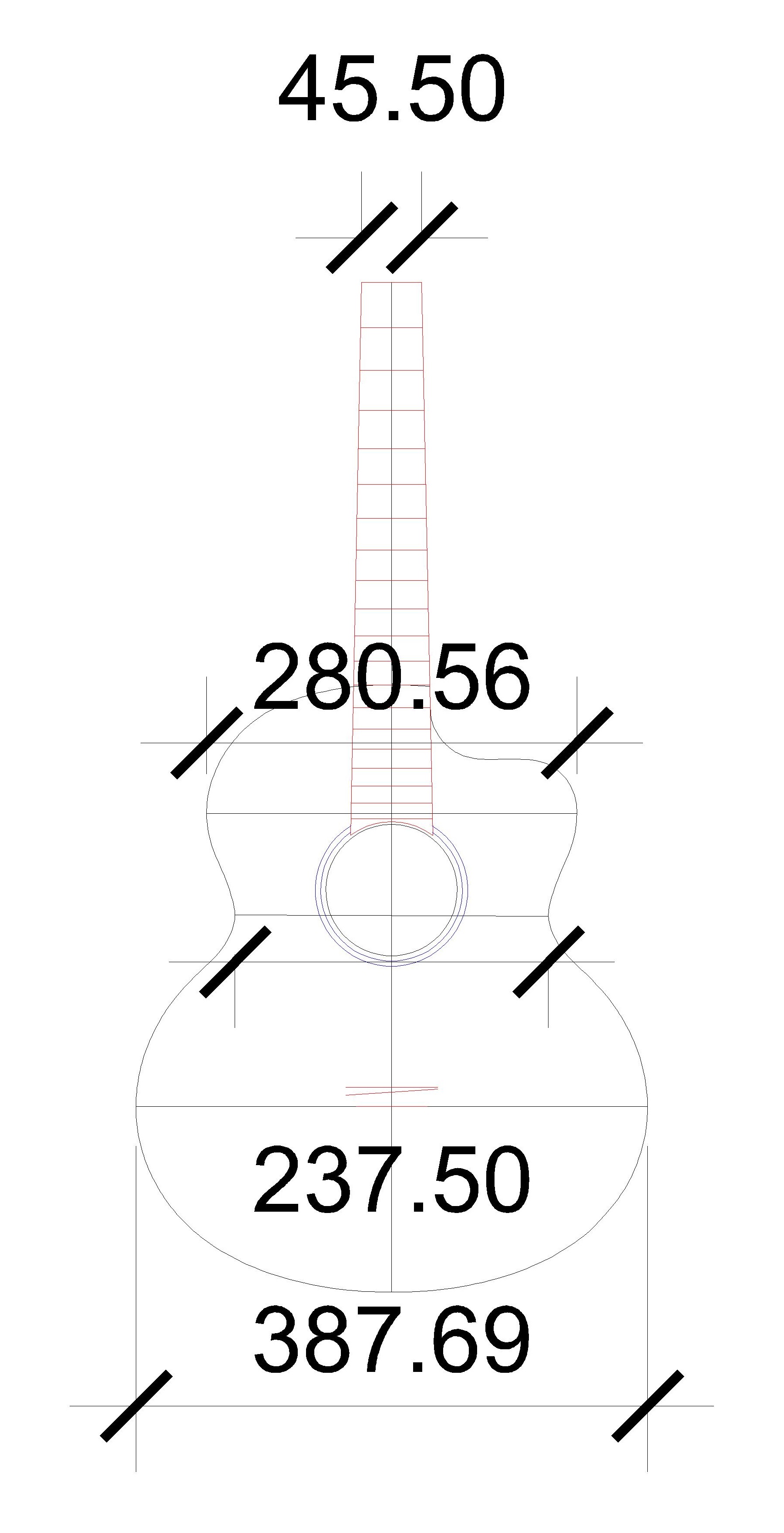

Specs place the bridge closer to the centre of the body than the old Martix.
I've attached a pdf.
First line above the 387.69 measurement (which is the widest part of the lower bout) is the saddle. The second line is the 305mm down from the 12th fret.
Bridge not drawn in as I have not got that far yet.
Hope this makes sense.
Thanks for the help.

Re: New build advice, on plans I've drawn.
I think the pdf may not have loaded... I've added a Jpeg.

Nothing wrong with those measurements.
The dimensions for the upper & lower bouts, and the depth are rather close to my OM size which i get great results with.

Shape and size seem good. Most guitars with that type of size are thinner. It is not unheard of to have deep small body guitars (one of my favourites is the Nick Lukas model Gibson L-00, which is similar to your plan) - but it is more common for them to be more like 95mm. But as long as you are happy with something with a depth similar to your dreadnaught, then go for it.
For your first attempt at guitar building keep the degree of difficulty manageable. A cutaway is definitely more complex, but not impossible. Doing two at once - probably not advisable.
You will have lots of questions as you go along. Don't be afraid to ask advice here.
Be aware of humidity issues as you do the bracing and gluing the box up. This is one of the most common causes of grief for rookies.
