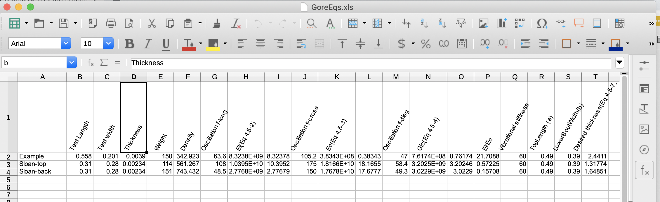

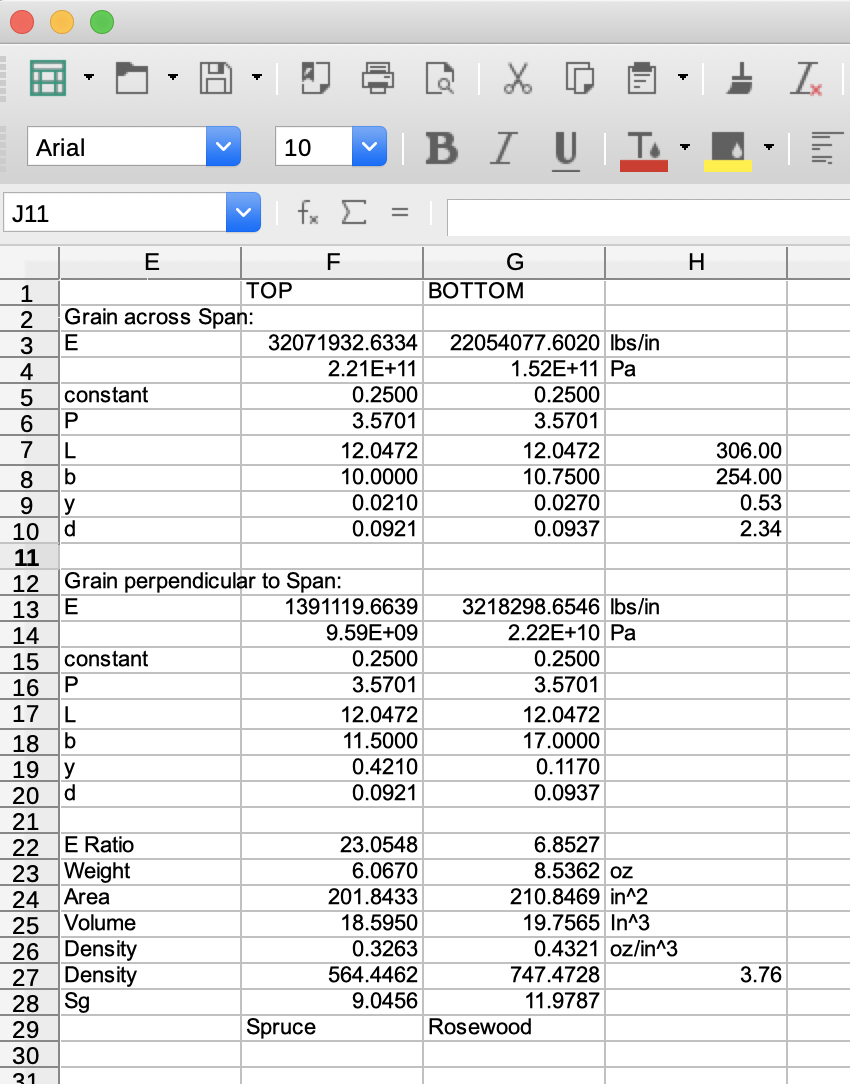

The top and back are free and the bracing has been removed. I am attaching spreadsheets for both the spectrogram and static tests; I trust none of the results. My best approach may be to do a new top with known properties and use the back with the current thickness (2.4 mm.)

From your original post, I understand that you have tried to obtain the long and cross grain E values (and Glc) for the wood of the top and back plates and have used both the tap testing (spectrographs) and deflection tests. Both methods are described in "the books" but with the main focus on the tap testing method. As mentioned by Jeff (and in the books) the tap testing method for determining El, Ec and Glc only work for rectangular pieces of wood. Also, the tap tests are usually carried out with thicker than final plates. If the rectangular plates are too close to the final value (which is not known at that stage anyway), the tap frequencies can be too low to measure reliably.
However, the defection tests should give reliable results for the El and Ec. All you have to do is support the shaped guitar top of back plate along two parallel lines and apply a line load half way between these. The parallel supports don't need to be at the extremities of the shaped plate. First measure the deflection at the load point with the supports and load perpendicular to the grain (for El) and then parallel to the grain (for Ec). The thickness of the "test beam" will be constant and measurable. For the width of the "test beam" use the average width of the shaped plate between the two supports.
Determining Glc by deflection testing is a bit more difficult. However this material property has the least effect on the target thickness, according to the formulas in the book. If you use a Glc value from published data for the particular species, that should be close enough and any difference to the actual value of Glc would probably only make a difference of 0.05mm to the target plate thickness, which is within achievable tolerance.
Once you have the El, Ec and Glc, your can determine the target thickness (and hope your plates are not already too thin).

Thanks Richard. The static test results are from a test jig using parallel rods and a linear load at center of span. I will look into published Glc values and recalculate target thicknesses. I'll rerun the static tests a few more times to get a sense of the reproducibility. Thanks for suggestions.

I reran static testing multiple times and consistently get targets for both top and back of 2.1 mm, slightly less than current thicknesses of 2.3 mm . These calcs used a Glc of 0.72 GPa for Sitka and 2.0 GPa for the Rosewood. Note, I found a mistake in the Static spreadsheet I attached earlier and that explained the weird results. Thanks again,

I'd suggest you just use the existing top and back at current thicknesses, brace and assemble and then test.
You can always thin the plates in situ.
The results from static testing of a shaped back and top are going to be suspect and can't just be rectified my averaging the width as suggested.
For one thing the span to width ratio will be too low to allow the assumption of a simply supported span.
