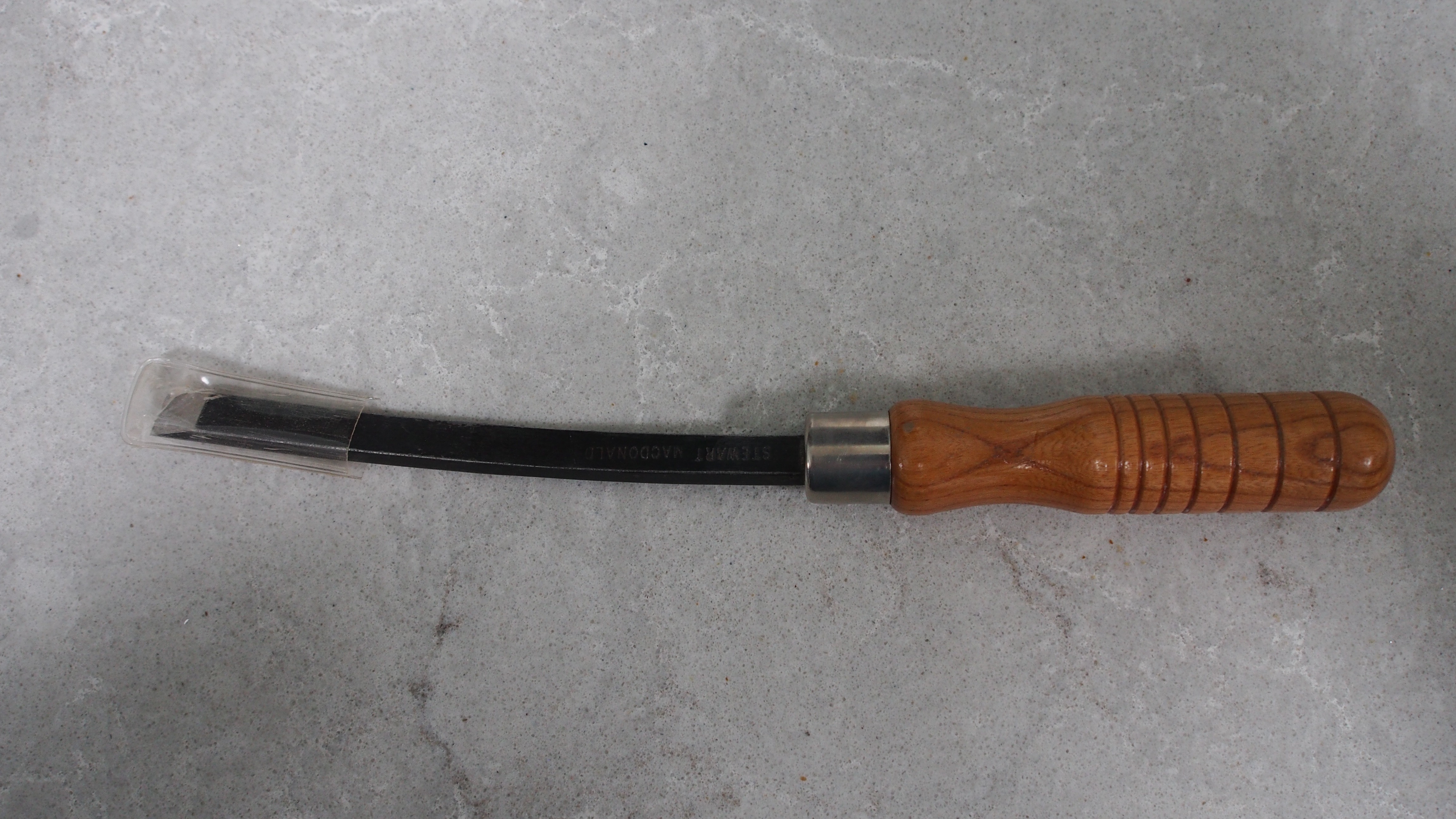

brace carving chisel
Lovely! I just checked out some build pix and noticed your brace carving chisel..I have had one of these on my wish list for too long now, so what is a good brand to get?
- WJ Guitars
- Posts: 414
- Location: Sutherland NSW
Re: New GS Guitar Build Started
Thanks all for the good comments on the guitar build progress.
It is probably not of any significance but Microsoft's SmartScreen filter doesn't like your photo site for some reason - had to turn it off to look at your PDF's/quote]
I have a Mac computer and an external drive that I can switch to that runs Windows 10. In Windows 10, I set up a file to arrange the jpeg photos on a page and then convert the file to pdf. I'm not sure either what is the problem with the SmartScreen filter. However, I just find it easy to format the photos together and hopefully making it easy to view more photos. I'm glad to he hear that you found a way to view the pdf photos.
Lovely! I just checked out some build pix and noticed your brace carving chisel..I have had one of these on my wish list for too long now, so what is a good brand to get?/quote]
I purchased my curved bracing chisel about 3 years ago from 'Stewmac' and 'Stewart Macdonald' Brand is stamped on this Chisel.
