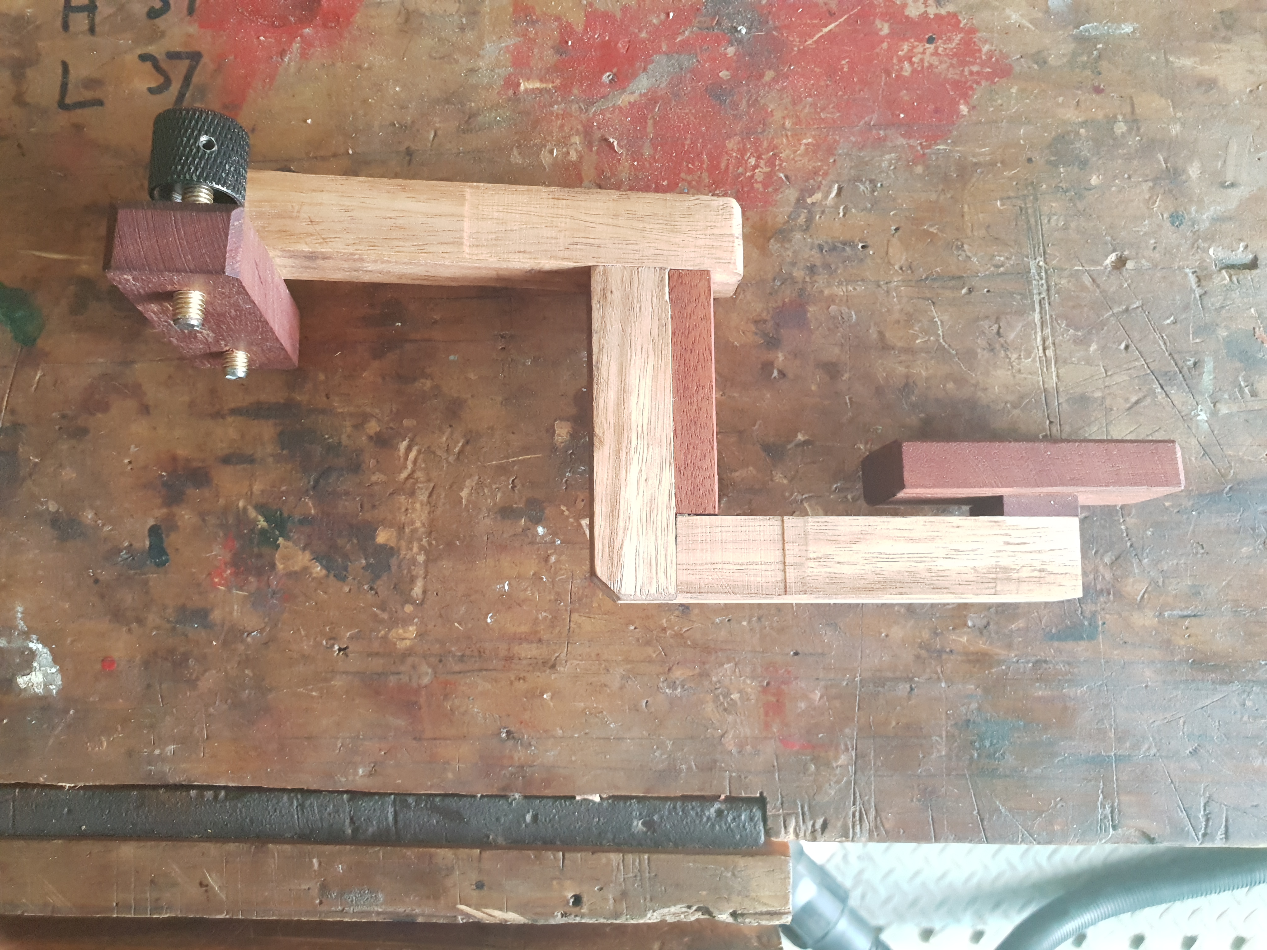

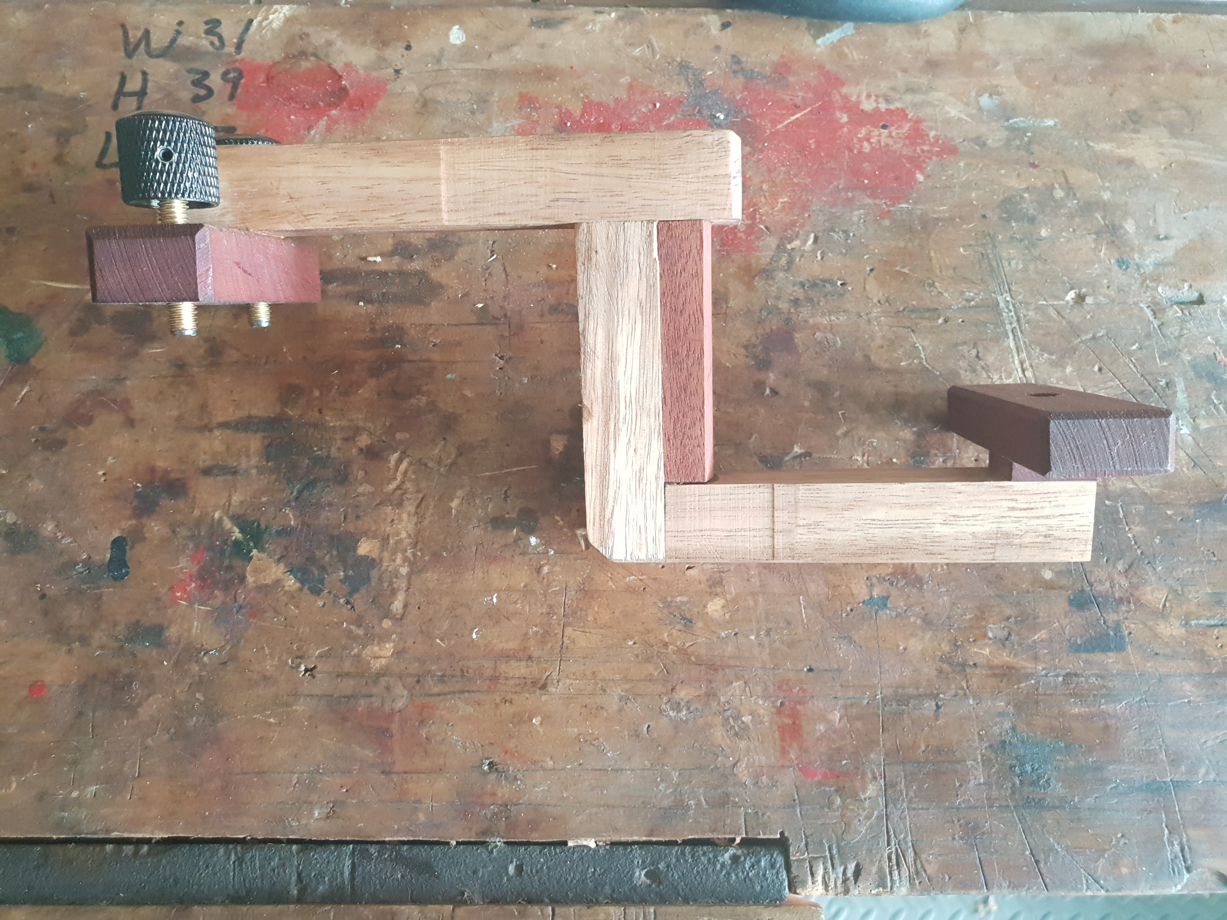

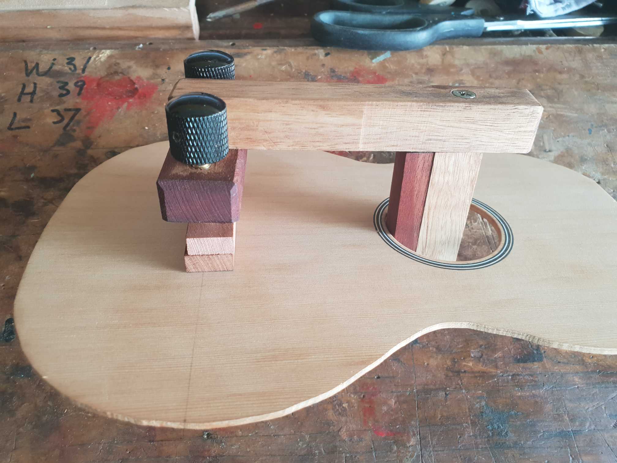

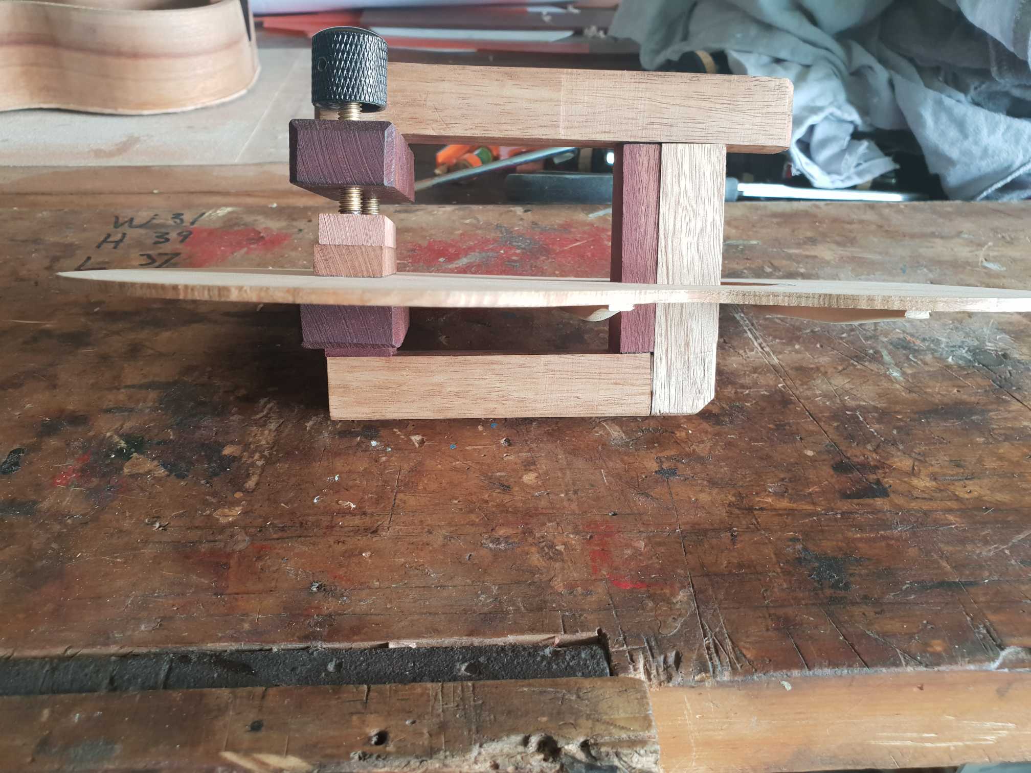

Tomorrow when it is daylight I will post a few pics of my Soprano Ukulele bridge clamp made on the cheap and avoiding StewMac with the postage.
Bridge clamps ( to my mind ) come in as expensive and then I have to gamble if they 'd fit.
This bugger "Does fit" and is made specifically and designed to fit only the Uke I am interested in.

Post by Petecane » Sat Mar 09, 2019 8:28 am
Wayne.
My bridge clamp is 2mm thick as per the drawing.
Is this too thick do you think?
Pete

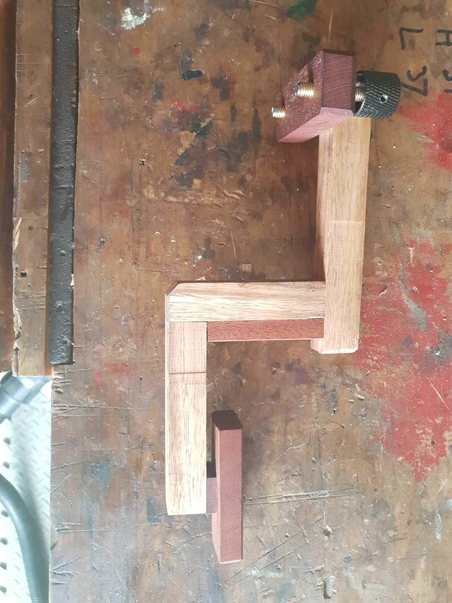

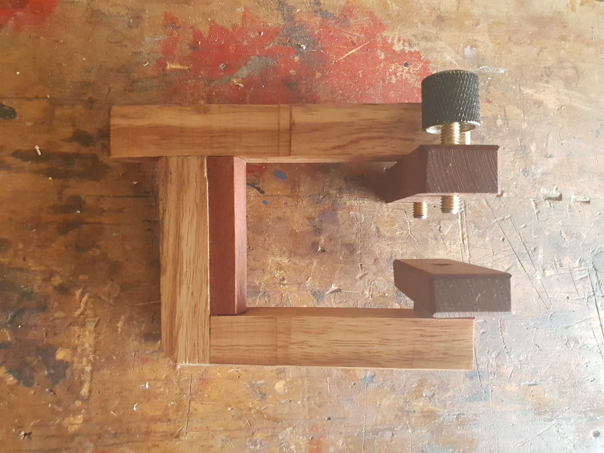

Post by Petecane » Sat Mar 09, 2019 9:41 am
This is my Ukulele bridge clamp.
I have tried to download the pics directly to the forum but do not know how to.
Any advice welcome.

Post by 56nortondomy » Sat Mar 09, 2019 12:17 pm
Looks thicker in the photo Pete, 2mm should be ok. When you want to add a photo go under the dialogue box click on attachments you should be able to work the rest out, just remember they have to be under a certain size. I resize mine with a program called fotosizer it's free and easy to use.Wayne

Petecane
Posts: 168
Joined: Mon Feb 25, 2019 10:09 am
Re: Bushwhacker Ukulele builds.
Post by Petecane » Sun Mar 10, 2019 11:46 am
Here are more views of the bridge clamp in it's various guises.
It is not beautuful but a working prototype.
Pete

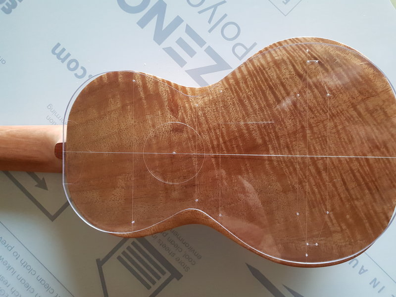

Post by lamanoditrento » Mon Mar 11, 2019 8:20 am
Nice little circle cutter Pete
Petecane
Posts: 168
Post by Petecane » Sat Mar 16, 2019 11:16 pm
Thank you that you like my circle cutter.

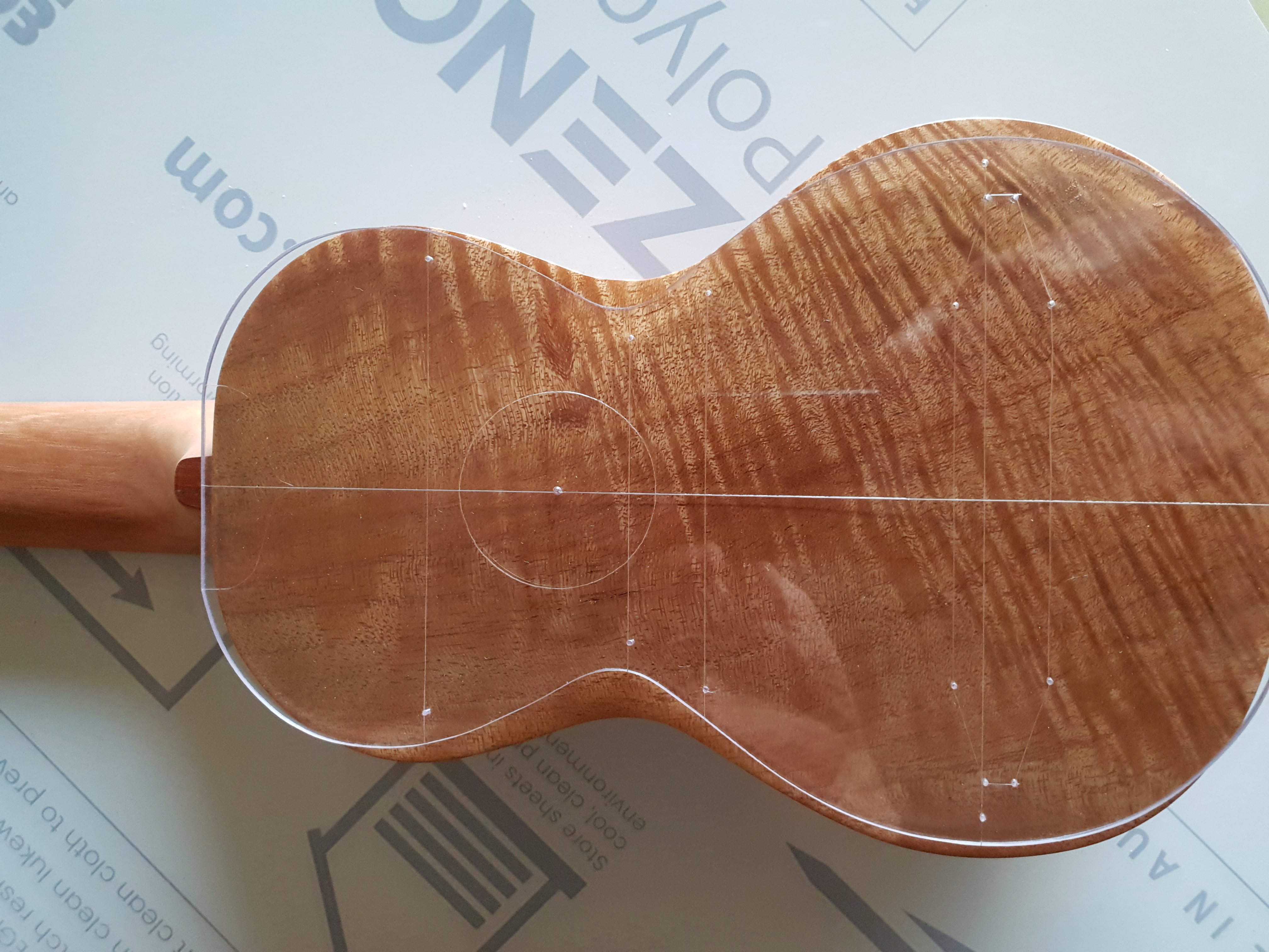

I am on a new build now.
I have used the Martin soprano crucial measurements but Brought the bouts in and made it more slender and Nunes style.
I used Polycarbonate to make the template and hardwood for the mould.I really like this shape.
All spars,and the sound hole are marked.
I like the old fashioned way these Ukes were made.
Slotted necks laid flat on the board which I have not made yet
The line of the finger board and top cannot be anything other than bang on straight..
The more I look at it the more I like the shape and it is "My " shape which I find exciting.
It is also allbut the old cremonese way of making violins.
I plan to do some modifications to the build but the old system will still prevail.
The second pic will show how I have varied from the Martin.
The Helmholtz thingey should be about the same.
More about that later.
No....Now!....as an experiment I blew across the sound hole and a definate note was there. ( with my almost finished Martin copy Uke!.)
With a guitar of course being larger this would be difficult.
But the " note " was definately there.
Anyway here we go if your interested.
Pete

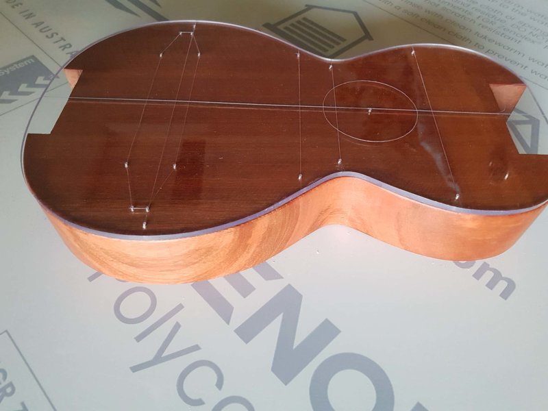

Petecane
Posts: 168
Post by Petecane » Sat Mar 16, 2019 11:18 pm
Sorry....doubled up.
This one hopefully will show the difference between the Martin Soprano shape.
Pete

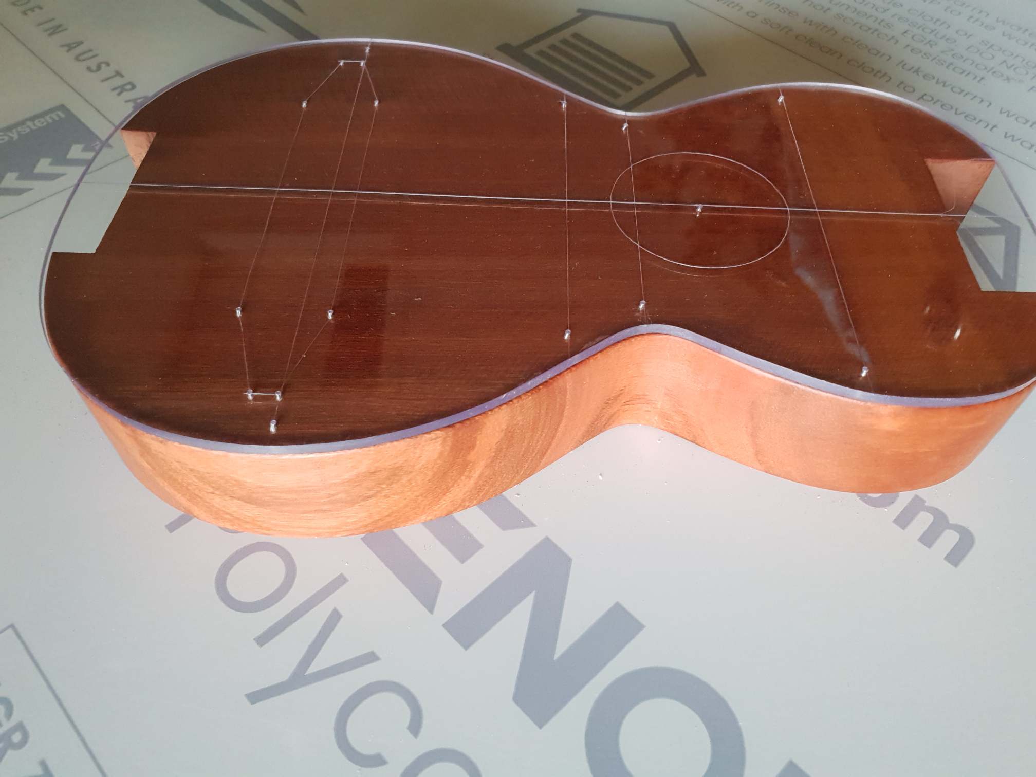

Petecane
Posts: 168
Post by Petecane » Sat Mar 16, 2019 11:19 pm
Try again!
Petecane
Posts: 168
Post by Petecane » Sat Mar 16, 2019 11:26 pm
And this one ...a birds eye of " the outline ".
I am just learning how to edit!....
