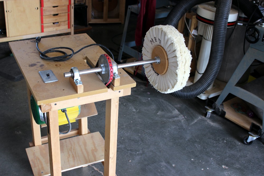

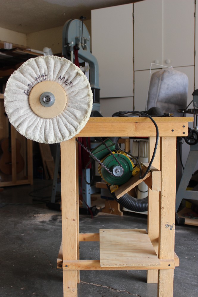

Here's one I made.
I works very well, spins around 700-800 rpm. My only issue is that every time I use it I think to myself "I need to a belt guard over that top pulley". I used a piece of shafting from an industrial supply store and had a machinist friend cut the thread on it.

Make the time - it'll save you time. I just wheel this outside when I'm using it so the crap doesn't go all over the place.
A feller on Gumtree made the rod for me - its a 1" hardened steel rod, just over 1000mm long. I had him turn a RH M20 on one end and a LH M20 thread on the other.
M20 Nuts - RH from Bunnings, LH from eBay. I've got spares of both if you want 'em.
Got the 1" pillow block bearings, pulleys and fan belt from Gumtree. One bearing was not seated well but rather than fanny on with it, I wedged the feet so it is level.
Motor and switch from a $99 Ozito drill press.
The buffs and compound are from www.thepolishingshop.co.uk Even with postage, its cheaper than buying from here.
The buff "plates" are mdf - I turned them on me little lathe.
The machine is set up to run faster than most but with a slackish belt - so it slows down when you push it too much. I tried it out with a guitar bouzouki yesterday and it worked a treat. In the photo I've stacked the buffs so there are 4 in the picture. I've taken two off - so each side has a 60mm buff. This works better it seems. I made up the space vacated by removing a buff from each side with a spacer - a 60mm section of aluminum pipe.
