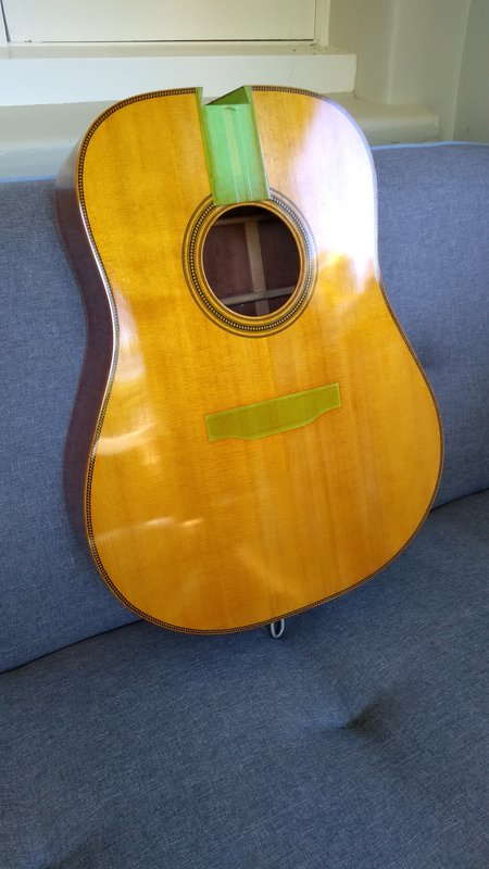

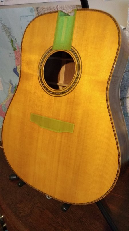

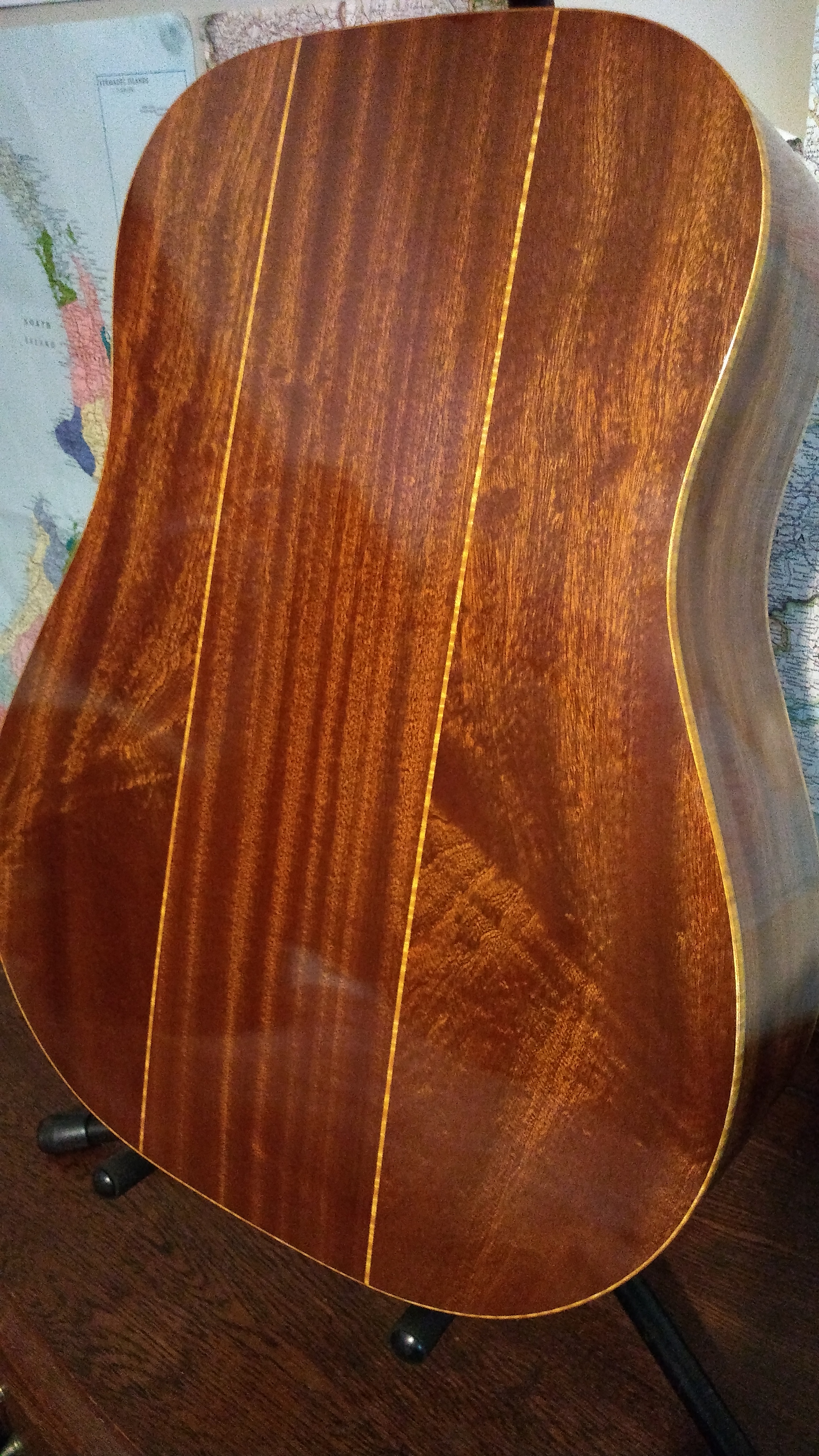

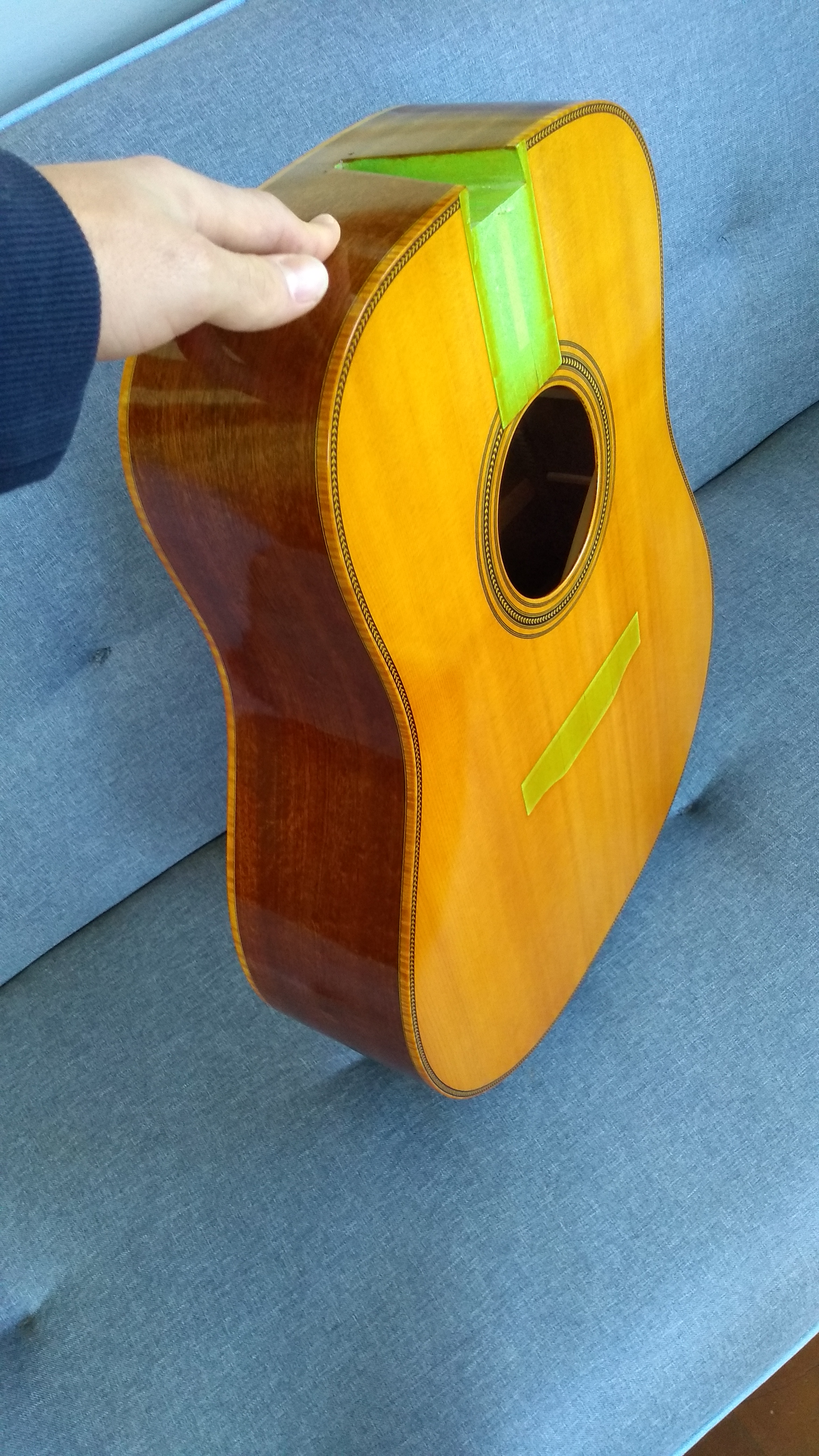

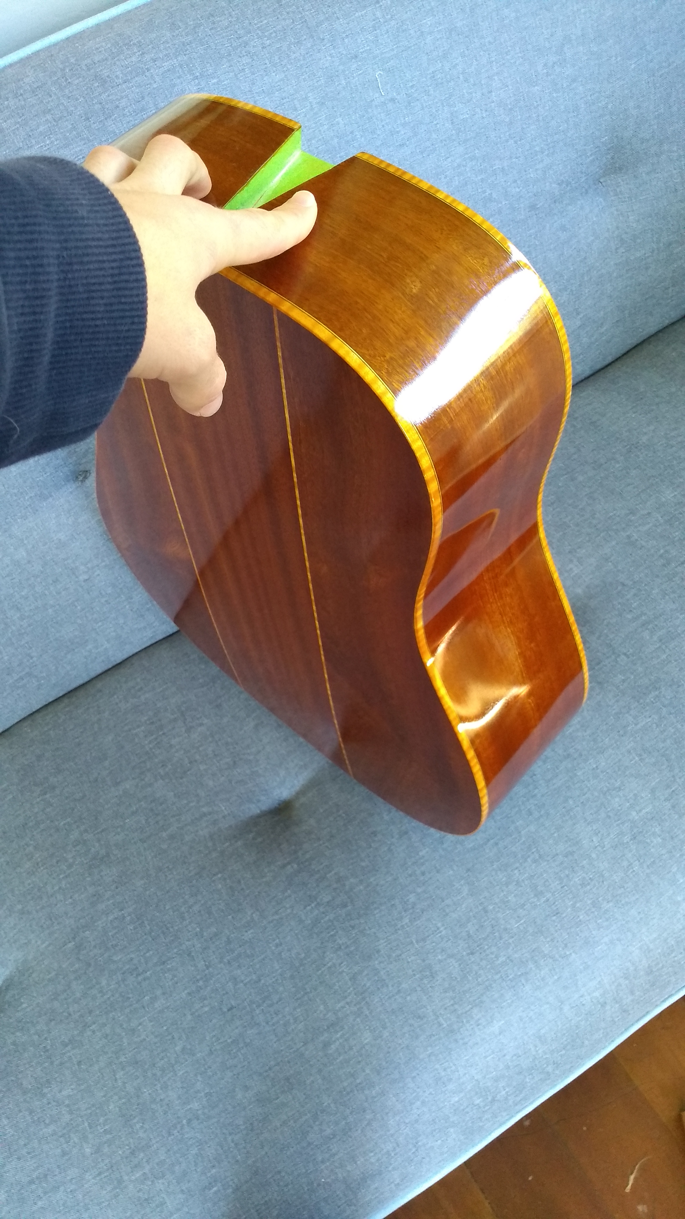

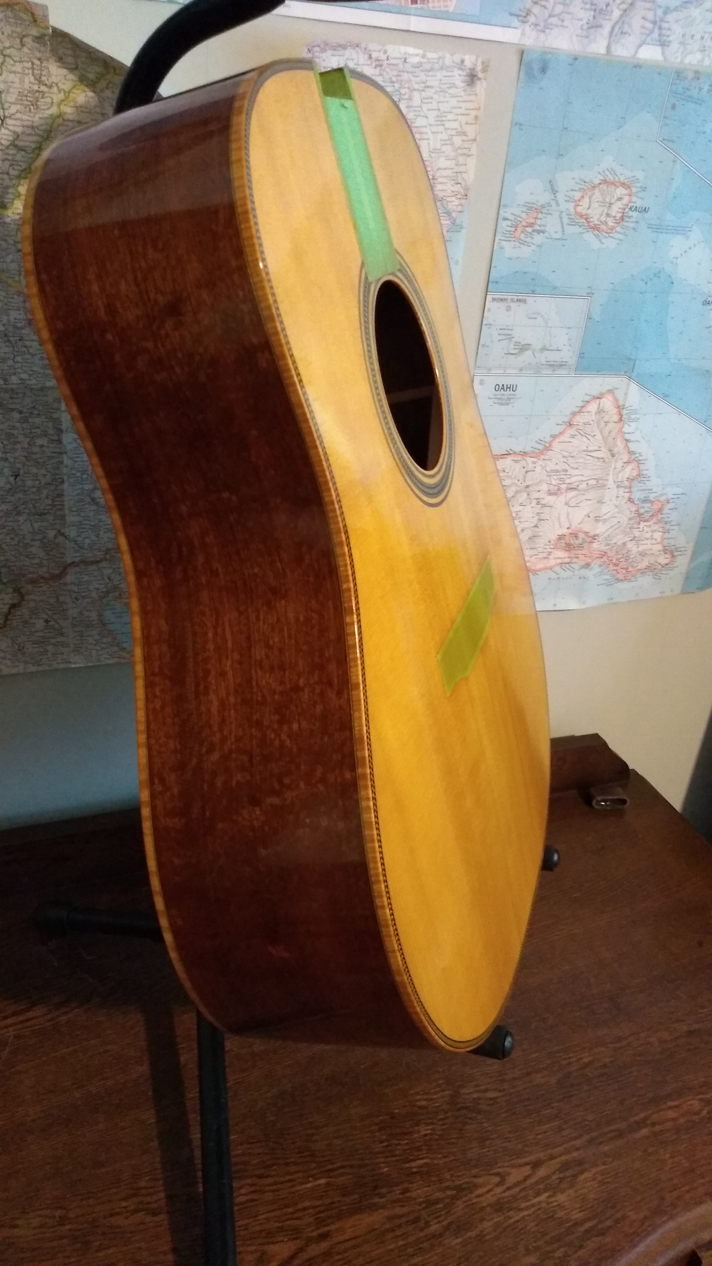

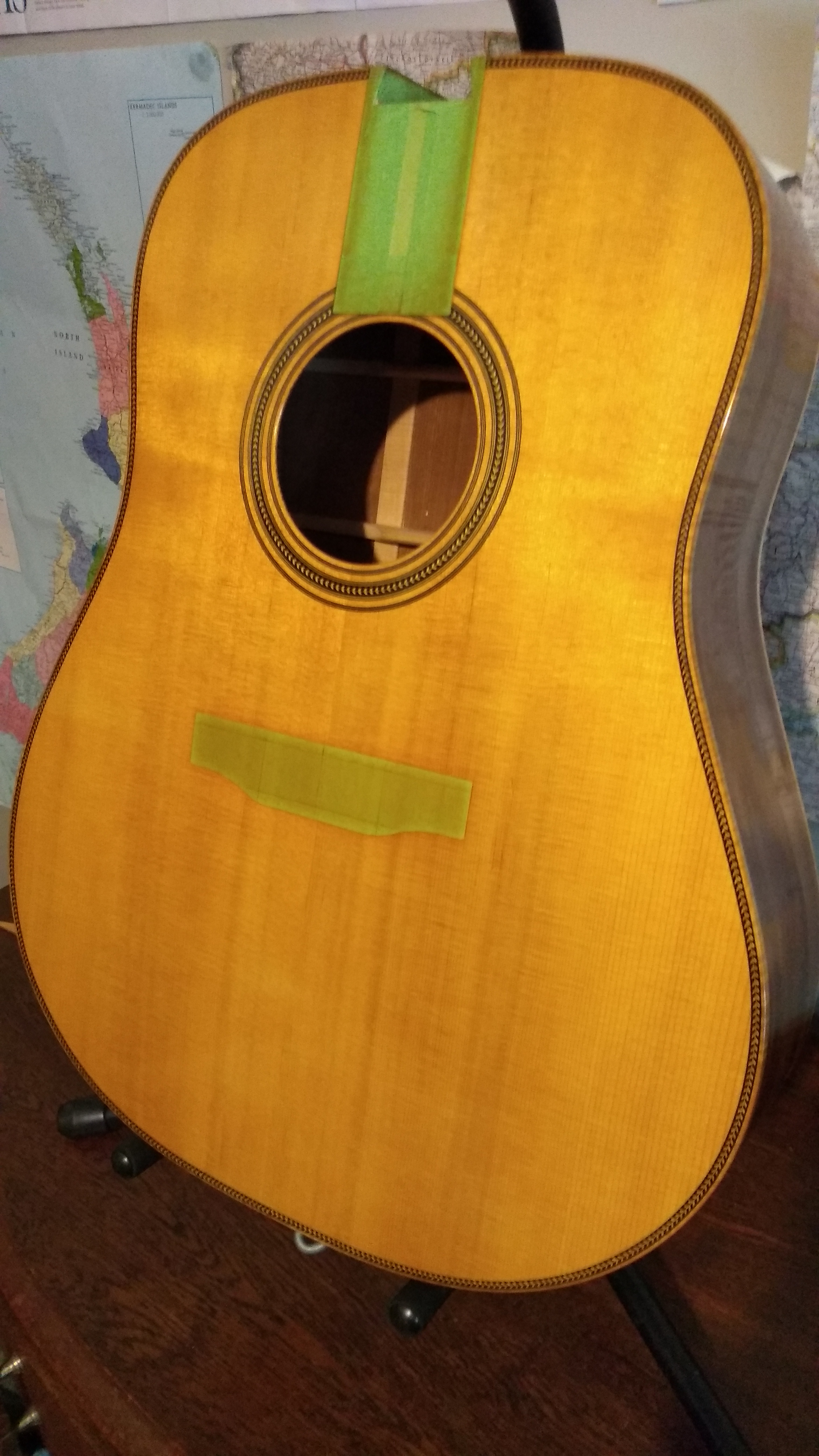

Alright so a while ago I posted about having problems with cupping on this mahogany dread. It has stabilised quite nicely and I've had no more problems since.
I've started french polishing it and it's had around 40 coats of shellac so its coming up nicely. But I was wondering if anyone had some advice on how to get the shellac to have a smoother appearance, I've noticed it has vey fine streaks in the finish from where the polishing rag has applied shellac, they are hardly there and barely visible but still noticeable. I've grain filled the mahogany so there is no problems there. I've also been applying the shellac very thinly to avoid squeeze out and runs. Anyone else had this same problem or know how to fix it?
Cheers Laurence
Cheers Laurence

Looks beautifully done to me!
Superb polishing.

Traditionally a spiriting off session after every few bodying session takes care of the ridges. There's a bit of skill involved in spiriting off so I take the easy option and I generally do a cut back session with 600 grit wet and dry wrapped around a felt block with a bit of oil for lubrication every few build sessions. This knocks off the ridges. What sort of material do you have on the outside of your muneca?

I also avoid spiriting off due to wimping out but use 2000 wet and dry with a touch of linseed.
Your polish mixture " could" be too thick?
I have learnt that it is better to keep the mix ultra thin.

For the record I use a 2lb cut for bodying sessions and go to a lighter cut (1-1.5lb) for the last few sessions. I use hard shellac ready mixed up by Shines. If youre using this stuff keep in mind that you cant allow long periods between bodying sessions as the stuff will have started cross linking and will go goopy on you.

In the pictures it looks pretty good. I mostly like to leave the finish looking off the pad so that people will know it is french polished, I have no ridges when I am finished but it is a different look than leveled with sandpaper (which also looks very good).
I do three wash coats (just pad it on) with a 2 lb cut, after that I use a 1 lb cut. I do not mix alcohol on the pad when bodying. I just use the 1 lb cut. I've seen see some techniques where a few drops of 2 lb cut and a few drops of alcohol are placed in the pad, so I figure I am just pre mixing. I also use a little olive oil. With a 1 lb cut I can continuous work a top for hours without the finish getting too soft. When I use a 2 lb cut straight on the pad the top gets sticky fast.
I do spirit off with just alcohol to remove oil and burnish the finish every few sessions. It is a touch thing but not really hard. When I spirit off I start with a fairly wet pad, the trick is no drips and one should not see visibly wet areas while wiping. So I start with a very light touch and incrementally press harder as the pad gets dryer. I am continually watching and feeling what is happening as I do with the grain strokes. By the end of a spirit off session I am pressing hard enough that I am careful not to crack the top. Two things can go wrong the first, leaving too much alcohol while wiping, a subsequent wipe after that can pull the build right off, the second is actually worse with the pad wet if you bump the edge of the guitar you may send a drip down the adjacent surface; no problem if wiped right a way, but if left it can ruin the FP on that surface.

Thanks Pete I appreciate it.
And I haven't been spiriting it off just sanding it back to get rid of ridges. I also haven't been using oil mainly because the thought of putting oil on doesn't seem right to me, maybe that's why it isn't as smooth as it should be? I've also been using a 1 pound cut that hasn't been diluted, maybe I should mix it with a little more spirits. Lastly I've been using an old t-shirt with cotton balls in it to apply the shellac.
You can probably tell I'm new to french polishing so any advice I can get I appreciate so thanks for replying.

French polishing is something you get better at the more you do it. There's no one method...you try different techniques and you end up adopting what works for you.

Ridges and lines being in your finish is not yet understanding how thin your mix must be at this stage of bodying or finishing off.
As your trying to fill the grain and get a flat finish with each body it doesn't matter because a good cut back with fine paper with a solution to stop the paper clogging up flattens it off. I use a mix of linseed oil and mineral turps.
After the third or fourth body , if your good at it, the grain of the Mahogany should be flat and full . Your top should be done sooner because of no open grain .
After that the shellac should be made a lot thinner. Like take an egg cup of what your using and tip it in a Mug of metho . Ten times more metho than before .
Pro polishers take it down in stages as they head towards the end and finish off with pure metho taking off the oil at the end for a highly reflective finish.
Shellac finishes is all about keeping the finished product it as thin as possible . A full grain with a fine, no ridges end job is what look the best .
Aim for three or four bodies with a few finishing off stages with oil.

My munecas consist of a core of upholsterer's wadding and the covers are trace cloth (lint free). To stop the pad going hard I keep my munecas in a sealed jar. As far as oils go I've tried them all but of late have been using mineral oil.

I have looked again and again at your wonderful French Polishing.
I have another side to this!
I think you are trying too much!
Your guitar looks glorious.
My take on this.
I harp on about this but in the sixties when I played a 1933
Santos Hernandez Flamenco guitar ..
It was not glass finished but so subtle.
You could just see the wood.
It was a sort of vinyl Matt.
There was a gloss but it was subtle .
Could have been the thirty years difference.
But I do not think so.
The guitar was coated very thinly with a form of Shelac.
I believe wood is wood and should be wood!
To see it, to love it, to play it and let it breathe?
You know what?
Rub the whole caboodle down with 2000 wet and dry and then polish it up.
