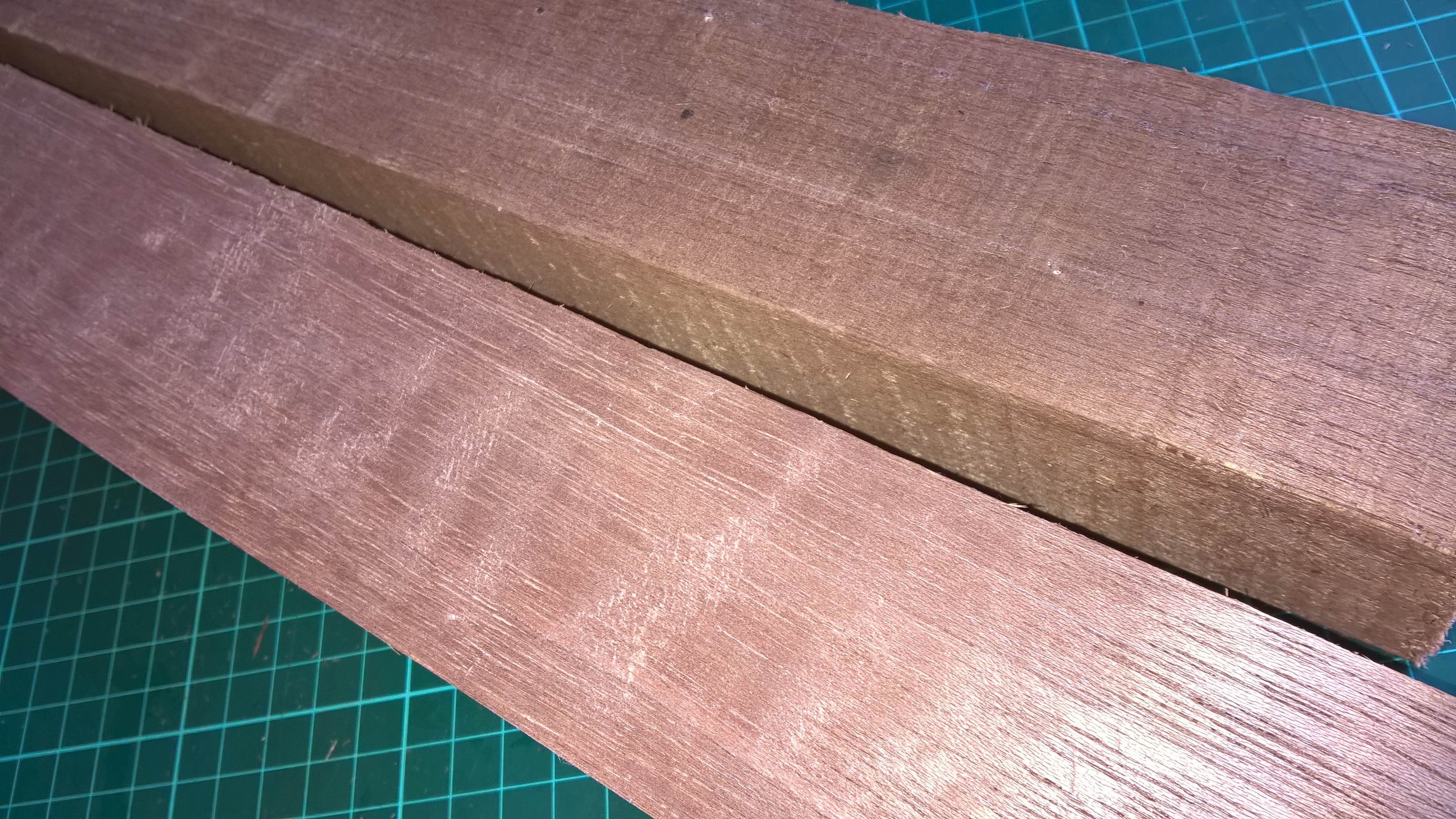

Hi Folks,
I have been given a lot of this timber and am hoping it's suitable for necks and bracing.
It's been shelved for around thirty years, very consistent tan colour, dead straight grain, completely free of knots and light in weight.
I planed one of these pieces and it has a nice sheen when held in the light.
I was told it's cedar.
Any ideas?

If it was being called cedar it might be “Australian red cedar” (toona ciliata), which is not a cedar species at all - but it is a good timber for furniture and joinery and would probably make a good guitar neck.

Looks like meranti to me. I don't think it is red cedar.
Re: Wood identification
Yep my vote is Meranti or perhaps Nyatoh. Sand and sneeze its probably Nyatoh.
http://mtc.com.my/wizards/mtc_tud/items/report(92).php
Used for everything where straight grained, knot free, and cheap wood was required in the 70's through 90's, its a fast growing sand sucker from s/e Asia that's sure to blunt your tools quick smart. As a tonewood, a great many early M.I.J. Yamaha lower end 'student grade' guitars, were constructed entirly from Nyatoh, even the top as part of the ply however the Japanese gave it the more alphabetically frugal name of "Nato". IMHO it would be good wood for necks as its stable however it can be a bit splintery until under a finish...From completing literally dozens of jobs where the customer did not want to pay for more expensive options like jarrah, (WA) sheoak, doug fir etc, nyatoh makes really good staircase stringers, knewl posts, balustrading etc. Sure its a bit boring to look at in the raw but with carpeted mdf treads and a lick of paint it works well as a functional budget option. Oh, and did I mention stable..

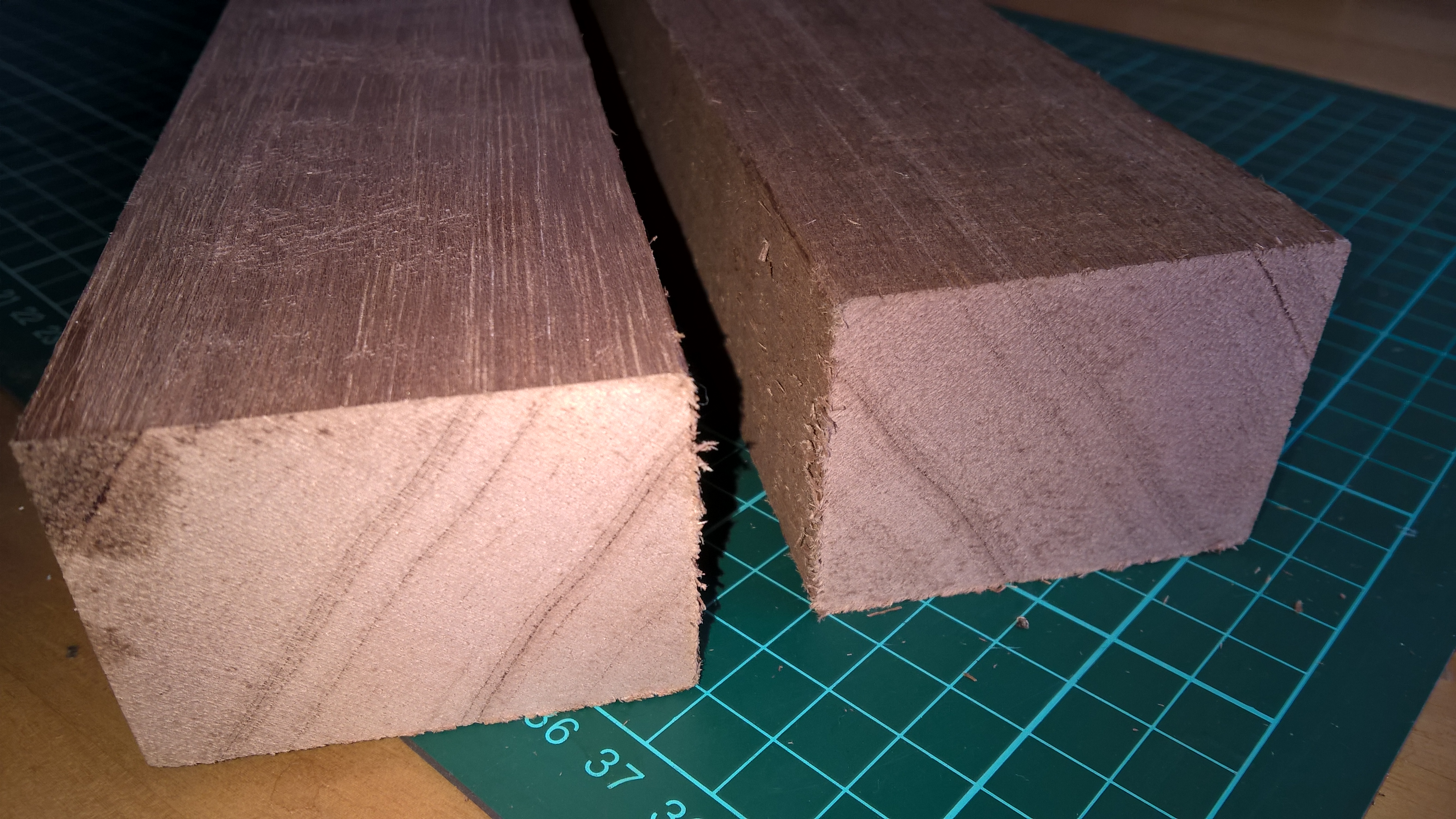

The second photo shows it way off the quarter. Am I right in thinking that gluing as shown will balance out any tendency to move?
