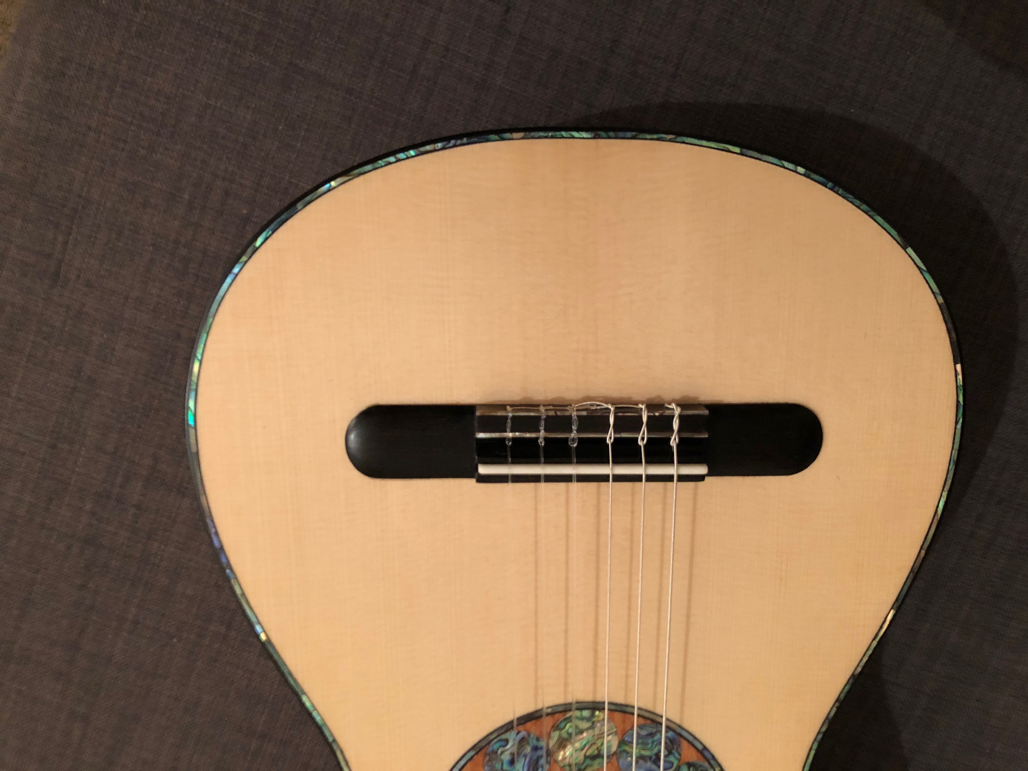

Thanks Pete. Yes it is one piece. It is a small parlour guitar based on the Torres 2 plans in Roy Courtnell's book Making Master Guitars. Lots of pics on this tread viewtopic.php?f=25&t=7912&p=85651&hilit=silky#p85615Petecane wrote: ↑Sat Apr 27, 2019 7:39 amTrent

Yes, just normal tea. Someone here once posted this link, which I found very useful https://www.popularwoodworking.com/tech ... zing_wood/
Mark is right, tea might not have been needed on blackwood but I am sure it doesn't hurt.
Also, I recommend you don't put a lid on too tight on the steel wool mix as the reaction produces a bit of gas and you can end up with an exploding jar (bit like bottling homebrew too early )

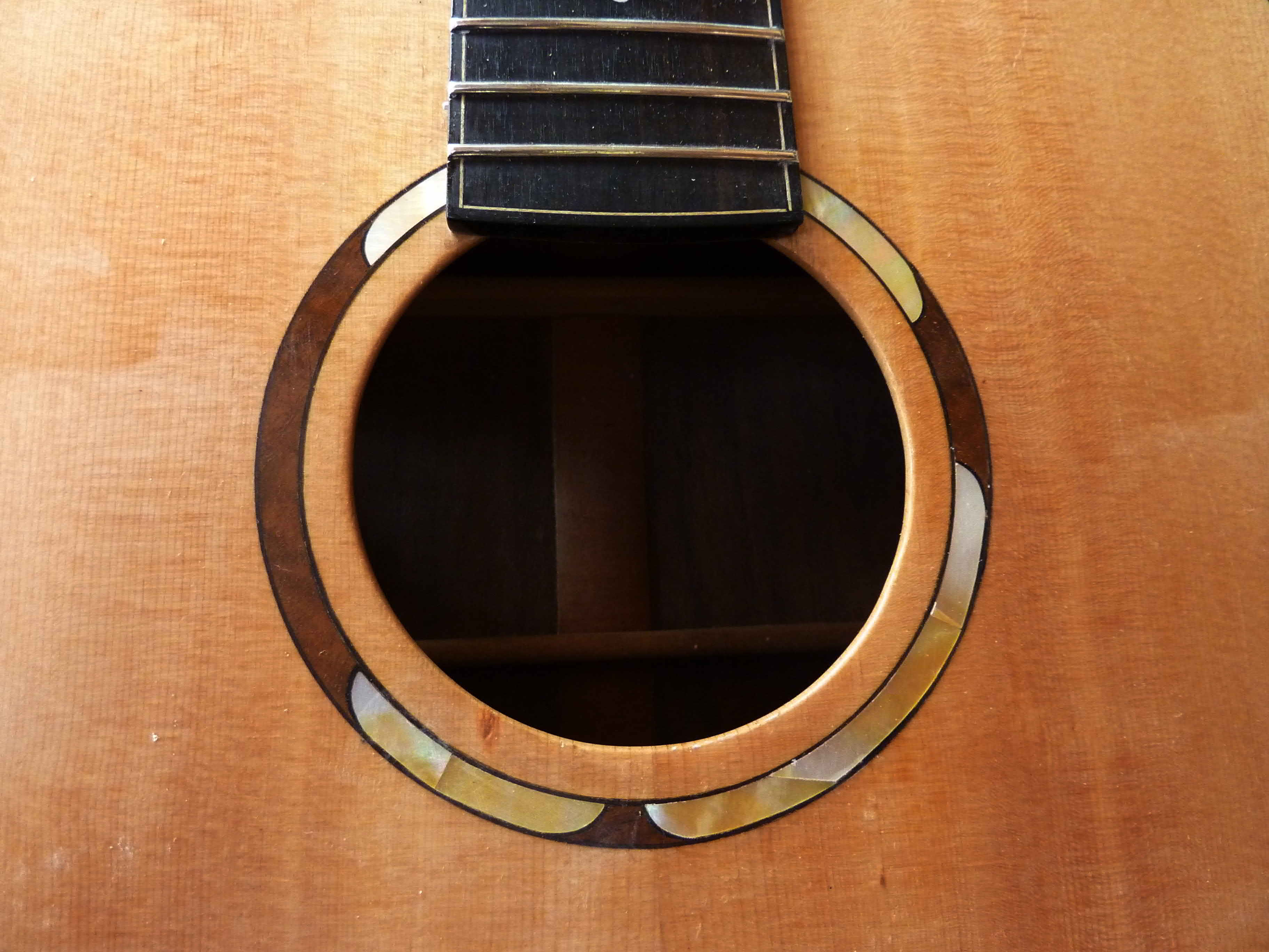

I made this rosette using a few tricks...firstly ebonised pearwood, then I used gold MOP and Walnut. The Walnut is a lot softer than the MOP so I saturated the walnut with superglue to harden it up so that I could scrape the rosette flush.
