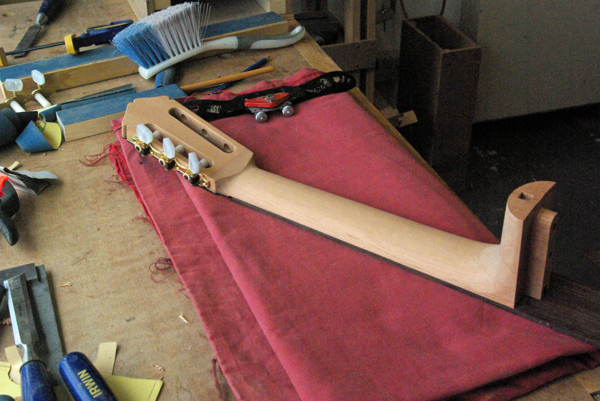

I am almost there bar a bit of sanding:

Your neck looks great Dave. However long you're taking, it seems to be working!
