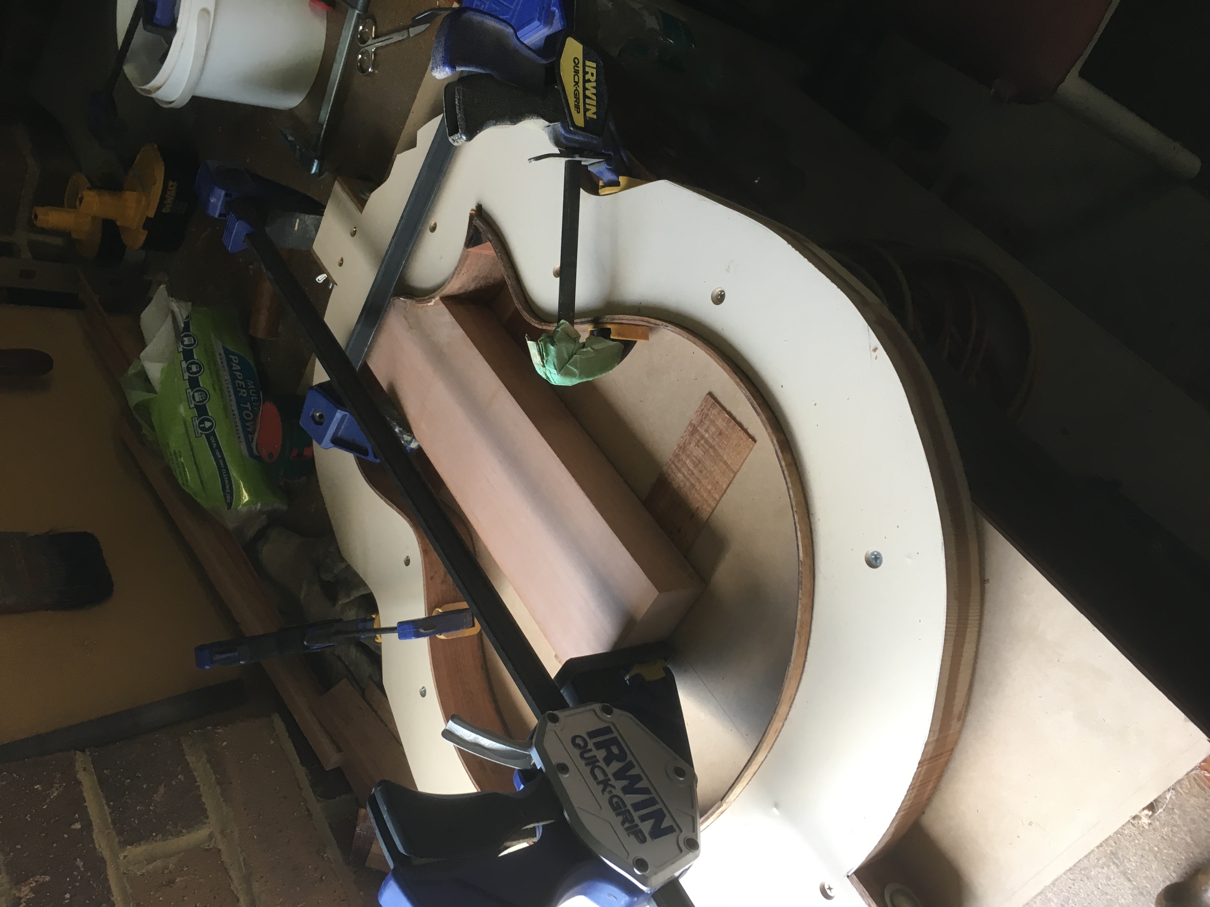

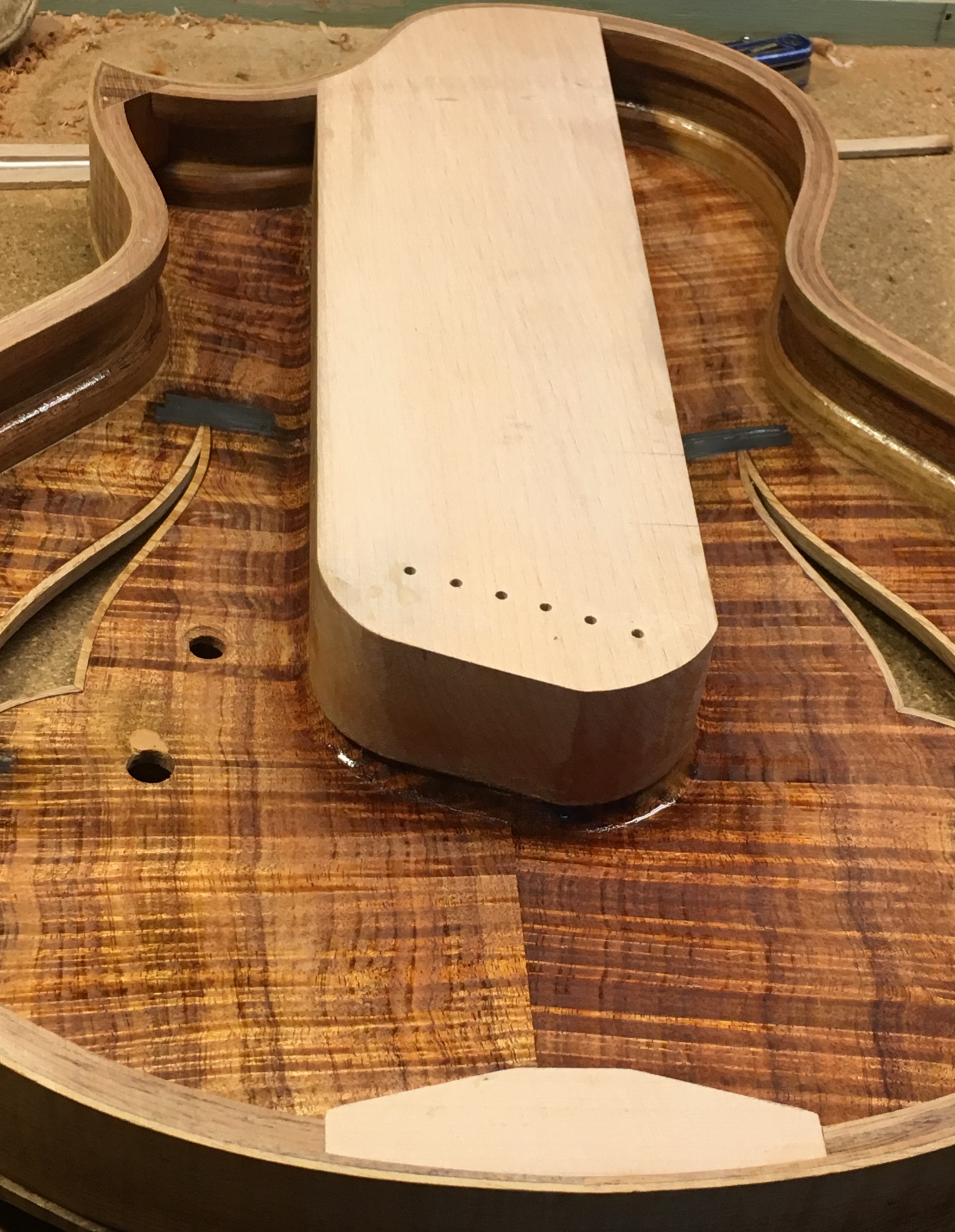

Post by rocket » Tue Jun 18, 2019 12:28 pm

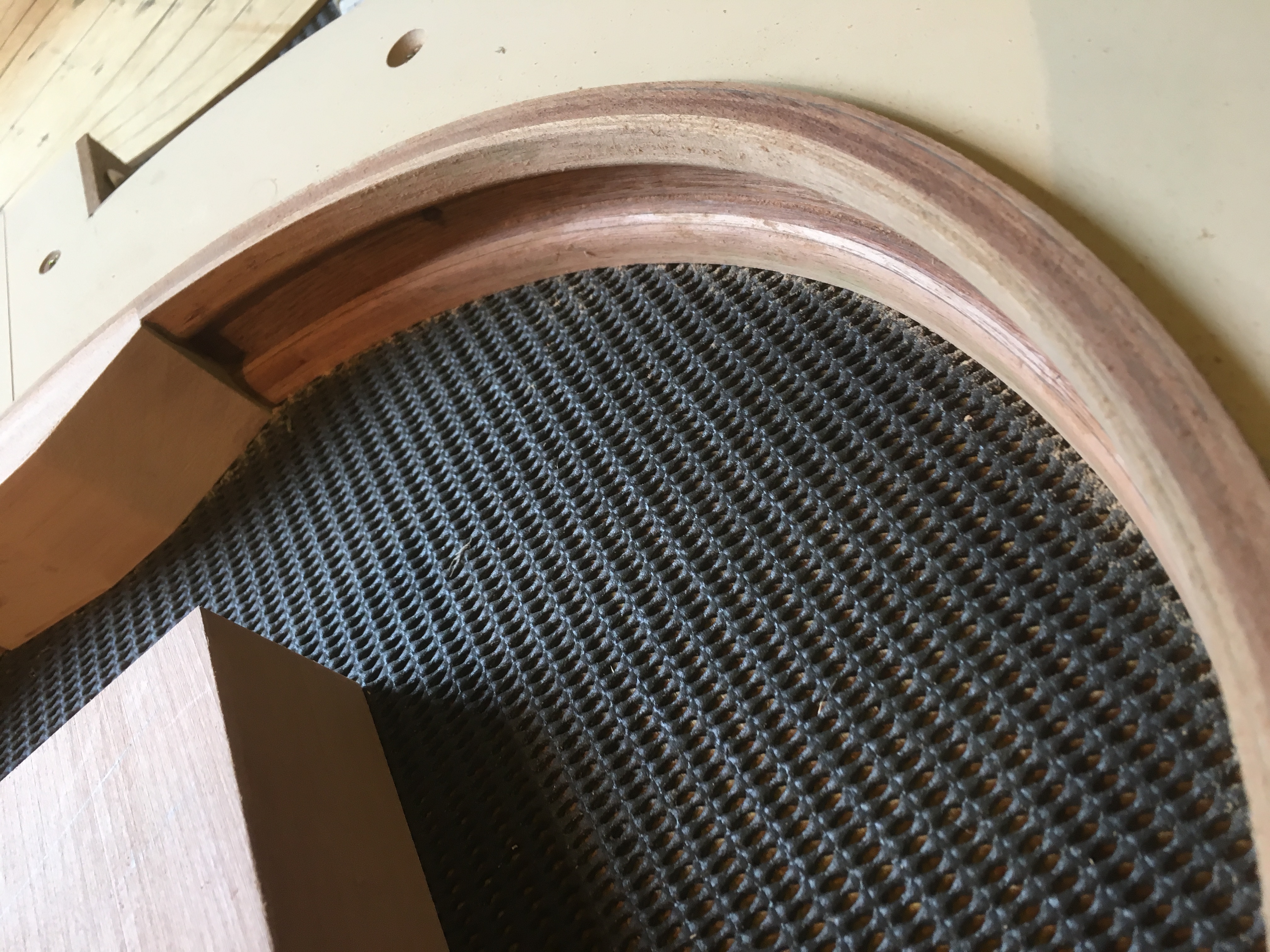

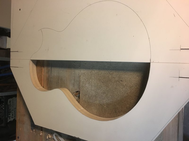

Finished the laundry and now back in n to he shop and into this 15 inch thin line semi in Blackwood and Sheoak.
Re: Semihollow fifteen inch

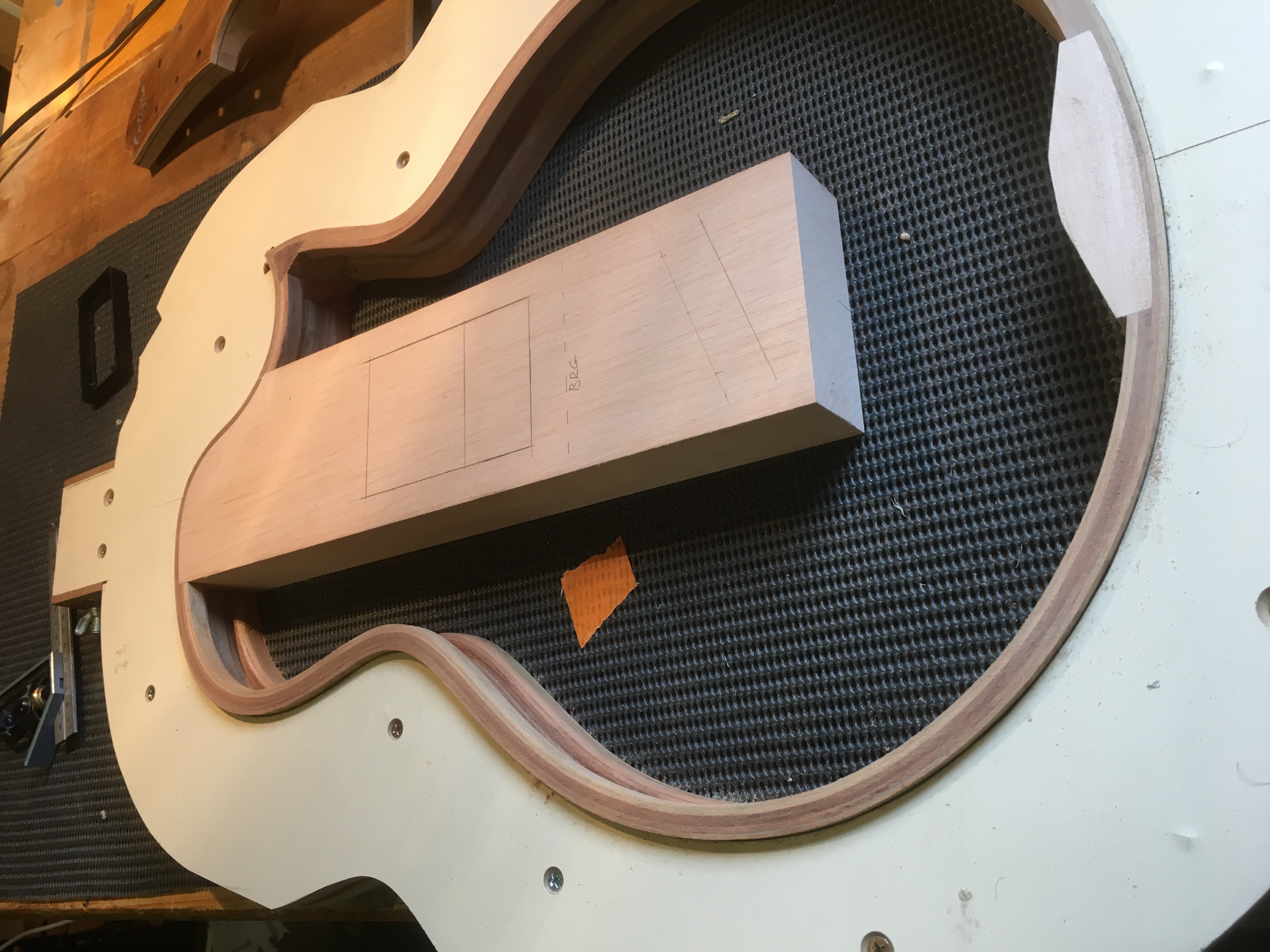

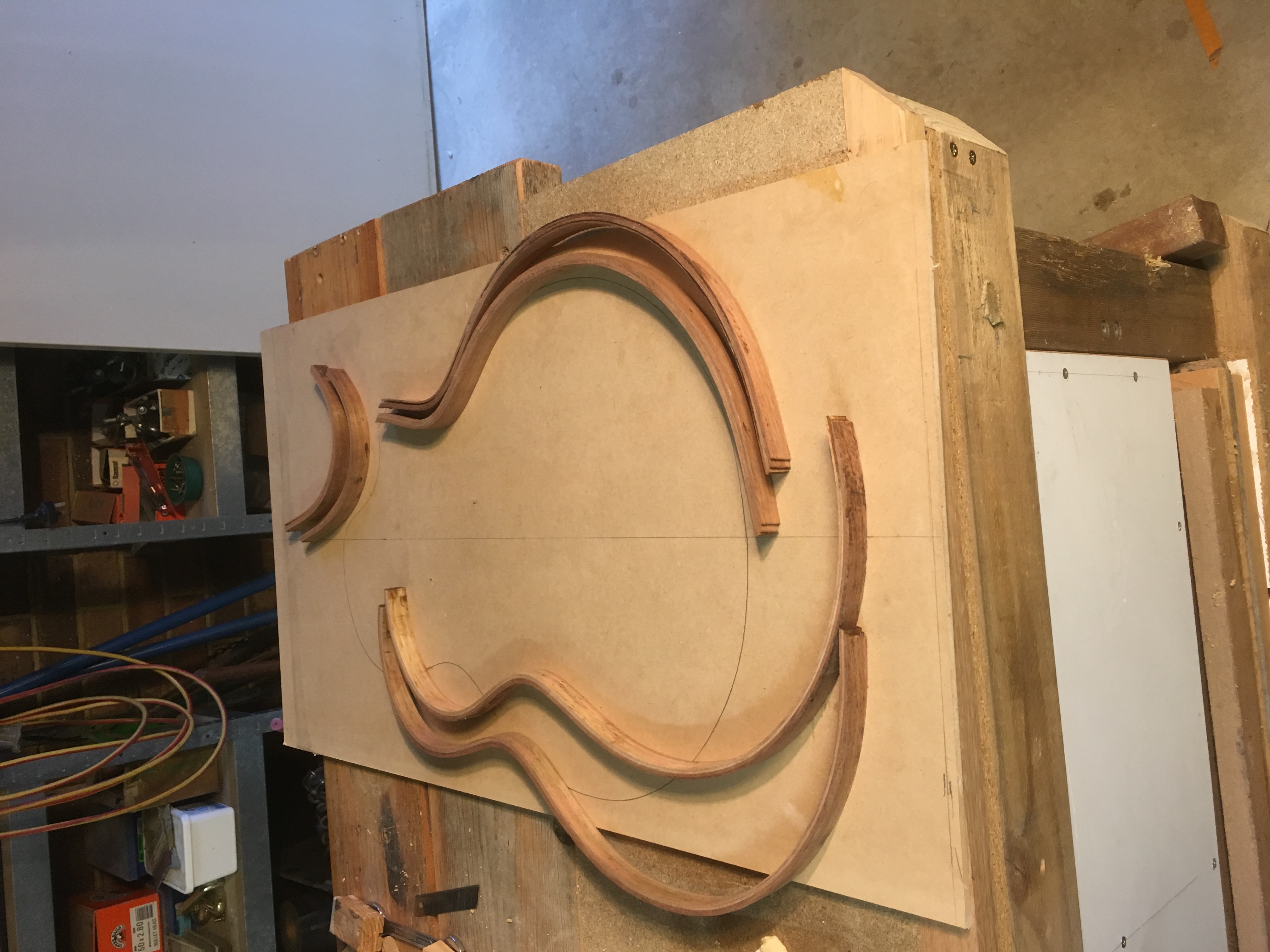

Post by rocket » Thu Jun 20, 2019 12:02 pm

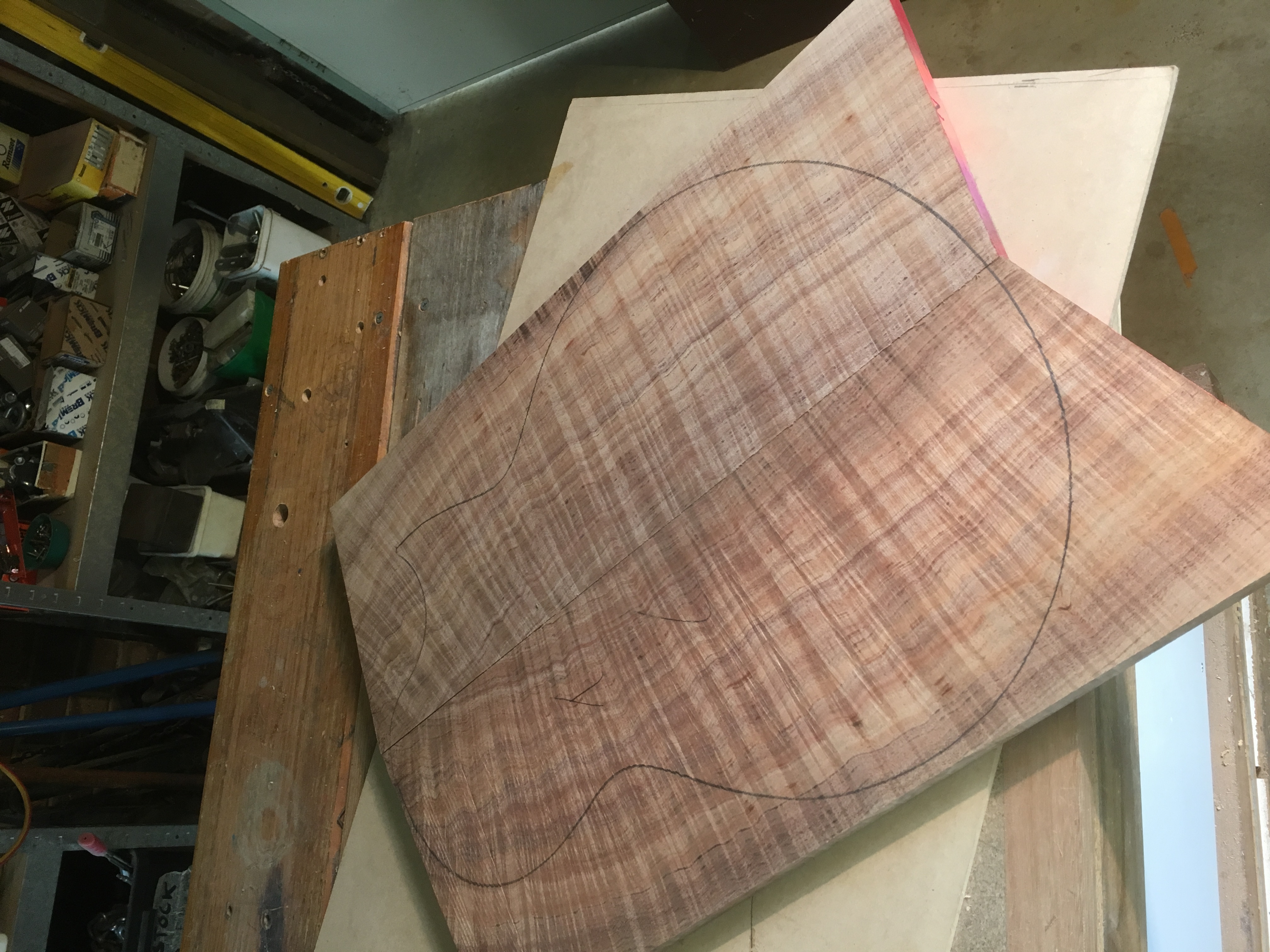

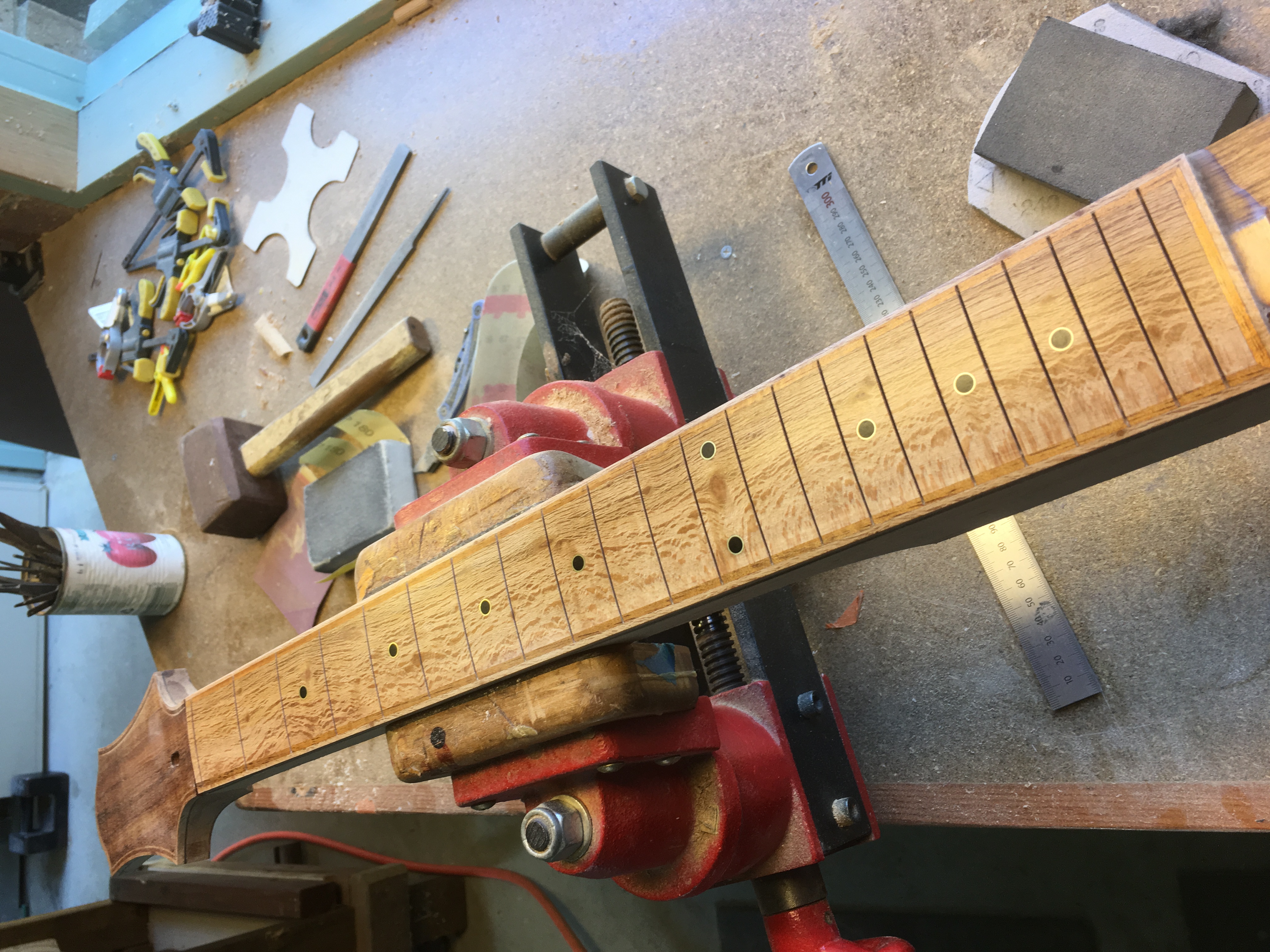

Sides and solid linings are bent and laminated and the top is ready to be jointed
WJ Guitars
Posts: 404
Location: Sutherland NSW
Post by WJ Guitars » Fri Jun 21, 2019 9:48 am
Sides and solid linings are bent and laminated and the top is ready to be jointed/quote]
Like the laminated lining design / construction that will ultimately be part of a great guitar body with strength and quality.

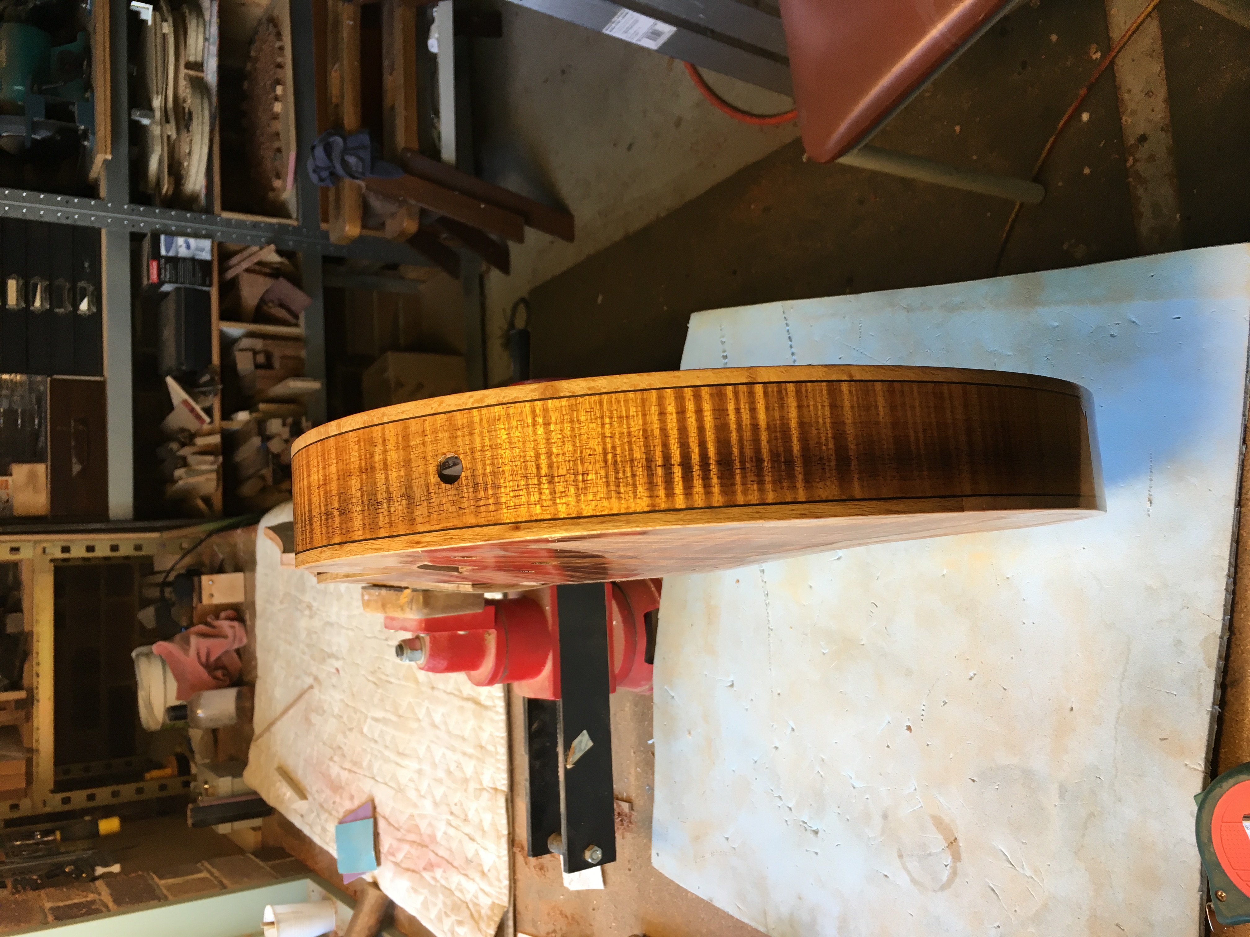

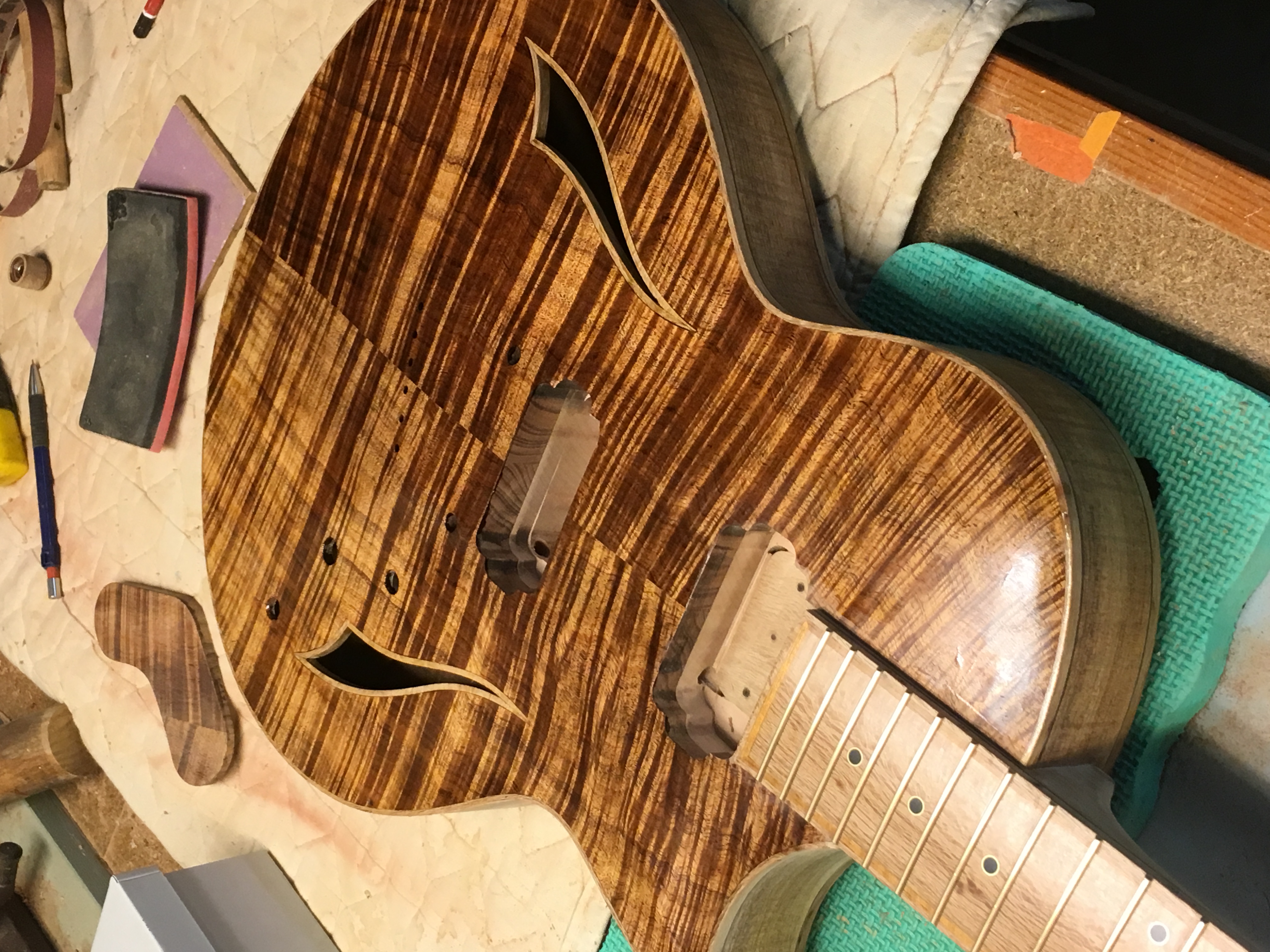

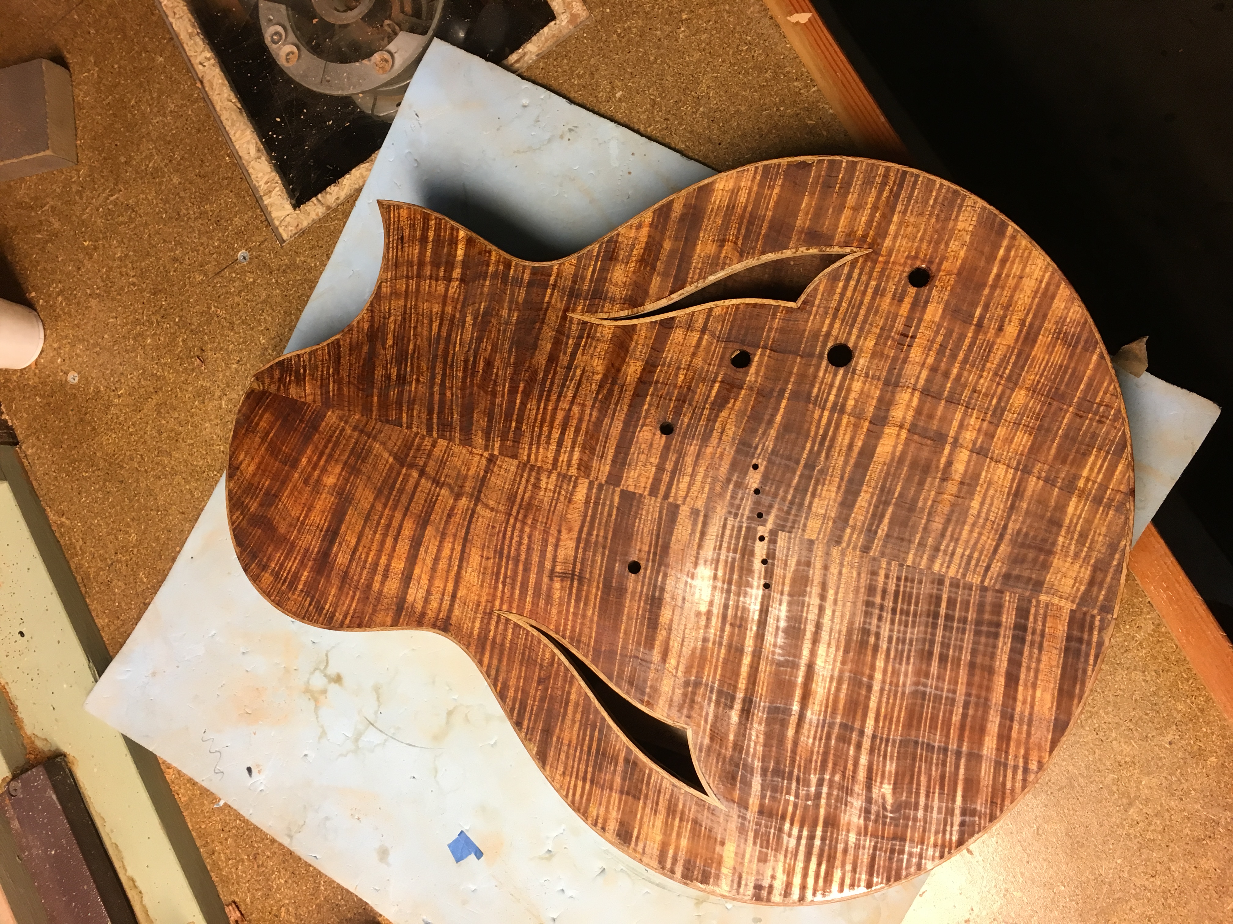

Post by rocket » Fri Jul 19, 2019 2:53 pm

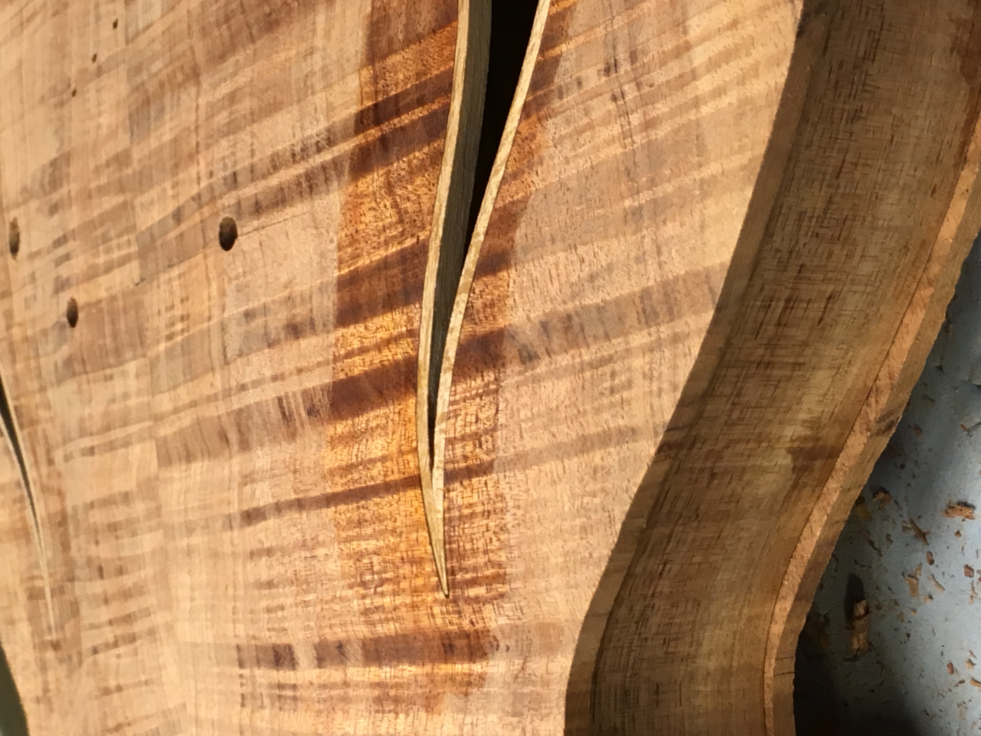

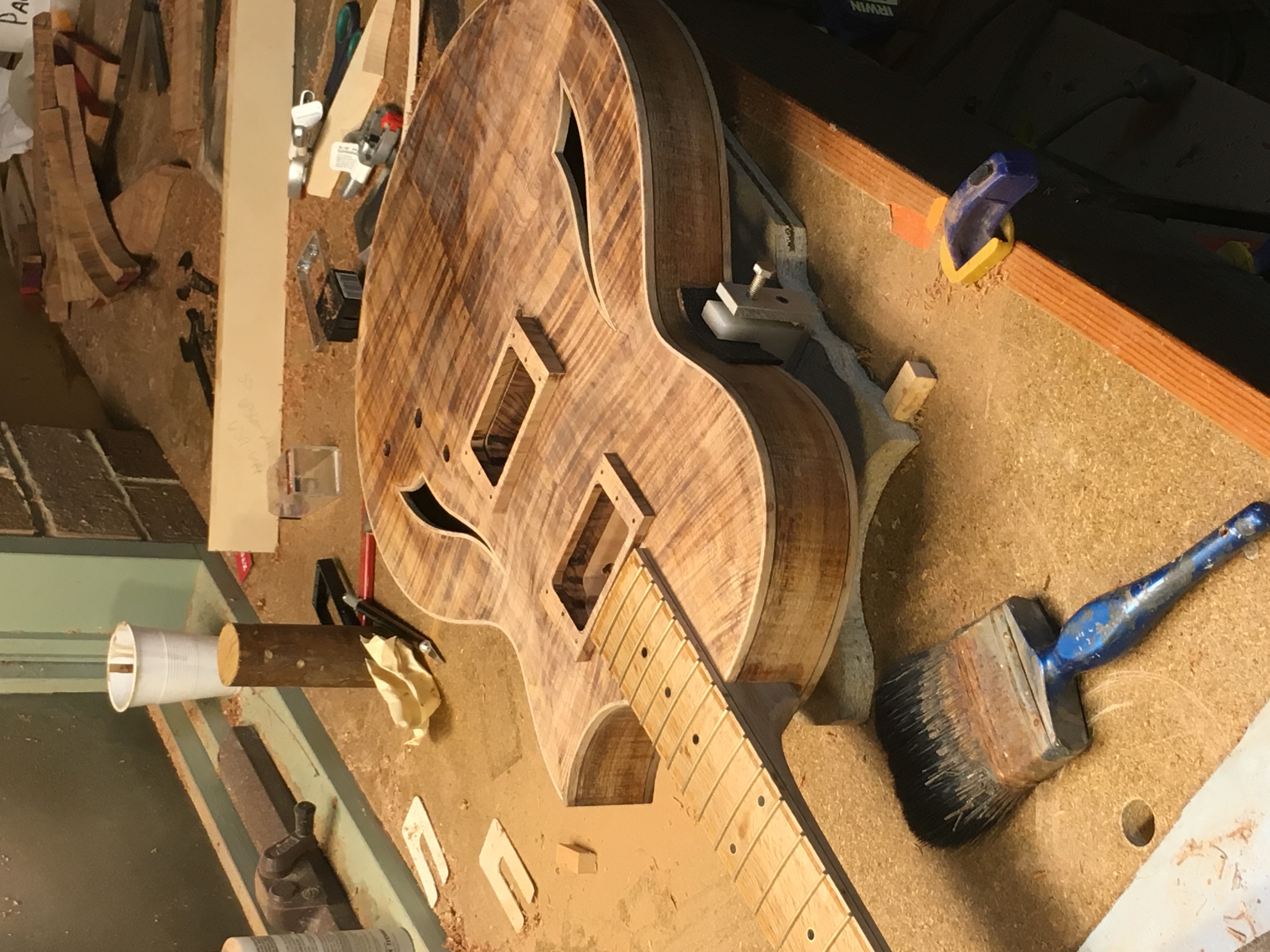

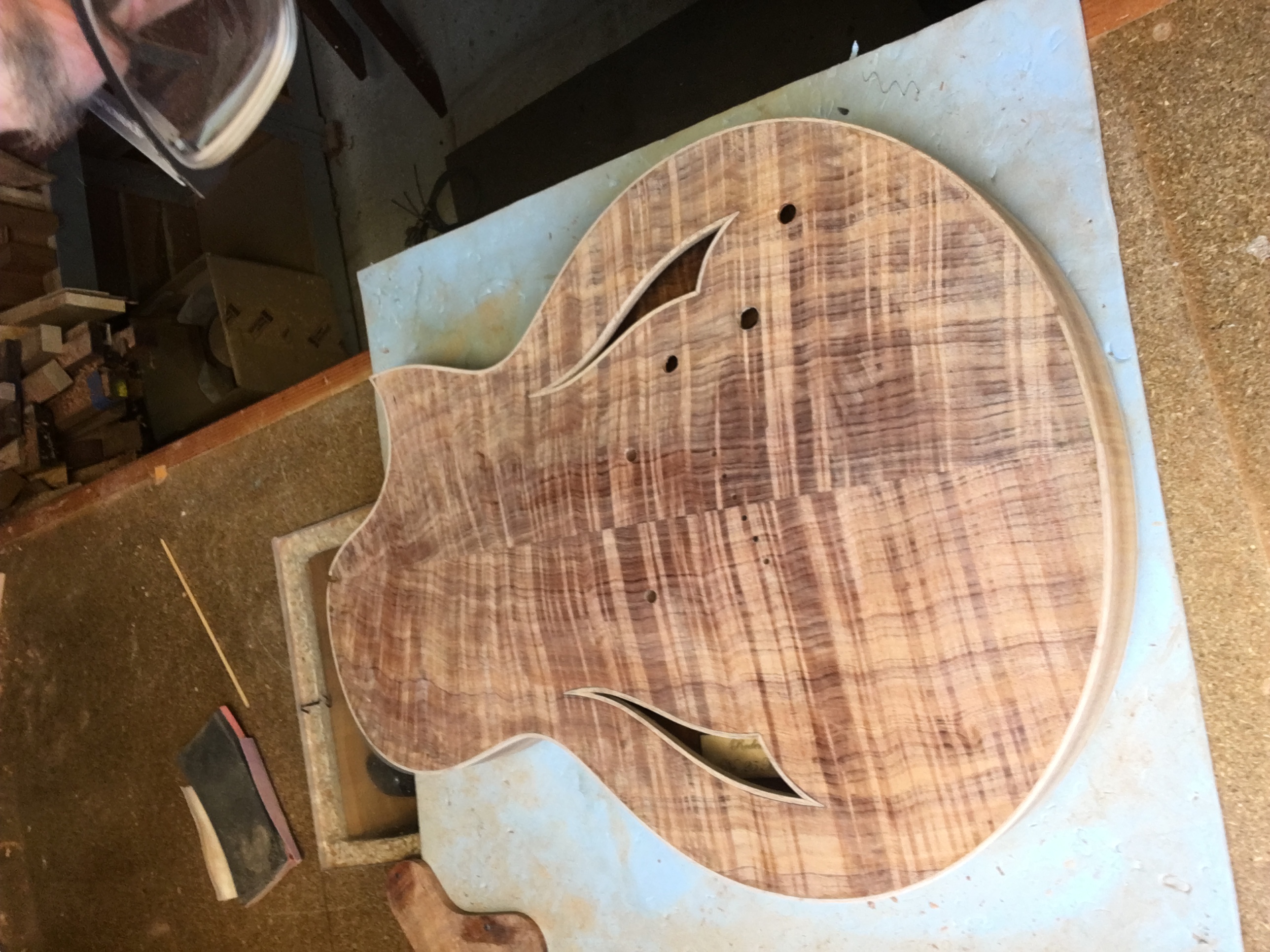

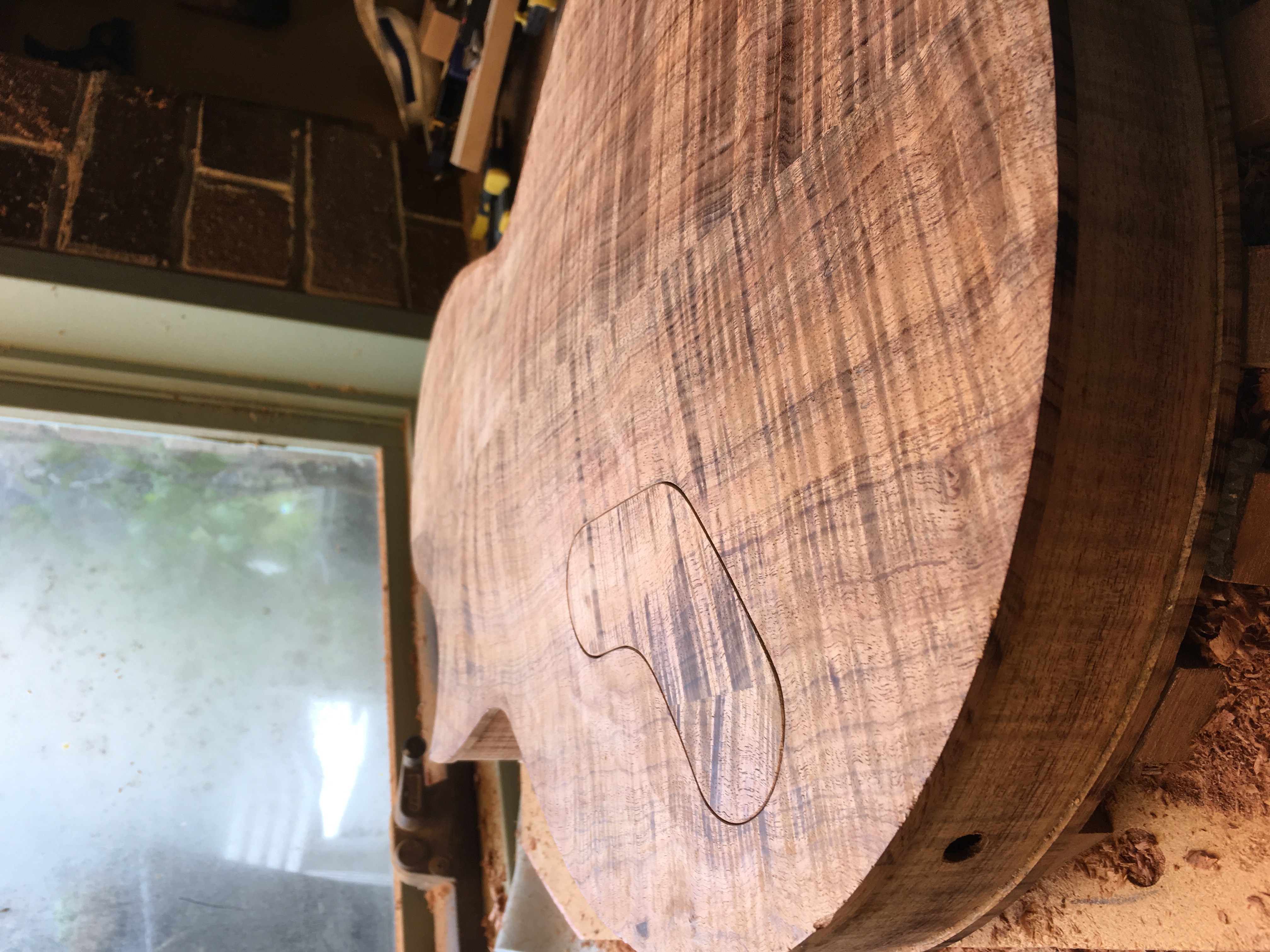

I’ve. Closed the box on this and applied one session of grainfill before the cut the neck pocket and pup cavities.

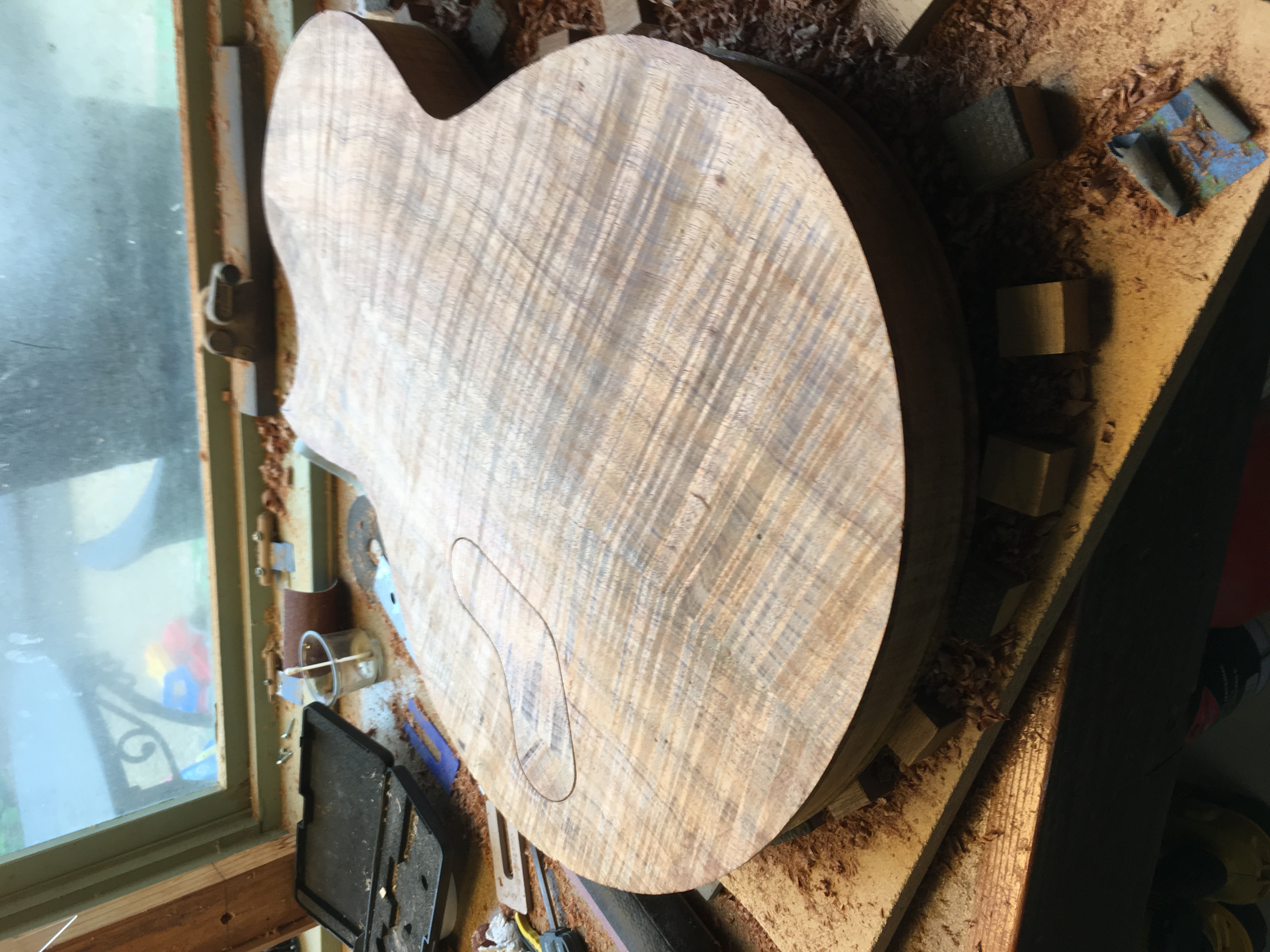

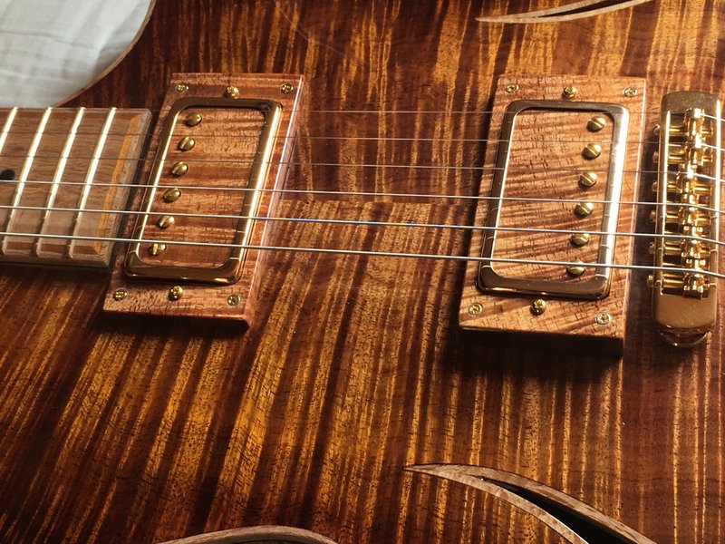

Post by rocket » Fri Aug 23, 2019 5:44 pm

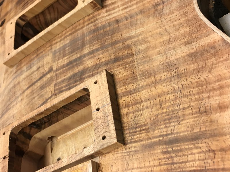

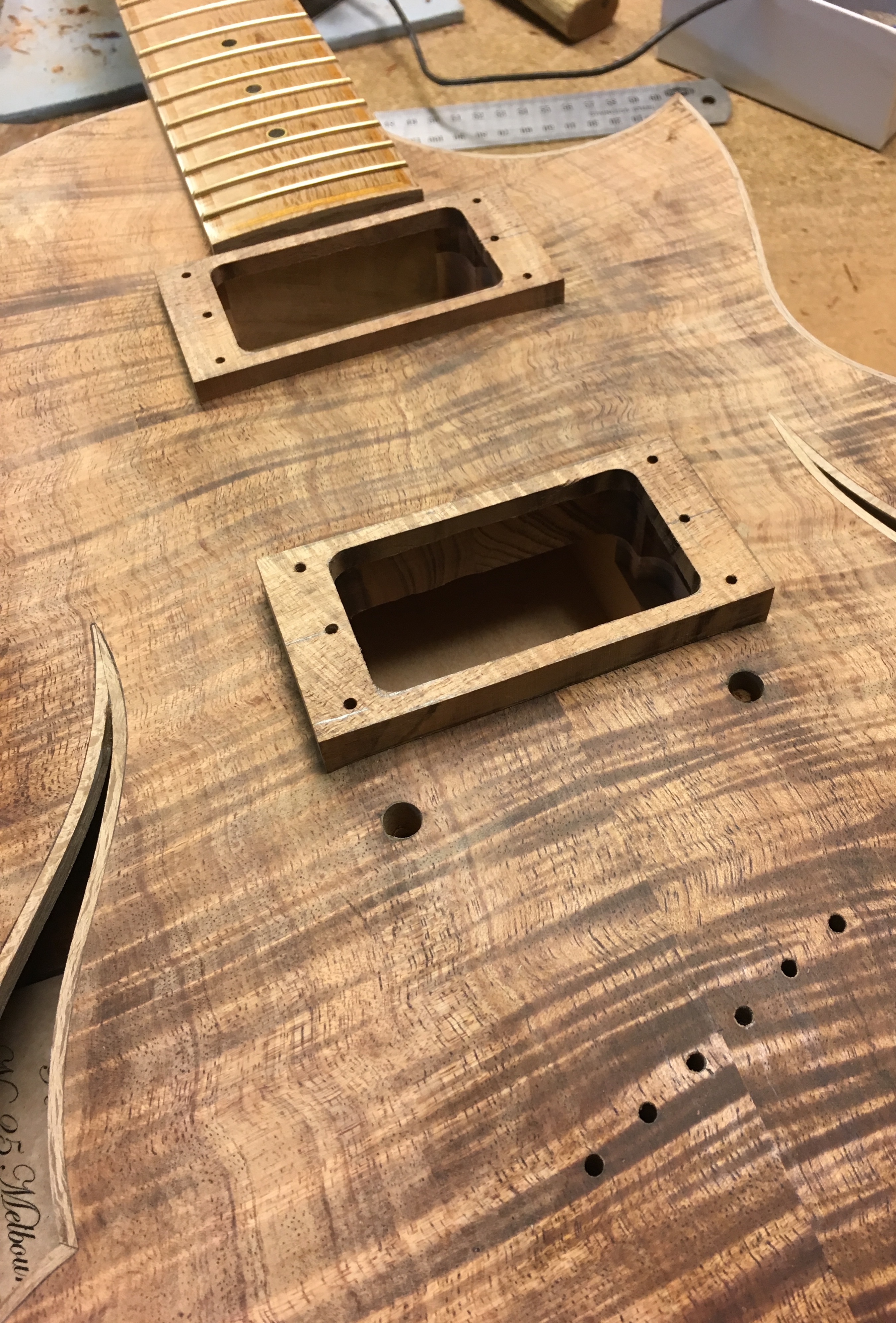

I’m still hopeful of keeping this thread wholly and solely about the titled build, so a couple of pics will show the closed body with binding and roughly shaped pickup mounting rings from the offcuts of a he plates. At this stage it has had two grainfill sessions completed and is ready for some finish but the weather is a bit cold in Melbourne atm so this is going onto the shelf for a couple of months, I can turn my attention to some other things.

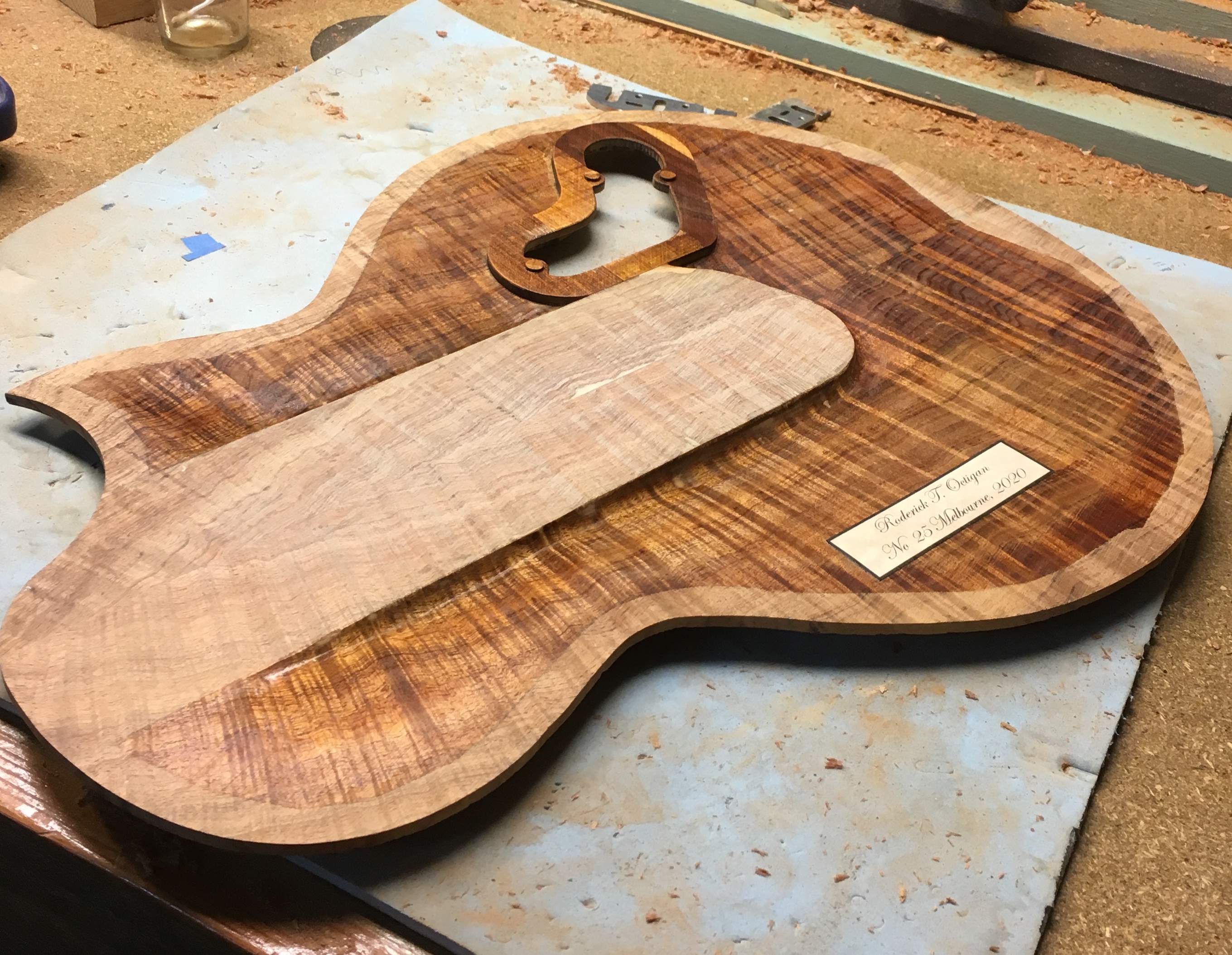

What are you planning to do about the access hatch for installing the pots?
On my last build I was desperate not to interfere with the beautiful grain on the back, despite my best efforts I still wasn't too pleased with the result. The panel was cut out but needed a lot of binding to make up for the cutting tool and finishing.
I was quite pleased however to find a way to avoid the need for plate screws.

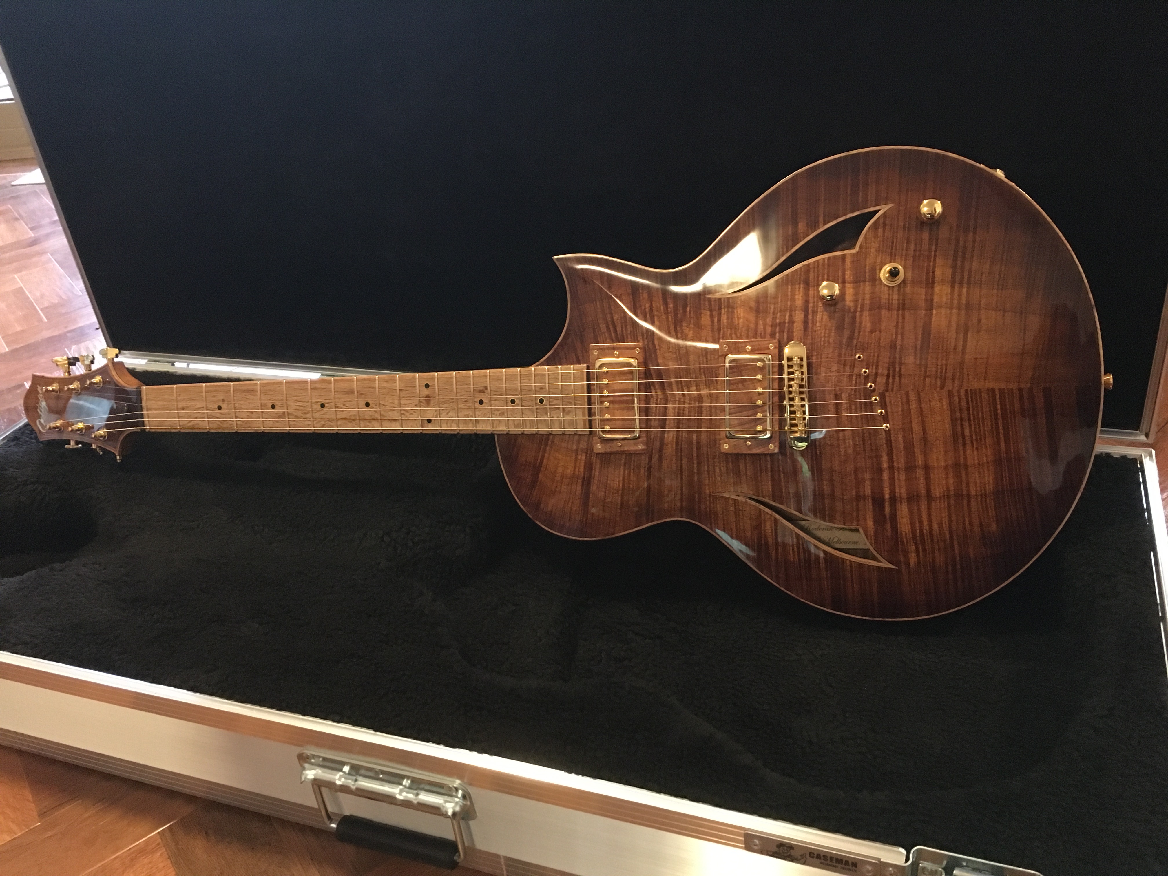

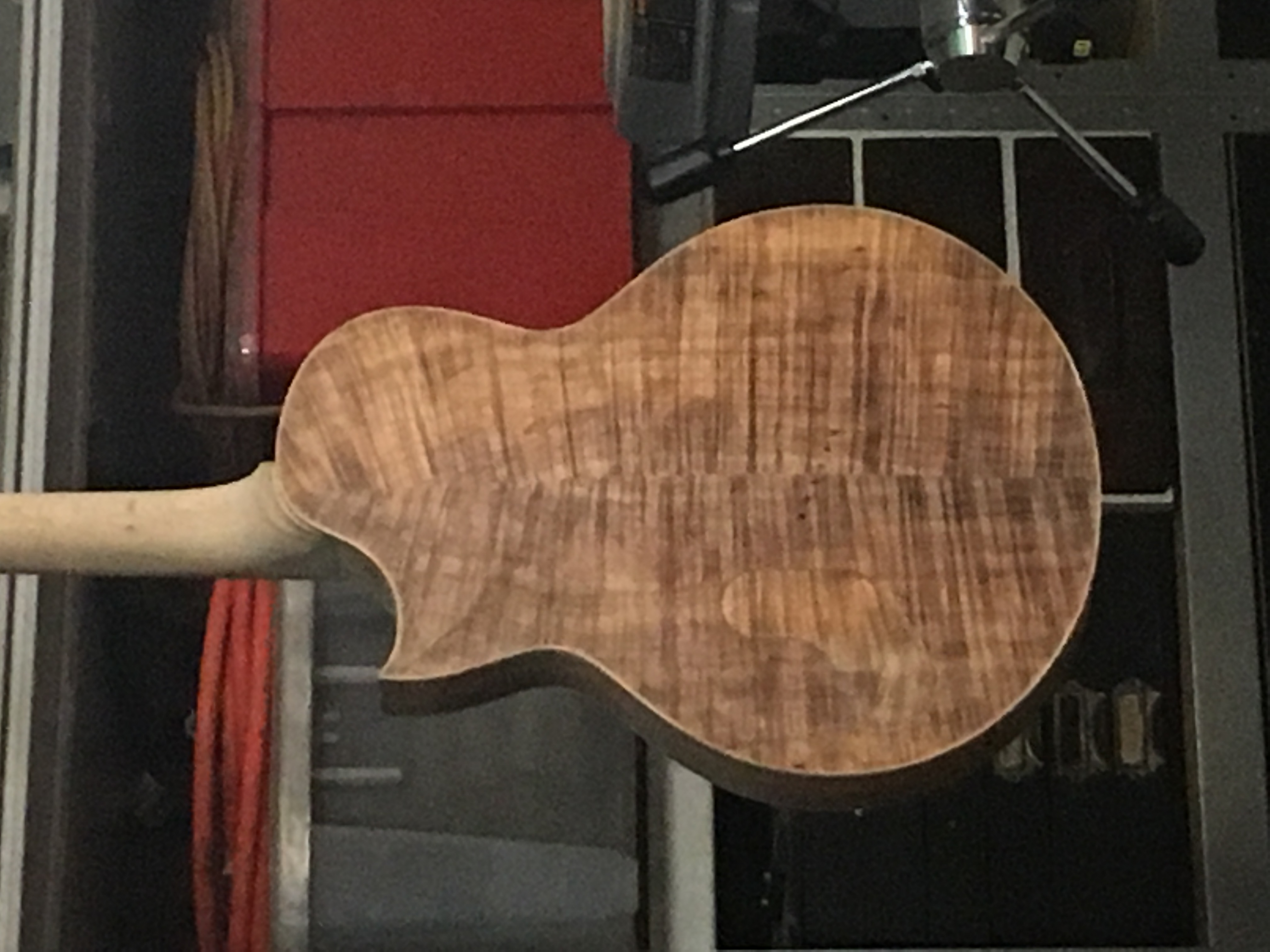

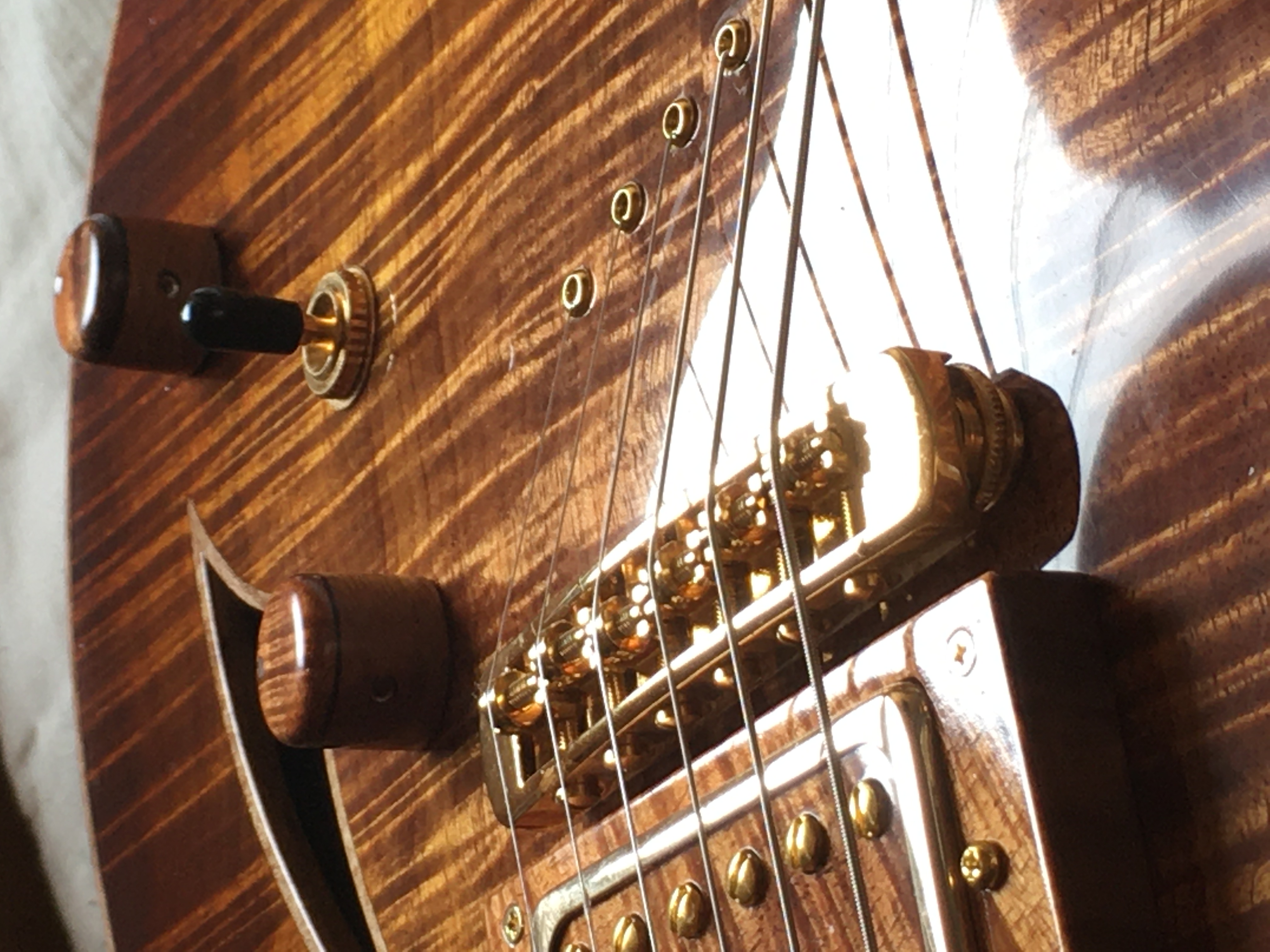

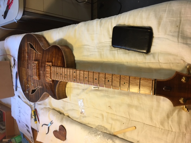

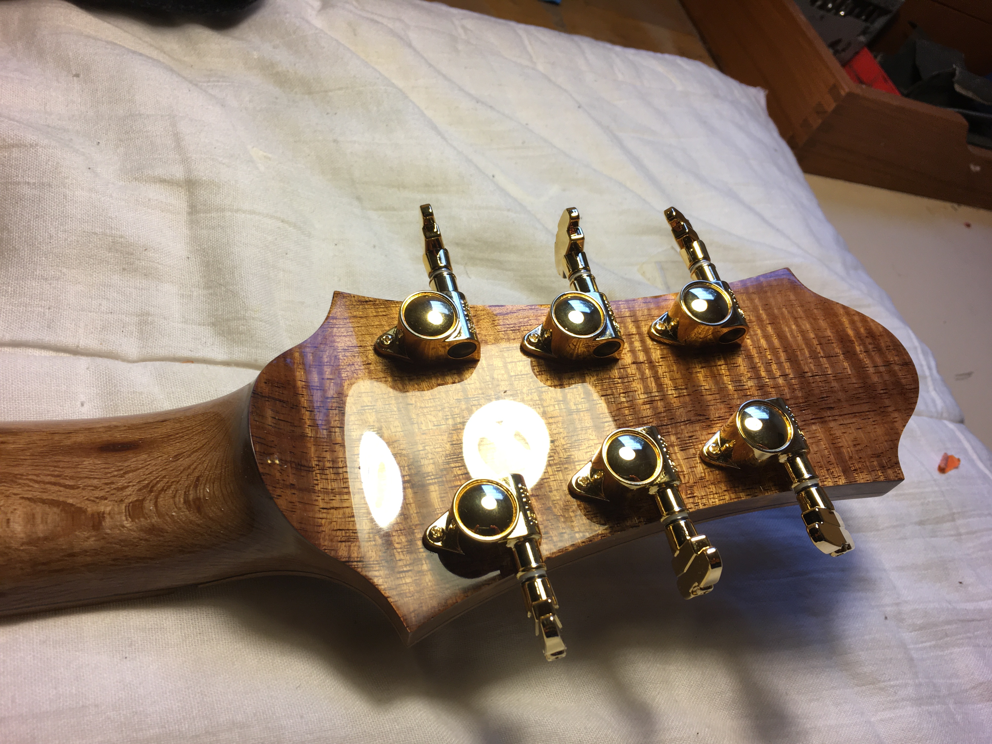

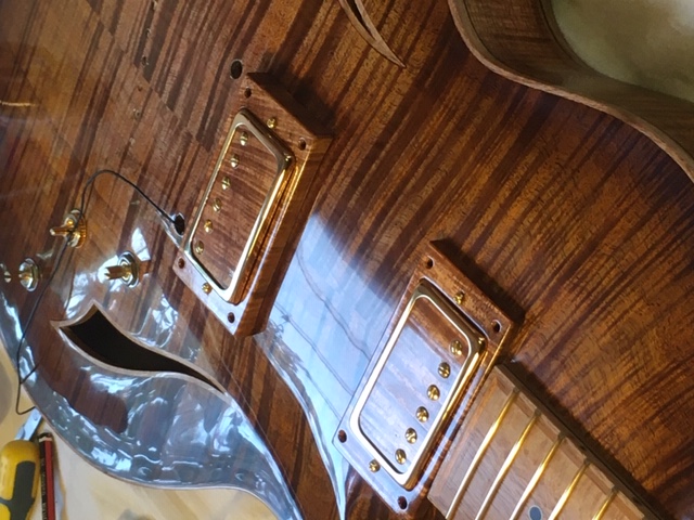

Post by rocket » Thu Feb 06, 2020 8:55 am
So this one is ready for a fit off and setup now, more pics to come.
Cheers Rod.

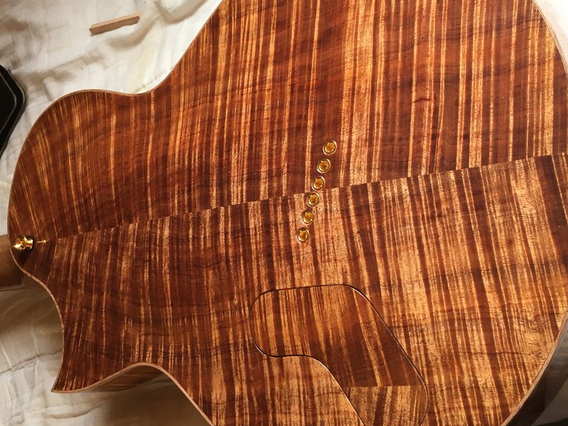

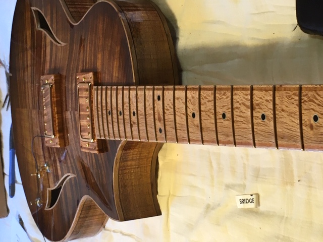

Post by rocket » Fri Feb 07, 2020 9:53 pm

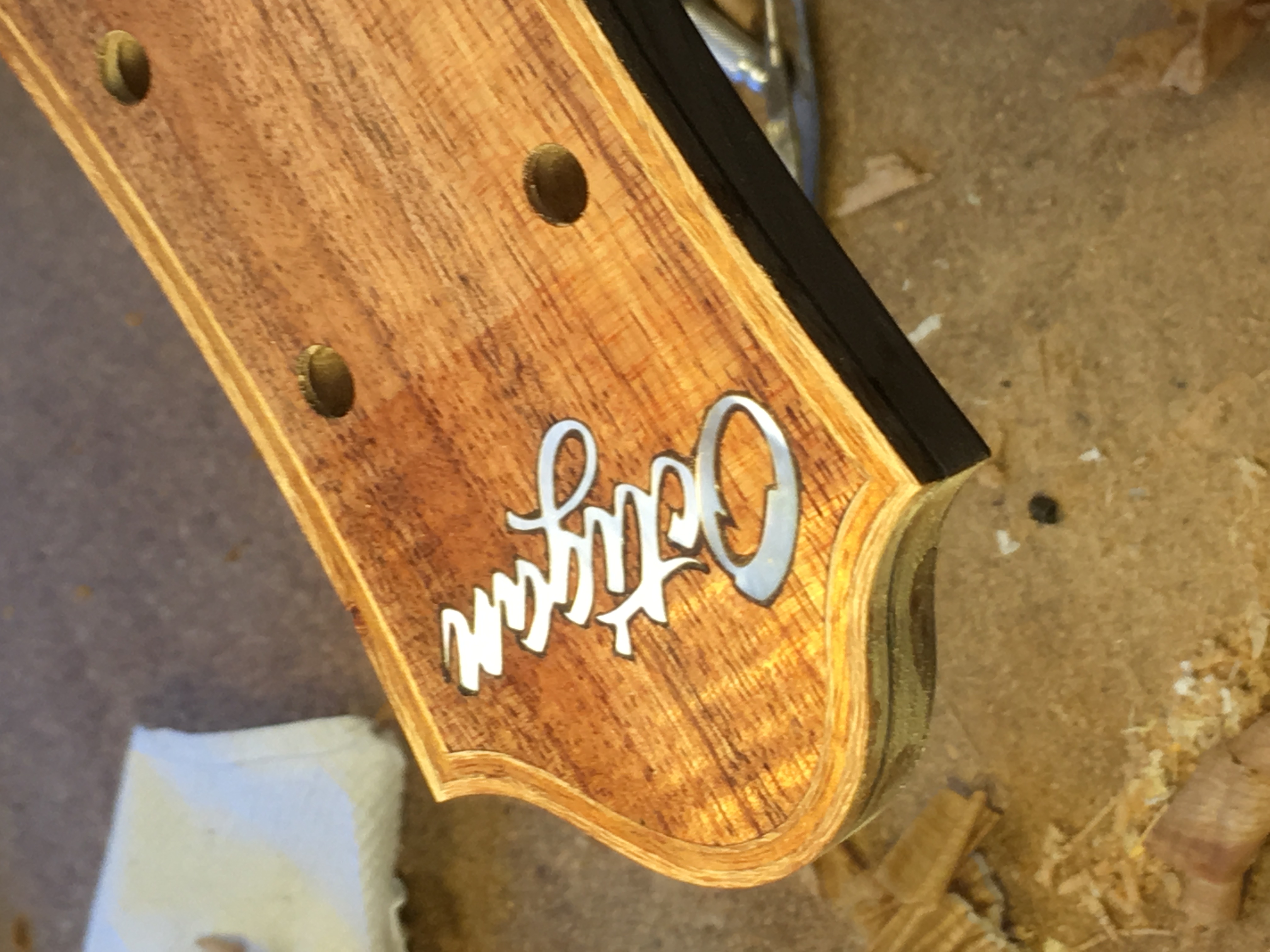

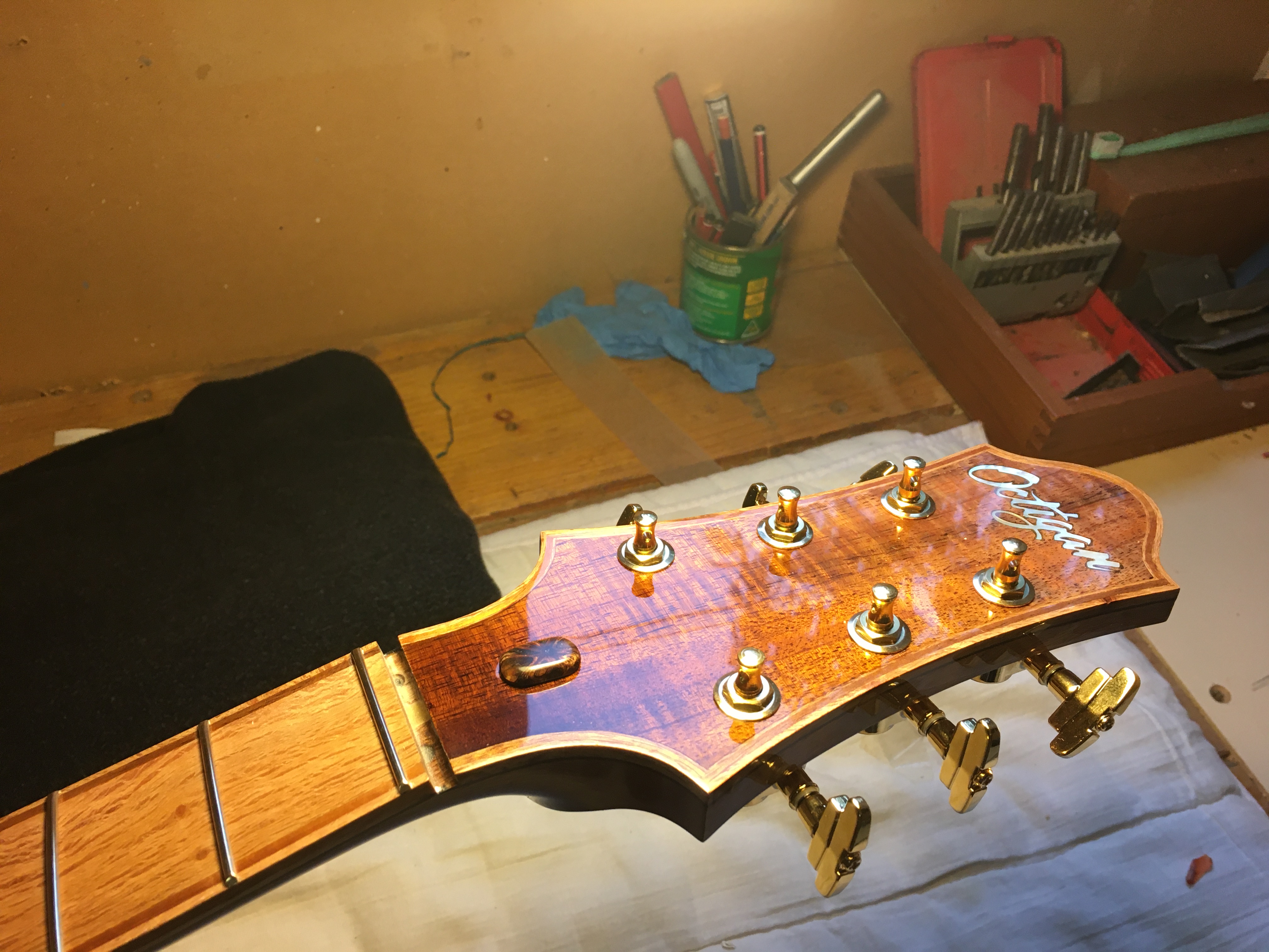

A couple more pics of the fit off

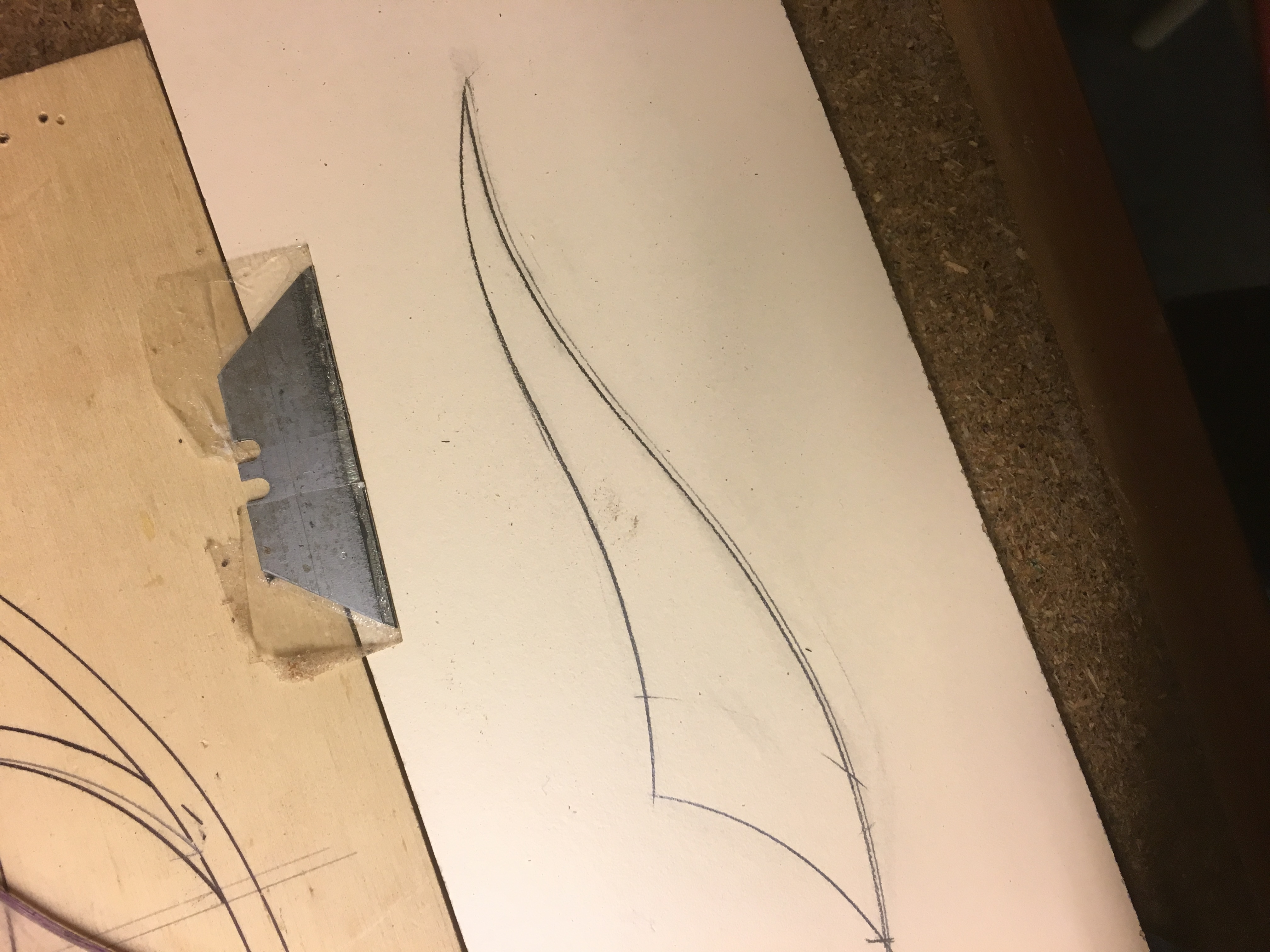

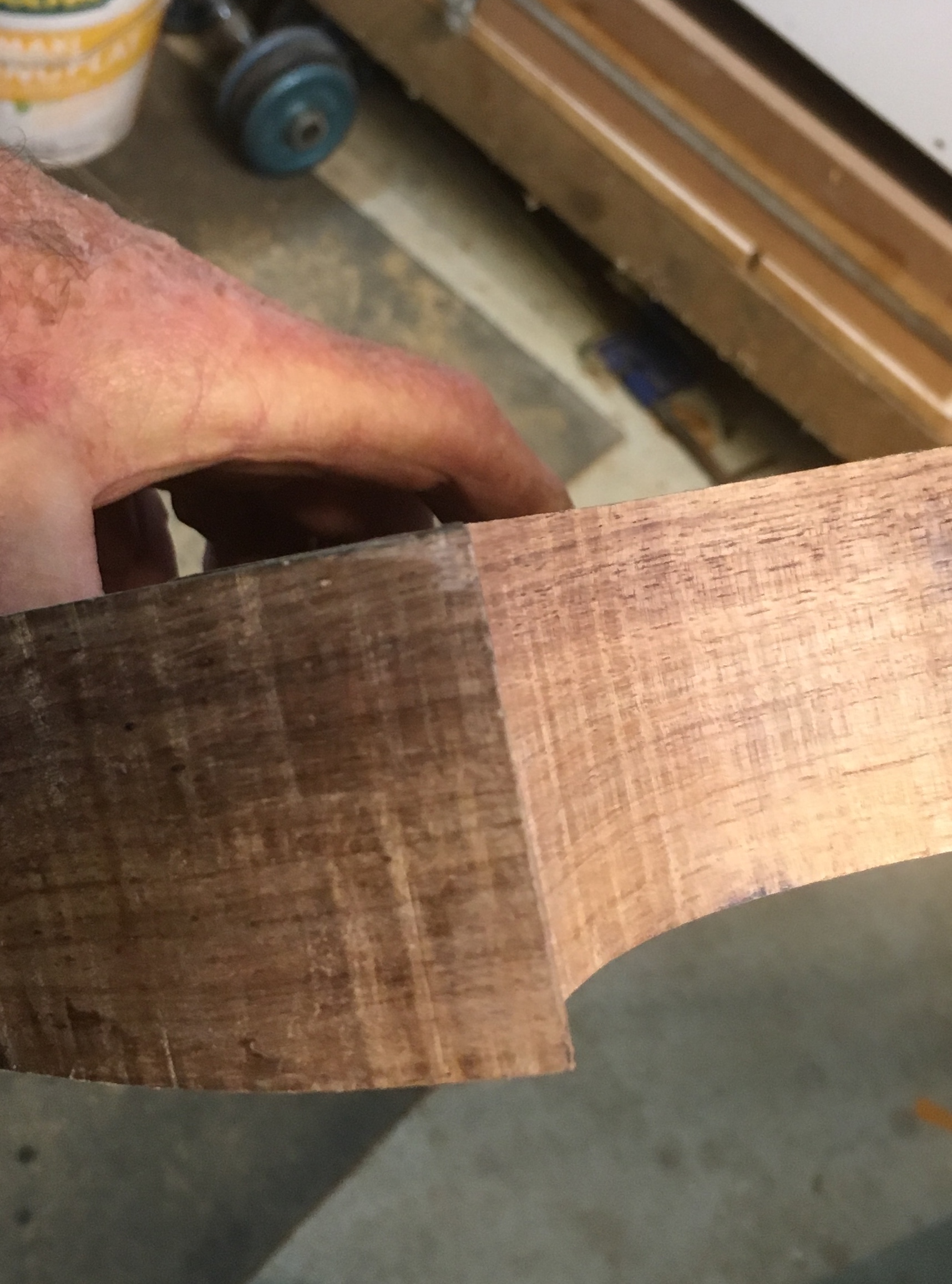

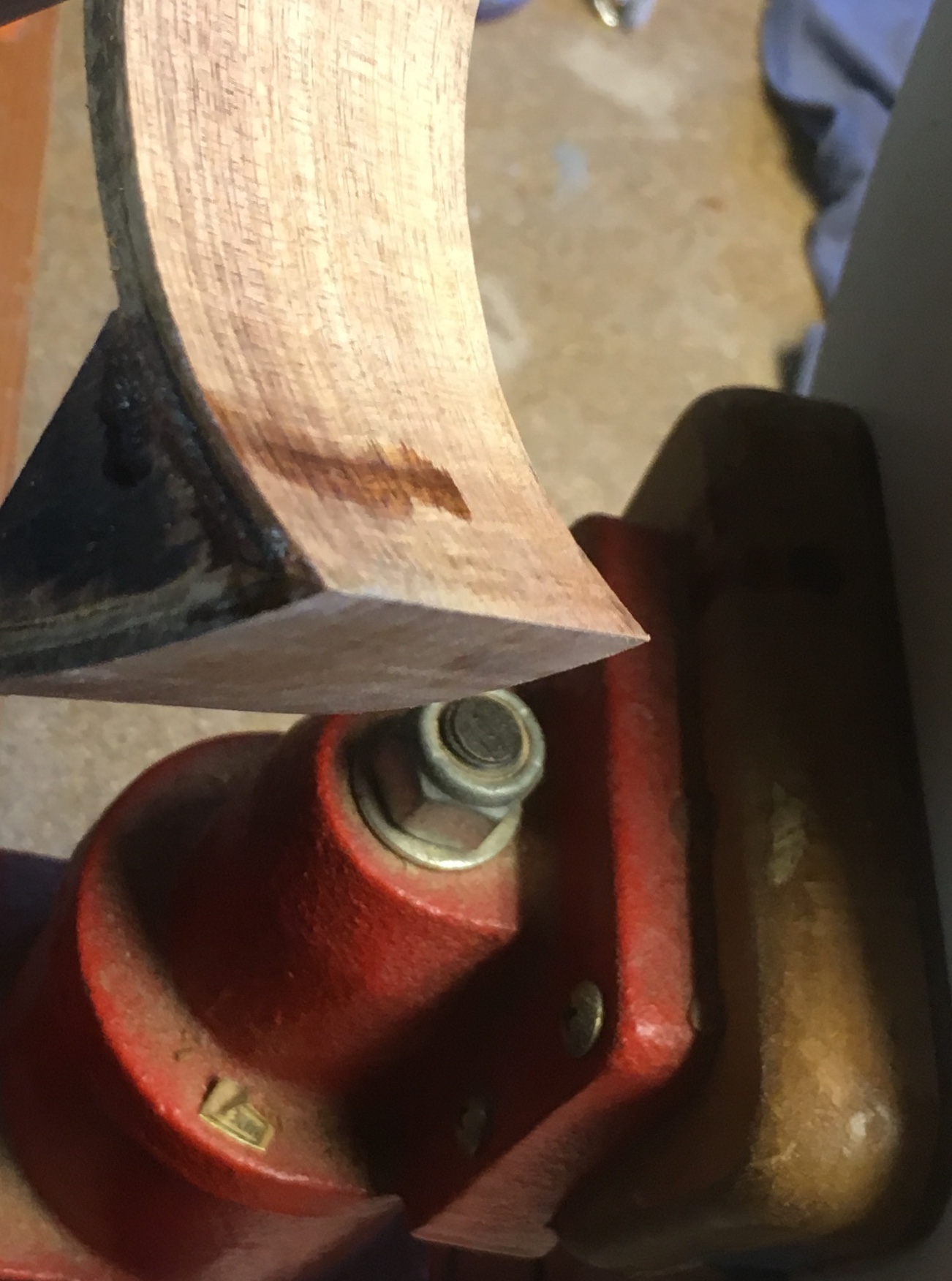

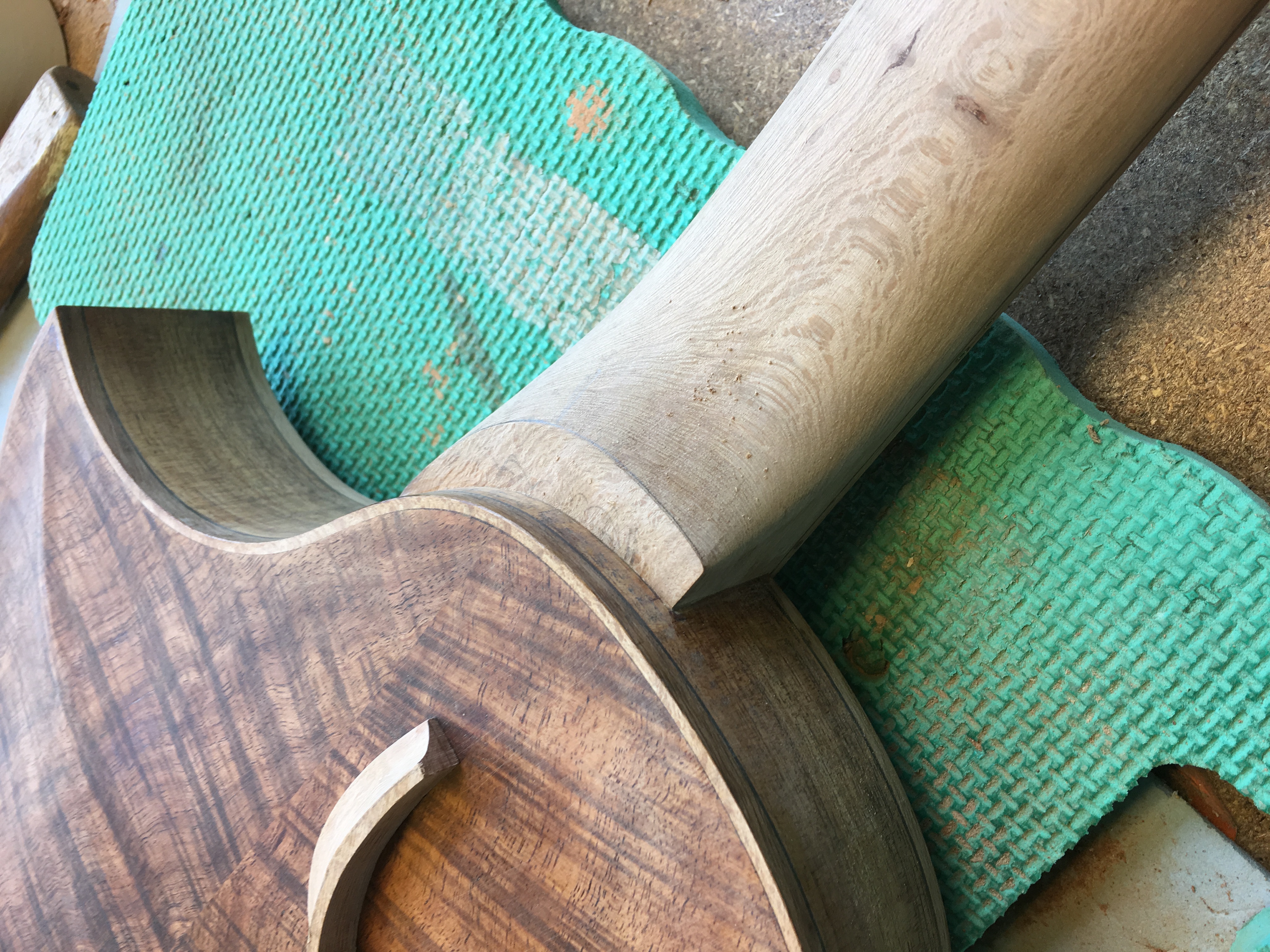

Dave M
Posts: 627
Location: Somerset UK
Post by Dave M » Sat Feb 08, 2020 3:40 am

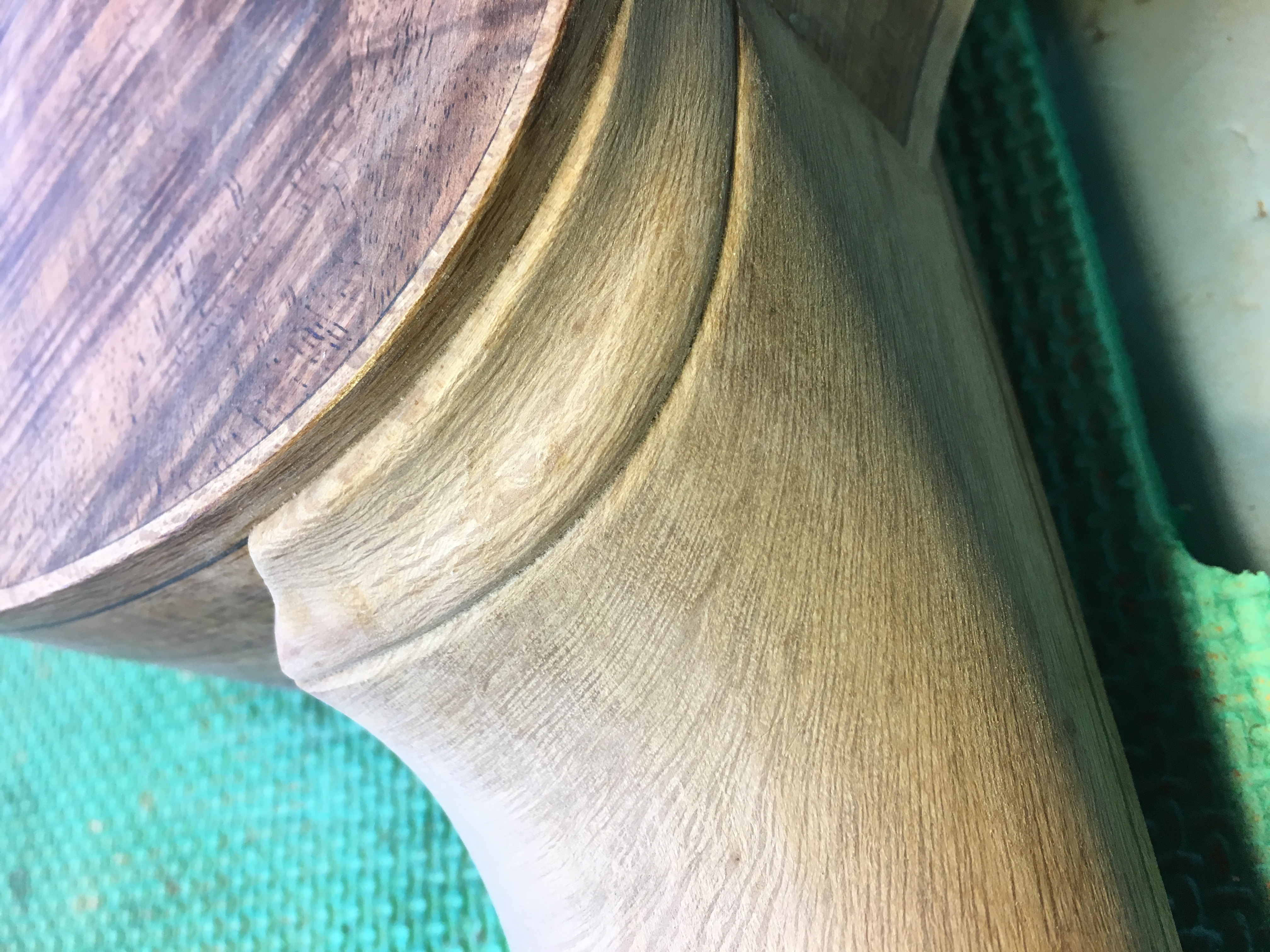

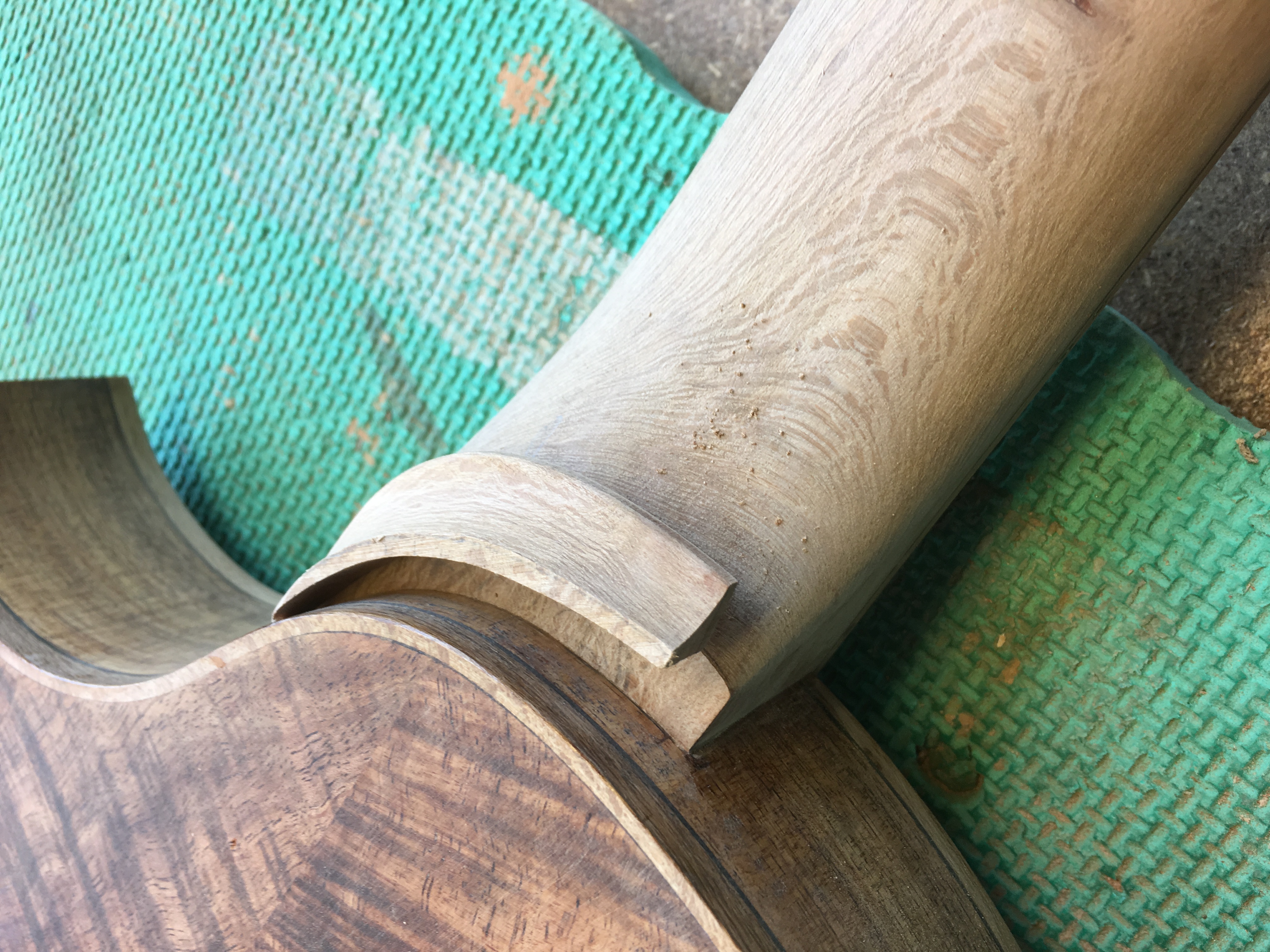

Rod that heel is interesting. Any chance of another photo or two? Is that a common thing to do on an archtop is is purely your design?

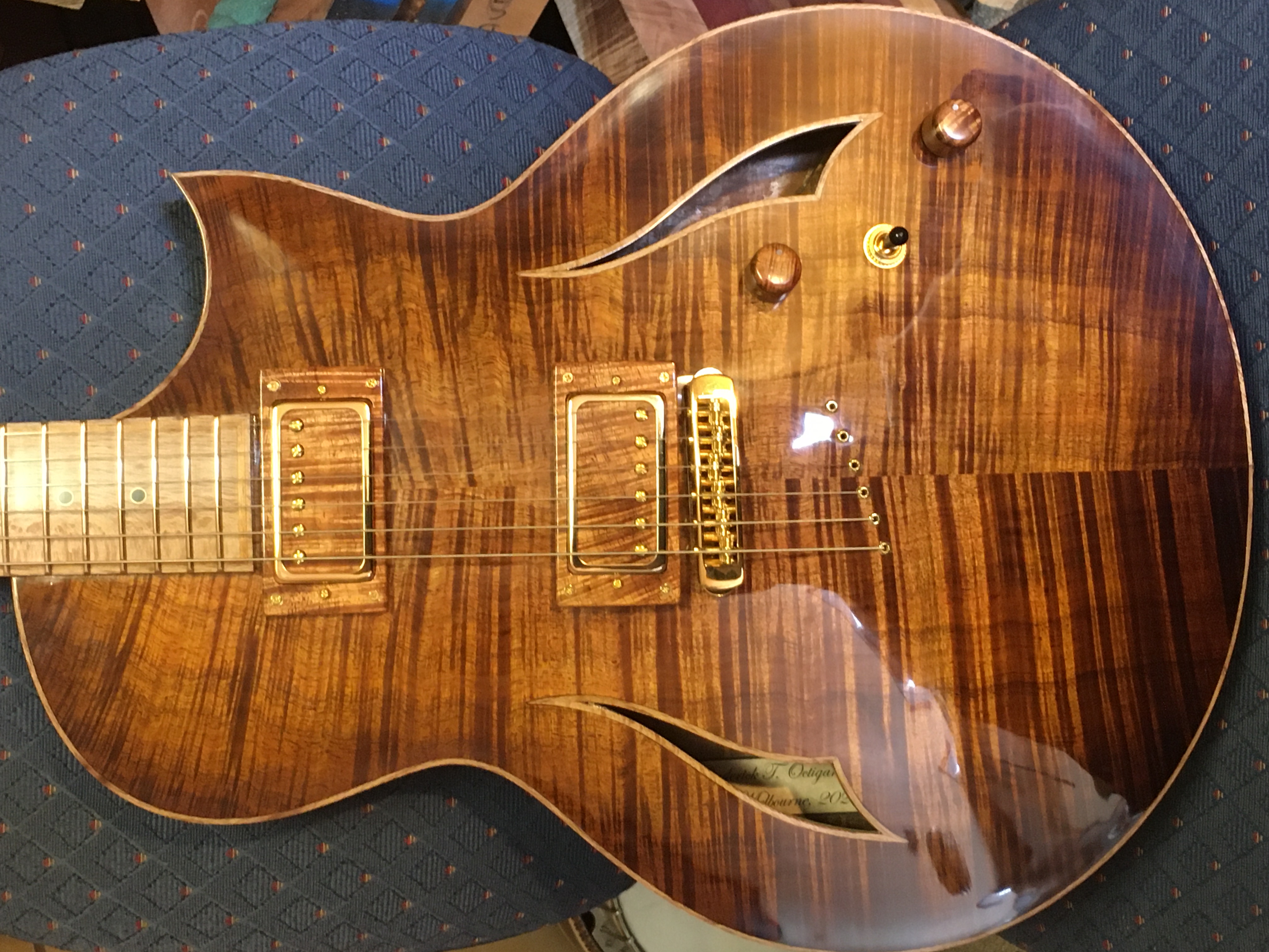

Post by rocket » Mon Feb 10, 2020 11:30 am
There it is
Rod
Joseph Jones
Posts: 77
Joined: Wed Aug 08, 2018 11:56 am
Location: Narrikup WA

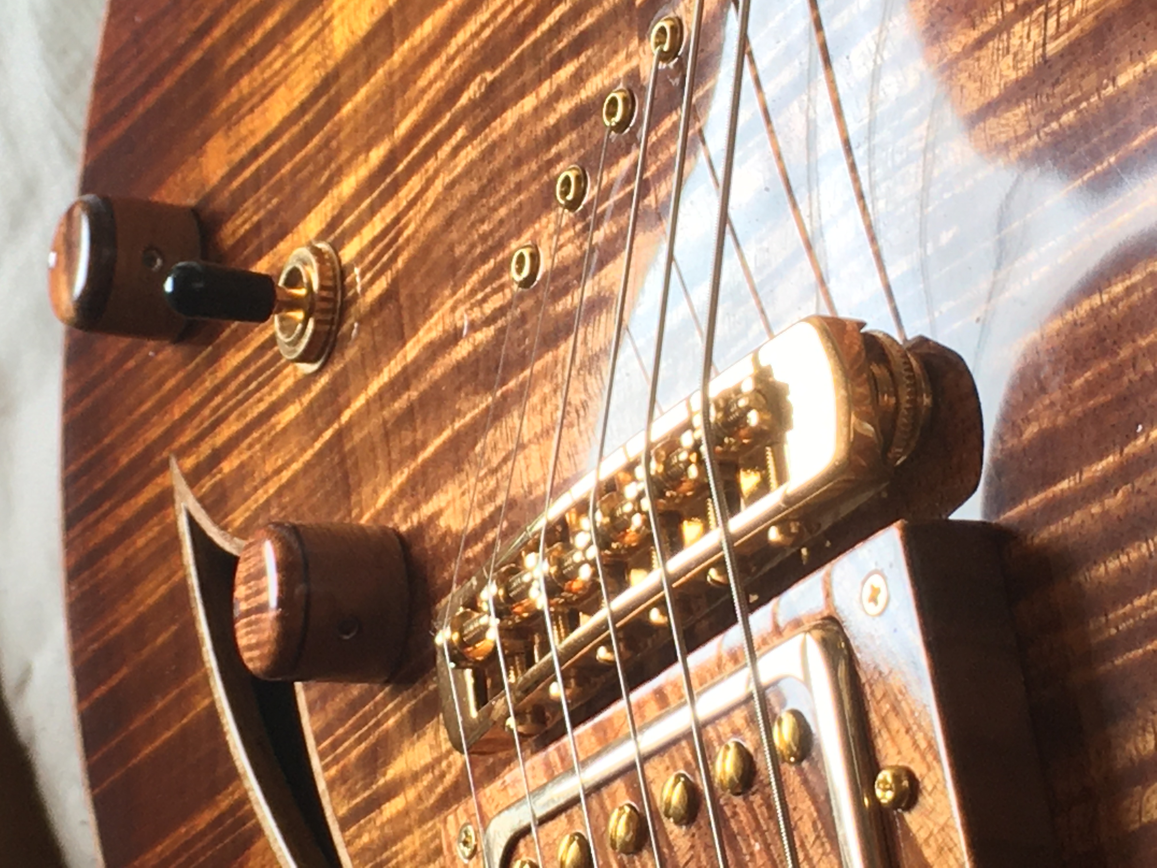

Post by Joseph Jones » Mon Feb 10, 2020 1:27 pm
Nice.
The stone is hard and the drop is small but a hole is made by the constant fall.
Posts: 1166
Post by Mark McLean » Wed Feb 12, 2020 8:57 am
Rod, that looks sensational. Many individual classy touches, like the timber covered pickups and the timber knobs (did you turn those yourself?). I also like the way that you incorporated the “heel” of the neck into the curved body. That is very clever and elegant. Does the laundry look as good as the guitar? You are quite a craftsman.
Post by rocket » Thu Feb 13, 2020 9:42 pm
Thanks Mark, yeah i made the knobs by using a hole saw without the pilot and then turned them on a spindle and put a brass insert inside to take a tap for the grub screw, i wanted to go that way because i thought my original plan of gold knobs would be too garish and too much bling but i think the gold would also go well, it can be an option for any prospective customers i suppose. Although i think I've made a couple of little mistakes i am very happy with the outcome, i've borrowed some ideas from some other builders but overall its basically my design, i don't know of any other thin line semi's with matching arched plates with a 15 inch lower bout and string through design, the 15 inch body saw the need to order a custom made road case to protect this little gem.

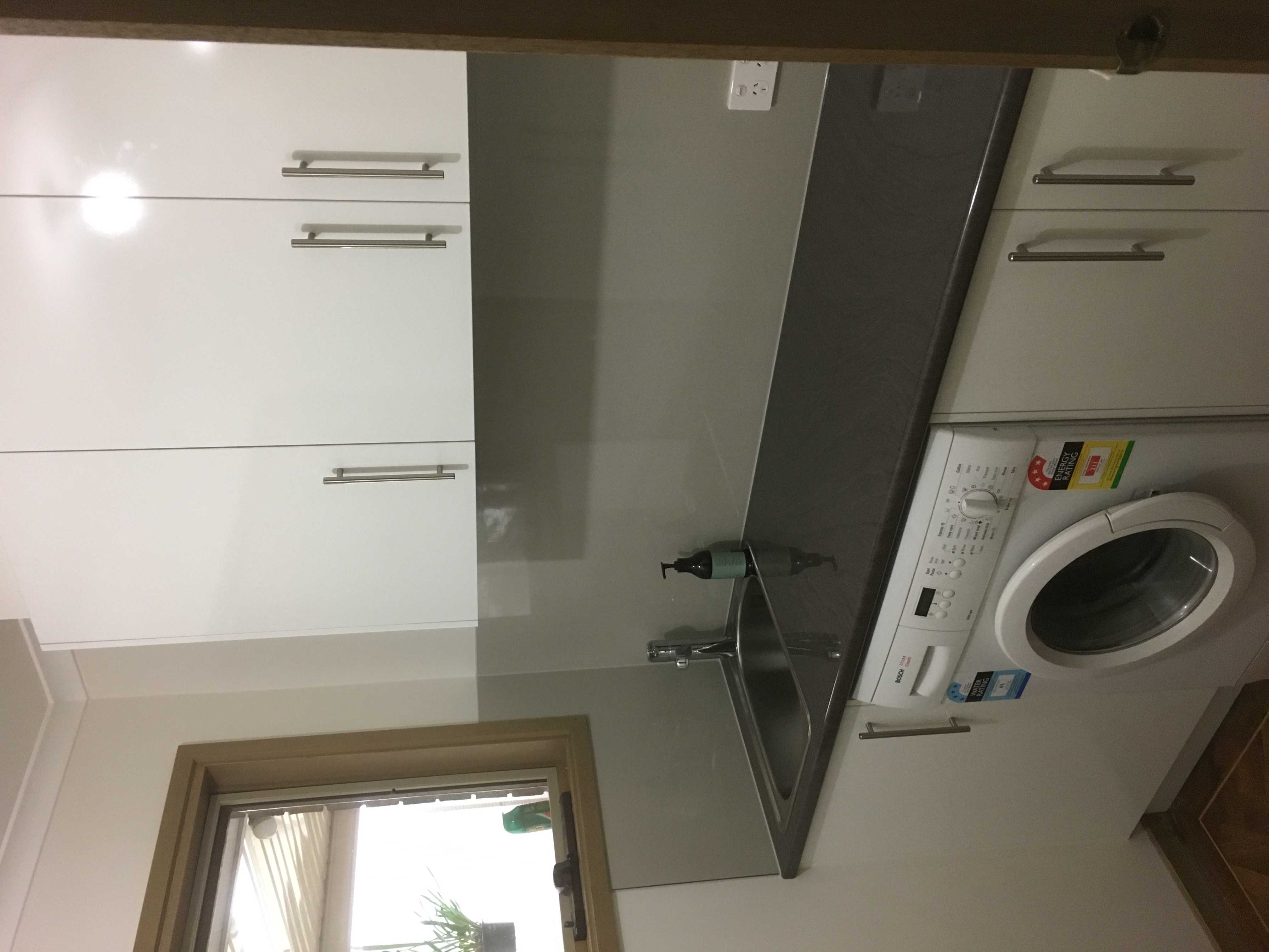

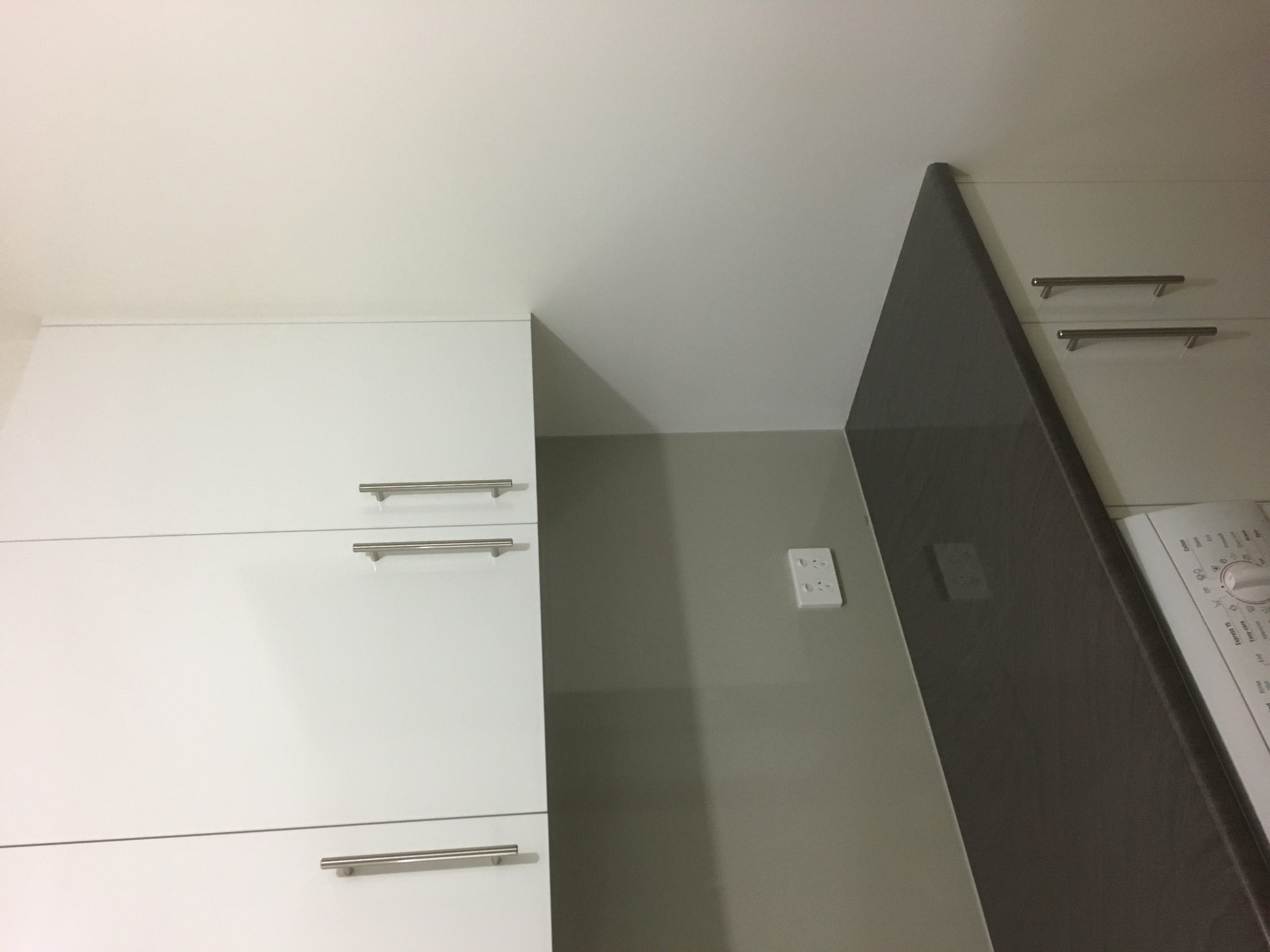

Post by rocket » Fri Feb 14, 2020 8:53 am
Thanks for asking Mark, even though this is a bit off topic here’s some pics of the laundry
Bruce McC
Posts: 397
Post by Bruce McC » Fri Feb 14, 2020 9:18 am
Bloody hell Rod a glass splash back and parquetry floor in a laundry!
That should keep the missus happy and win you a few brownie points. :cl
Post by rocket » Sun Feb 16, 2020 3:56 pm
New case
Posts: 1166
Post by Mark McLean » Sun Feb 16, 2020 6:59 pm
Looks like the sort of home that it deserves.
