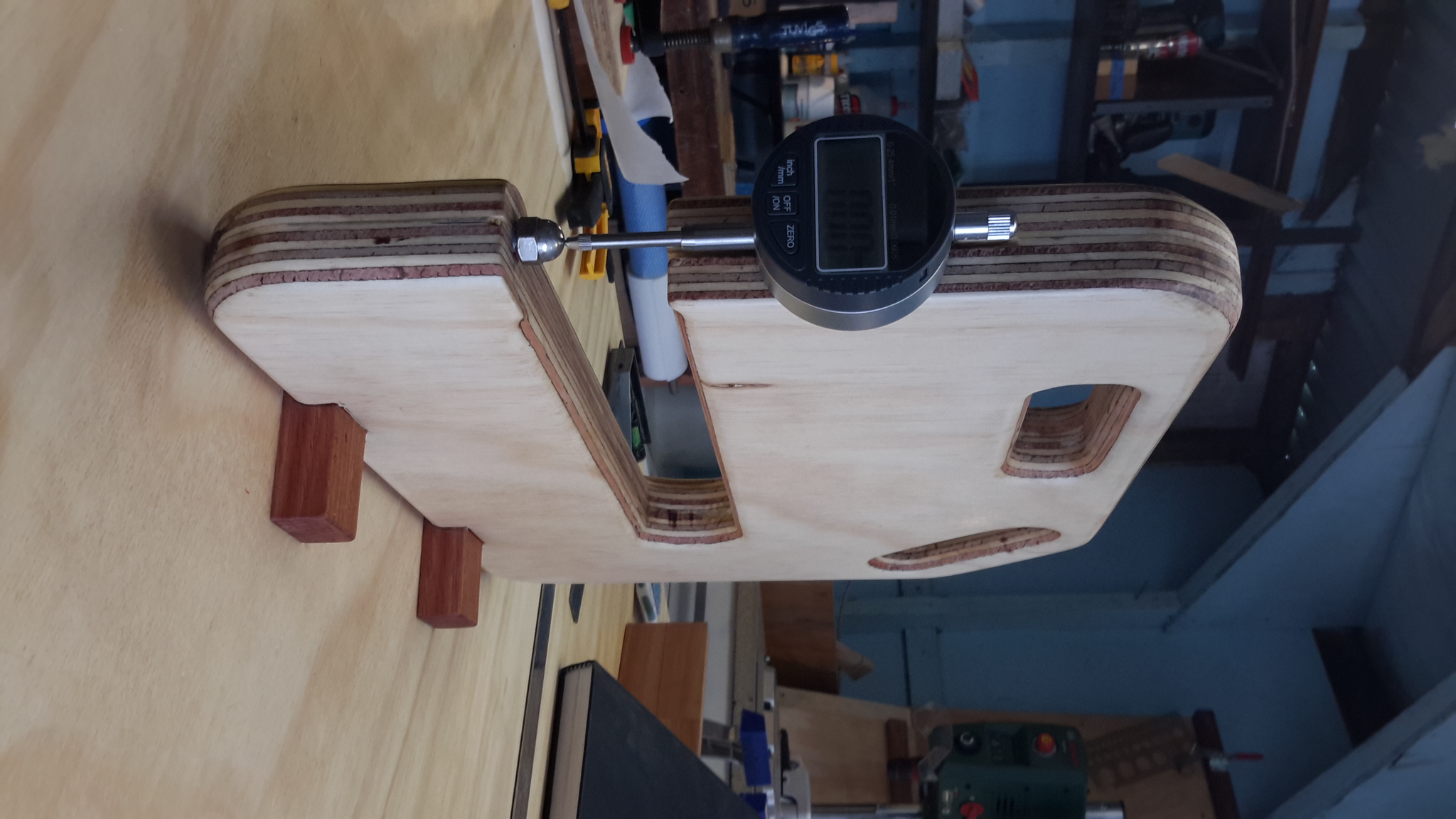

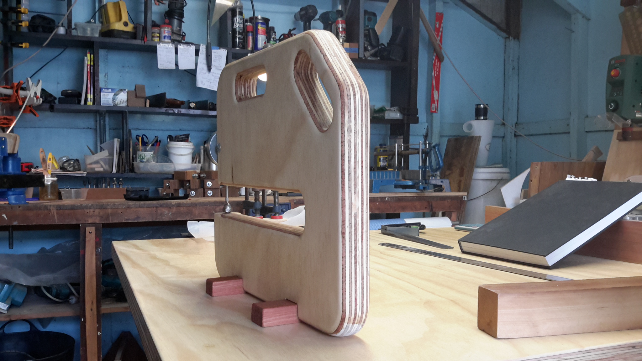

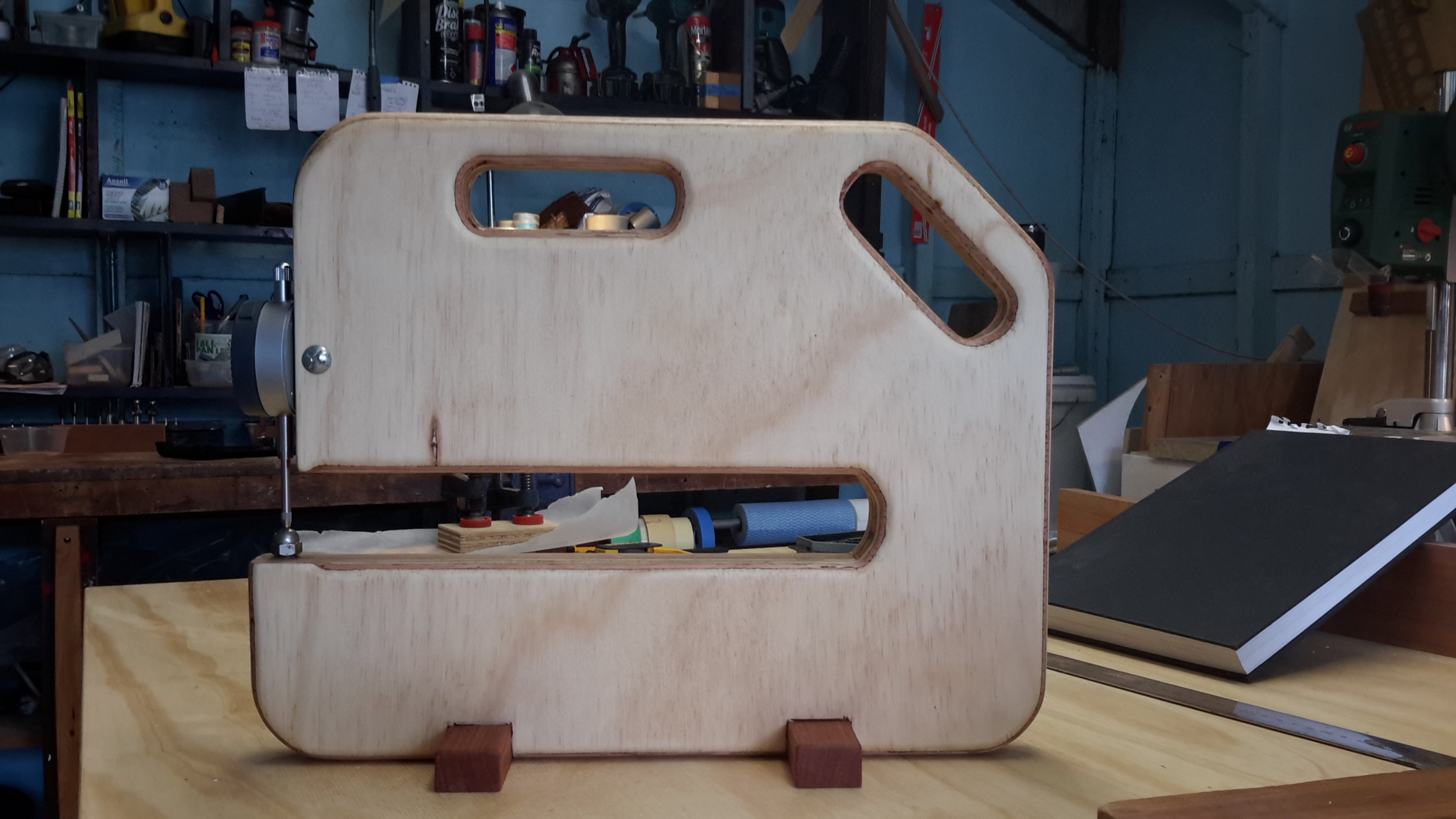

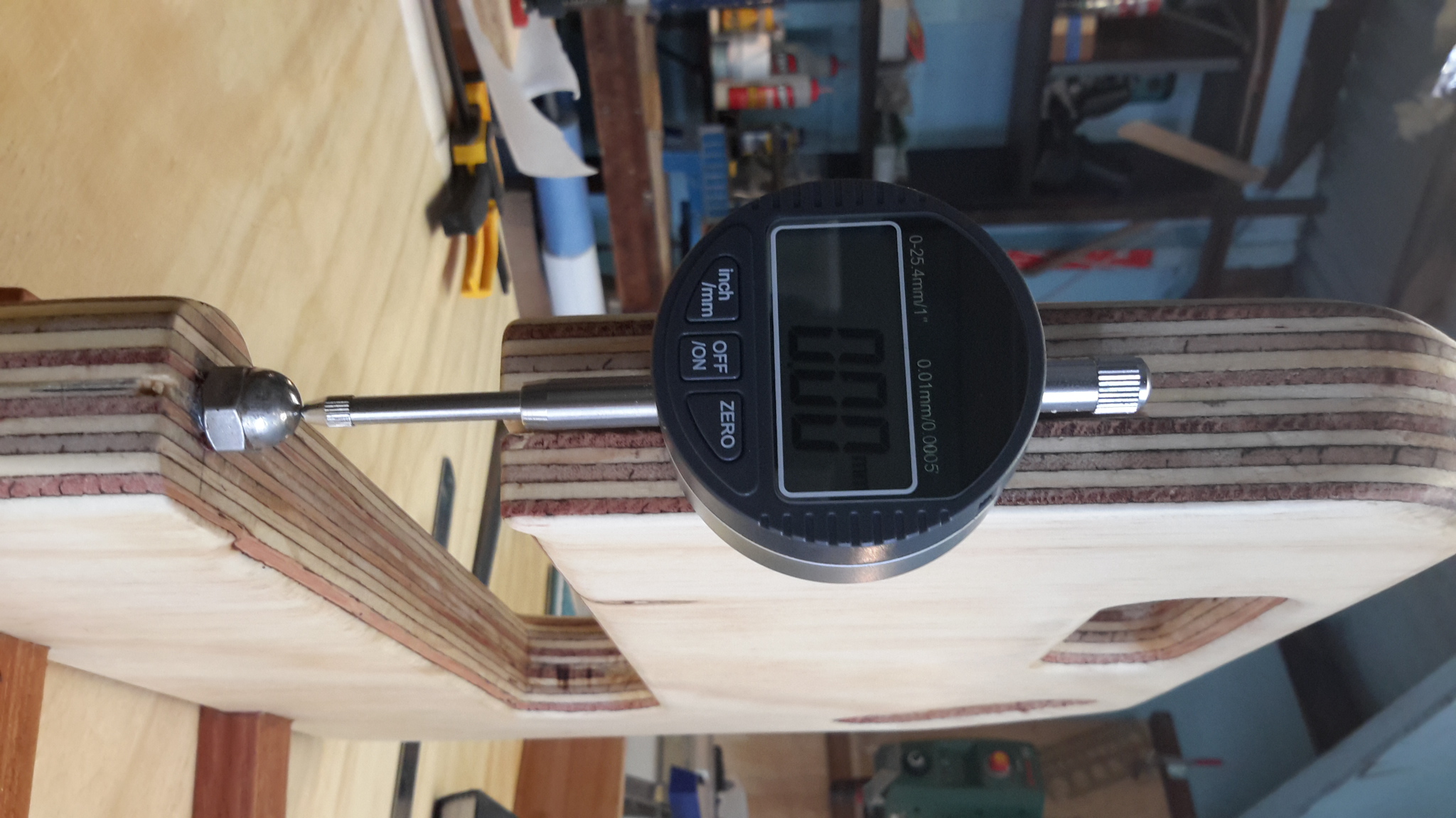

After much umming and ahhing about the cost of a proper gauge and then again in at the potential inaccuracies of a cheaper Chinese offering, I decided to make my own. I could make another one if anyone is interested. It works perfectly and appears to be plenty accurate enough for my purposes. It has a 300mm throat. I toyed with the idea of a lifting lever but I honedtly don't think it's necessary. PM me if you are interested.

Hi Wayne. After a bit of research, I ended up buying it from Amazon.com.au. It's a Neoteck digital indicator Model: NKT021, sold by neoteckau
