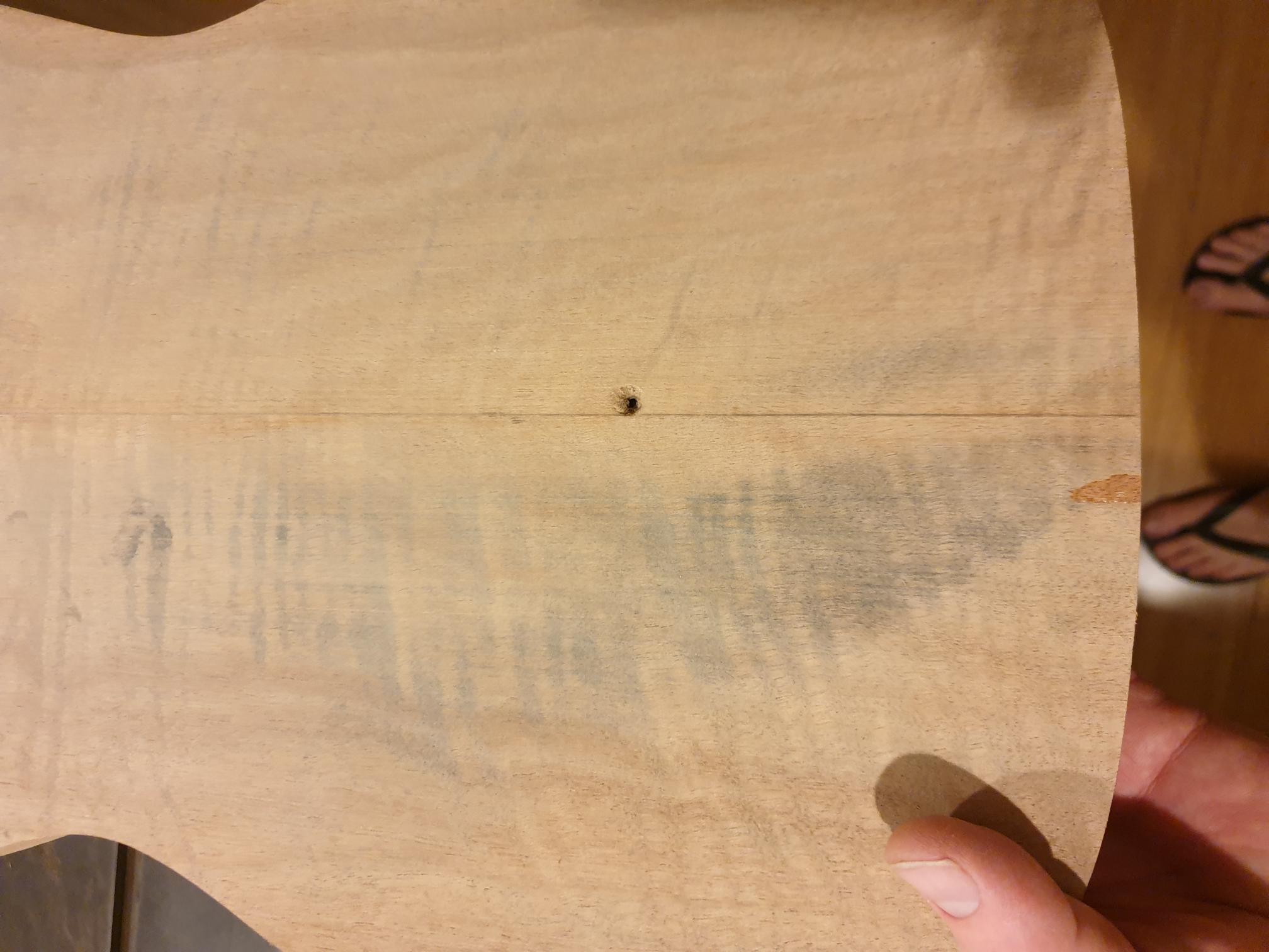

With water and after it had dried, you can see on the right hand side the staining isnt bad and I gave it a light sand wich seemed to work ok but there is still black in the flame so I stopped to see if I could find another solution rather than sand anymore..

That looks like staining due to a mix of iron and carbonate ions in your water reacting with the tannins in the wood (i.e. hard water plus iron plus tannins). A certain fix for that is to wash it down with a mild solution of oxalic acid in pure (de-ionised) water. Oxalic acid is available in crystal form from Bunnings as a deck cleaner. Don't use too much (a teaspoon of oxalic acid crystals dissolved in a cup of warm water is plenty) or you will end up with a red hue in the wood. Wash down afterwards with a mild acid solution e.g. white vinegar in pure water. You could try starting with a wash down of white vinegar in water and that may just do the trick. But if it doesn't, you now know what will work. Oxalic acid is a bit nasty, so observe the safety instructions on the container.

I was thinking the above but didn't think Queensland Maple was that high in tannins. I didn't consider high iron in the water.
