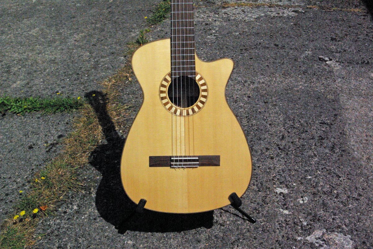

I've also made steel strings on my small body classical chassis (340mm lower bout). That's about as small as I'd want to go a keep a full bass response. Here's one (no sound, though).

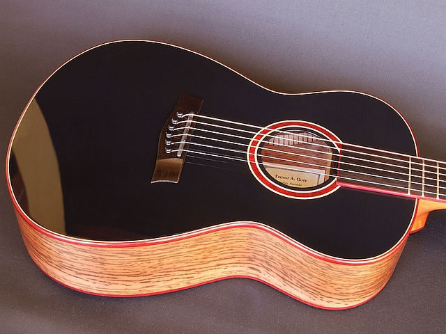

I've been building my classicals like this which has the overall dimensions of Torres SE114 but using your high waist which I like. With the lower bout at around 350 the outline doesn't differ very much from the Torres.
That black top really is seriously black!
