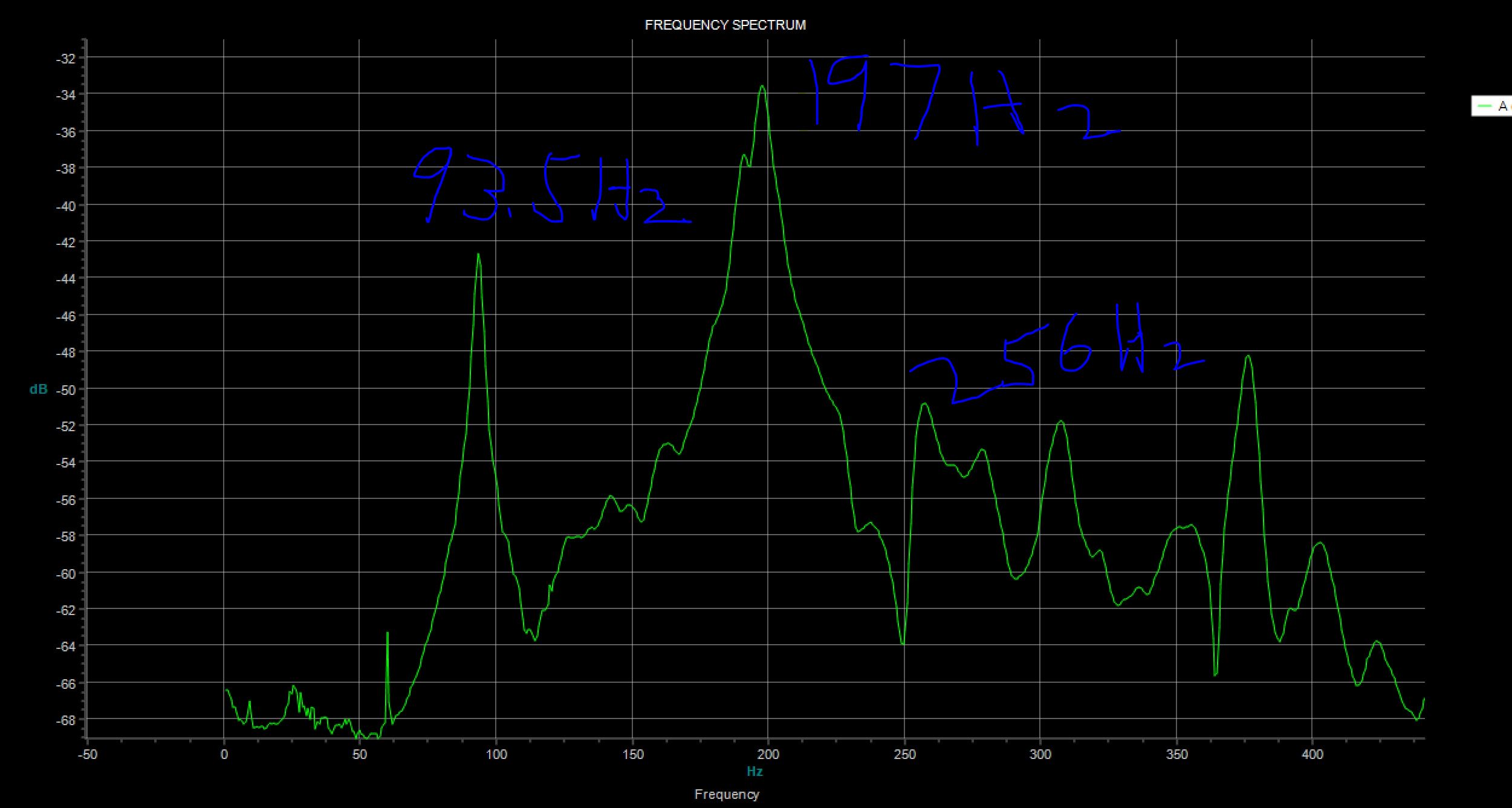

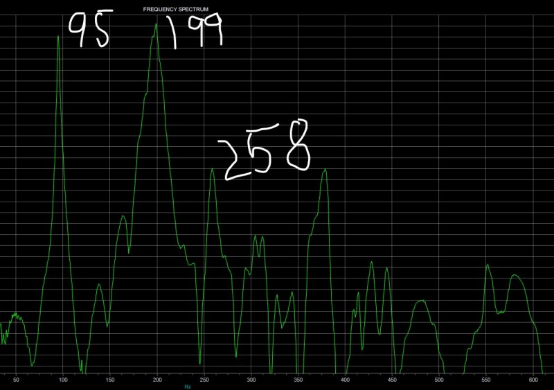

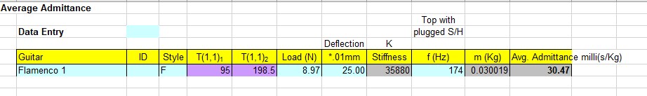

I did a bit more analysis of the guitar after having it for 4 months. All of the flamenco players that have tried it have been shock at its sound. I watched them go from skeptical to slightly interested when they felt how light the guitar was, to very engaged when they started playing and spending a lot of time with the instrument.
The resonances are 95 Hz 198.5 Hz and 157 Hz. The bridge rotates 1° and monopole mobility is 30.47

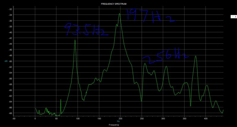

New tap testing results. I dropped the action down almost 1 mm from the first plot. It made a couple Hz difference.
strung up resonance.jpg (86.44 KiB) Viewed 7882 times
