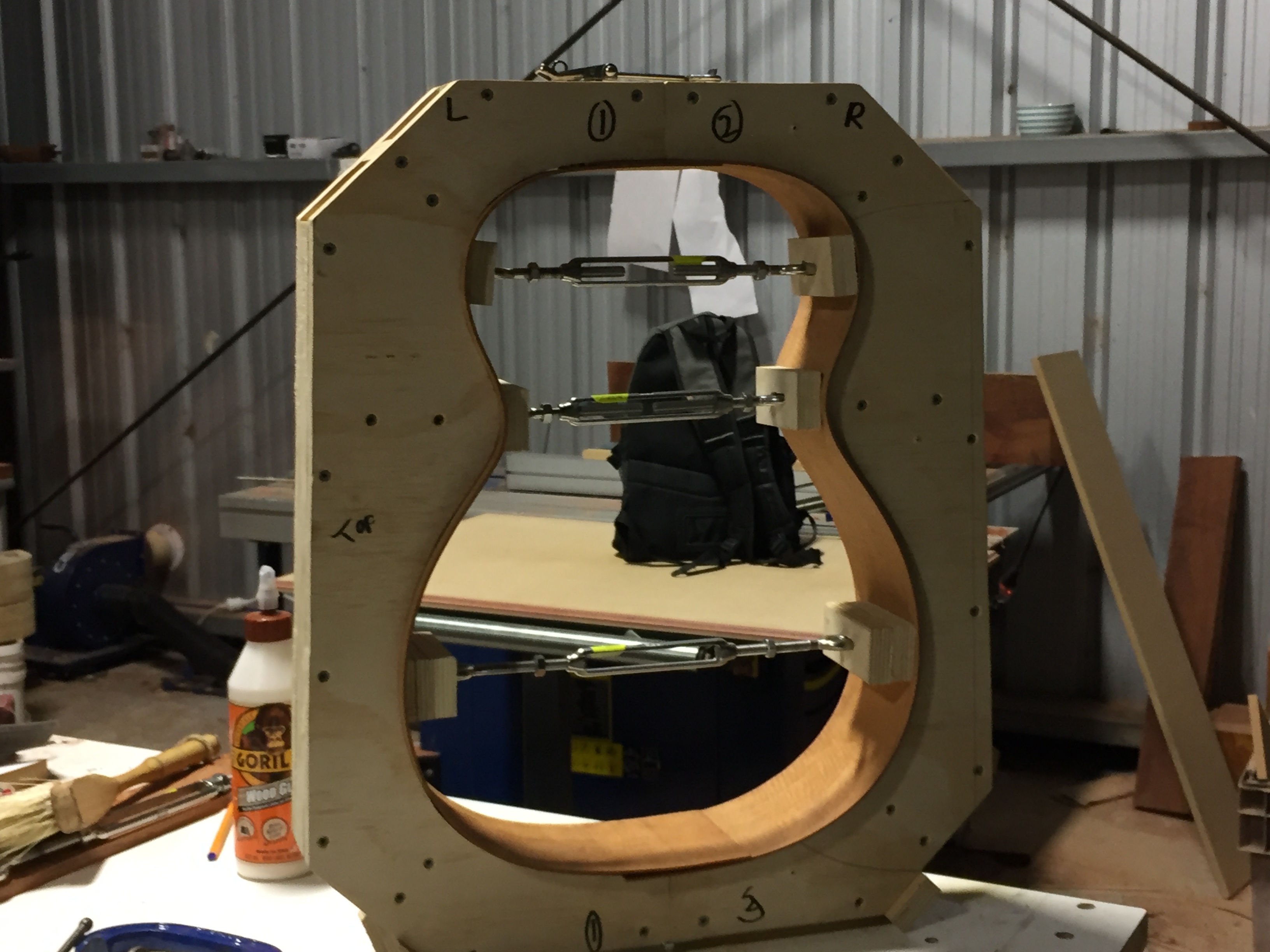

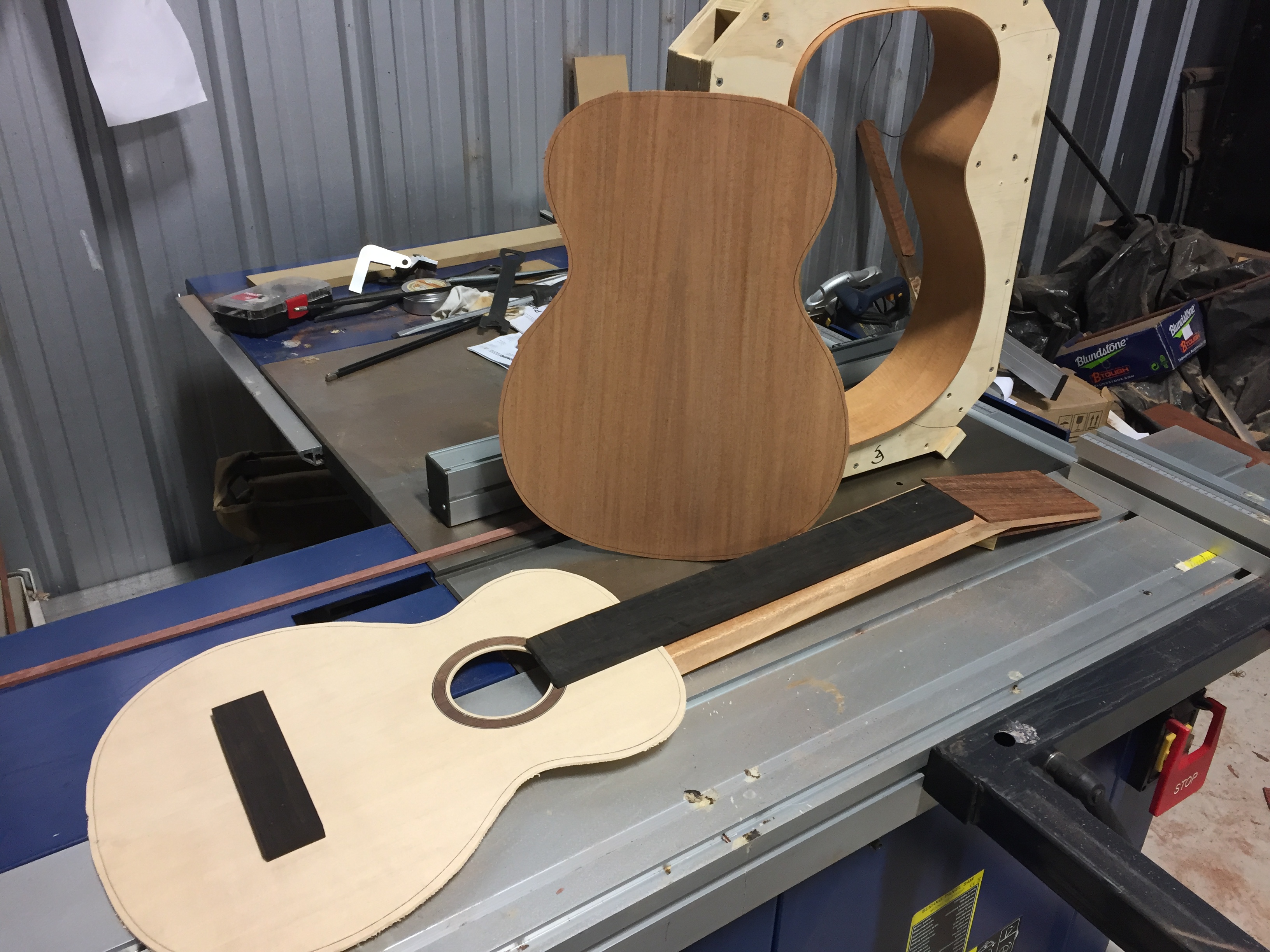

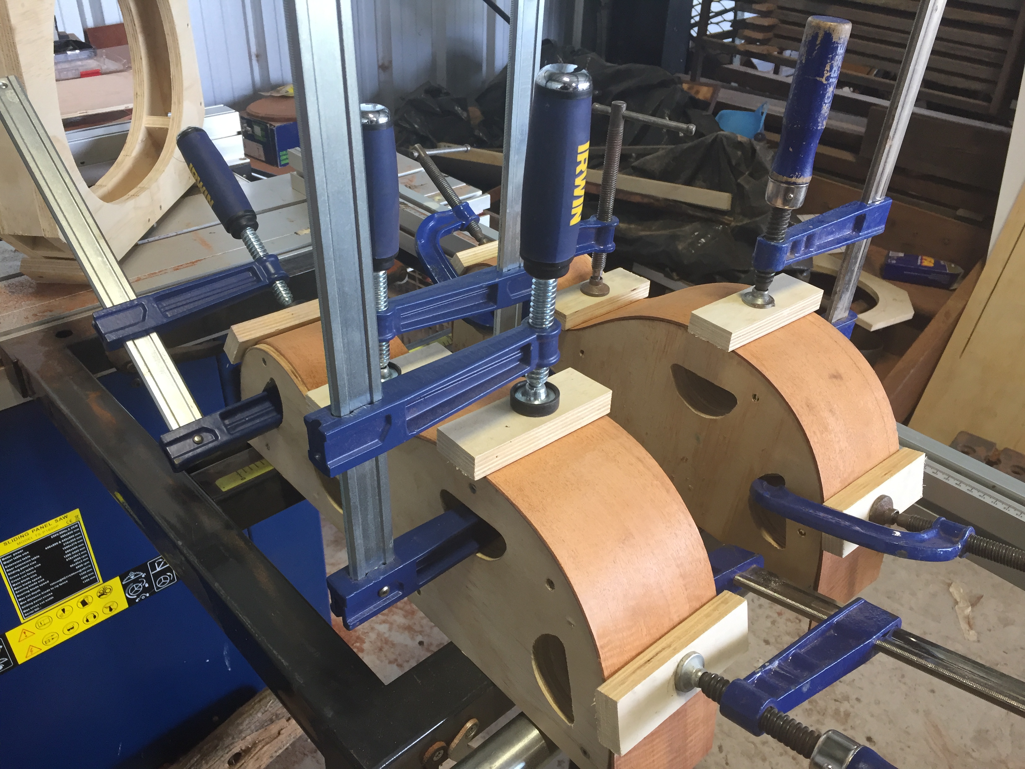

Hi all.
Rather than filling the forum with all my
First-builder questions...I thought I’d start a thread on the whole guitar.
I’ve downloaded the 00 size plan from Grellier
and am “customising” it to my preferences.
It will be Sitca Spruce top
Mahogany back
Sides are either mahogany or rosewood.
Mahogany neck
Ebony fingerboard and bridge
With Jarrah and Mulga as bindings headplates ect
John Maddison, a luthier close by has been very helpful so far and showed be how to bend the sides on an iron as well as some other tips.
So the sides are bent, top and back thicknessed, now working on some bracing and kerfings.
I’ve made a 25ft radius dish which I’ll use for top and back.
If someone sees I’m doing something a bit weird feel free to say something as I don’t really know what I’m doing!
Look forward to keeping you updated.
Joseph

Hi Joseph
Looking very good so far.
My only comment would be on the glue choice. Is the Gorilla PVA Glue the one you are planning to use for the whole build? I have no experience with it myself, but most people are wary of using PVA glues because of the issue of cold creep which can be an issue over time with joints that are under constant stress. The effect of 140 lbs of string tension constantly trying to fold your guitar in half can make glued joints move over time. The most trusted glues for general guitar construction are Titebond (Original - the red one), or hot hide glue if you want to be traditional.
Sitka and mahogany 00 is a classic design. Should be good. Are you planning a 12-fret or 14-fret neck joint (I am guessing from your mock-up that it will be 12)? Slotted headstock or peghead? And what scale length?
Keep showing us pictures as you go. We love that around here.

My comments:
1) go with Titebond I AR glue
2) Ebony makes for a rather heavy bridge....I prefer rosewood or if using CF I use blackwood or walnut to keep weight down with the CF adding stiffness.

Re: 00 Acoustic build thread.
Thanks Mark,
Titebond lll (green) is what I’ve been using so far, the gorilla is just for jigs etc. But I’ll try find some of the red.
Peghead but haven’t got any tuners yet.
Not sure about scale at this stage, probably 14 fret now that I’m not doing a cutaway.
yet to get cluey about all that.
frets and neckjoint are what I’m probably most nervous about stuffing up.
Joseph

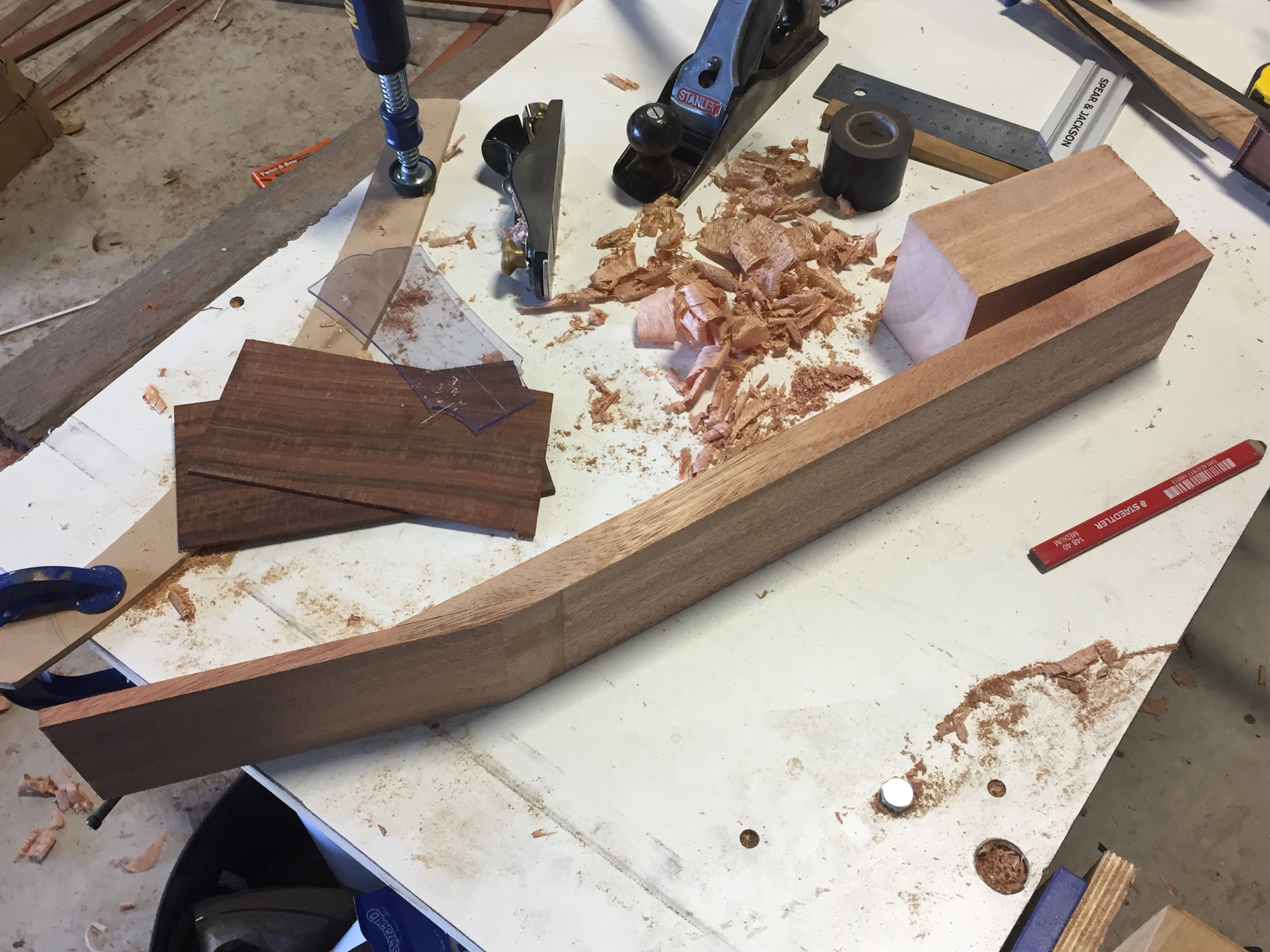

You are ready to glue in the neck and heel blocks. Next decision is what type of neck joint to use - bolt on or dovetail. You can get into a massive debate over this issue but pretty much everyone here at ANZLF seems to be in the bolt-on camp. I think it is definitely the right way to go. Even traditionalist William Cumpiano has converted to bolt-on methods in the years since he wrote his book (check his website).
- Joseph Jones
- Myrtle
- Posts: 77
- Joined: Wed Aug 08, 2018 11:56 am
- Location: Narrikup WA
Hmm yes, the neck joint.
Do I need to sort all that out now before the neck block is in or is it easier to cut it at a later stage?
Won’t be going dovetail I reckon.
Joseph
Joseph
Going for a pinned mortise on the neck joint.
Mahogany neck and tasi oak block should work well?
Joseph
Joseph
The stone is hard and the drop is small but a hole is made by the constant fall.
- Posts: 1165

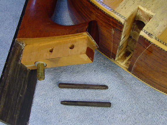

Tassie oak would probably be OK for the blocks. Lets see if anyone here has tried it before?
Mortice and tenon is a tried and tested system. How you attach them to each other is the important question. Pinned mortice is not a common way of doing a guitar neck these days - but it was used by Michael Gurian, one of the early pioneer independent luthiers in the 1970s. His guitars were very highly regarded, but I have never seen one. Is this the sort of thing you have in mind? It comes from one of Frank Ford’s pages at frets.com, which is worth looking at:
http://www.frets.com/FretsPages/Luthier ... reset.html
But a more common way of attaching the m&t joint would be to bolt it, maybe using simple barrel nuts. This is essentially the new Cumpiano method:
https://www.cumpiano.com/an-improved-neck-body-joint
