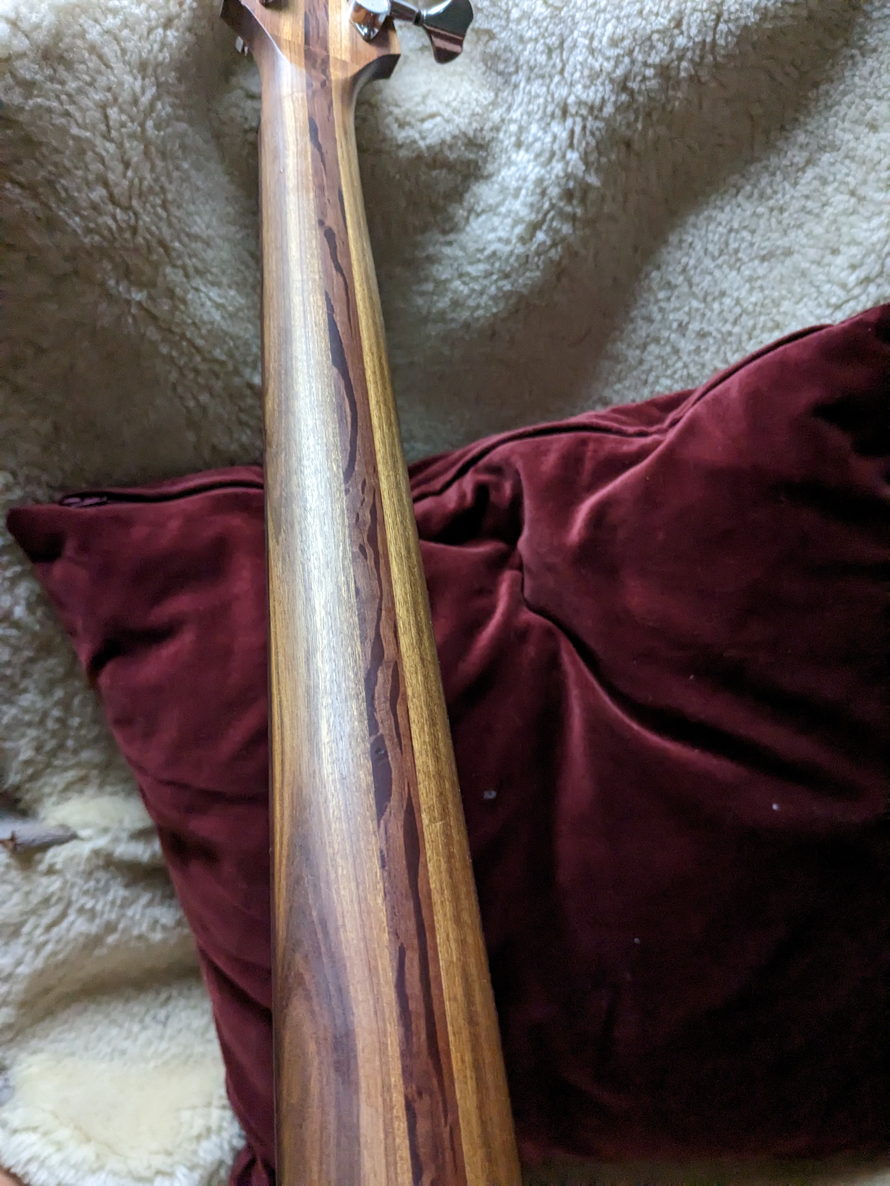

It's remarkable stuff, I used it as the centre strip on a neck that has it as the fretboard

Post by Julian » Mon May 22, 2023 12:35 pm
I'm trying to upload photos but am a bit hopeless at tech ...
