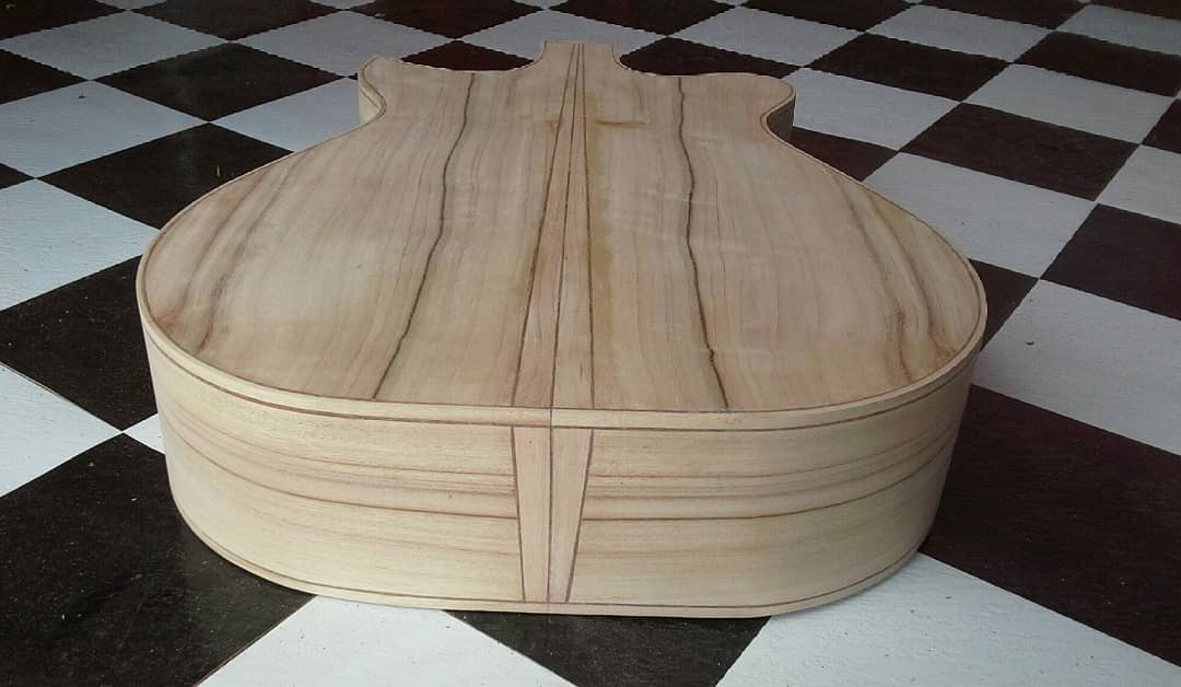

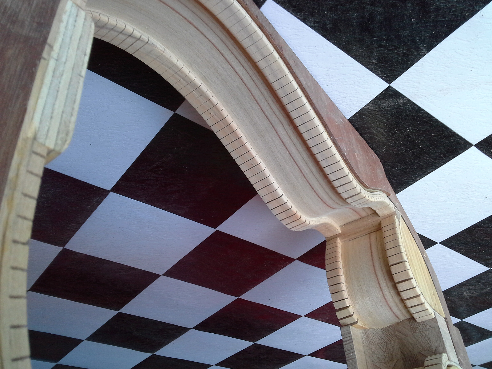

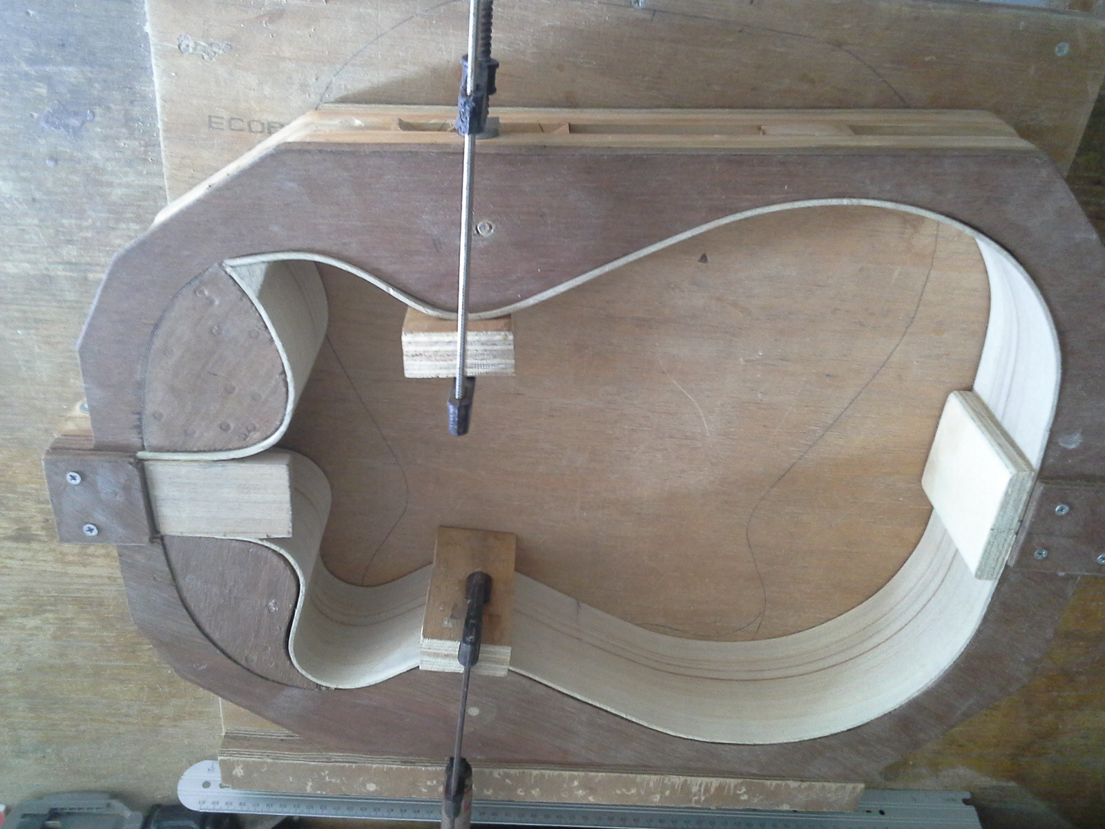

I've had this idea for an acoustic for quite some time now,
Decided to finally build it.

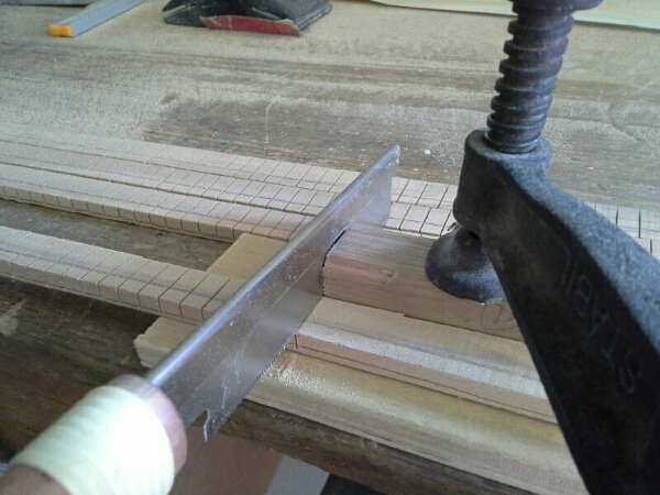

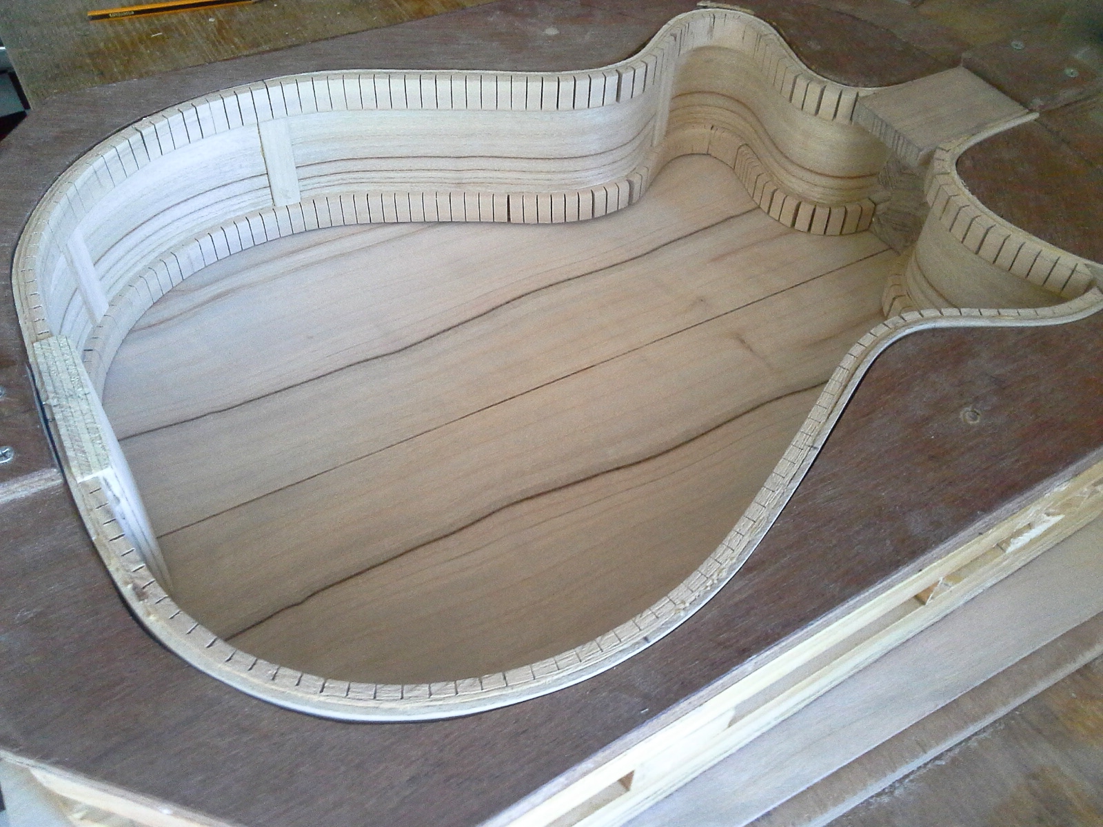

Camphor Laurel sides have been bent on a bending iron and top / bottom blocks installed.
Bunya pine linings, I don't use circular spinning saws so no other option than to cut it by hand.
I actually prefer to handcut it anyway.
Looks rather nice against the Camphor Laurel sides.
A few photos upside down, lets just say its intentionally arty....

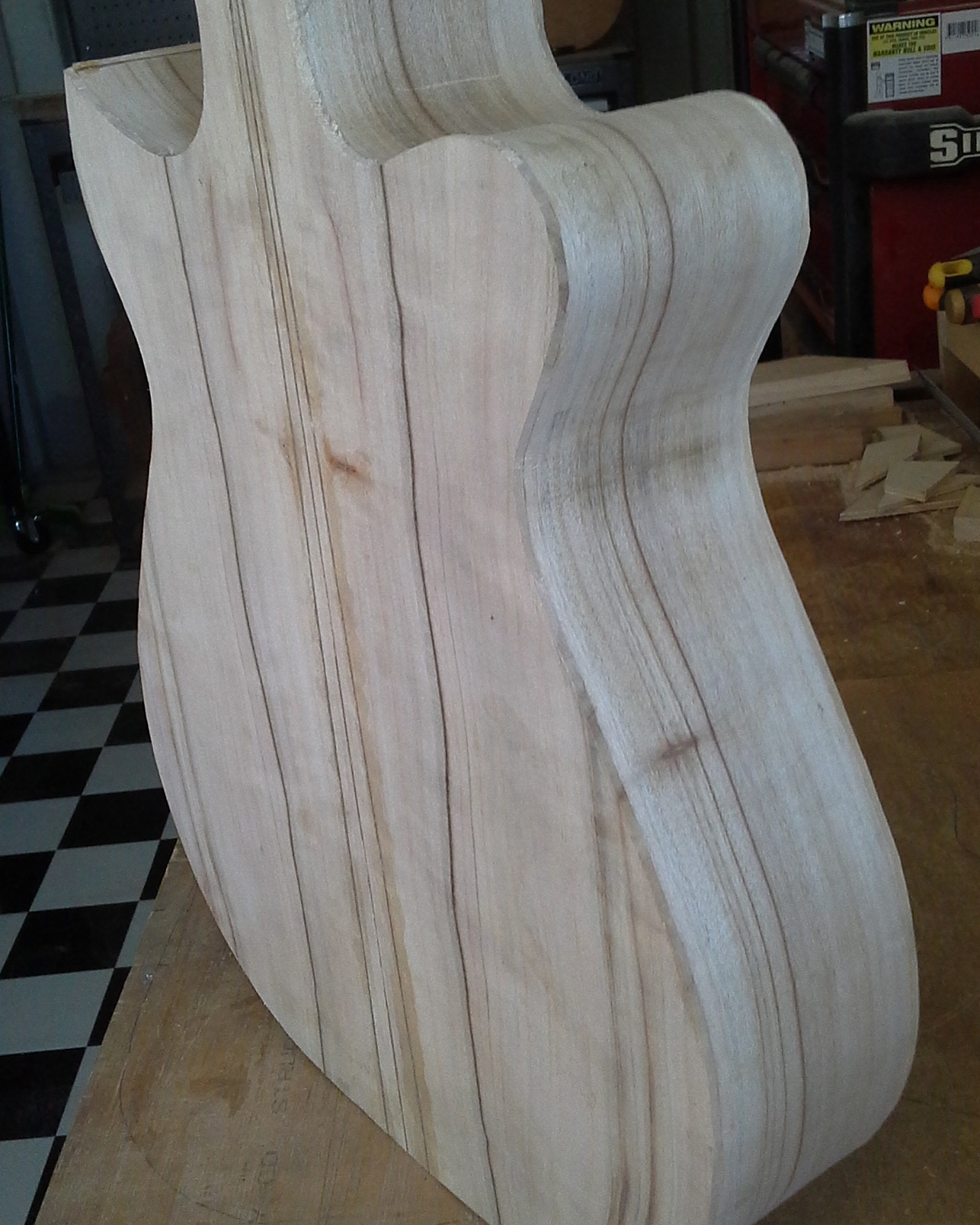

Added a few side supports made from the offcuts of the Silver Quandong top.
Having a look at how the grain matches up on the back and sides.
Making great progress.....

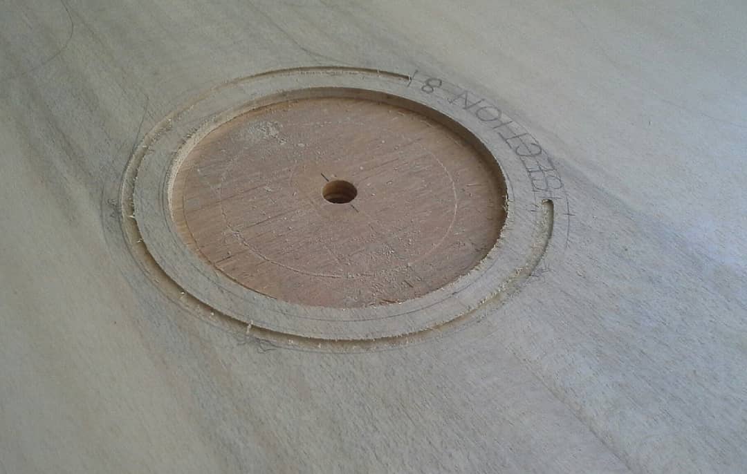

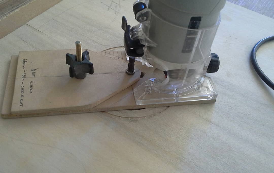

Made myself one of those circle cutting jigs,
Cuts a really nice rosette trench and soundhole.
That laminate trimmer is one of few powered tools I use, mainly binding channels but it comes in handy for jobs like this.
Time to make the tone bars...

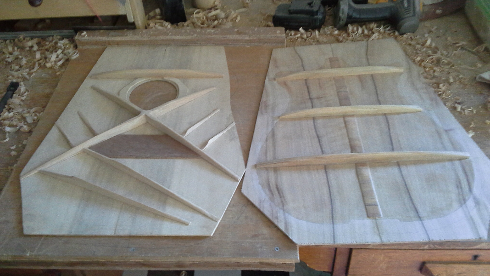

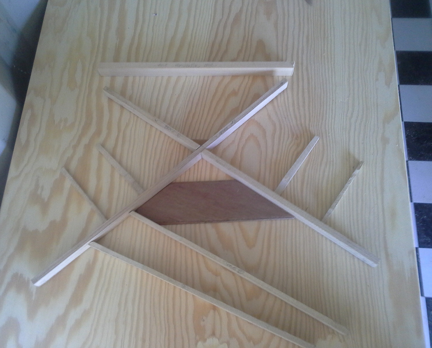

Okay, tone bars are made.
Handcut and shaped from Bunya Pine.
All internal areas have been sealed.
I guess it's time to close it up.

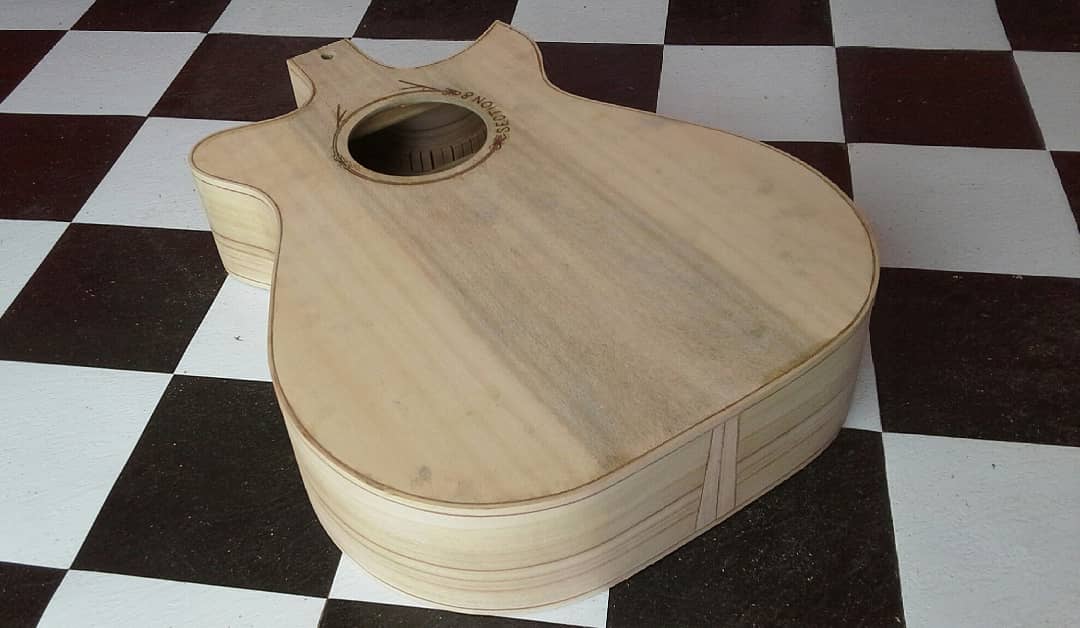

Camphor Laurel binding with contrasting Australian hardwood stripe installed,
Partially completed soundhole rosette as well.
Nothing over the top just keeping it subtle.

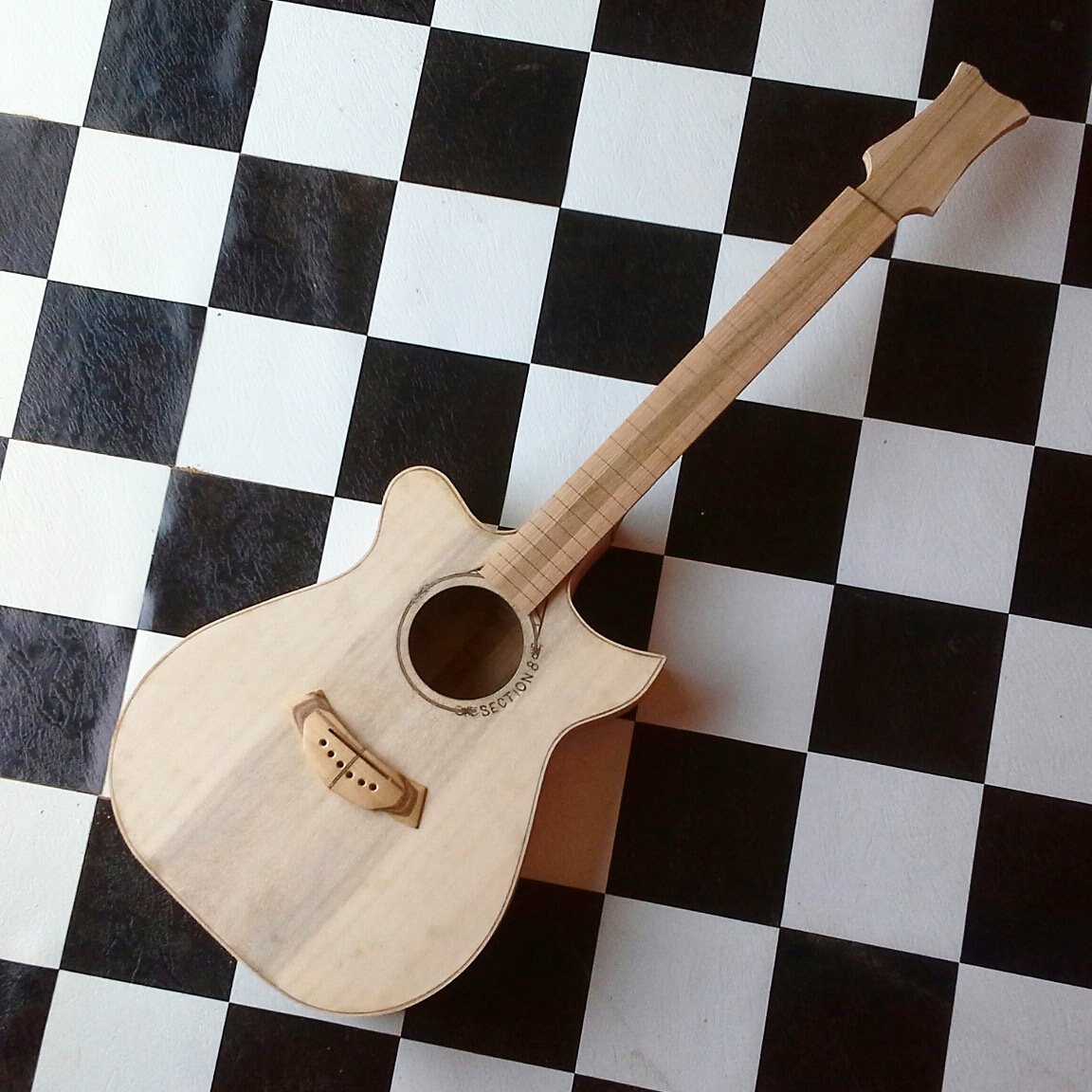

Still a bit of work to do on the fingerboard but its looking pretty good.

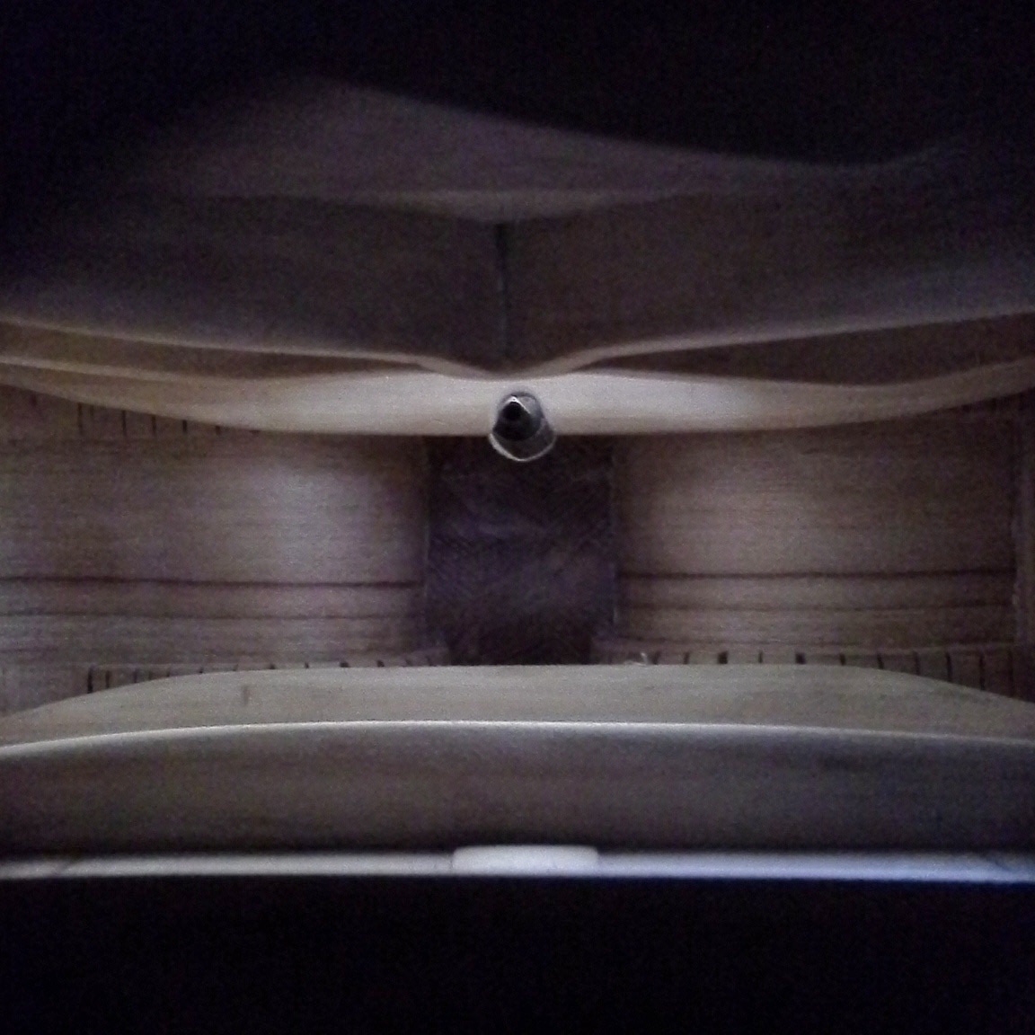

Bridge has been made from Camphor Laurel with Australian Hardwood stripe and sealed.
It looks more like a theatre inside than a guitar.

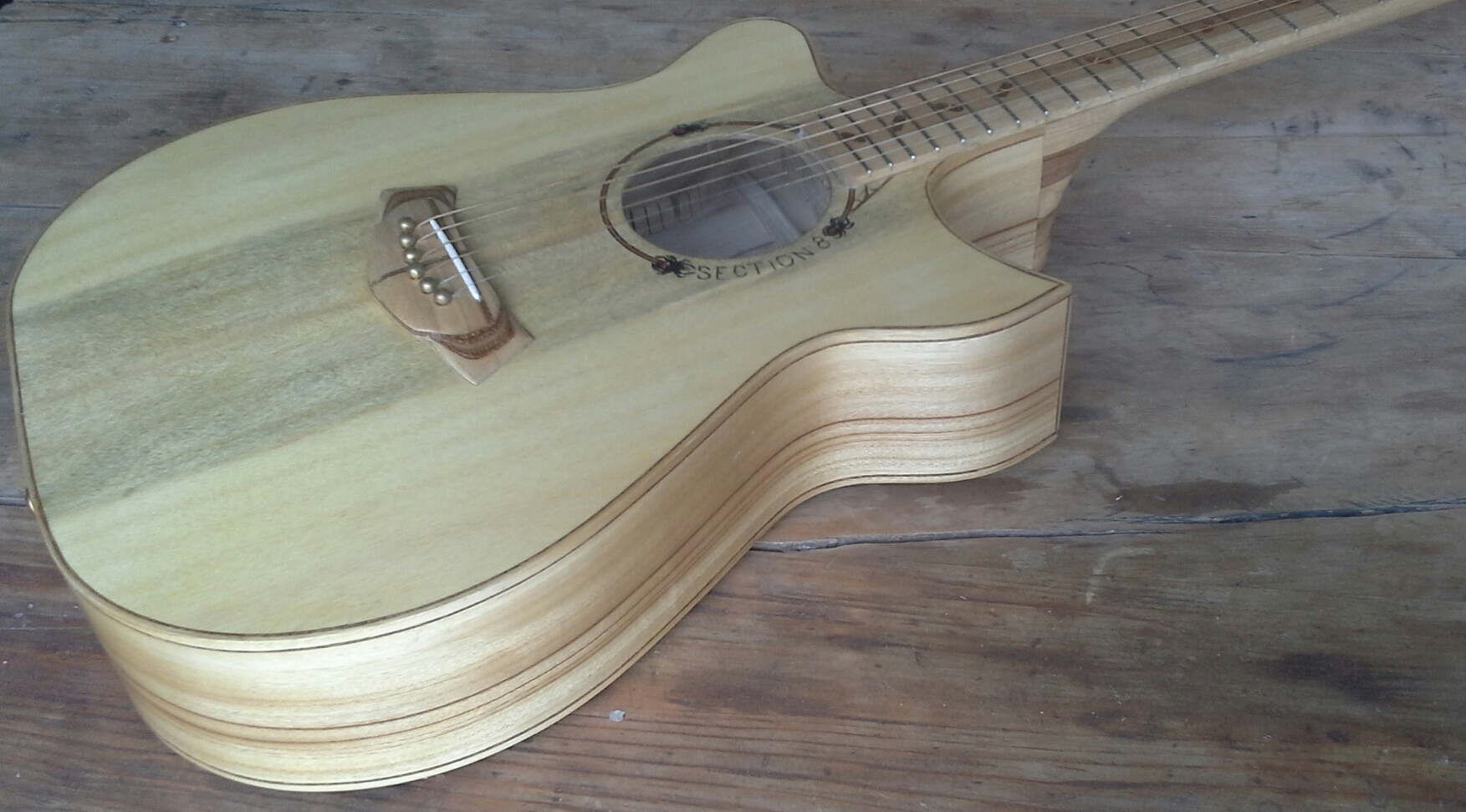

Post by KirbyMD » Fri Mar 13, 2020 1:10 am
A couple of coats of polyurethane and then frets are installed.

Thanks Dave,

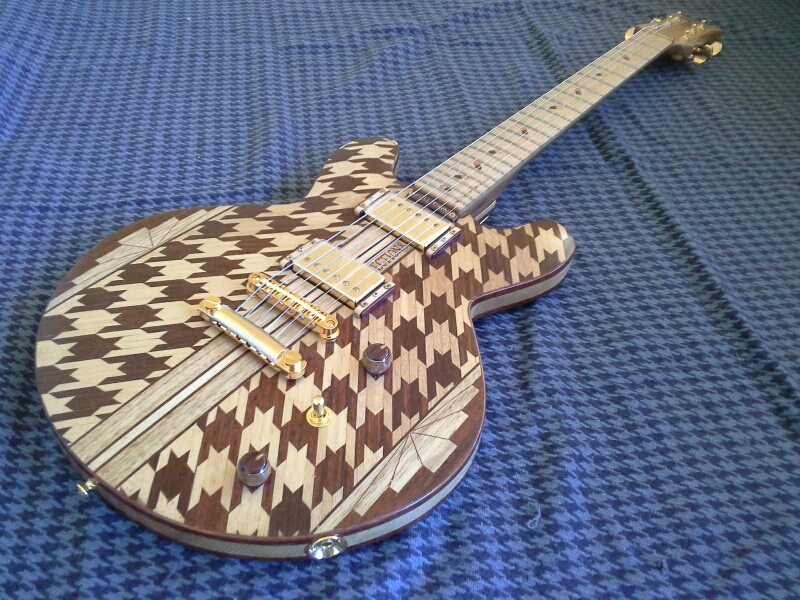

I worked out the body shape a long time ago when I was employed in the mass production side of guitar building. It is unusual yet reminiscent of a tele in acoustic form.
The body is parallel at 94mm which helps visually.
I'm ex-Maton, 2 terms 1989-1993 and 1997-2003 so I'm pretty quick when I get going.
This actually ran over by a month.
Section 8 is a category of discharge from the United States military, used for a service member judged mentally unfit for service.
We're a little nuts here and do things differently, so it seemed fitting to call ourselves Section 8.
Take our Houndstooth guitar....
All Tasmanian Oak and Jarrah , chambered body.
Thanks for checking it out.
