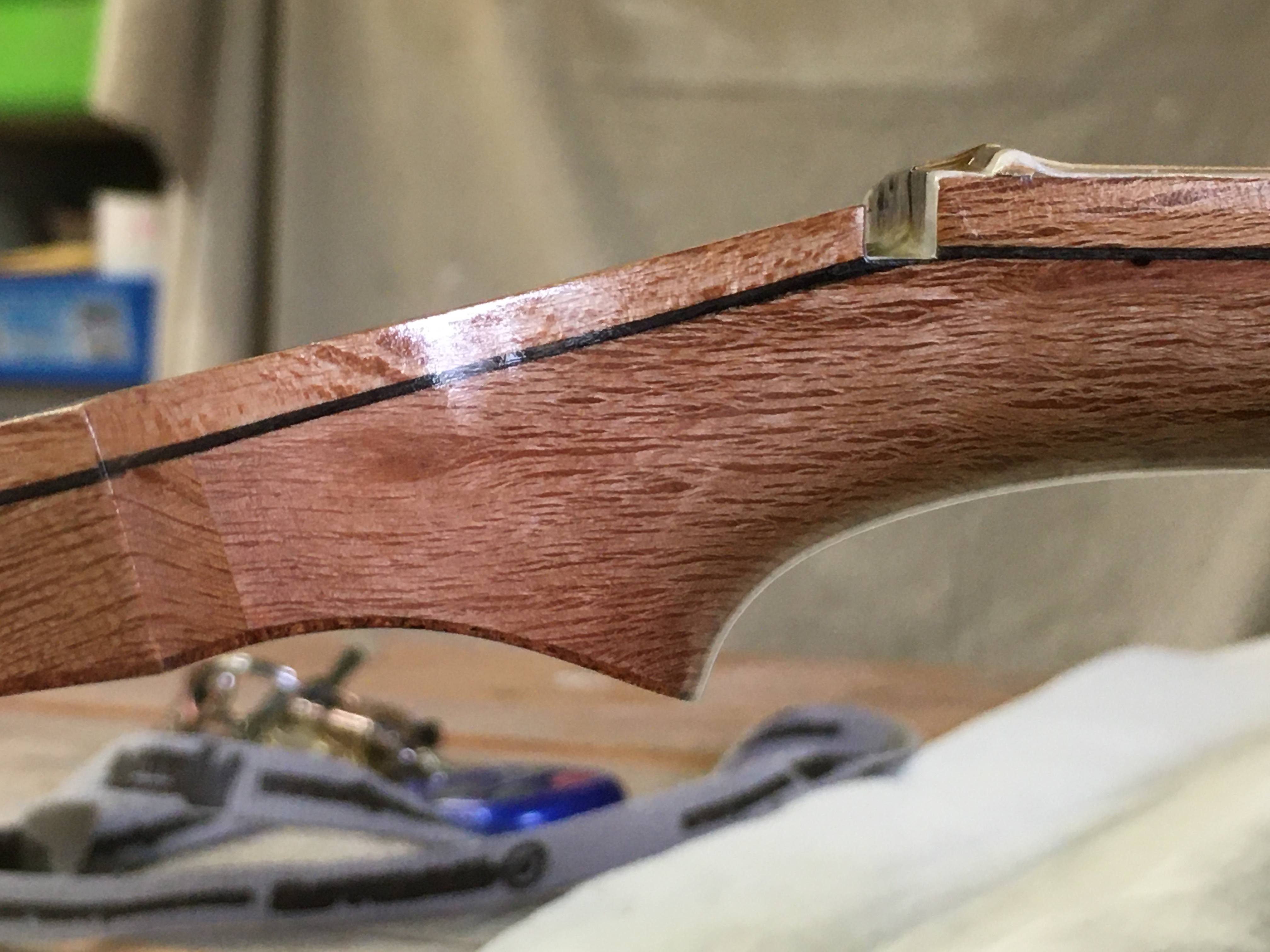

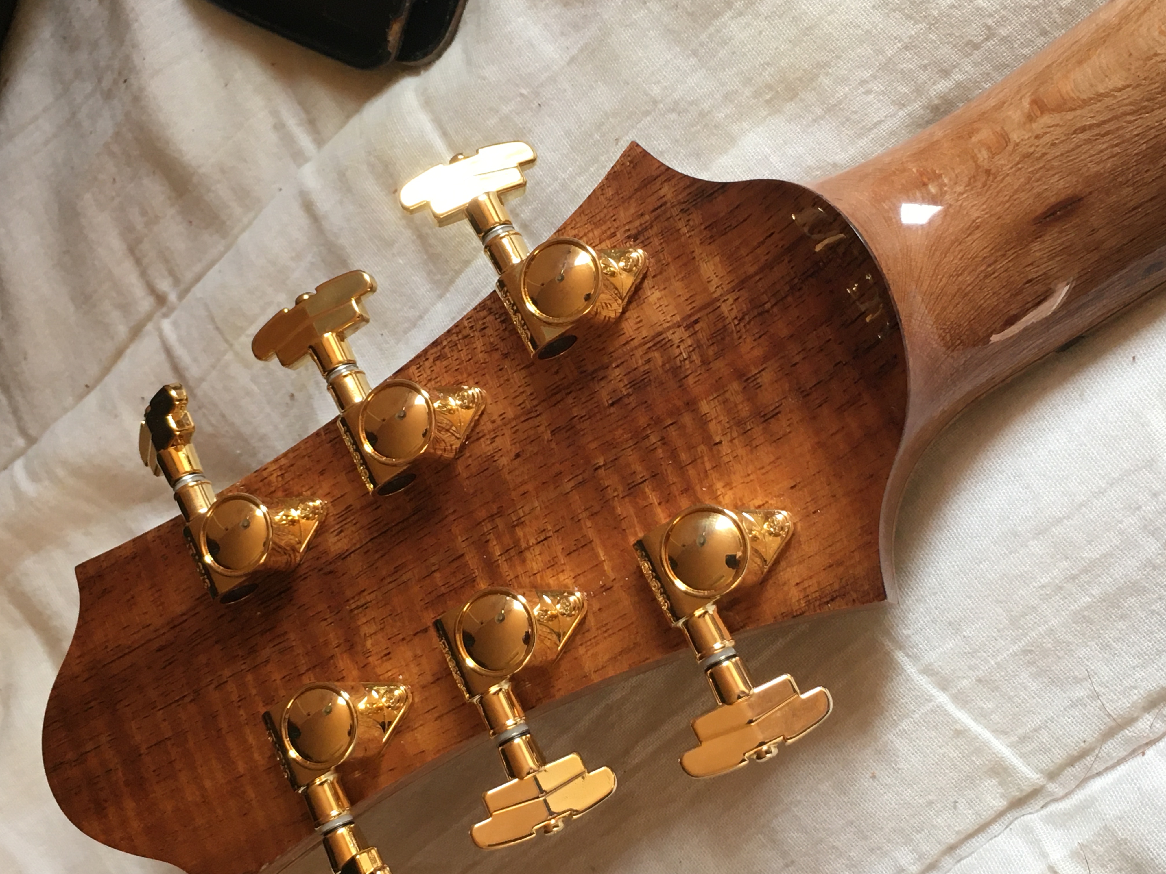

Very interesting Mark, I had the impression that the volute was more related to that of those used in the Viol family, violin, cello etc. I have used the volute on some of my builds mainly for aesthetics but thought it made sense because of the distant relationship that family and archtop guitars have.

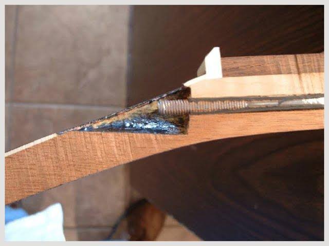

But getting back to Greg’s original question - why?
It has sometimes been suggested that it strengthens the neck at a point of weakness. I have been sceptical of this, especially with regard to the Martin dart. Is it in the right place, or substantial enough to make much of a difference? But if you look at this cross section of a Les Paul neck without a volute you can see why Gibson’s design with the truss rod adjustment at the headstock creates a neck that is ready to snap off the day it falls off a guitar stand. And any extra meat there has got to be an improvement. I have built guitars with volutes, or darts, and with headstock adjusting truss rods, or Martin-style. My latest preference is truss rod adjustment through the sound hole, and a neck transition with a backstrap just like Nigel’s design (but I must admit my execution is not as classy as his).
