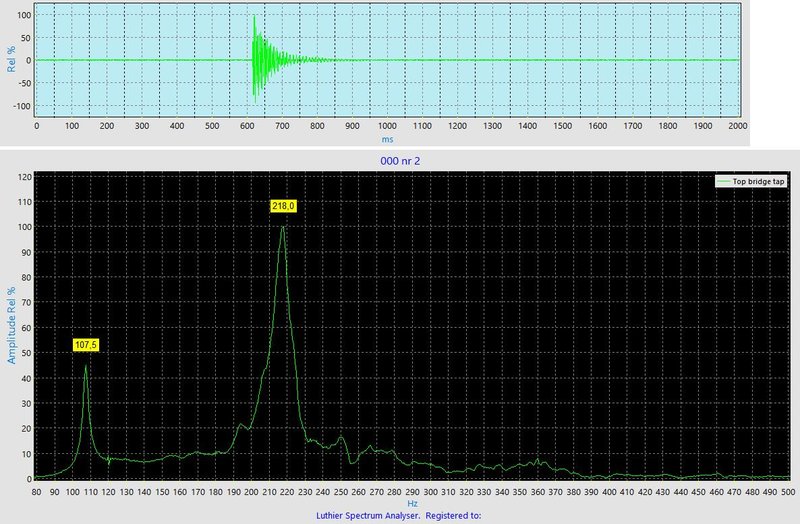

Here is a spectrum of the original :

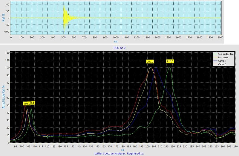

The next chart show how it changed after 1, 2, 3, carving session of the braces.
Notice that the air mode did not changed much as this is mainly driven by the box volume and sound hole diameter.
The yellow line show where I stop.
I could take the top down from 218 to 202 Hz
Go slowly and measure often.
