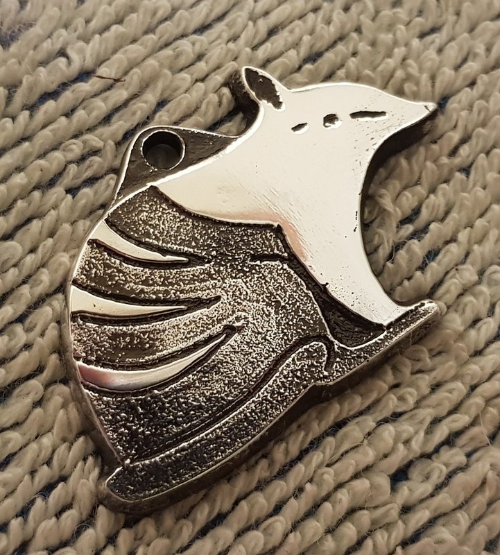

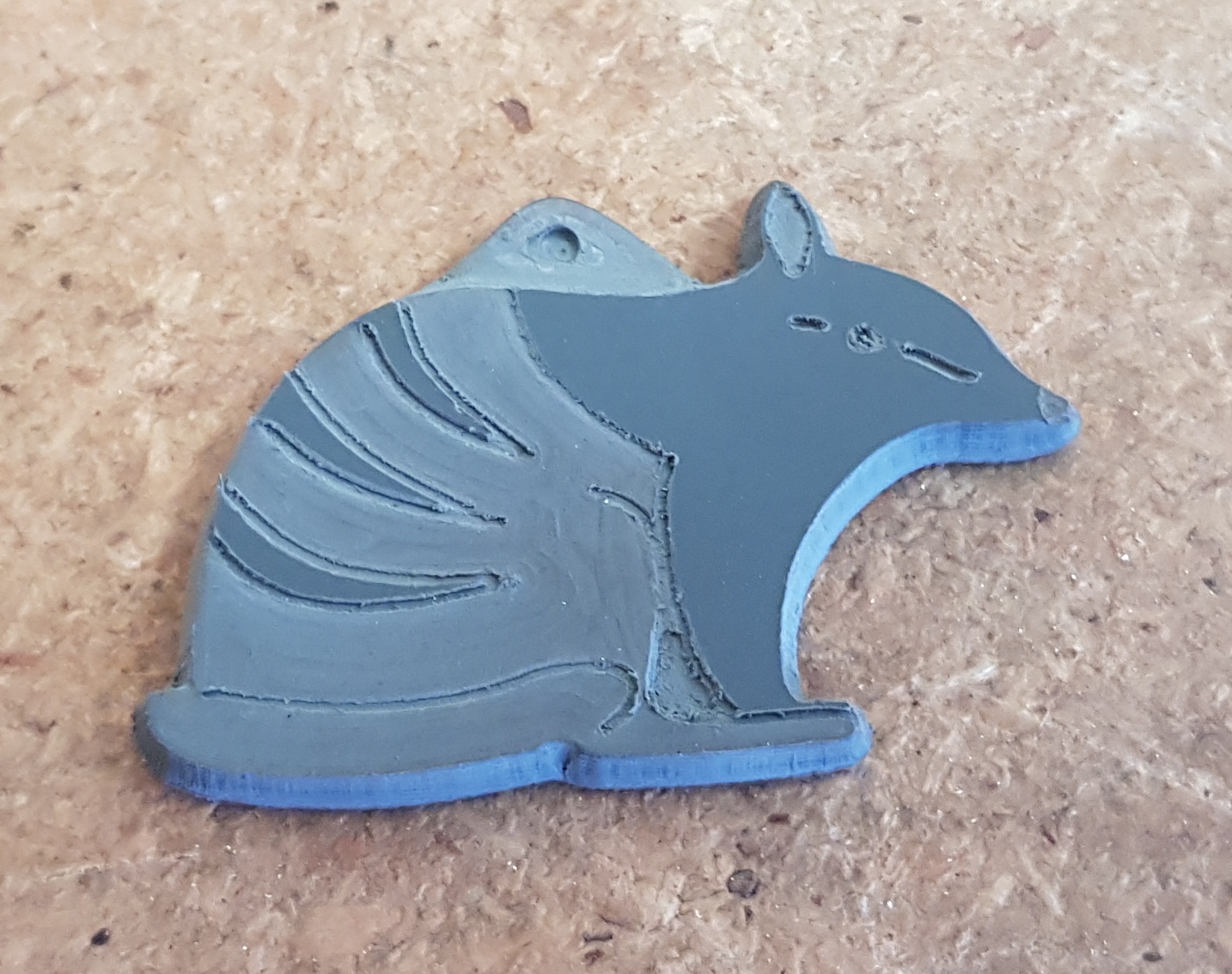

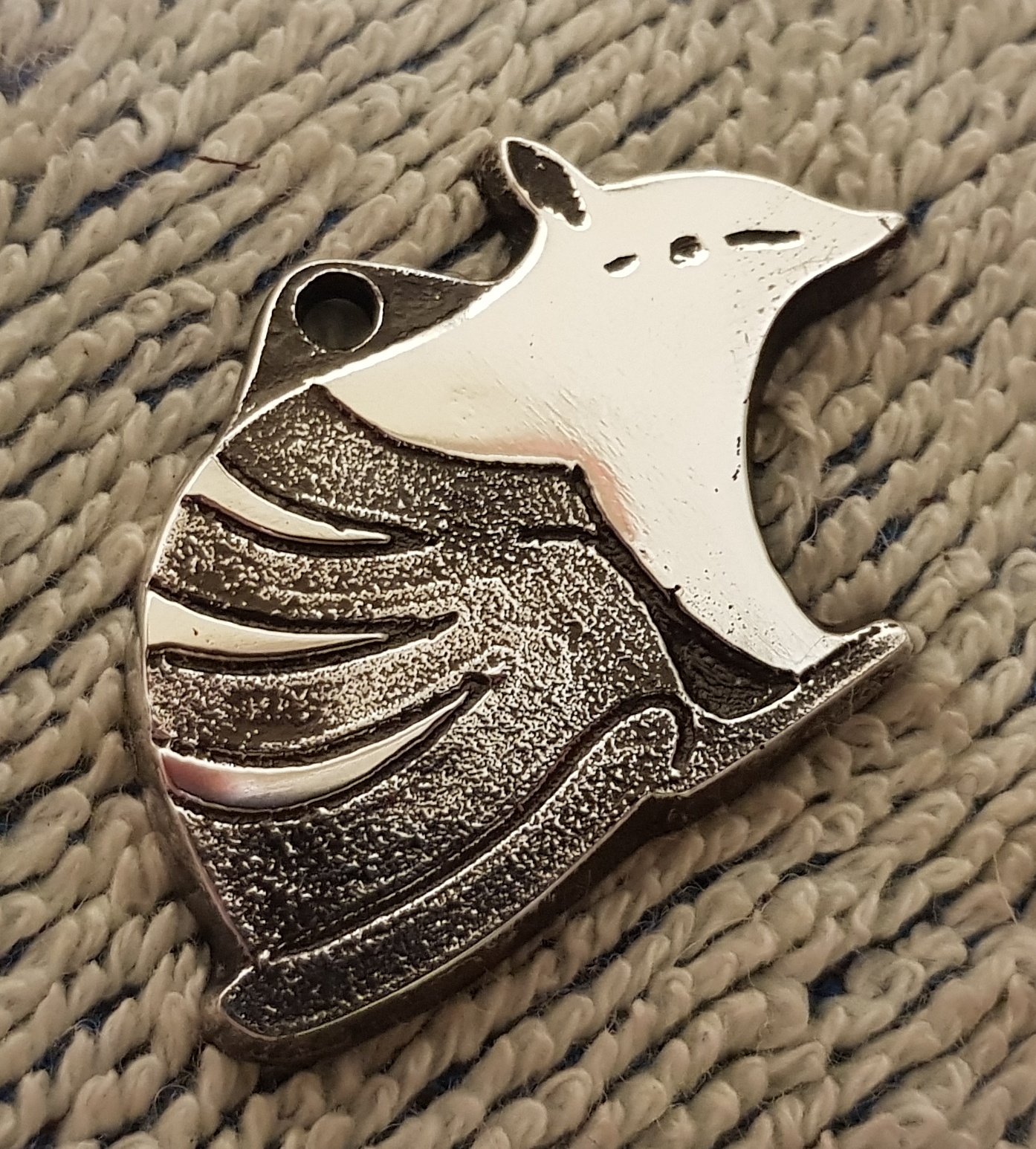

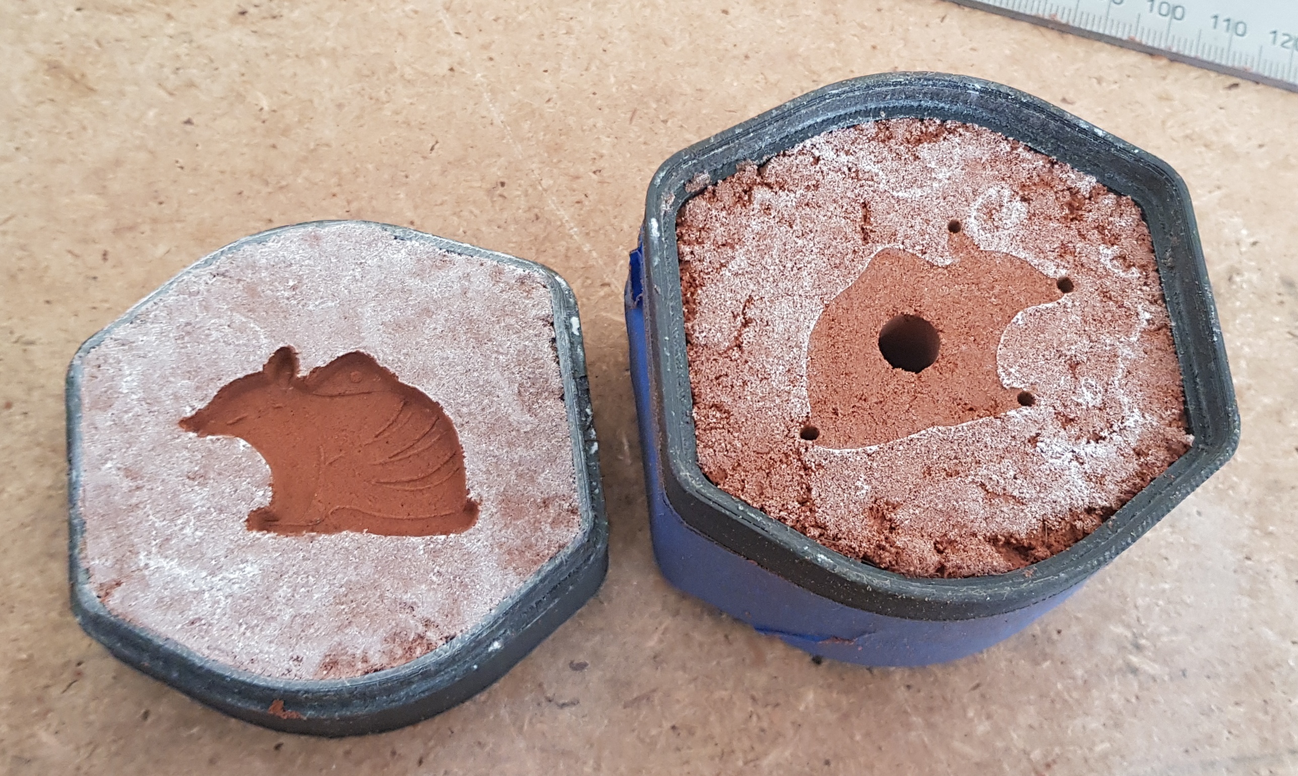

Not the same, but similar; I've sand cast a sterling silver pendant in much the same as the method you're wanting; i sketched it, converted that to a 3d file in fusion 360, cut the design out of lino (like kids carving and printing lino) with a small cnc router, then made a sand mould from that. You can buy sterling silver casting grain pretty cheaply, and just used an Amazon hand held crucible and a bunnings mapp gas torch to melt the silver.
With sand moulding you can't have any overhangs on your part (well, not without getting really tricky anyway) and the part works better if it's reasonably consistent thickness.
I'm a hell of a long way from an expert on this stuff, just playing around with it, but happy to help with tips. I failed a hell of a lot of times before getting my final cast product. Ha ha.
Silver piece
Sand mould
Lino master
